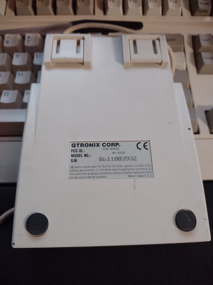

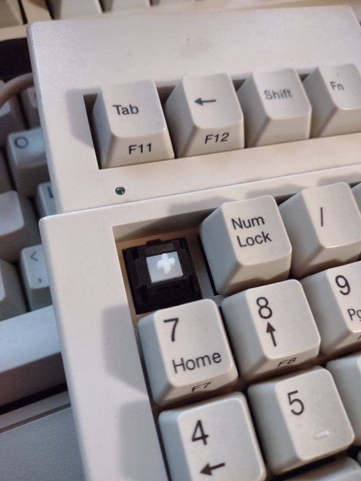

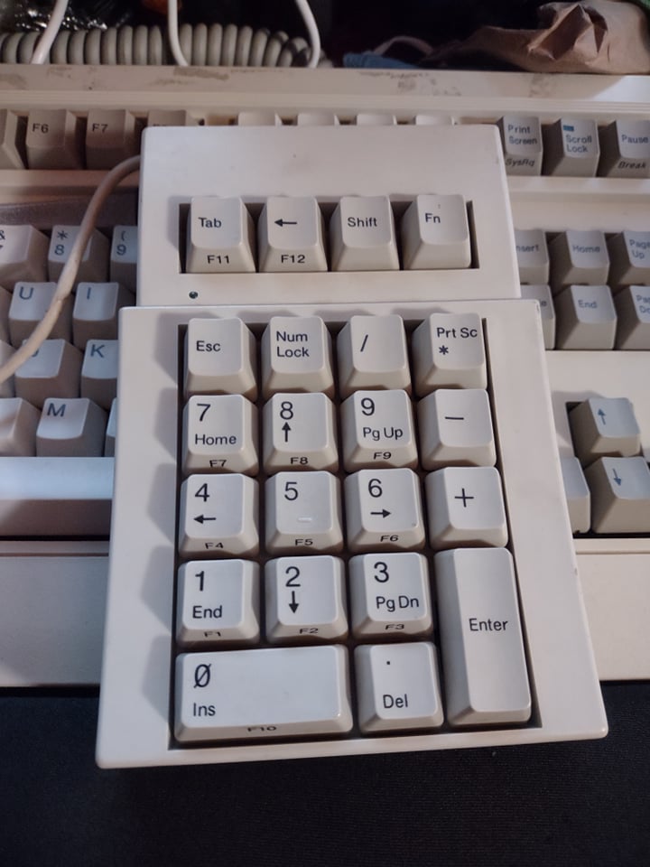

I recently acquired a Qtronix QX-822R with Aristotle switches with the intent of using it with my laptop. I daily drive linux and I didn't expect it to be as difficult as it has been to get it up and working. I've been working on it all day with only minimal success.
I found this web page from 15+ years ago and it helped somewhat, but I'm currently running into the issue where the C code compiles but it can't access my USB to Serial adapter.
http://www.linuxtoys.org/keypad/keypad.html
I am hoping that someone might be able to help me figure this out.
Thanks in advance!
--Cheers
--Given
Edit: I forgot to attach the pictures.
