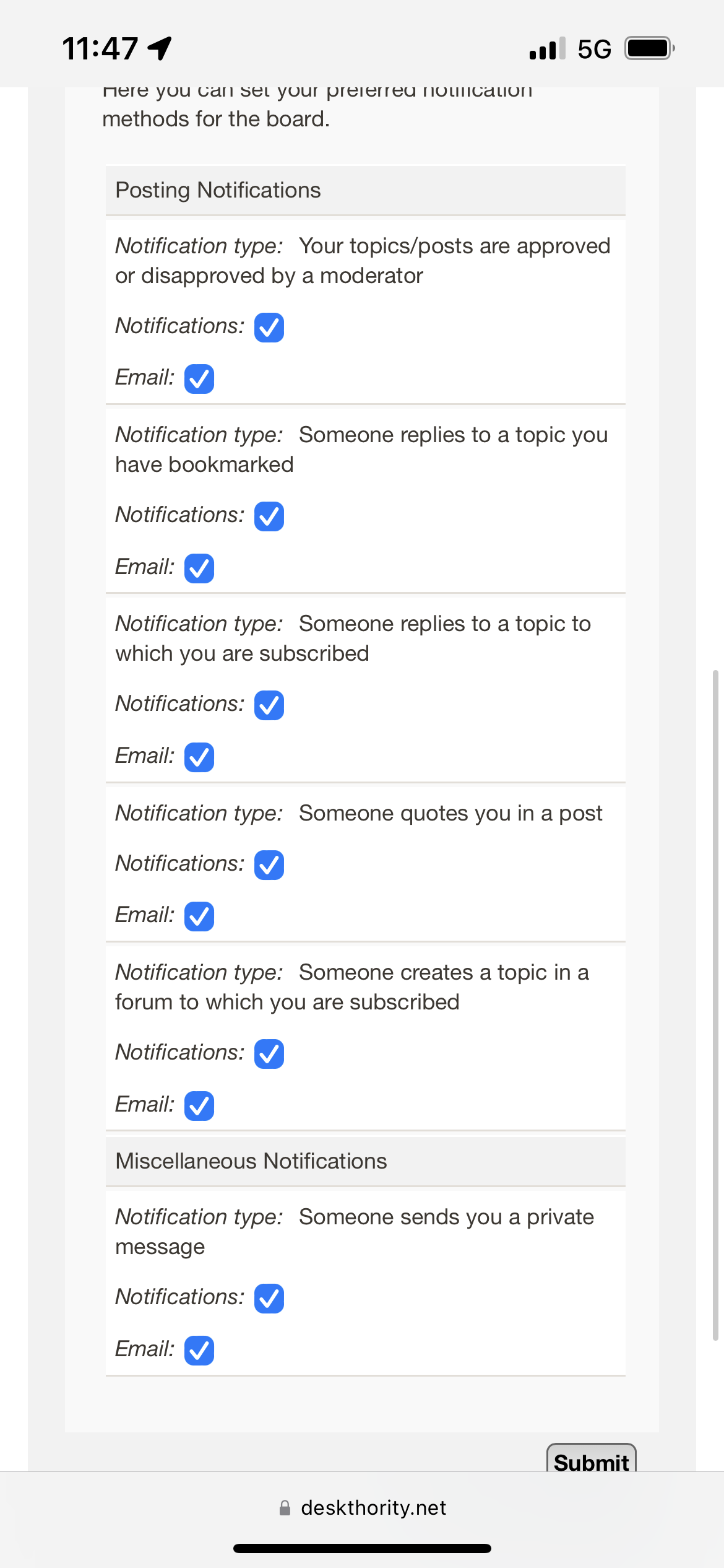

by thefarside
Thanks I checked those settings and everything is enabled and has been since I created my account. Below is a screen shot.
