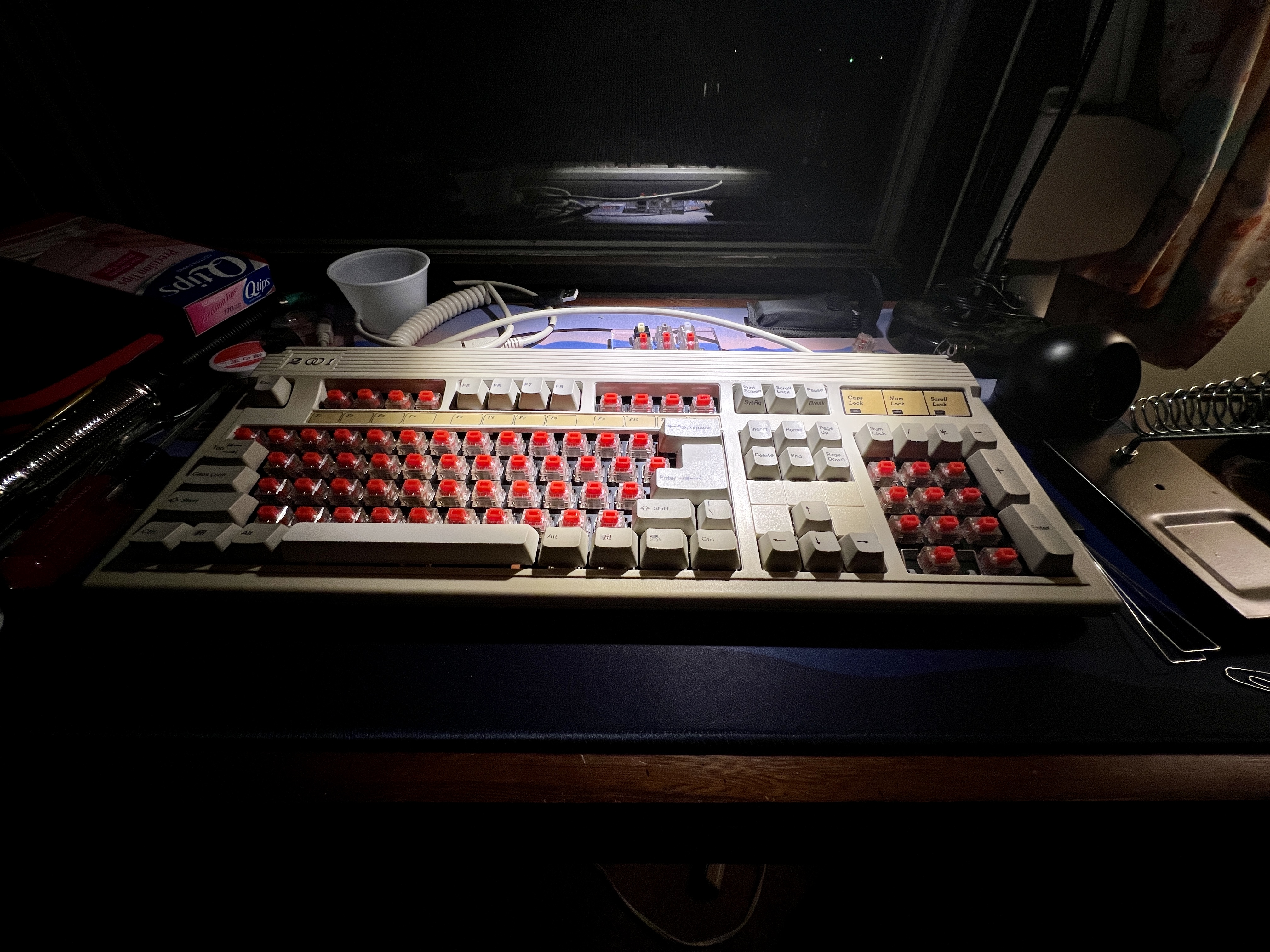

I'm playing with an AEK II now, and pulling the keycaps off is pretty hard. The spacebar is sticking and I want to pop it off and see what's going on, and I cannot get the thing off. I'm afraid to pull any harder.
Prior to this, I had a Matias Tactile Pro I bought used. I pulled the keycaps off to clean them, and I actually ripped some of the switches off the PCB.
Is this a common thing with ALPS keycaps? Are they harder to pull off switches than Cherry keycaps?

Better to disassemble the AEKII and take a look from the front to see how the space bar is attached.

Every original alps keyboard I've come across was strong enough to withstand pulling off the keycaps. On AEK2 you just have to pull the spacebar really hard until the stabilizers pop out of the keycap or the clips pop out of the chassis. It's all meant to come out and reseatable so don't worry.
All genuine alps switches I've seen are completely fine as long as you pull straight up. Some have brittle plastic issues with age that can make the sliders snap if pulled at an angle. Even if that were to happen it's not the end of the world if it's a used board since you can put another slider in (if it's NOS you broke the slider on you are going to Hell :) )
Some more info about AEK II spacebar: It has a single vertical peg in it, so don't pull it at an angle even after you pop it off the switch itself; you could snap that little peg's tiny cross mount.

I got it off. Took some work. Now I just have the long wait till the adapter gets here.

always unclip wire before pulling the cap (atleast with long wires like on a spacebar)

apastuszak wrote: 11 Oct 2022, 19:02
My preference is to use a Soarer's Converter. But that only works with PS/2 boards.
I don't know where you heard that. My old project looks embarrassingly crude, but it works fine.
https://geekhack.org/index.php?topic=58 ... msg1348717
