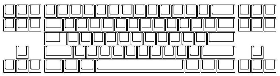

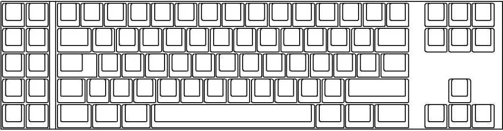

Here's my take on a proposed layout. It has all the keys a normal TKL does...plus media keys (vol up, vol down, play, pause, next track, prev track). The only key that I completely did away with was capslock, but who will miss it! It also doesn't have a right windows key.

Hmm, I like the idea of Caps Lock -> Fn. Coupled with the number row->Fn it makes them easier to reach.
How about Esc just to the left of Fn, then? That would make it nicely accessible via little finger, with minimal wrist movement. I like the idea of a cluster to the left of the main block, but not so much it being a mirror image to the usual right-hand end.

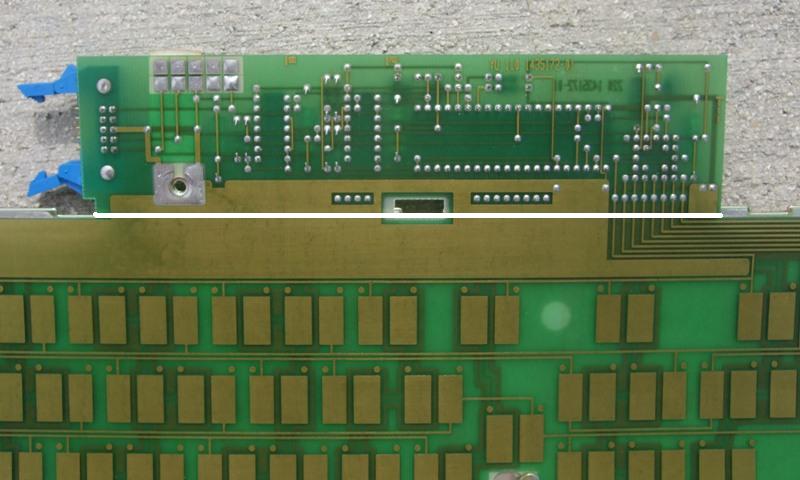

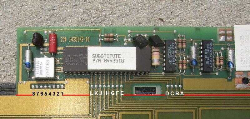

here is where we will cut the controller:
from the other side with rows numbered and columns lettered:

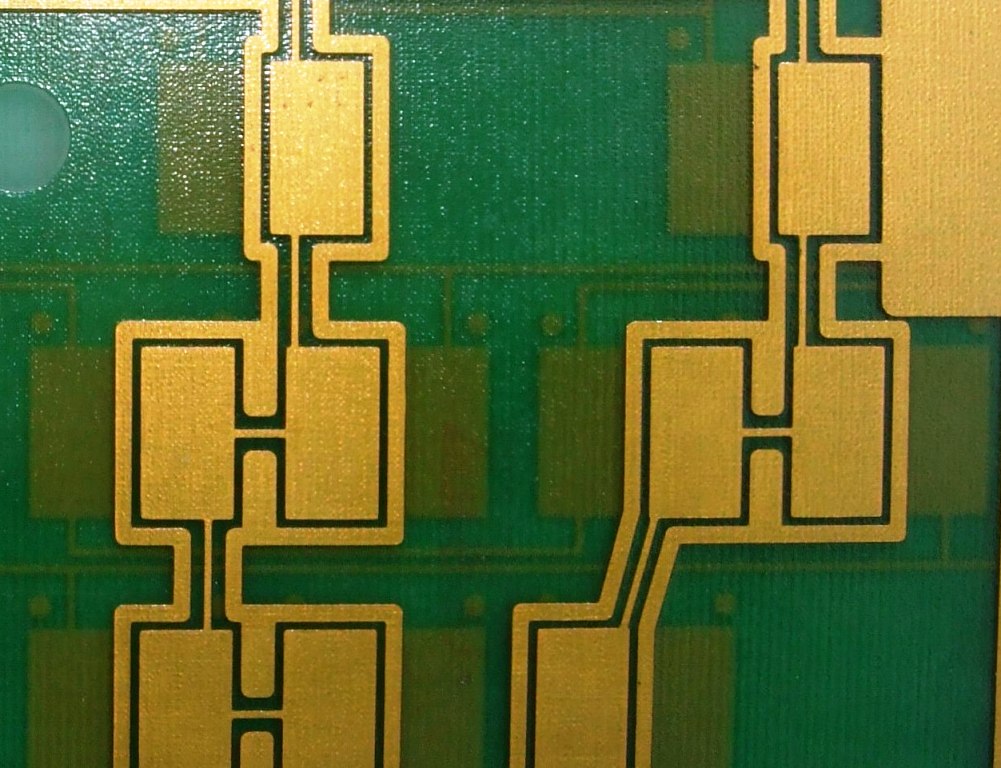

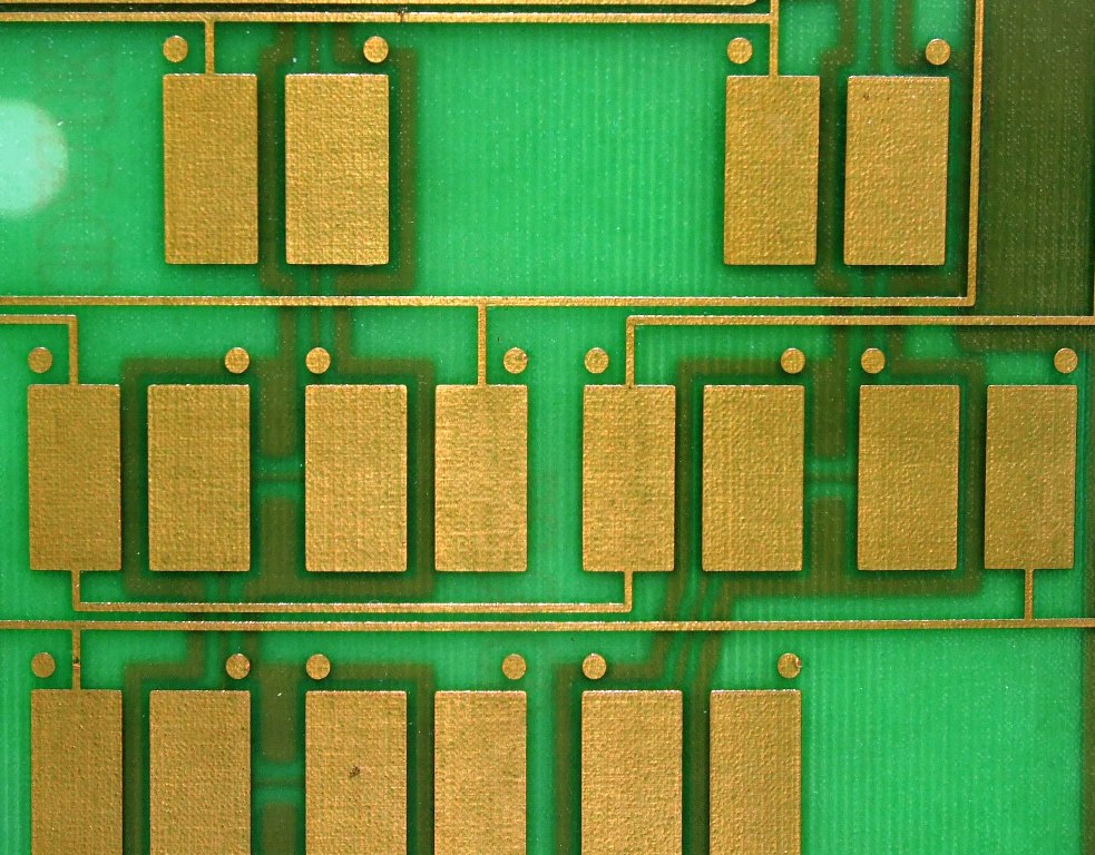

here is a close up of the front top right of the matrix:
matrix top.JPG (217.98 KiB) Viewed 31161 times
and the same spot from the back (mirrored):
matrix back.JPG (170.07 KiB) Viewed 31161 times

AKIMbO wrote: Here's my take on a proposed layout. It has all the keys a normal TKL does...plus media keys (vol up, vol down, play, pause, next track, prev track). The only key that I completely did away with was capslock, but who will miss it! It also doesn't have a right windows key.
Key assignments are 100% up to you!
All keys can be re-assigned to anything else. Want the space bar to be the letter A - fine; just change one line of code. This is a keyboard for people that like to customize. If you don't like to customize - fine; grab one of the configuration files that will be posted here.
What i'm looking for with the layout challenge is where to place the keys.
nathanscribe wrote: How about Esc just to the left of Fn, then? That would make it nicely accessible via little finger, with minimal wrist movement. I like the idea of a cluster to the left of the main block, but not so much it being a mirror image to the usual right-hand end.

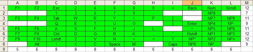

Good idea. But we are limited to 83 keypads. We are using 63 under the alphanumeric keys (2 for left shift and 2 for enter – required for ISO convertibility). The right shift has only one live switch, but uses two barrels (one for the stabilizer). The backspace key is still using two keypads – could take one there, but for every “extra” key added it means that you will need to find a source for barrels. The downside of the layout I suggest is that it does require one more barrel than what comes with the XT.
Try your hand at rearranging the keys in a way that incorporates that spot but still only uses 19 keys in 6 columns outside of the alphanumeric. Remember, you can use 1.25, 1.5, and double-wide keys.

What about a layout like below? It would alleviate the need to cut out the bar that runs parallel to the function keys.
Please excuse my poor paint skills^

I don't think that the layout with three columns on the left would fit. Note that the Model F XT has only a 1-unit wide Enter key and a 1 3/4 wide Backspace key, and the partition to the function keys is 1/2 keys wide. The area available for keys is therefore 21 1/4 wide with the partition removed. The main keyboard area needs 15 units. Then you are left with 6 1/4 for six keys + new partition. This means that each new partition must be 1/8 unit wide, and 1/8 units wide is 1.78 mm including space on each side. We don't have these tolerances.

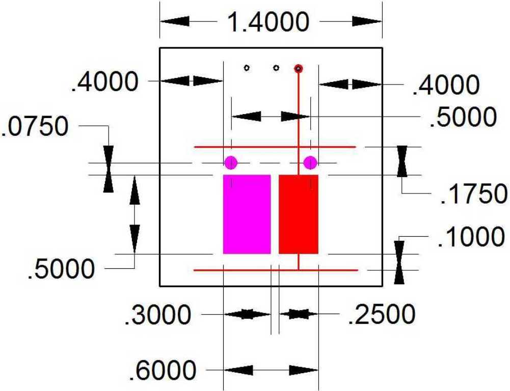

PCB Info:
The board is .031” thick with two copper layers. Copper weight is unknown (does anyone know how to test for this?). The matrix part of the PCB is 16.6”x 4.8”
Each capacitive switch is composed of three rectangular pads:
• a row pad is .500” tall, .250” wide, and is on the top copper layer
• a column pad is .500” tall, .300” wide, and is on the bottom copper layer
• the third pad is exactly the same size as a column pad, but is on the top layer directly above the column pad; this pad is not connected to anything; if there is not a proper name for this pad, I dub it the “magic pad”
• distance between a row pad and the magic pad is .050”
• two .085 diameter dots are at the top corners of each switch; like the magic pad, these are not connected to anything; I will be referred to these as “magic dots”
• standard switch width is .750”; standard height is .825”
• row and column traces look to be .025” wide
• minimum distance between traces looks to be .025” also
• row lines normally run .175” above the top edge or .100” below the bottom edge of a row pad
• the bottom of a bottom row pad is .200” from the bottom edge of the PCB
• the top of a top row pad is .800” from the top edge of the PCB
• the left side of a left most column pad is .400” from the edge of the PCB
• the right side of the right most column pad is .400” from the edge of the PCB

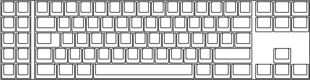

This has got the border on it. Also, all 83 keys are shown. Left shift is split (ISO), backspace is split (Happy Hacker), enter is split (ISO would be double high, ANSI would be double wide). I just dropped the navigation keys in, but there is .80" of space to split up for left and right of the navigation keys.
I just thought of something. If we make all of the navigation keys 1.25 wide then it fills in the extra space. I'll do a mock up of that.

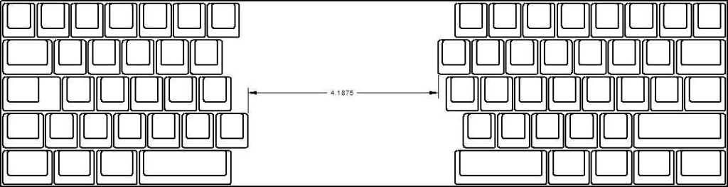

wcass
02 Jul 2012, 04:31
Here's a starting point for the guys that like a split keyboard. What you see displayed uses 68 barrels leaving you with 15 barrels to use elsewhere. The split in the middle is just over 4".

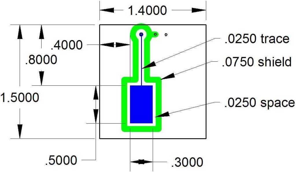

I need a volunteer or two. Do we have any KiCAD/Eagle people out there? All units below are in inches.
Do we have anyone with experience with DIY etching? I have enough .031 thick double sided 1oz to make a bunch of these, but have no experience.
single key PCB top.jpg (48.49 KiB) Viewed 30971 times
single key PCB bottom.jpg (40.99 KiB) Viewed 30971 times

Icarium wrote:Great idea! Wanted to do something similar for a while.
Do you know how exactly the switches work, yet?
What exactly does the PCB have to look like?
There seems to be one pad on either side with one having this "shield" around it. I assume it is grounded? Do you know why it's necessary?
I have a copy of the IBM patent and several other derivatives around here somewhere, but -not being an EE, i don't pretend to understand it. as near as i can tell, the switch is composed of 3 pads and the hammer. one of the pads is charged and - due to the position of the other pads, some of the potential energy is stored electromagnetically across all the pads. when the hammer strikes, it adds another "pad" and potential energy is shifted around. the controller is connected to one of the pads and detects this change and registers this as a key press. the type of capacitor formed by the pads is polar - serving the same purpose as the diodes in conductive switches.
this might also be useful reading

Sorry, the Soarer is not a fan of tenkeyless... OTOH, I love the hackery that this would involve. Mixed feelings.

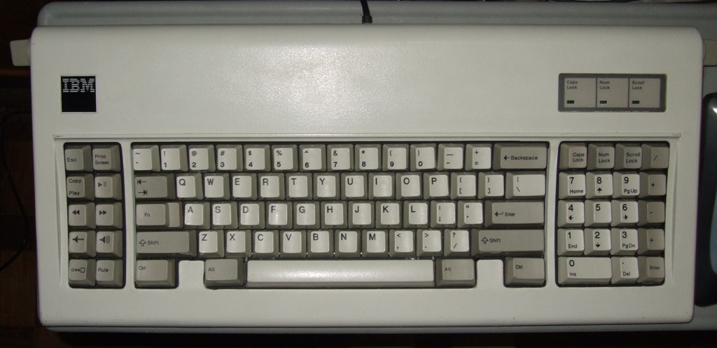

I would argue that the tenkey on the XT is almost unusable. A triple-high plus !? And remember that the XT only has 83 barrels. The AT had extra barrels because it was the first to use these as stabilizers. That said, it would be possible to put a proper tenkey on the right side, but it would use all of the 20 available barrels, so nothing for the left side block.
Here is a the XT matrix:

Indeed, and of course it's possible to split insert into two keys and have a tenkeyless style layout.
Soarer wrote:TBH I'm not sure it's fair on the XT, either, but it's got no modding potential otherwise, unlike the AT.
wcass wrote:I would argue that the tenkey on the XT is almost unusable. A triple-high plus !? And remember that the XT only has 83 barrels. The AT had extra barrels because it was the first to use these as stabilizers. That said, it would be possible to put a proper tenkey on the right side, but it would use all of the 20 available barrels, so nothing for the left side block.
The XT's numpad layout is quirky, but certainly not unusable! I know a few people have used my converter on them, so I hope at least some of those are actually being used. There is something pure about using old keyboards 'as is' that I appreciate.

wcass wrote:... the type of capacitor formed by the pads is polar - serving the same purpose as the diodes in conductive switches.
I don't think it's polar - it doesn't need to be. When the switch is closed, the capacitance is lowered which when strobed increases the rate of change of voltage at the sensing side, hence increasing the voltage sensed at a given time after the strobe above some threshold in the sensing circuit. Any other path to the sensing would have to go through multiple switches, but the switches in other columns have their strobe lines grounded which I guess quells the signal.
