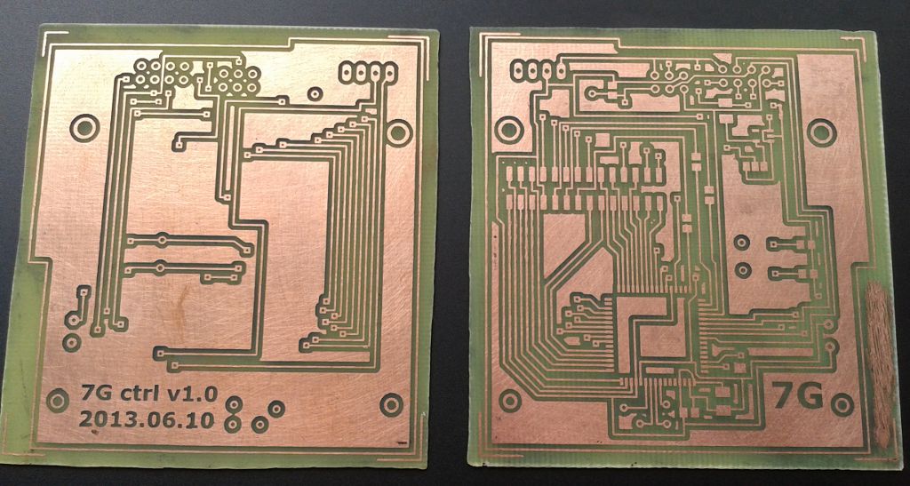

I have etched the two sides of my PCB last night. I set the iron too hot, so I had some toner smudging, but nothing serious - there doesn't seem to be any broken or connected traces.
I build double sided PCBs from two separate 0.8mm single sided PCBs. I sand them down to the alignment markers I have placed on the PCB graphic and glue them together with super glue. I use the gel variety of super glue so I have time to align the two PCBs before they stick permanently - the liquid super glue works too fast. This method takes a little longer than using double-sided 1.6mm PCB but it's much more reliable and there are hardly any problems with alignment.
7G controller PCB v1.0

I finished the PCB, soldered everything and realized I made a mistake. I swapped the upper and lower rows of the keyboard PCB connector. :cry: :oops: I will have to update the wiki with the correct pinout.
The good news is that the positions of the connector and the holes are spot on. It fits even better than the original controller. :D
So I have to design and build a new PCB. Btw, this is why I like making etched PCB prototypes. At least I didn't f**k up a whole batch of factory made PCBs that took a month to get to me from China.

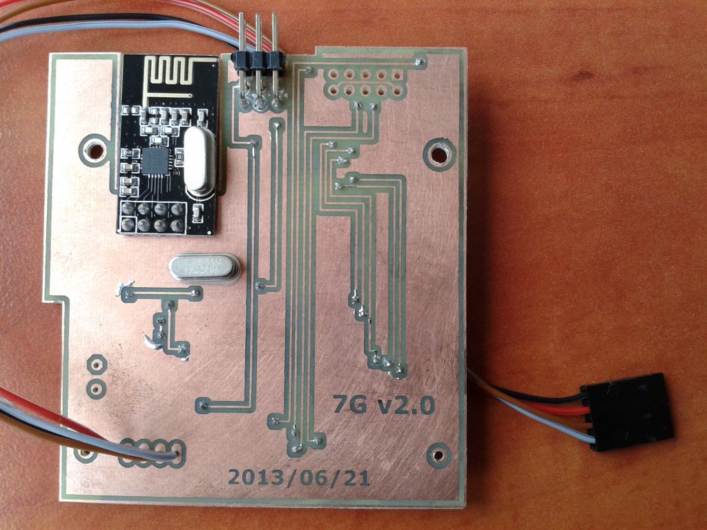

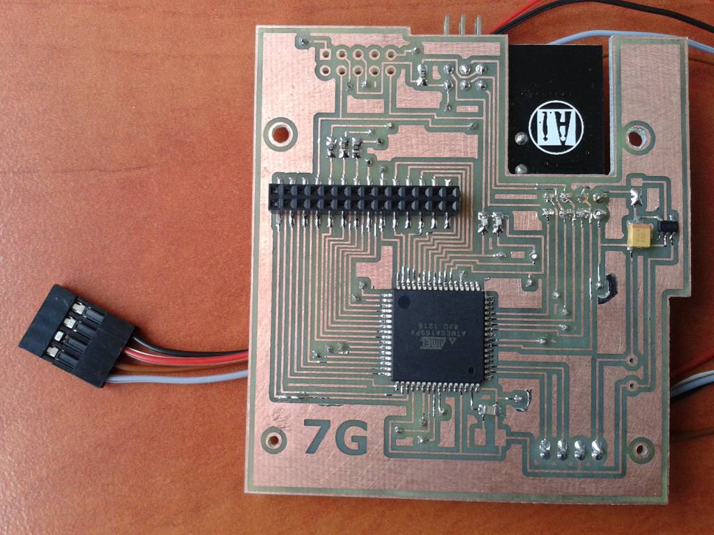

The new PCB is working! I have left a hole on the part of the PCB underneath the nRF antenna. The cable on the picture is a UART connector I use for debugging.
So far, the keyboard matrix scan and the RF data transfer are working (I tested it with a ATmega644p dev board on the receiver side). I haven't started doing the USB or the low power optimizations yet.
I think I might change my mind about tmk_keyboard and just do a minimal firmware with only the things I actually need (the SS/RWin key swap). I doubt anyone other than me will build or even need this. Although I might do an interest check to see if I'm wrong.
It looks like this controller will not be compatible with the 6G v2. Judging from the pictures I found here http://blog.gaingame.com/2010/09/14/ste ... rd-review/ the 6G has all the electronics integrated into one single-sided PCB. Bummer...
bottom side
bottom side
My 7G controller top side

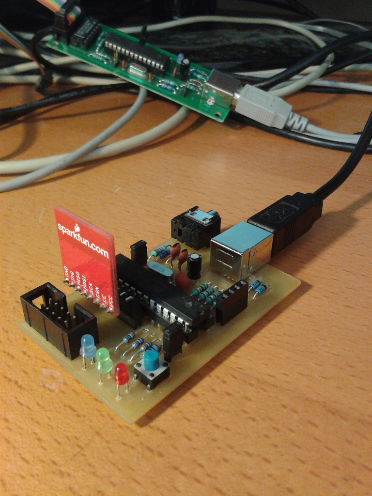

I've had another change in my plans. I decided to ditch the ATmega32u4 for the receiver and just use a circuit I built a while ago which already has a header for the sparkfun nRF24L01+ breakout, an ATmega88 and a USB connection wired to work with the obdev's V-USB driver. And things seem to work just fine. It's too big for an actual dongle, but it's great for testing and developing.
I still haven't made any low power optimizations on the AVR or the radio, but that is the next step. I just read the relevant parts of the AVR docs about low power, and I'm about to start playing with it. The problem is that I don't have any tools to measure current consumption in the less than 1mA range, which is what the circuit should draw on average if everything is configured to consume as less as possible. I think I can fix this by charging a large capacitor and then running the circuit from the power stored in the cap. I won't be able to tell exactly how much current the circuit is drawing, but I will be able to tell how long it will run on a fully chaged capacitor. And that way I will be able to tell if any change in the configuration is drawing more or less current.

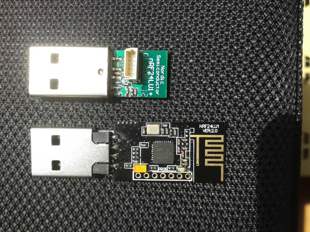

I ordered two different nRF24LU1+ dongles from ebay. Man, these things are tiny. I plugged one of them in and my PC recognized it as a "Nordic Semiconductor nRFready Basic Remote Dongle". It turns out, these already have a wireless QWERTY keyboard firmware on them and in theory I would only have to know the protocol and send the data in the format that the dongle expects to have a working system without any need to program the dongle. But there's a catch. To get the documentation about the protocol it looks like I have to buy the entire development suite http://www.nordicsemi.com/eng/Products/ ... art-Remote . So, that's out of the question.
I also found the nRFgo-SDK which is a collection of C source code for the nRF24LU1+ and nRF24LE1. These contain the source code for the Gazell protocol stack which allows very robust RF connections. At first glance the code looks quite portable. I wonder if I can port it to AVRs.
The V-USB receiver with the sparkfun nRF24L01+ breakout
The nRF24LU1+ dongles

I was quite busy these last two months, so I haven't done a lot of work on the nRF24LU1+. But I've finished the paying project I was working on, so now I'm free to get back to the dongle. I've built an nRF24xx programmer which I plan to use to port the dongle code from AVR to nRF 8051. Here's the programmer circuit and source:
https://code.google.com/p/nrfburn/
The two nRF24LU1+ dongles I have seem to be useless. They don't have the RESET pin brought out, which seems to be necessary for a correct programming sequence. Actually I'm quite sure I've destroyed them by not resetting them before and after flashing. So I've ordered a SparkFun nRF24LU1+ breakout which has a RESET, and I will continue when I receive it in about two weeks.
