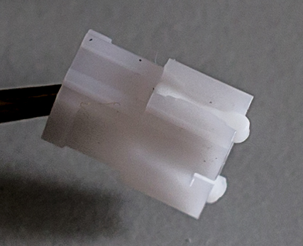

Took some pics of the mod as well.
Top cover removed.
Screws that holds the plate and PCB together.
Plate removed.
Dental rubberbands on the sliders. They are so cute. :)
Some more pics that does not really matter but might be fun to look at.

It was really easy, did not use anything else then a small screwdriver to make this mod.
I did not experience any problems at all.
The feeling is just the same, I don't feel any difference at all except the lower sound.

FYI, to get the sliders off I used a small scredriver and pulled them off through the plate. It went pretty easy. And on the keys with stabilizers I just unhooked the stabilizer from the sliders and they went off really easy after that.

Today I finished the silence mod to my HHKB PRO 2 and I couldn't be happier. The size of the rubberbands is just perfect and it's really easy to put them on.
It took me around a couple of hours and I had to cut the bump on the sliders in order to take them off but it didn't affect the switch so there is no problem for doing it. I also took off some of the lube that was in the stabilizers because they made some rattle noise and after I finish the mod the spacebar is now super quiet and sounds fantastic with a deep "tock" instead of "cha".
I was planning to sell the keyboard because it didn't feel nice at all with the noise of rattling modifiers and that crispy sound but now I'm convinced to keep it :P
