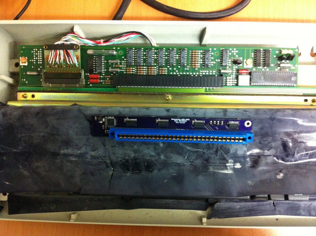

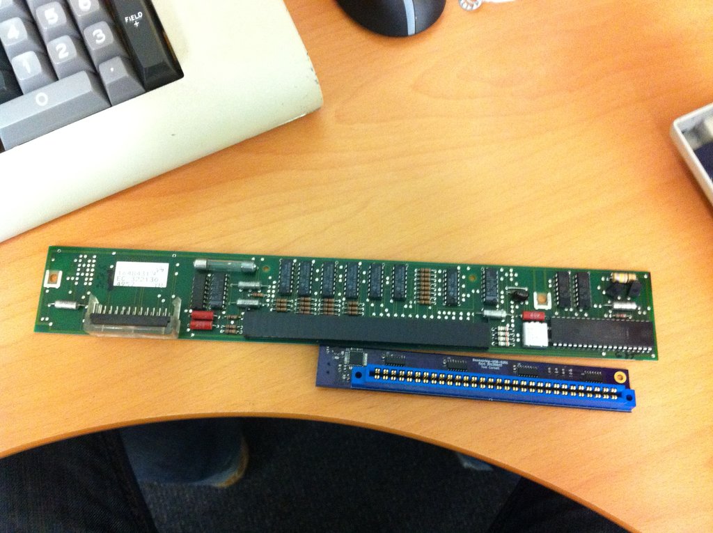

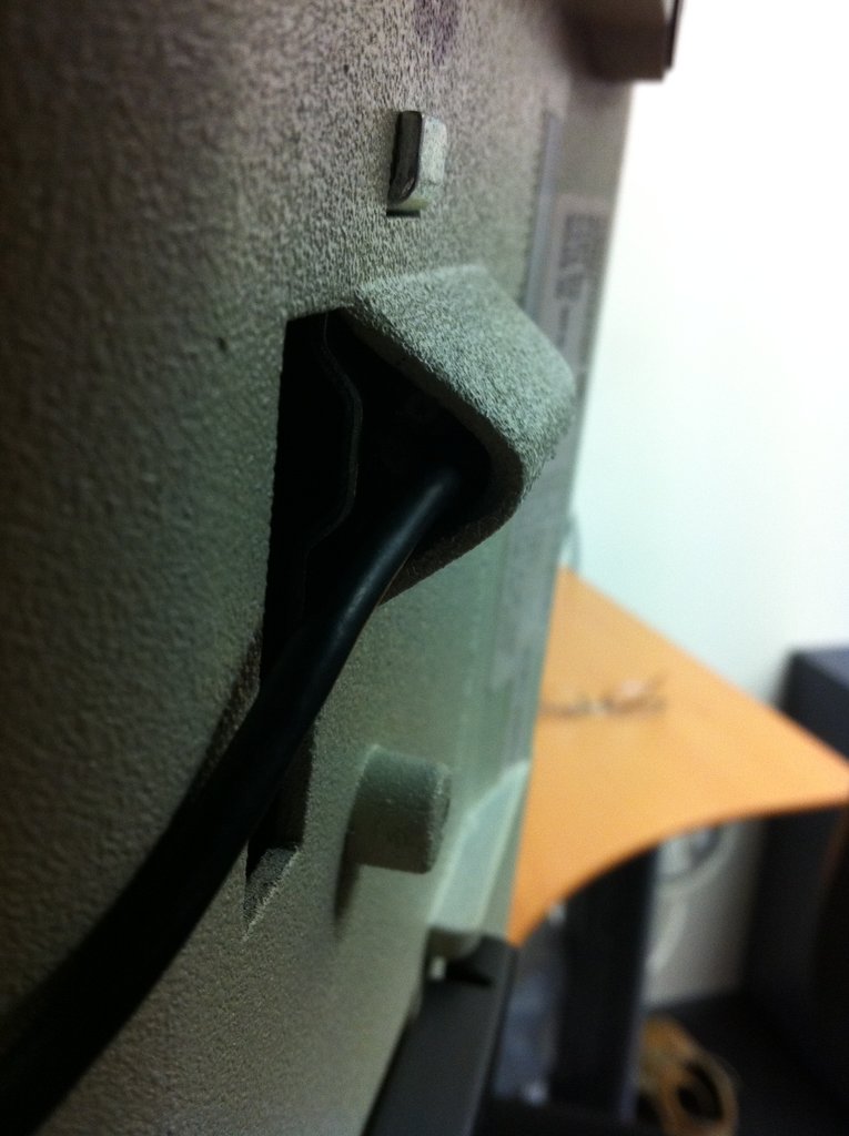

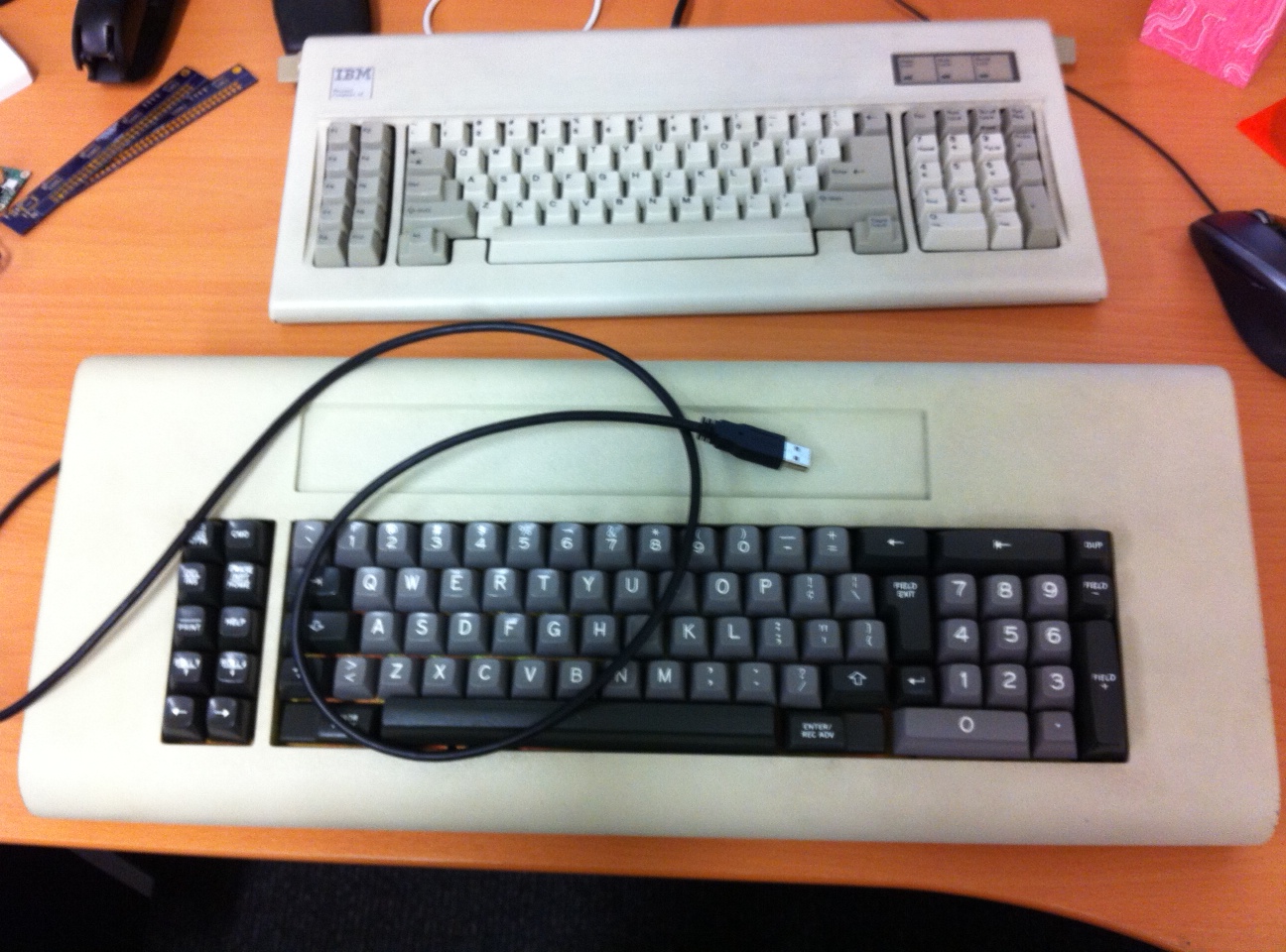

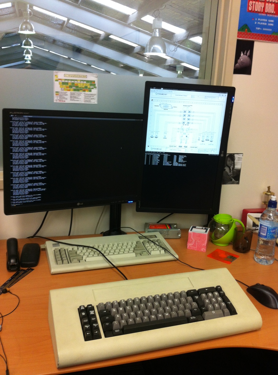

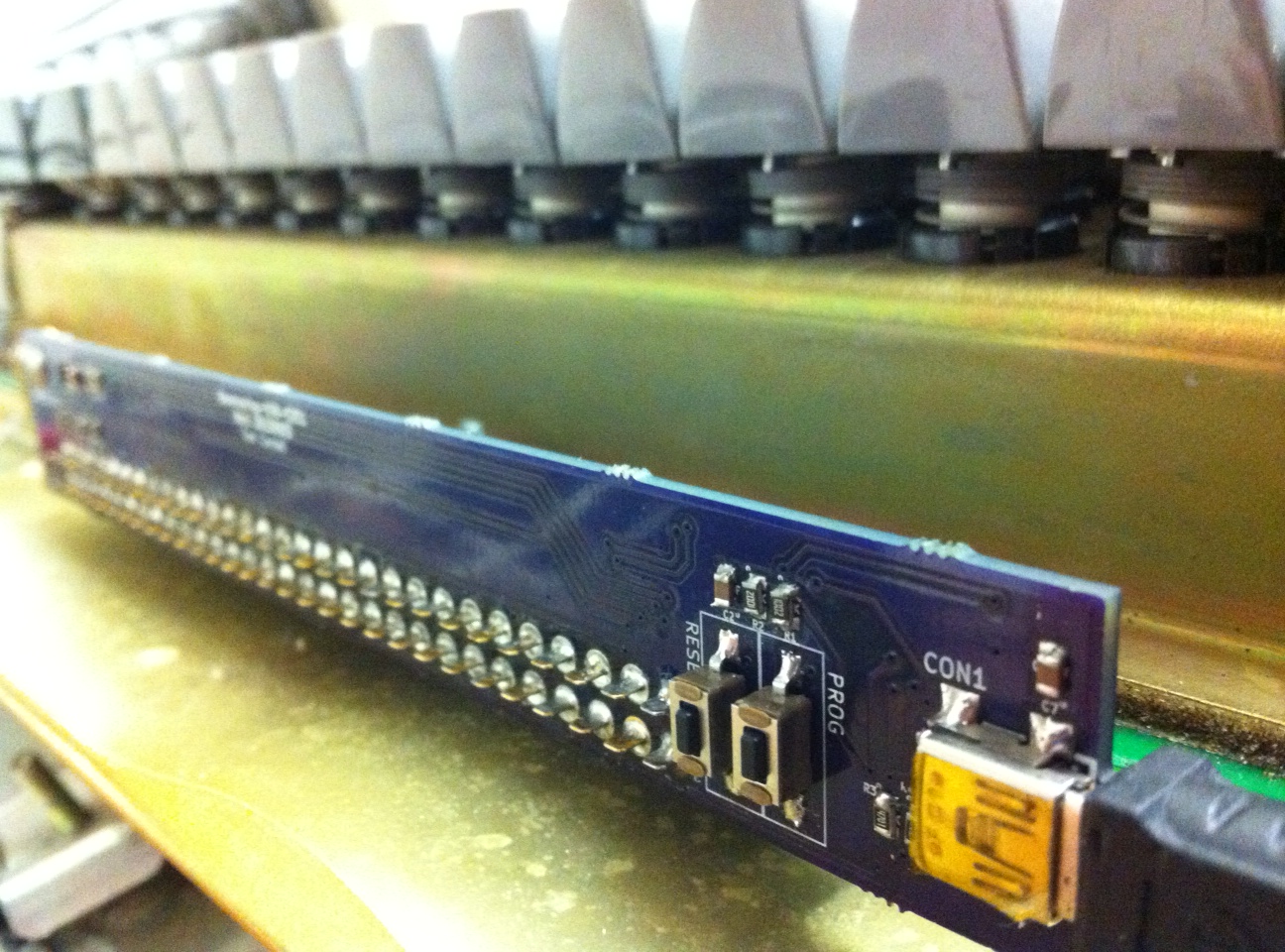

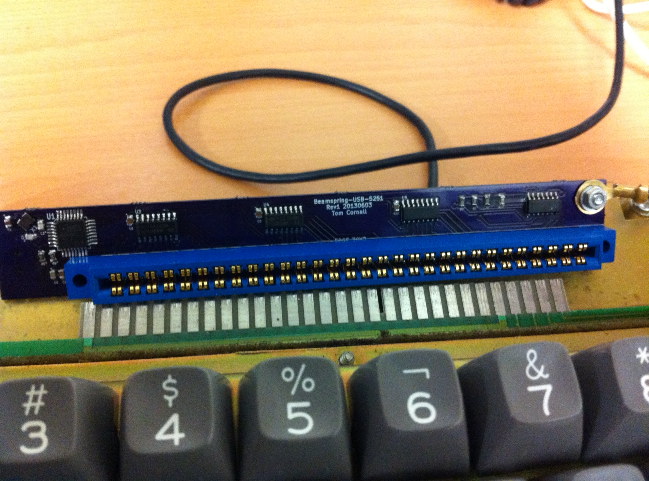

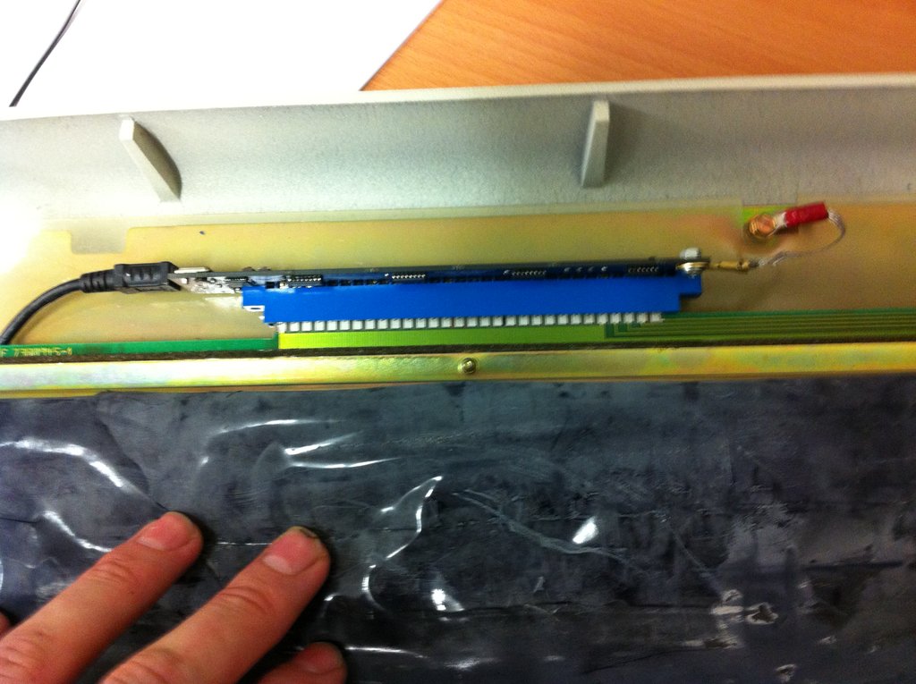

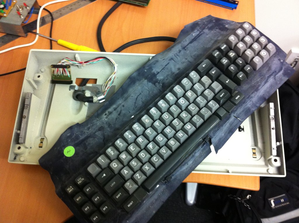

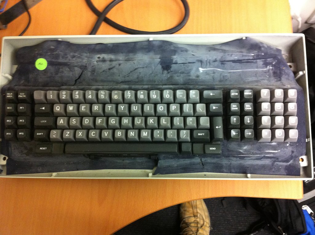

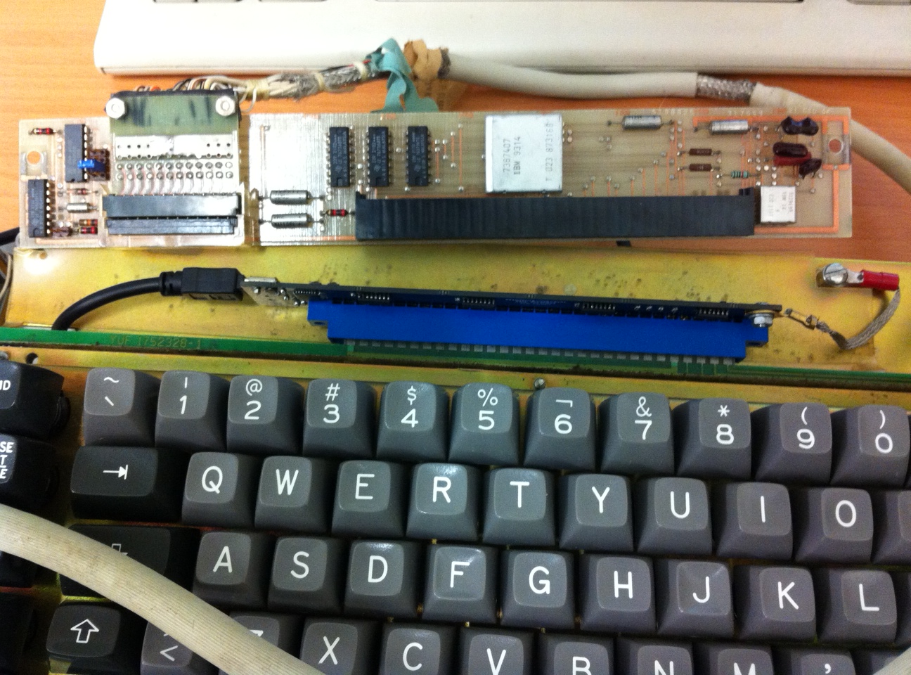

I've finally got around to converting one of my beamspring boards (a 5251) to USB. Attached is some pictures and the schematic. Once I've finished the firmware (it needs an autocalibration routine for Vref, and an additional HID `debug' channel for rebooting it into USB DFU programming mode, and manually setting Vref and reading raw matrix, maybe a scancode programming mode) I will upload everything including the Kicad project and gerbers onto Github or somewhere.
As OSHPark gives you three PCBs minimum, I will shortly assemble another controller for my other Beamspring (also 5251-based, except based on the 3270 layout, I think it's a 3277? That means I have one PCB left over for now. Anybody with a 5251-based beamspring who wants USB?

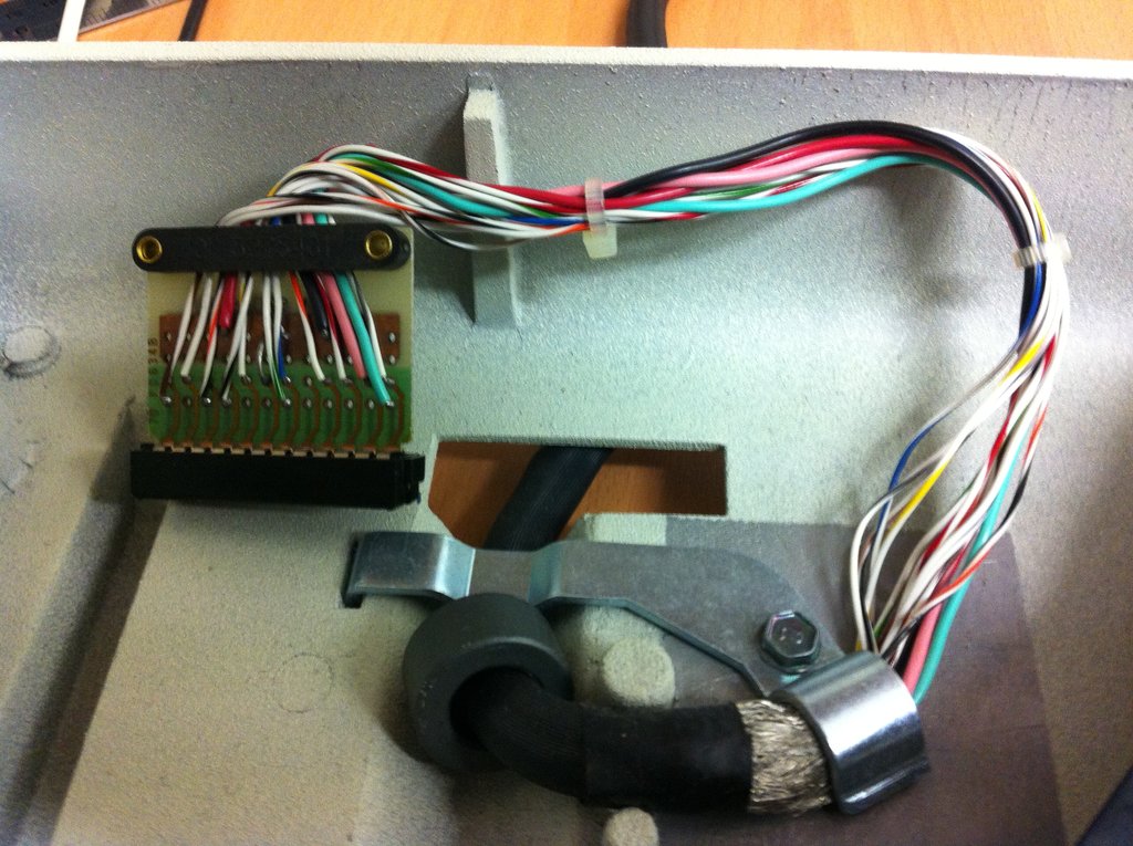

I think it will need work for the 3270-style beamsprings (with the cases that step down at the back) as due to the connector I used the PCB is vertically mounted, which could prove difficult despite it being pretty short (about 22mm high I think). Also, non 5251-style layouts might have a different connector pinout (pin 1=GND, followed by 23 columns except pin 16=NC, pin 26=GND, followed by four rows). If anybody with a different beamspring board can answer these questions and is interested in a USB controller I would be keen to work with them.
Back: Compared with original controller: Connector details: Reassembled: A little bit short on desk-space now. Also need a higher chair. Currently 890Hz scan rate or so, with a incrementing/decrementing counter for debounce (yes there still is bounce on a capacitive board). min=0, max=5, <=2 is unpressed, >2 is pressed. This means absolute max of 3ms for key delay, which I believe compares favourably with most modern Cherry boards (if sticking to the rather long recommended 5ms debounce) Row drive for two consecutive columns, space inbetween to allow caps to drain: Blue trace is column sense, about 100mV. Key (L Shift) is currently unpressed: As above, except the key is now pressed:

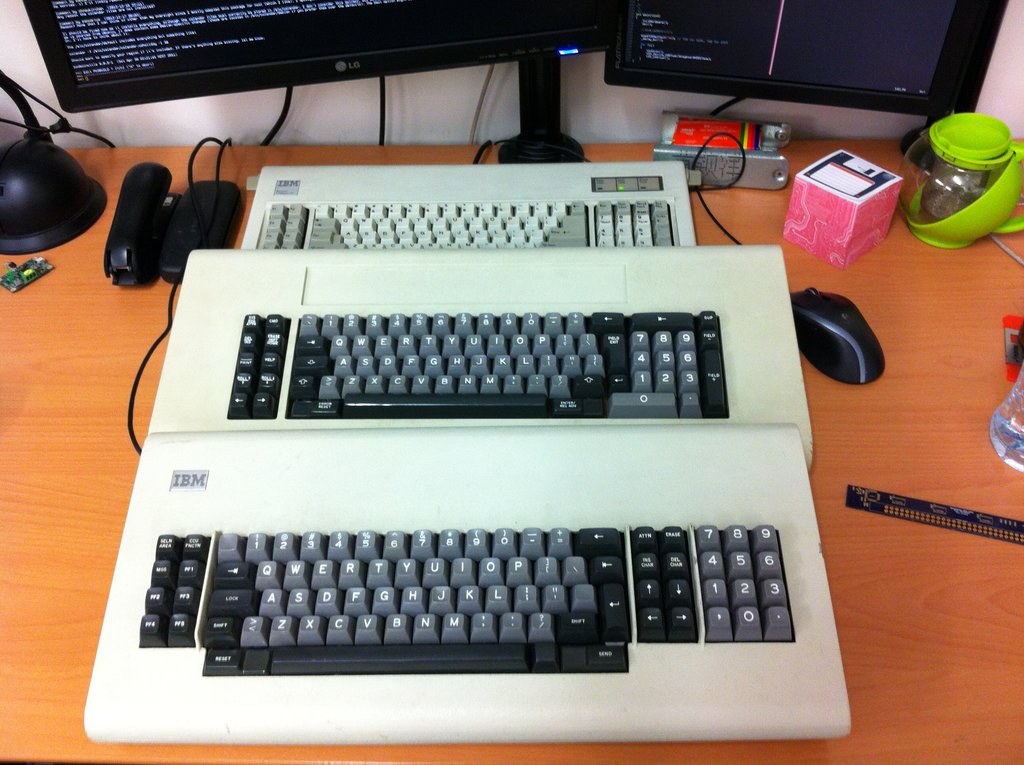

Isn't most of the case filled with air? It looks wider than the F AT, but isn't the mechanism about the same width?
A 60% would still take considerable space with wide keys like that.

Webwit don't you have a 3278? How far did you strip it down? Similar connector/pinout? You reckon a skinny board like the above would fit in the stepped-down case like that?

Pics here of strip down:
http://webwit.nl/input/ibm_beam_spring/

Looks promising... seems to be similar pinout etc. as far as I can see (four columns at far right). Height would have to be measured. In the worse case could make the straight-pin edge connector I used into a right-angle connector with an adapter board.

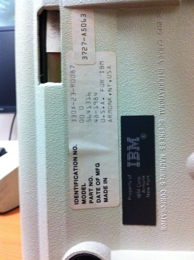

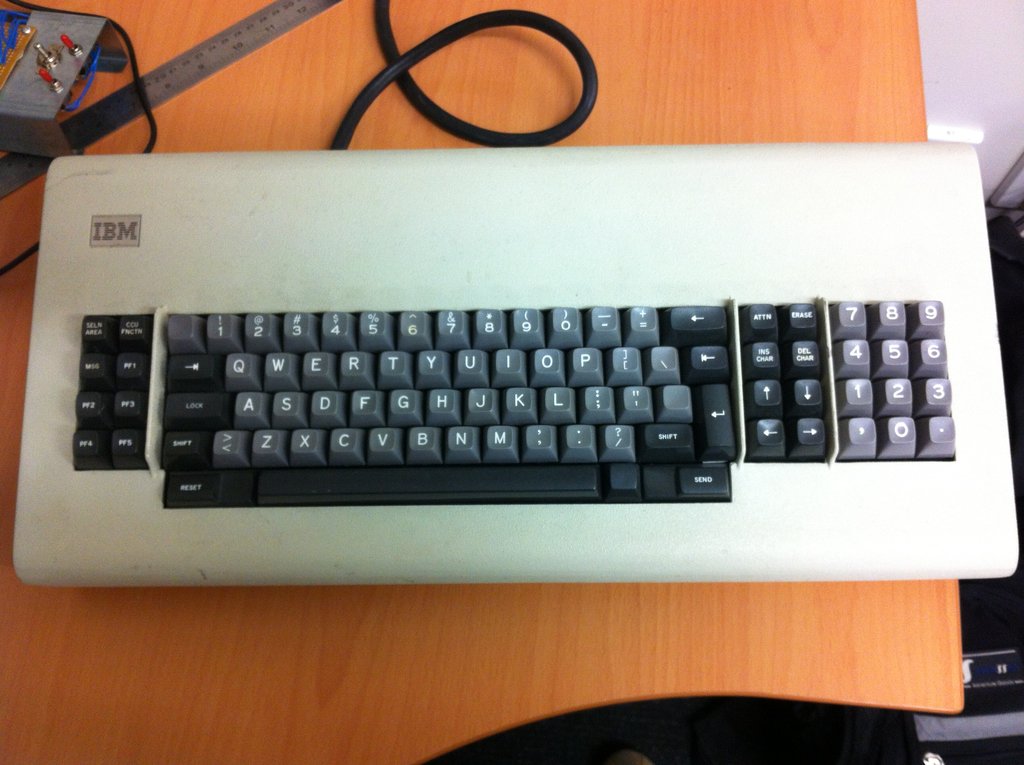

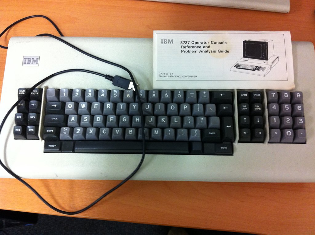

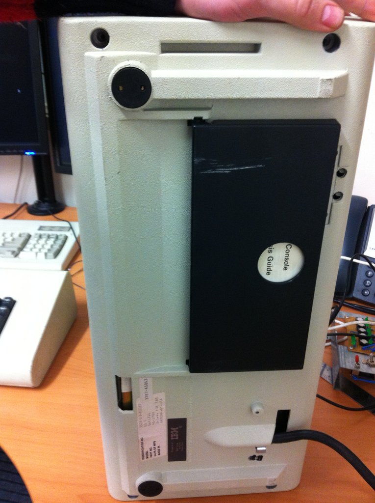

OK assembled another controller today and installed it in my other beam-spring board, a 3727. Went together very easily. Looking forward to using the board for a full day tomorrow (today I got a full day's work done with the 5251 which was novel). Very smooth board, feels very high quality (much nicer than the rattly 5251 board).
Note in the pictures the `Property of IBM Corp. Armonk New York' label. Hope they don't come looking for it!

IBM beam spring 60%:
IBM 3741 Data Station
Space Cadet color style/IBM/60% for the win!
IBM 129 Combination Keyboard

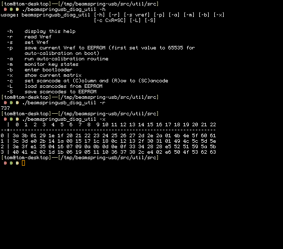

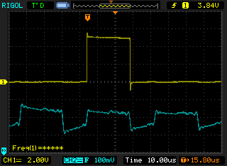

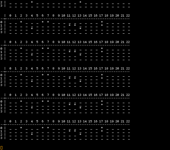

I have the code in a good enough state for release. License is GPLv3. I have auto-calibration for Vref now. Can be overridden in the EEPROM.
Keyboard scancodes are now stored in EEPROM.
An HID diagnostic interface is present that allows changing scancodes on the fly, storing and loading them from EEPROM, along with Vref and monitoring interesting stuff like current key state (independent of what the USB keyboard protocol is saying). BTW I have full NKRO on the board itself---you can hold down all the keys if you like---although I'm only sending 6 over USB as I don't have a great use for NKRO so haven't bothered to `scratch that itch' yet.
There is only a command-line tool for interfacing with the HID interface. Hopefully I will be able to write a Qt GUI app at some point when I get time.

Yes it would work, as long as it has that 30-pin connector with the same pinout (the other 3278 boards I'm seeing seem to have it, so I think it is likely).
In fact you'd probably use the same scancode matrix layout as a `US'-layout 3278 (or, say, my 3727), as with USB keyboards, they still send the character code for `Y', but the OS (whether Windows or Linux or whatever) knows that you have a German keyboard layout selected so intreprets the `Y' as a `Z'.

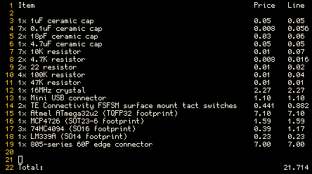

As far as I can see there are three ways to get a controller:
Second option is also fun but you might be able to get the bits cheaper (I'm in New Zealand) if you take the first option. You also have to wait for it to be shipped from NZ, which might be a couple of weeks.
Third option gets you something that works (and has been tested on either my 5251 or 3727). It costs a bit more as I'm no pick-and-place machine and I'd really want to test it properly before shipping it out.
Cost breakdown is as follows.
The PCB cost is $USD9.12 from OSH Park. My cost for components is $NZD21.714 (see below), which is rougly $USD17. The remaining $USD23 for me to assemble and program/test the board is pretty conservative. I've no particular desire to make a profit on any of this (I don't think there's much of a market for this niche-in-a-niche), and would prefer that as many people as possible with beamsprings had the opportunity to use them (hence open-source), however I can't give my time away entirely.
This controller will all be a bit more compelling in a few weeks when I've had enough time to write a more user-friendly graphical remapping/diagnostic program. If people do want either option 2 or 3 from me, let me know either on here or through my email, [email protected].
- Use the schematics/PCB/code released above to make your own, or buy one off somebody who is
- Buy an unsoldered/unprogrammed kit of parts from me and do it yourself (~$27 USD + shipping)
- Buy a fully-assembled/programmed/tested controller from me (~$50 USD + shipping)

If I were to build one, I would avoid the SMD parts. I recon some might be interested in a PCB with the SMD parts soldered to make things far easier.
- Location: NZ
- Main keyboard: IBM 3727 beamspring (converted to USB)
- Main mouse: What's a mouse for?
- Favorite switch: Beamspring
To be honest it's all SMT apart from the edge connector and the ground strap. If I'm going to solder all of the components on apart from that I might as well go the rest of the way and solder on the connector and test it on a keyboard.damorgue wrote:If I were to build one, I would avoid the SMD parts. I recon some might be interested in a PCB with the SMD parts soldered to make things far easier.
This is awesome! Every day I've been staring at my beamspring keyboard, waiting for the day I can actually use it. Now there's real hope!
I'm a bit worried about the way the connector is mounted. On the 3278, the spot where the edge connector is just happens to be the shallowest point on the case - only 4 cm from the bottom of the case to the cover. It looks roughly 2.5 cm from the bottom of the case to the top of the connector, so if that PCB overhang is much more than 1 cm, it might not fit. Isn't there an edge connector that mounts sideways? (like the original board)

Yes please .. Or maybe 2 ...Buy a fully-assembled/programmed/tested controller from me (~$50 USD + shipping)

Hmm, would it work with this 5251 66-key variant?
- bhtooefr
- Location: Newark, OH, USA
- Main keyboard: TEX Shinobi
- Main mouse: TrackPoint IV
- Favorite switch: IBM Selectric (not a switch, I know)
- DT Pro Member: 0056
Pop the cover off, count the pins on the controller/matrix interface.
An 83-key 5251 has 30 pins. (The edge connector being a 60P part would probably be because single-sided edge connectors are hard to find nowadays, and a double-sided one will work just fine.)
