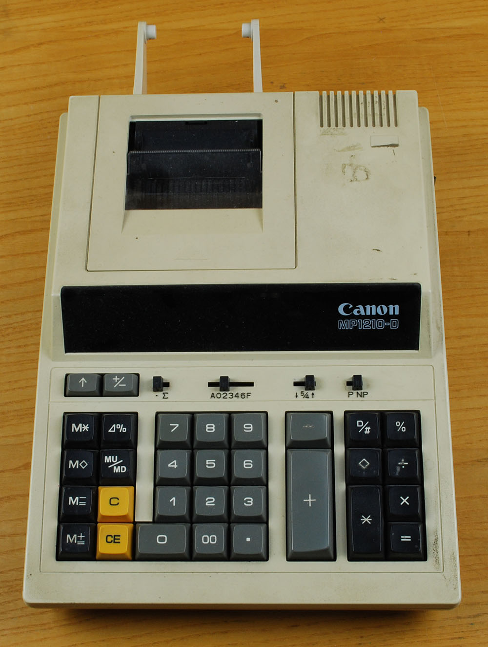

Hey all
I found this old calculator at home. I am guessing these are rubber domes. Can someone confirm this. Keycaps are very thick doubleshot.

Why don't you take it apart and have a look ?
These old calculators always have awesome keycaps,
made to last the lifetime of any accountant .

Great caps. Reminds me of many an early 80s board.
The stems say rubber dome to me. What does it feel like? Spongy, and it's very likely a regular dome. But perhaps it's something more interesting. The caps are high end.

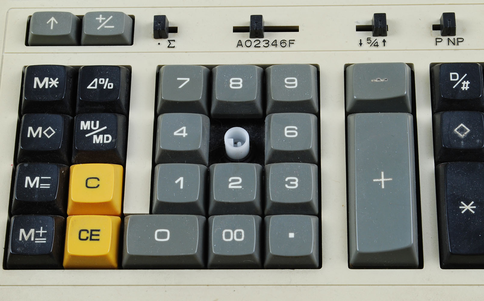

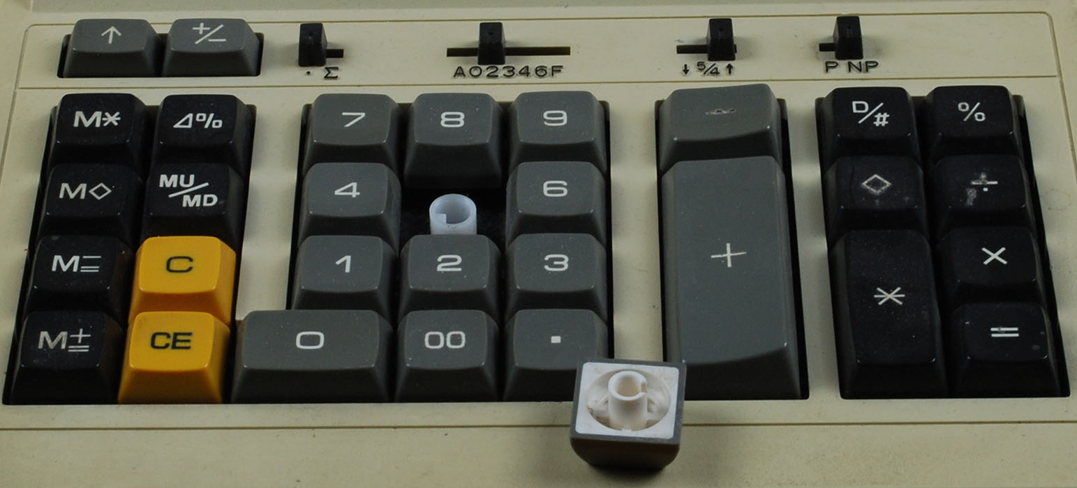

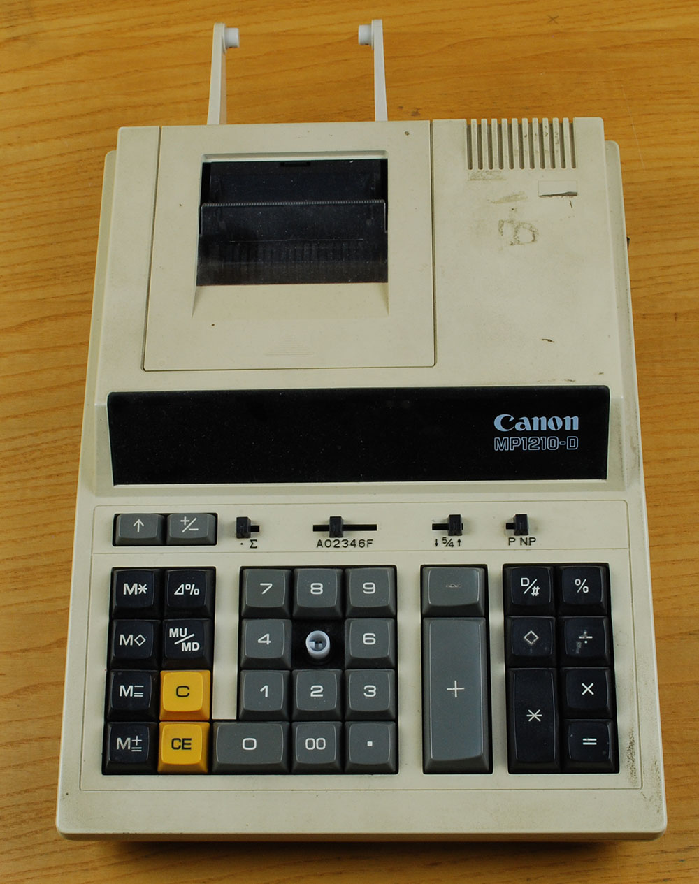

I asked here first if someone knows that switch type. I'll open it up and take few more photos.

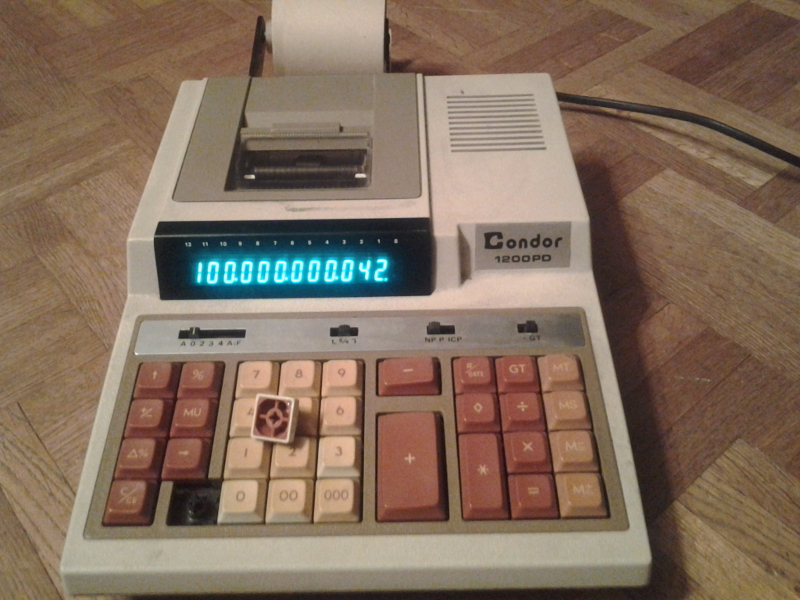

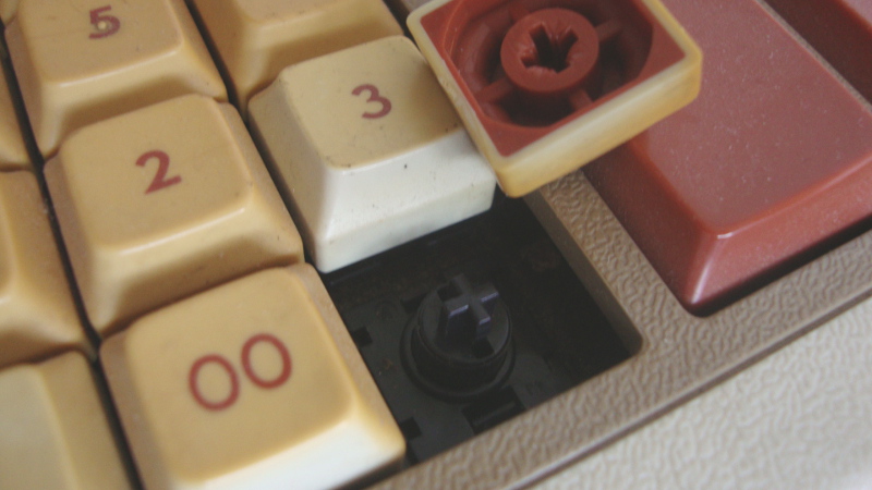

- Daniel Beardsmore
- Main mouse: MS IMO 1.1
Interesting — different coloured spring instead of different coloured slider? That's a new one.
Any obvious difference between them?
I realised afterwards that the yellow dome in my BTC 5149 under the space bar might be a stiffer dome, but I've reassembled the keyboard without thinking to compare them.

I think I have seen those switches and caps on a Silver Reed typewriter (probably still under a mountain of stuff in my apartment block's recycling bin).
The green spring for the space bar looks the same gauge metal and is the same size, but has one less loop. It's slightly more firm.Daniel Beardsmore wrote:Interesting — different coloured spring instead of different coloured slider? That's a new one.

Necro for great justice — most of the switches on this page match the Mitsumi latching switch in a C64, and the C64's slider design also happens to match that Condor 1200PD:
http://deskthority.net/photos-f62/commo ... t8406.html
The difference is that the keyboards on this page all have the spring under the slider, instead of on the outside above the slider.
It would be nice to see if any of the keyboards in this topic can be confirmed as Mitsumi.

Thank you. Turns out it's not Mitsumi at all, or even close: it's [wiki]Alps integrated dome[/wiki].
