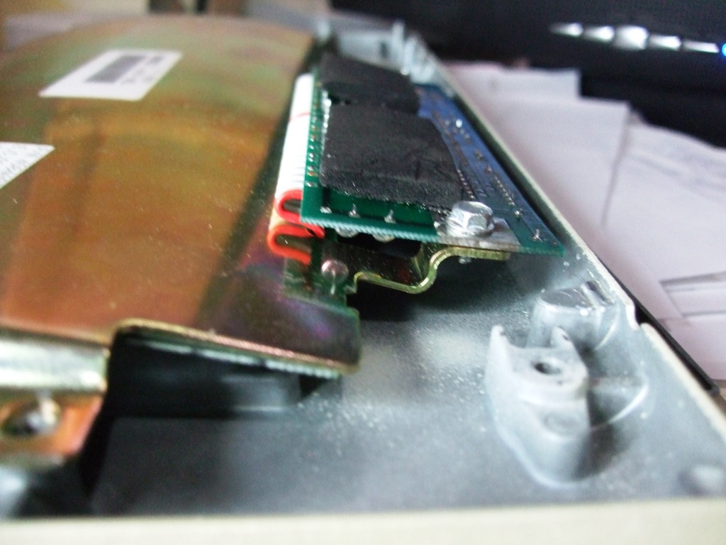

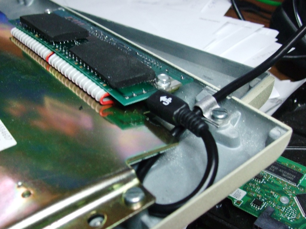

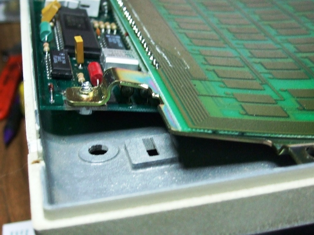

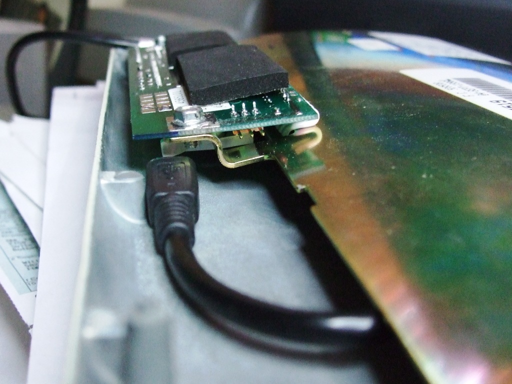

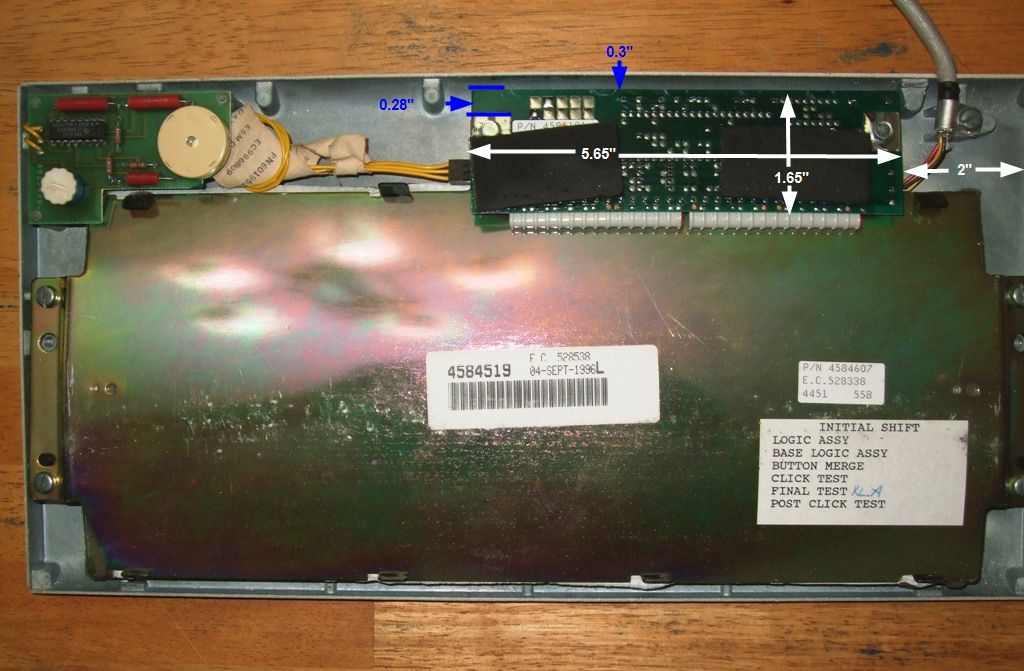

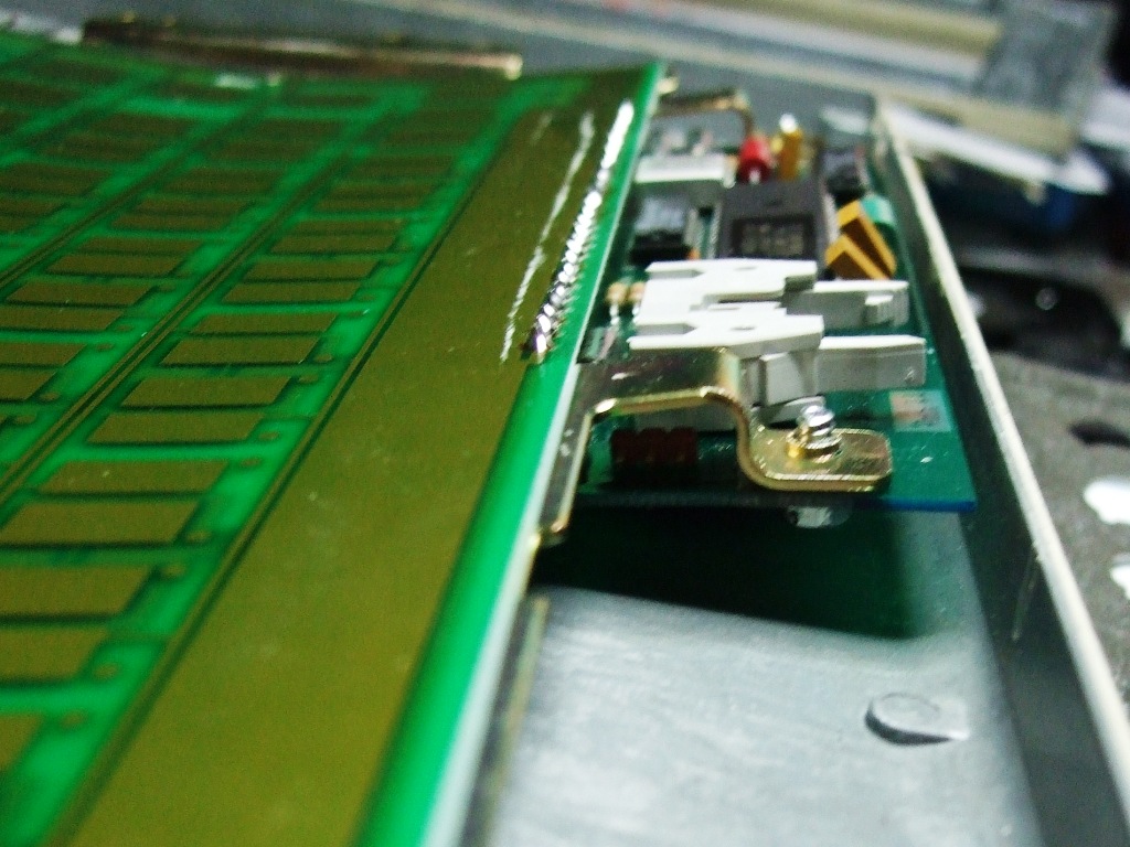

About those keep-out areas, let’s take a look at the original controller in the Kishsaver case. This first picture has the controller and key assembly mounted to the top cover (flipped over). All cables attach to the top side of the PCB (hidden).
bottom marked.JPG (106.58 KiB) Viewed 17275 times
The next pictures are of the right side of the controller (middle of the keyboard). You can see the 3 pin header that goes to the daughter board. The USB cable is thrown in only for size comparison.
top right.JPG (220.8 KiB) Viewed 17275 times
bottom right.JPG (240.26 KiB) Viewed 17275 times
And left side of the controller (left side of case). Again, the USB cable is thrown in only for size comparison.
top left.JPG (222.49 KiB) Viewed 17275 times
bottom left.JPG (186.67 KiB) Viewed 17275 times
bottom left1.JPG (223.22 KiB) Viewed 17275 times
You can see that there is no room for a standard USB cable exiting to the back of the case. It also looks like the sides above the controller mount screws are a bad choice because there is just not enough room for the USB jack. There does appear to be room on the left and right sides below the mount screws on both the top and bottom of the board for a mini or micro USB jack. All of the above is assuming that the USB jack is at the edge of the PCB. An issue with putting the USB jack in the interior is that it would require additional clearance which is not as abundant on the Kishsaver as on other IBM’s. There is slightly more room on the top than on the bottom. There would of course be room for non-traditional USB connections such as direct wire-to-board or double-row bent pin (like the original controller).
