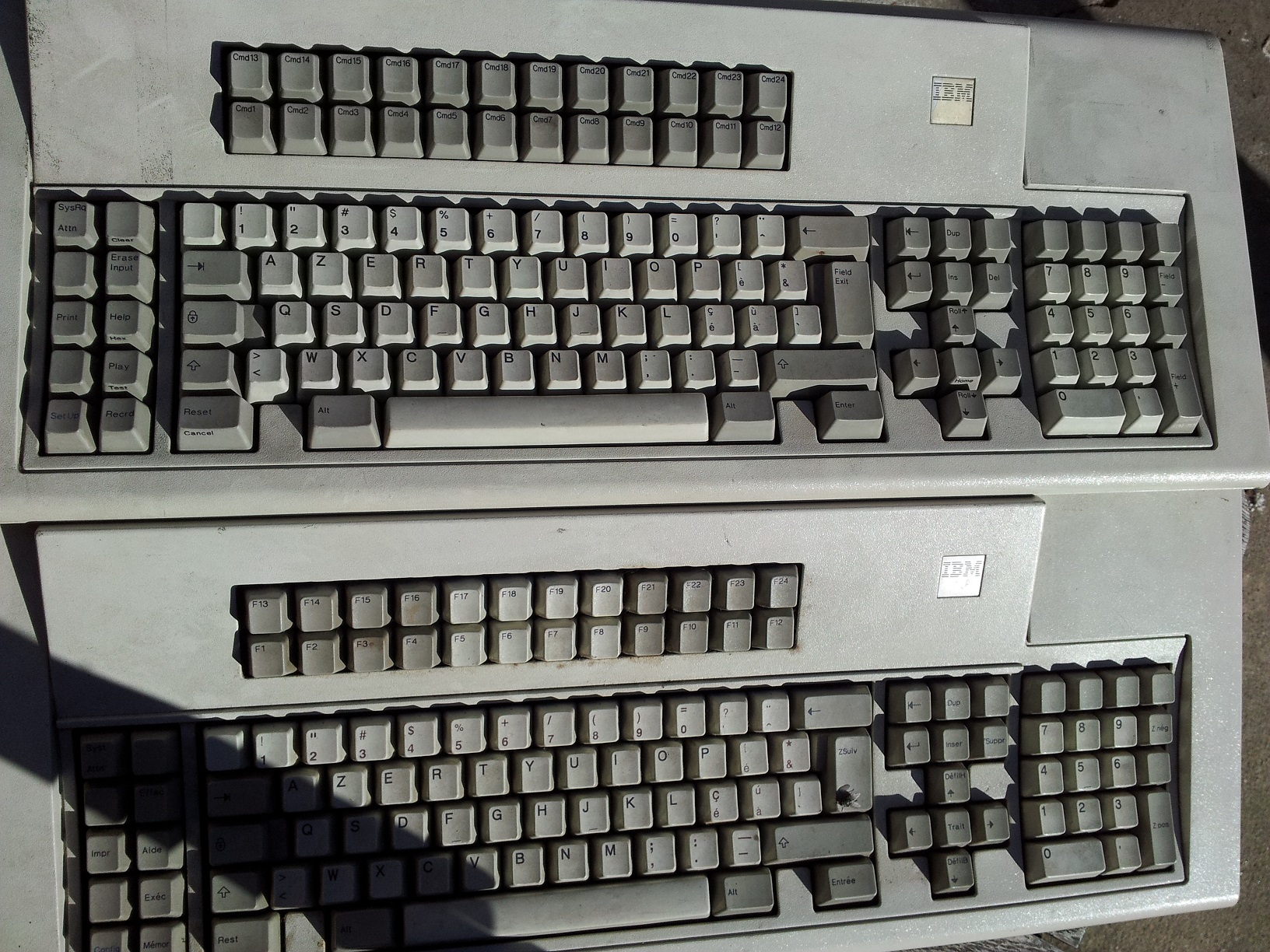

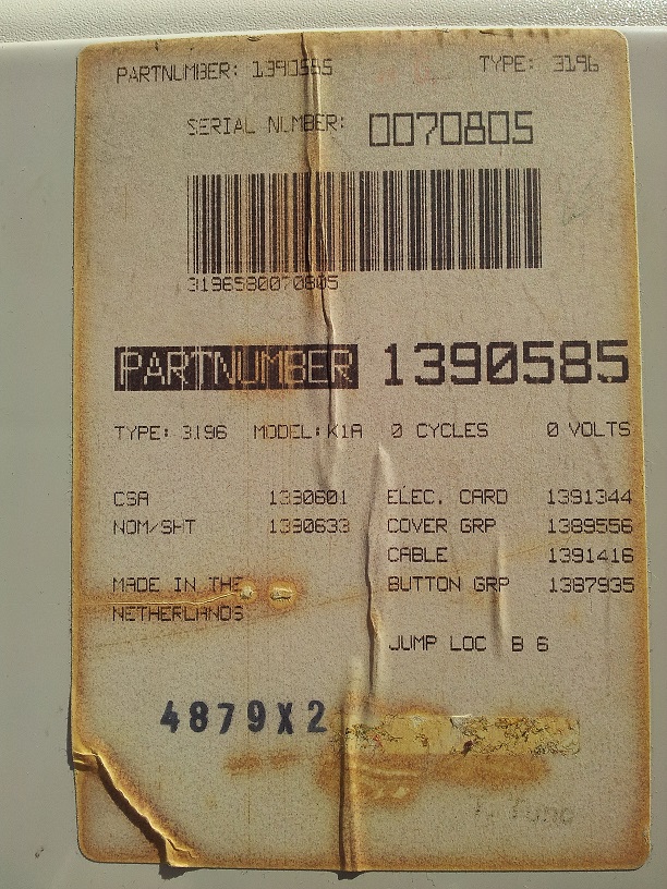

Just found two IBM keyboards few days ago in a friends basement while I was in Bruxelles (Belgium),
they were happy to give them to me when I asked for ;)
My knowledge is far from perfection so I took pictures of them, could someone confirm wich model they are ?
Thanks !

Nice score!
What else do you want to know? They sure look like Model Fs. See how the "top deck" extends further than on my 122 key Model M:
http://deskthority.net/photos-videos-f8 ... ml#p124262

Don't all Fs have black metal backplates? I think OPs should be Ms!
05 May 2014, 14:01
Good point. I don't have a 122 Model F to compare against, but the backs are plastic, quite like my Model M. That's probably a stronger indicator than the length of the upper deck, on the front.

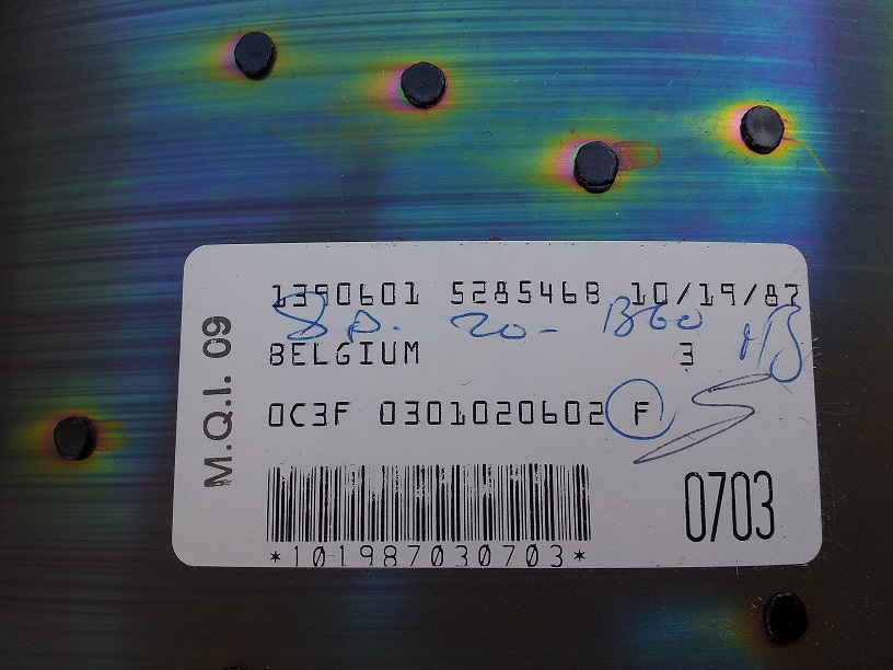

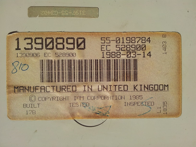

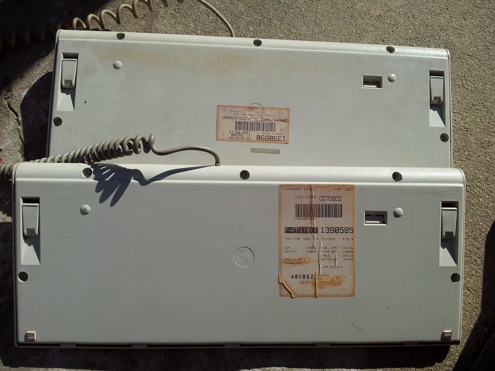

These are early production Model M terminal keyboards. As pointed out above, the Model F ones had black metal backplates. It wasn't until 1987 or so that the ones with oval labels appeared (and the square labels continued in production for longer due while the associated terminals were still manufactured)
The non standard labels on the back of one indicates that it was probably serviced/refurbished by a third party.

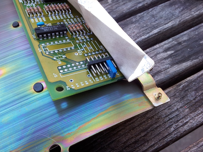

13 May 2014, 20:36
Just open the one branded from netherlands to clean the inside
this is on back side of the metal plate
and I noticed that there are unconnected pins on the controler, their position corresponding to this closed aperture on the plastic back plate
would it be possible to connect an RJ45 to these and so avoid this DIN 5 female connector to set up..?
13 May 2014, 21:07
Nope. I seriously doubt it. But you are onto something, just a minute…
There's nothing magic about RJ45. You don't get to plug these straight into network ports! All the different connectors supported by Soarer's Converter (DIN, Mini-DIN & RJ45) are simply four wires: ground, +5V, clock and data. They all hook up to a Teensy the same way in the end.
Now a Teensy is a tiny thing (about the size of a pretty small USB memory stick) and you can install it inside the keyboard case if you like. Then you just hook it up to the controller PCB directly, to the four contacts where the original cable hooks up.
Just make sure to test which contact is which *before* you remove the original cable. A Teensy costs $16 and can die if you get that wrong. (There are cheaper alternatives, too, but I don't know how to set those up. Still looking into it.)
