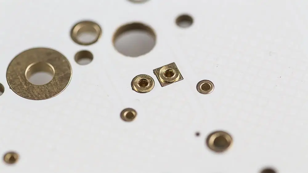

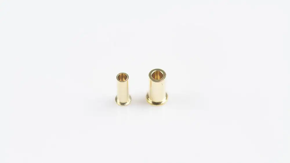

These "hot swap"receptacle for key switches are engineered to maintain reliable contact for the connection to function, given when properly installed on the PCB. Currently there are three variations of such parts:
1. TaoBao Receptacles (offered also by KBDfans on Aliexpress):
That fit larger PCB holes and require soldering.
2. Holtite Receptacles (offered by many sources such as Digikey or Mouser):
Some builders claim that installation of these does not require soldering.

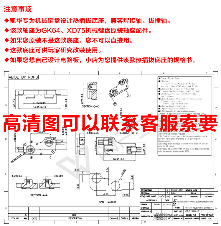

3. Kailh has recently made its new Receptacles available (seen on TaoBao):
It seems to me that Kailh's design is the most sturdy one with plastic protecting the receptacles.

I suppose that they could be using "Holtite sockets". Holtite sockets I have bought from Mehkee fit well into the standard ErgoDox PCB.
Kailh's socket would require new PCBs but they would probably give a better connection. I know some Cherry MX clone switches (such as Outemu) have thinner pins than others and might not get a reliable connection inserted into the regular Holtites.

From the pictures currently on their website, it clearly looks like Kailh's design, with an updated PCB.
