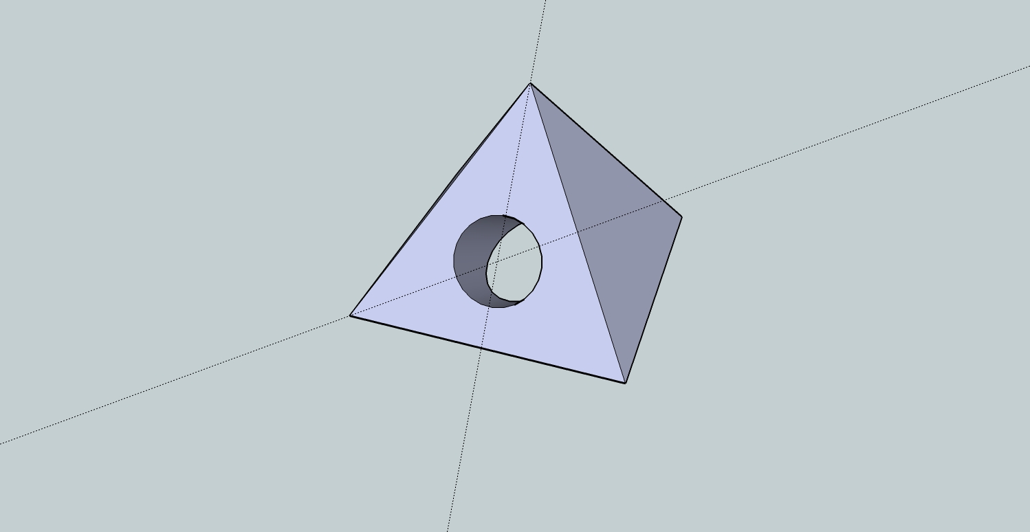

Try push/pulling a hole in a pyramid. You will end up with a mess on the other side because of the different face angle.... Can't seem to find a solution for this....
Posted: 26 Aug 2013, 21:12
by tlt
Like this?

tlt wrote:Like this?
No.... Make a hole from one of the sides.... :-)
Posted: 26 Aug 2013, 22:01
by Mrinterface
tlt wrote: Edit: that does not actually work. But I made a cylinder and put it where I wanted the hole and than right clicked the surface and chose the "intersect with model" option this gets me edges on the right paces so that I can remove the necessary surfaces.
Yes, that's how I finally ended up trying it. But somehow I could not get it done properly, it just did not intersect properly. Plus I got un-closed faces due to non-orthogonal edges.

by tlt
Yeah, it's easier to make a simple example than to fix a complicated model. When it starts to go sideways I often start from scratch for a par or the whole thing. That's often faster when you have figured out a good solution.
Something like this?
redraw edges and split the un-closed surface might work.
