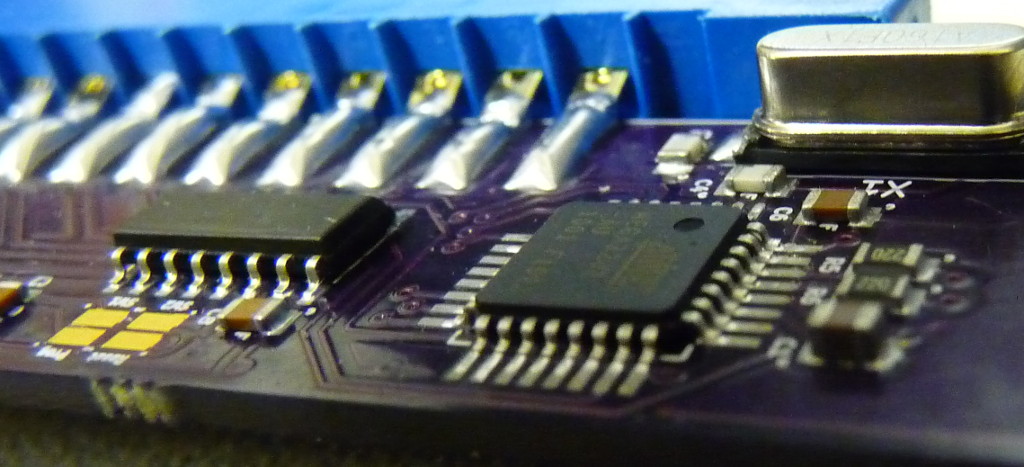

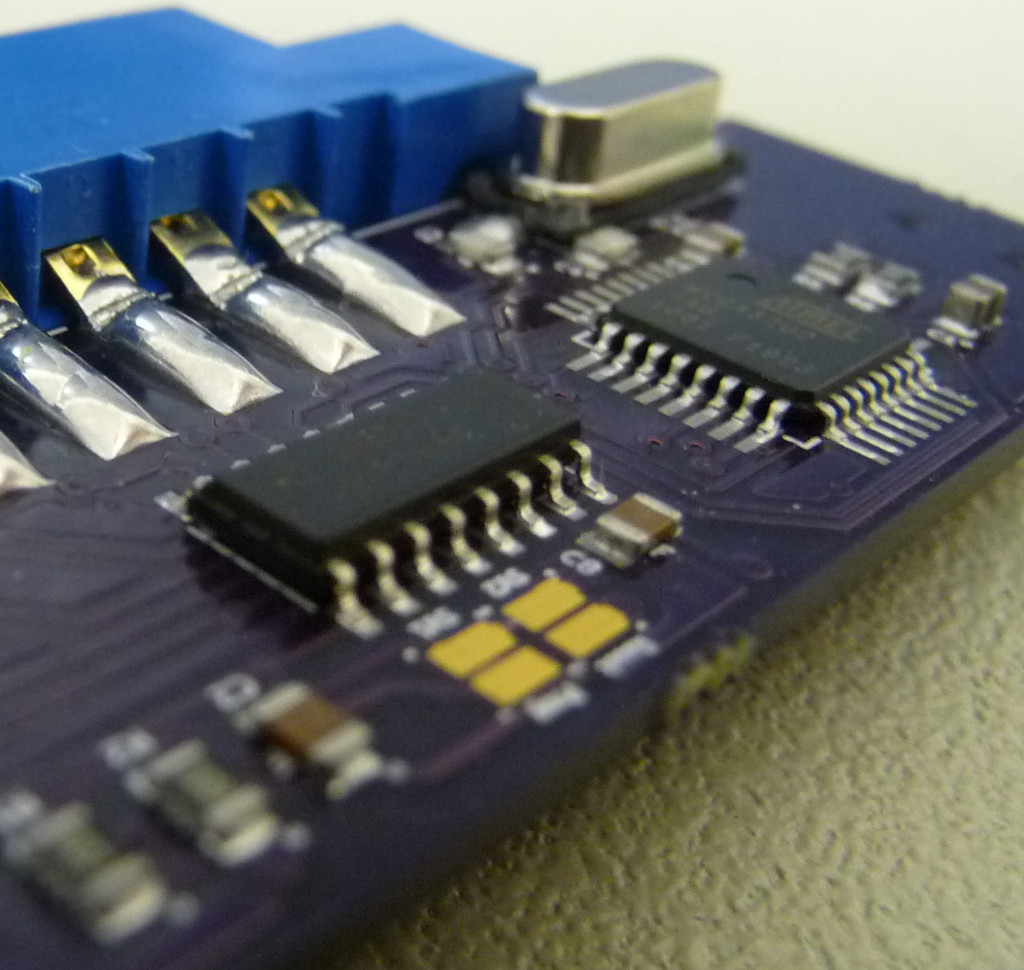

Ah yes and I thought I'd show off my first reflowed board. All the 0805s straight and flat, nice heel and fillet, all the things I wish I could do when soldering by hand! I think on the next redesign I might have to make a move to a board with all the components on one side so I don't have to do double-sided reflow (i.e. reflow one side, then flip it upside down for the other side and hope the surface tension of the molten solder is enough to hold the components on against gravity—this actually works to my amazement!).
Apologies for crap photos, work point-and-shoot has no macro mode and my M3 only focuses down to 1 metre lol (never mind the Tri-X grain being a similar size to the 0805s :) ).
