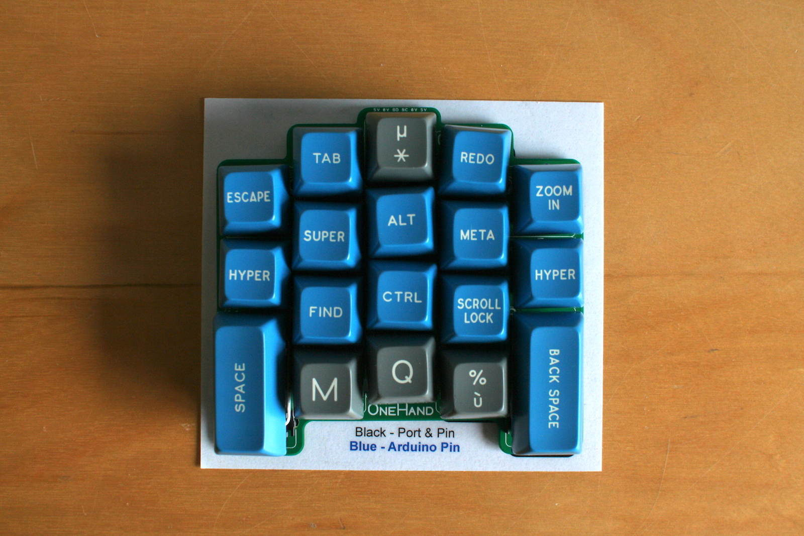

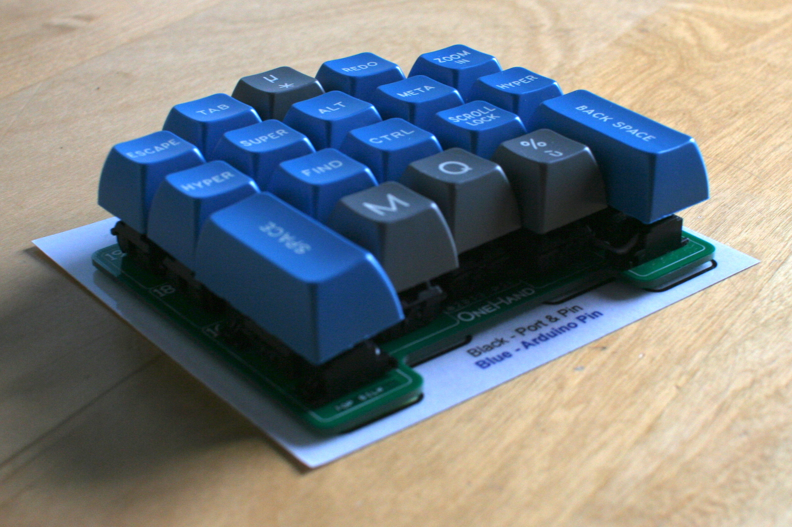

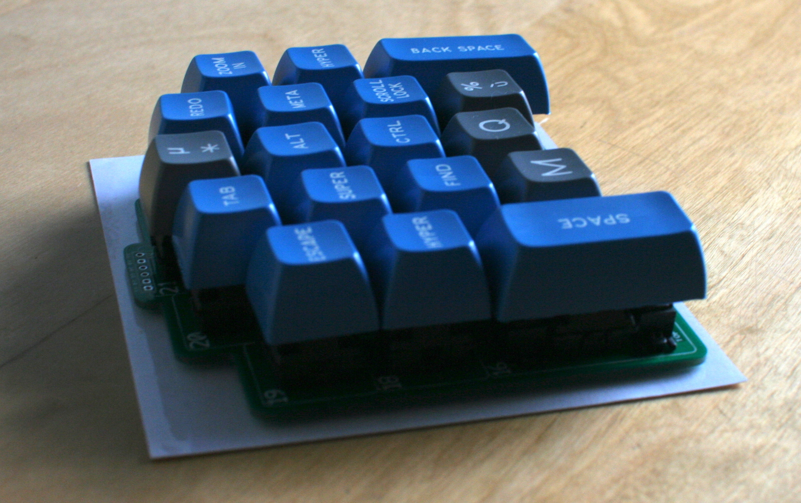

As for SA profile caps, here's my OneHand (still not soldered so a little wonky looking) with uniform profile row 3 SA caps on it instead:
Vierax is right about the profiles I used in my earlier picture. I can't really vouch for how they feel (as the keyboard's quite topsy turvy waiting on assembly) but I'd guess the "right" rows would feel better. They certainly have the look.
Doubleshots like these are no good at letting light through. (And none of Round 5 has LED windows.) This is what they look like when backlit:

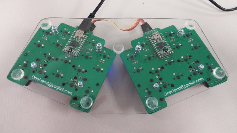

Things are taking a little longer than expected...
The second keyboard sends I2C messages to the main unit using the following binary encoding:
R R R K K K K K - where R is the row number 1..4, and K are the individual switches.
If one row changes then only one byte is sent to the main unit, and all changed rows are sent as needed. Every 0.5s of inactivity the second keyboard sends the current status of all the rows to keep the two keyboards synchronized. I have used 001, 010, 011 and 100 for the R value. I therefore have a number of free values for options such as request mode LED values.
As chording is less likely with the TwoHand arrangement, I'm changing the keyboard scanning logic to output keypresses like a more standard keyboard, which will allow much quicker typing as the system does not need to wait for the switches to settle.
I now have code which scans all the switches and generates a debounced matrix of keyswitches. I now need to convert them into the scan codes.
After blaming the 0.1" ribbon cable, I found the problem to be a dry joint on the 0.1" header. I only found this after soldering a ribbon cable in place... :0(

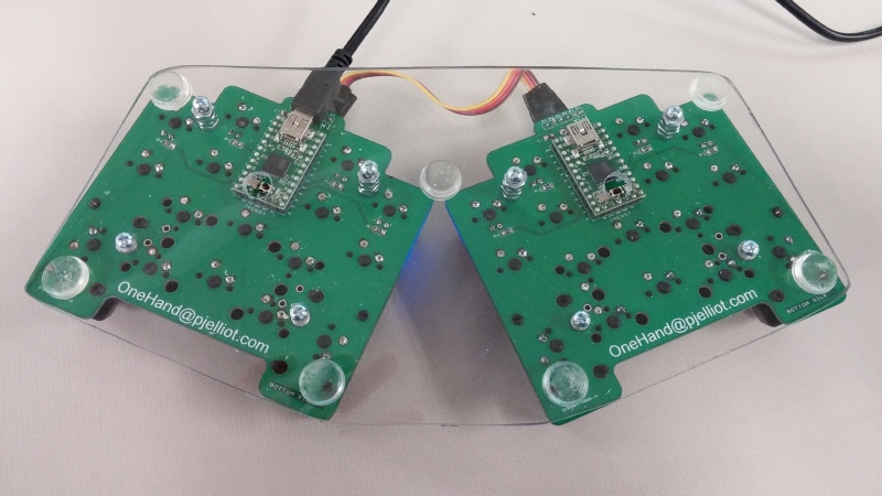

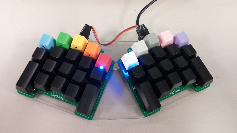

I have finally finished a first draft of the OneHand assembly guide which can be downloaded from this link - http://www.creativephotoeffects.com/pje ... _Guide.pdf. It shows the basic order in which the keyboard is put together.
I've also mounted both of my newly assembled OneHand's (Red & Brown) on a (crude) Plexiglas plate to create a TwoHand keyboard. The sticky feet and fixed arrangement make it easier to use. Here are some pictures.
I'm working on the TwoHand code at the moment. I have it working as a basic keyboard which alpha-numeric and cursor movement, but need to work more on functions and symbols.
I'm also looking to design a 3D printed base for the OneHand and TwoHand once my V2 design is finalized. I'm thinking for the TwoHand a small triangular PCB in the V between the keyboard halves could hold a couple more thumb keys and also some form of mouse replacement (Parallax OFN, Trackpoint, etc).
Now if I wasn't so busy at work...

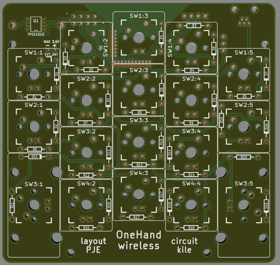

Posted: 11 Mar 2014, 14:33
by kile
First of all, I apologize for hijacking PJE's thread. If it's a problem - I will make my own, but I thought this belongs here, since this is PJE's layout and design.

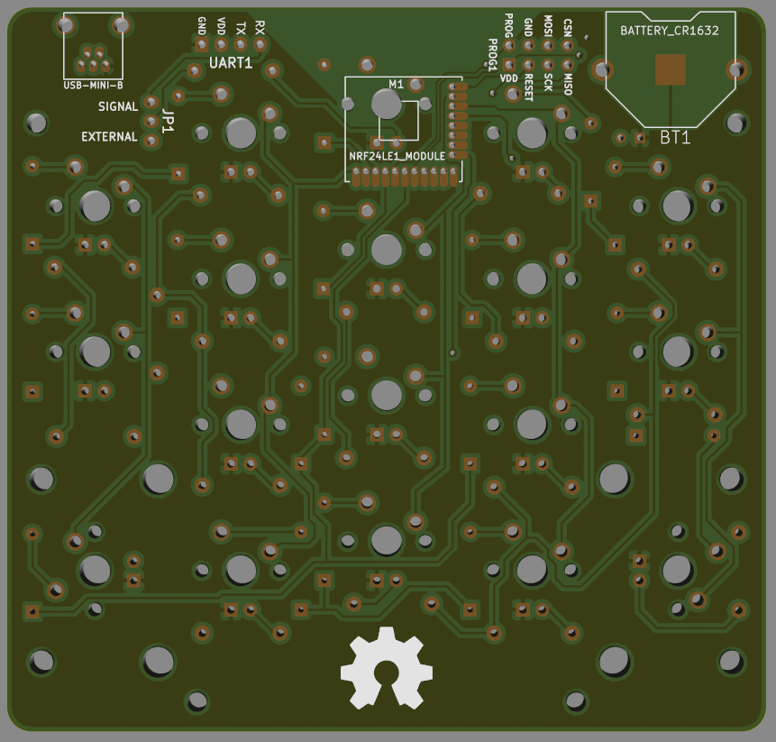

So, I've started working on the wireless version of the PJE's OneHand layout. Because of EagleCAD's board size limitations I've had to learn to use KiCad which was a pretty pleasant experience. On the whole I think it's a much better package than EagleCAD even not taking the Eagle's limitations into consideration. This is what I've got so far:
far from finished...
This image is from an amazing piece of software called ZofZPCB. It takes the gerber files as input and creates a rotatable 3D representation of the finished PCB. It really is amazing.
I am using the smaller CR1632 coin cell (upper left corner, under that SMD mosfet) because I could not fit the CR2032 on the board. I have a reverse polarity protection MOSFET and a through-hole mini USB socket for powering the LEDs. I've also added a breakout for programming the nRF and a breakout for UART.
I've made all the components through-hole to make it easier to assemble. The only exception is the MOSFET, but that shouldn't be hard to solder.
I still have to double check the component footprints, and think of where to put to mounting holes. Then I'll send the gerbers to a PCB fab. And then I'll start working on the firmware.
I've attached the KiCad files of the board and schematic. I used the latest version, so you might have to upgrade if you want to open the files. I will probably make a google code project later on.
All comments are more than welcome.
Posted: 11 Mar 2014, 14:54
by Muirium

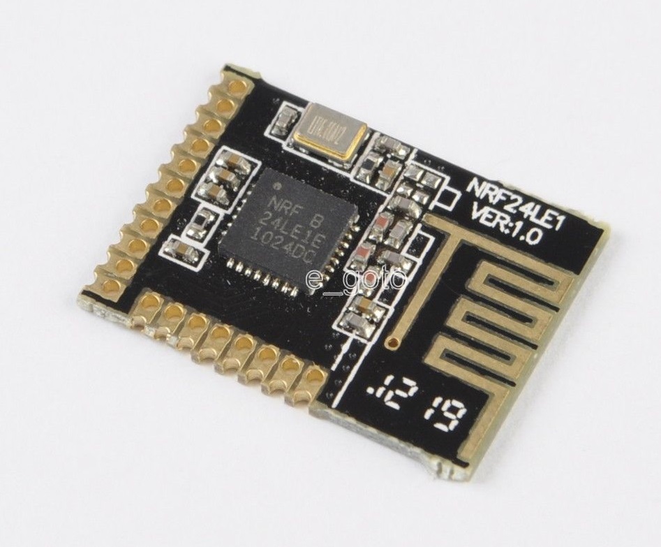

Cool! I guess that L shape of narrow pins around switch MXL1_3 are for an Atmel chip or something else?
Posted: 11 Mar 2014, 15:09
by kile
Yes, that is for the nRF24LE1 microcontroller/radio chip breakout board. This one:
Posted: 11 Mar 2014, 15:11
by Muirium
Right, a one-chip controller and wireless module? Perfect!

Hi kile, no problem with hijacking the thread. Post away!
Love the design idea. I'm considering moving the outside columns down on the V2 design to line up with the center column to keep my thumb and little finger more centered on the home keys. The current layout is still pretty good for my hand size though.
Your placement of the RF module is clever, I'd recommend ensuring no ground plane covers the on board antenna.
I'm considering an optimized TwoHand design, allowing me to free up the two OneHand units for further experimentation.

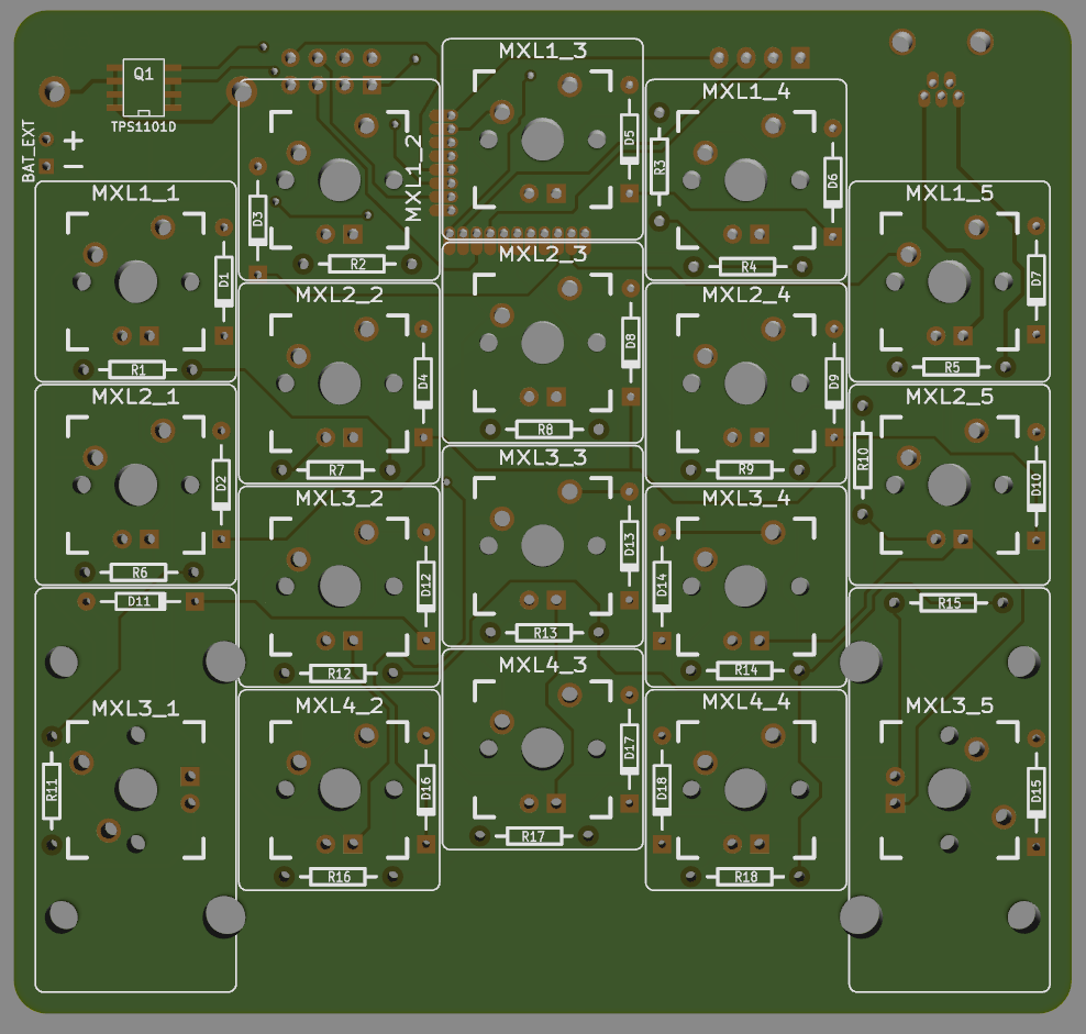

Posted: 21 Mar 2014, 01:17
by kile
This is the last sanity check before I send the gerbers to the PCB fab.
PCB front
PCB front
PCB back
PCB back
The LED on SW1:3 can be disconnected from the 5V USB power and connected to an MCU pin and used as a signalization LED for some firmware features (board lock/unlock or layer switcher for instance). Wether the LED is on the 5V or on the MCU can be selected with a jumper (JP1).
I've tried to keep the PCB area around the antenna clear from copper to avoid shielding.
I've added an "external power" source if you want to connect larger batteries. For instance, if there is room in the case you could power the circuit from two AAA which would last much longer than the coin cell battery.
The KiCad files and gerbers can be found on: https://code.google.com/p/onehand-wireless/
Comments and suggestions are welcome!

kile wrote:This is the last sanity check before I send the gerbers to the PCB fab.
Hi kile,
Nice work! The only suggestion I'd make would be to drop a 3.3V regulator powered by true USB connector which would allow the board to be powered from a USB battery pack. Some of these packs are small enough to package with the keyboard and can be recharged as needed.
I'm working on a new TwoHand arrangement with less angle between the two units. I'm looking a creating a V2 PCB for this type of keyboard, maybe offloading the CPU onto a thumb switch board placed between two OneHand matrix PCBs.
Posted: 22 Mar 2014, 10:34
by kile
PJE wrote:The only suggestion I'd make would be to drop a 3.3V regulator powered by true USB connector which would allow the board to be powered from a USB battery pack. Some of these packs are small enough to package with the keyboard and can be recharged as needed.
Hmmm... Do you mean adding another USB port which would power the LEDs and the controller? Or using the existing USB plug? Either would mean you have to remove the CR1632 battery when you plug in the USB or else the battery might go boom! Also, I don't like regulators for this because all have a quiescant current which is usually about 10 times higher than the controller power consumption. I would be powering the regulator instead of the rest of the circuit. I already have one USB connector which only powers the LEDs, so you can plug the USB battery pack into that and keep the controller powered from a CR1632.
I've made another check moments before I wanted to send the files and found a serious problem. I swapped two pins on the module breakout which would need some ugly trace cutting to fix had I not caught it. Phew!
I've never before sent a PCB into production without etching a prototype at home first. I'm a bit nervous...
Posted: 22 Mar 2014, 10:42
by Muirium
Best of luck, Kile. I want to see this thing work as much as you do!

kile wrote:Hmmm... Do you mean adding another USB port which would power the LEDs and the controller? Or using the existing USB plug? Either would mean you have to remove the CR1632 battery when you plug in the USB or else the battery might go boom! Also, I don't like regulators for this because all have a quiescant current which is usually about 10 times higher than the controller power consumption. I would be powering the regulator instead of the rest of the circuit. I already have one USB connector which only powers the LEDs, so you can plug the USB battery pack into that and keep the controller powered from a CR1632.
For some reason my response never made it to the board...
I was meaning via the USB you had already added. Obviously this comes down to how long the keyboard will work on the CR1632. Did you see if a CR2032 would fit? From my checks it seems to have a better price/power ratio than the smaller cell.
I bought my OneHand PCBs from Seeedstudio for $25. I was very happy with their quality.

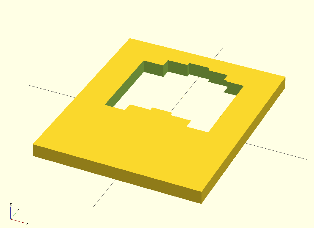

Last night I've changed the battery holder to CR2032, rerouted the top of the PCB and sent the gerbers to ITead. And today I found a small mistake on the board. I wanted the mounting holes to be 3mm, but they turned out to be only 2.5mm. Oh, well... :(

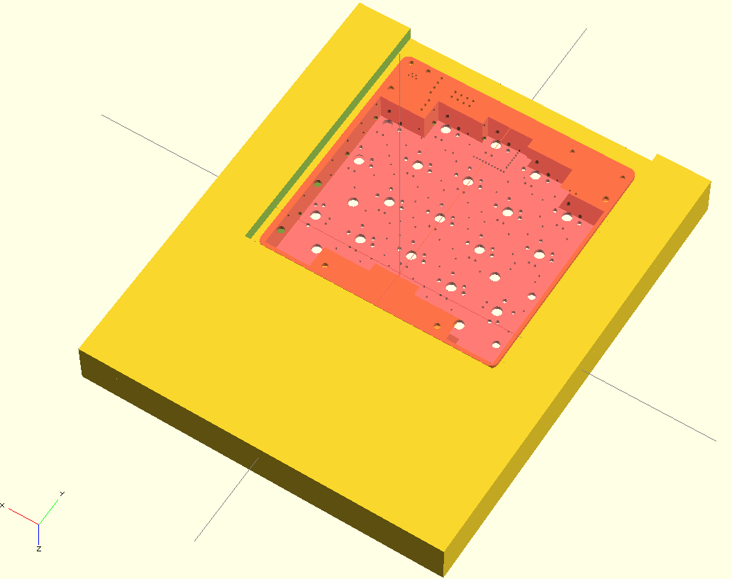

I've started designing the case. I want it to have a long wrist rest like on the 7G, and I want it to be made out of wood. And it has to be simple to build and simple to remove the PCB, so I will make it out of two planks of wood and glue them together and then file and sand them down to my linking. I don't have enough tools or knowledge to do everything by myself, so I hope I will find a place where I can have these planks cut to size. But I do have wood files, sandpaper and glue. The PCB will be screwed to the top plank with four screws.
I've installed OpenSCAD (very, very nice piece of software if you know basic programming) and made the design with it. It was surprisingly easy and fun :)
This is what I want it to look like.
top plank
top plank
bottom plank, the PCB and the top plank underneath
Posted: 25 Mar 2014, 17:22
by PJE
Hi Kile,
I like what you're doing... I've been looking into 3D printing a case for my OneHand and TwoHand designs.
At present I'm focusing more on the TwoHand design as I find I can use it easier for typing bulk text. I've been mounting the PCB on a plexiglass base with simple standoffs at the back to clear the CPU module. When using this, some form of wrist rest about 15-20mm thick would make the unit more comfortable to type. I've been using mouse wrist pads in the short term.
I'm working on a new OneHand PCB design which allows a $5 ProMicro to be mounted behind, as with the current design, or to have an additional thumb PCB which can scan the matrix of two OneHand units plus two additional thumb buttons. This version will use a traditional matrix with diodes in a 5x4 arrangement for each hand, using 5x8 matrix scanning for the TwoHand version.
This three PCB arrangement will allow more flexibility in the PCB placement as it can rest flat if needed, and also simplifies the code as only one CPU will be needed.

  • I2C port available - RJ11/Grove.
  • PS/2 Touchpad interface, with data sent via USB.
TwoHand Option 1
  • Two OneHand modules with rear mounted ProMicros.
  • I2C interconnection - RJ11/Grove.
  • 2x PS/2 interfaces
TwoHand Option 2
  • Two OneHand modules without CPU.
  • CPU Board holding ProMicro, two additional thumb switches.
  • PS/2 Touchpad interface to accept a standard (eBay Synaptics surplus module - I picked up 3 for $3 each).
  • Touchpad mounted above CPU, in the V between the keyboard units.
  • I2C Interface - RJ11/Grove.
TwoHand Option 3
  • Two OneHand modules, one with CPU, one without, as mentioned above.
  • Center board holding touchpad and two additional thumb switches.
Each of the OneHand PCBs will keep the same PCB shape as the V1 - I've grown fond of it, with a shaped PCB between the units with a 2xSIL connections from the OneHand PCB to the center PCB. The PCB will hold the CPU, Touchpad and two additional thumb buttons.
The aim is to allow cursor movement using either thumb without needing too great a reach... Here's hoping!
I'm going to create the new OneHand PCBs first, and then when I've debugged the touchpad and chosen a size, and then finalize the center PCB when I've settled on a spacing. I will then be creating a 3D printed shell to hold the PCBs in the required location, as well as the touchpad carrier.
I now need to track down some DSA keycaps to allow me to have the correct symbols on the caps without worrying about the row style...
Thoughts...
