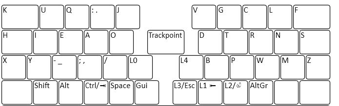

Suka interisting what is the layout of your hypernano?
it looks fit 4 fingers and modifiers in addition pinkie

nisilhum wrote: Suka interisting what is the layout of your hypernano?
It used to be something like this, index fingers on A & T. I think in the current version I shifted the thumb keys one column to the outside on each side

suka wrote: It used to be something like this, index fingers on A & T. I think in the current version I shifted the thumb keys one column to the outside on each side
my bald :lol: yeah it's make sense now thankx

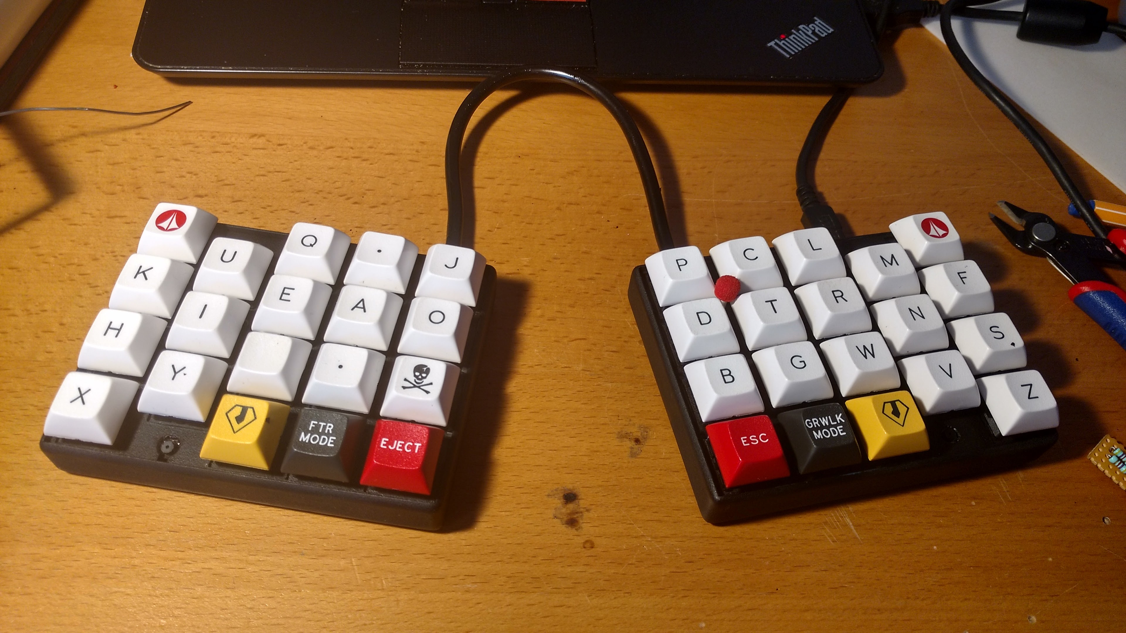

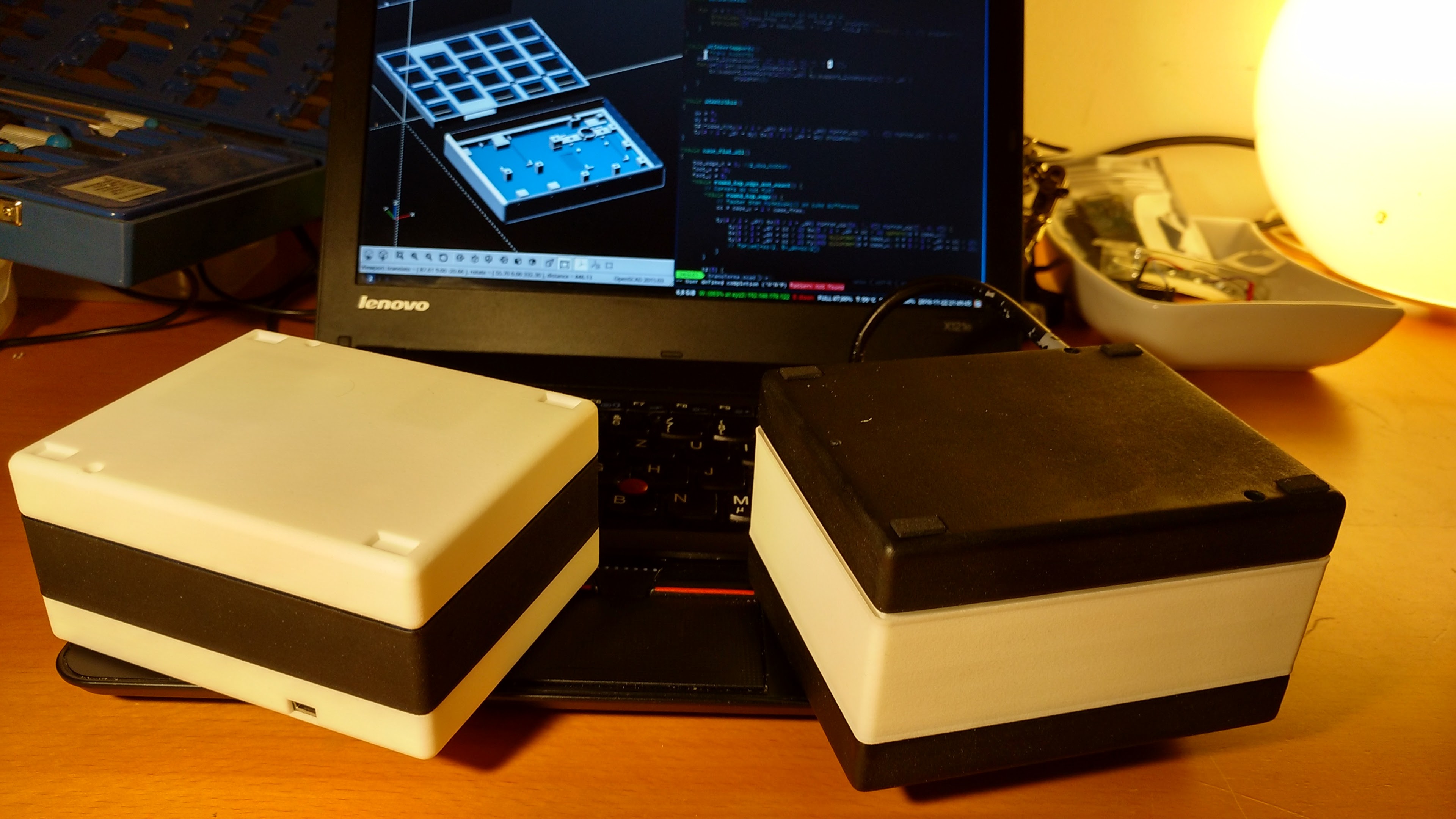

The venerable RedTilt prototype has been my daily driver for over 3 1/2 years now, and I have nothing at all to complain about the general layout or functionality. And as you can see from the lack of updates to this thread there simply wasn't any good reason to continue the search for my personal holy grail of keyboards as the minimial tilted split board feels perfect in every regard to me.
But the prototyping character without a case and clear view (and access for dust and grime) of all its hacked up innards has been bothering me for a while even though the DIY appeal really shines here. Also, the improvised stand on screws and missing bottom shell made it hard to stow away or transport. And last but not least, the 2nd column on the pinkies has been of no use to me with my custom layouts, so finally I pulled myself together, started OpenSCAD once again, and was immediately up in Full Make Mode (tm), thinking up wildest options of ergo thumb clusters or re-thinking about the bowl-shaped experiments from my early phase.
In the end, though, I managed to distill my previous experiments into two evolved versions of my beloved RedTilt design, and one super secret next-gen combination of both: One minimalistic version, whereby the individual tilting of the columns has been given up in favour of an absolutely clean and transportable design, and a second one that takes the RedTilts ergonomic ideas to the next level by also rotating the rows, thus creating a bowl like shape.
So here they are, without much further ado:
Codename BlackFlat, to keep the senseless prototype names

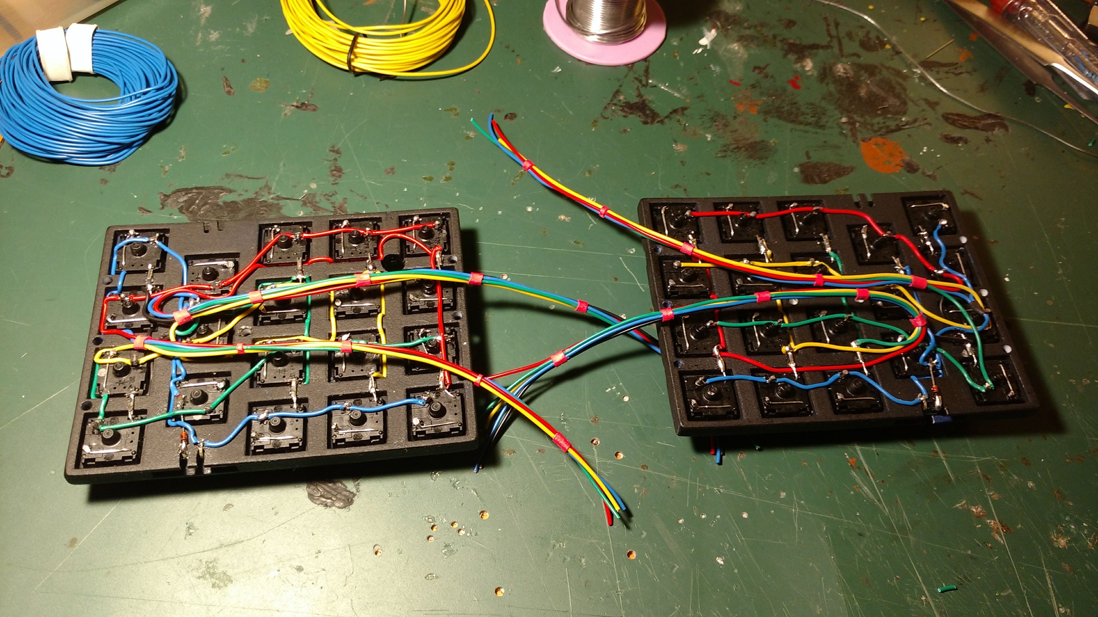

Just as I am typing on in now: Trackpoint support is not yet connected, and I am commited to not keep the fixed cable for the next 3 1/2 years but order TRRS-Connectors or something similar with some port expanders next week. Matching supports are still missing and the connecting piece is way too high, but that will be easy to fix.

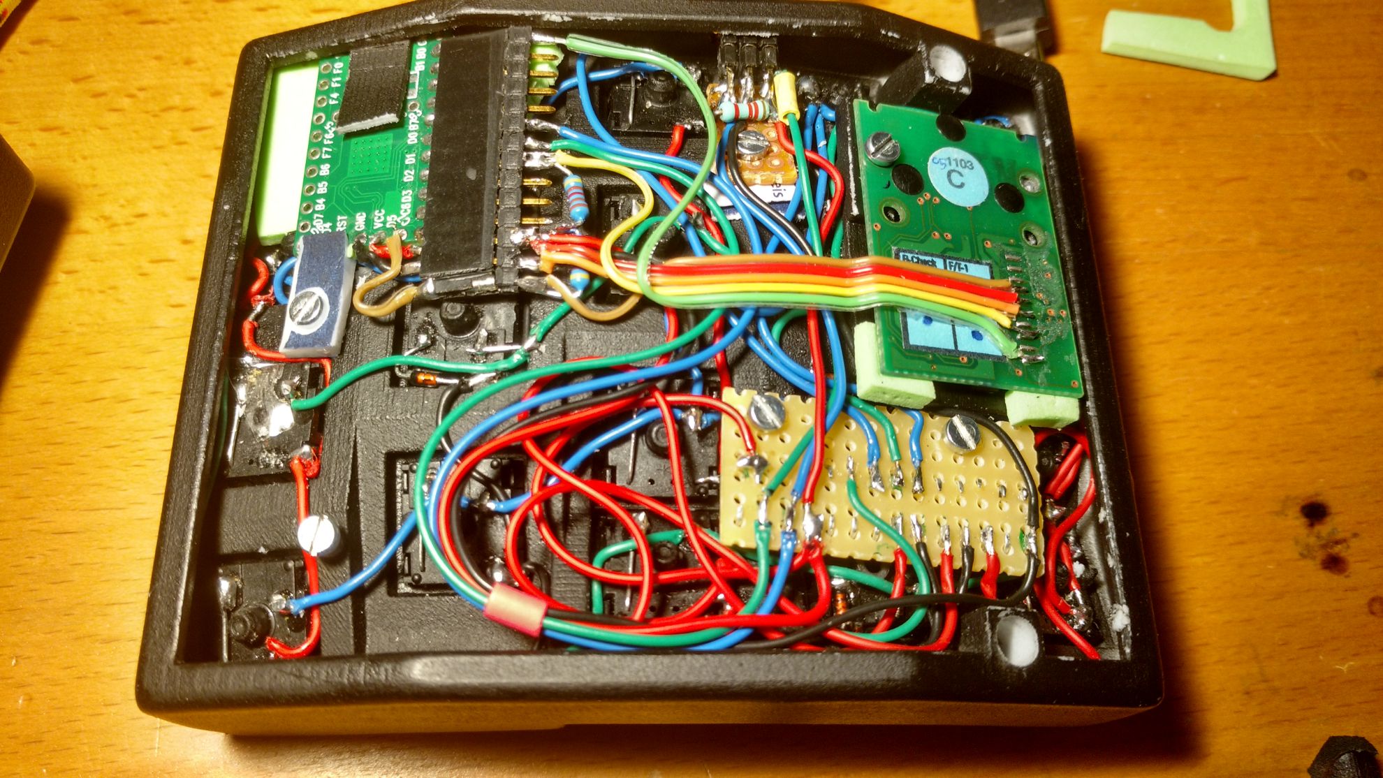

Tried to cleanly layout the wires this time to achieve minimal height

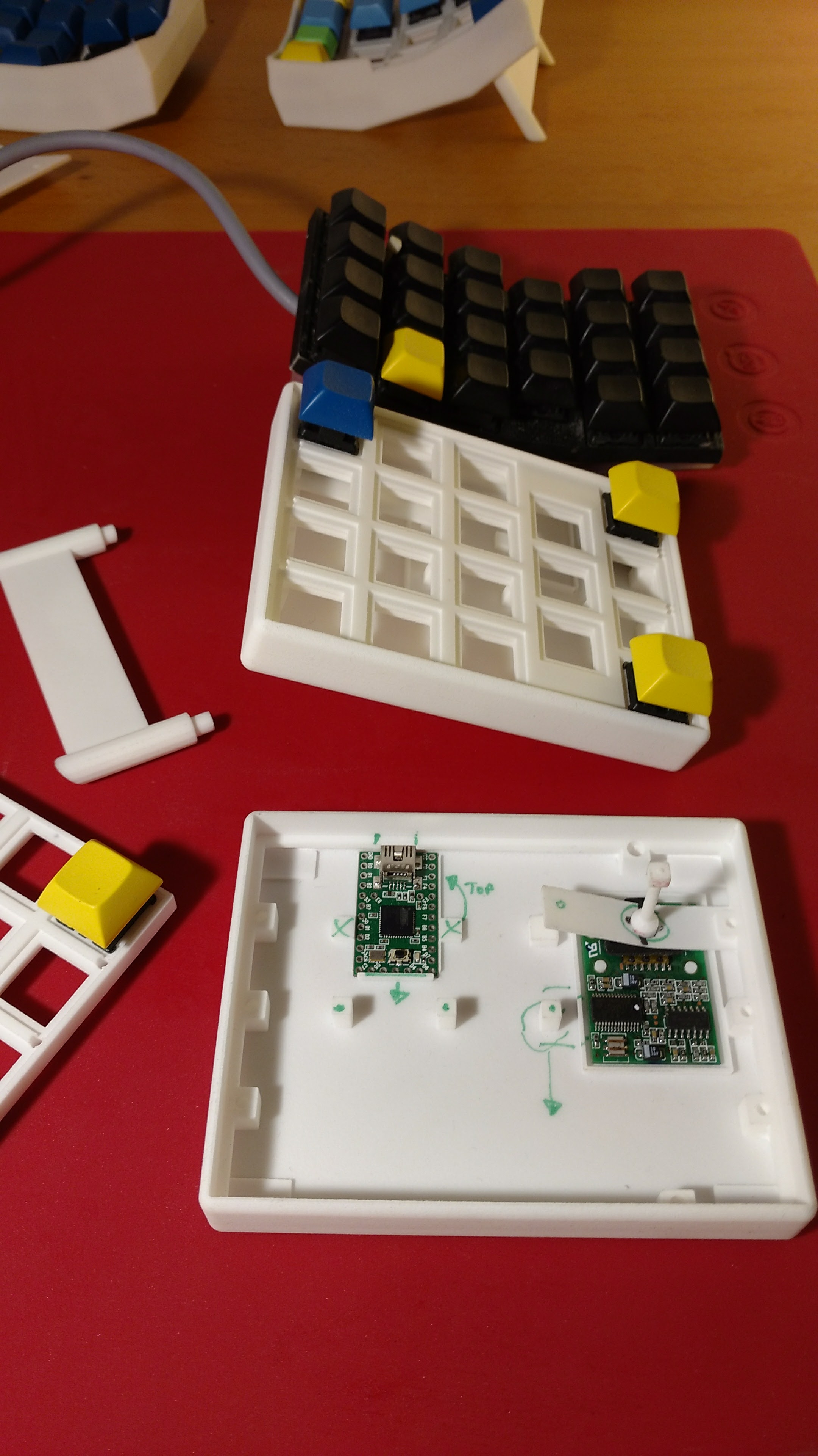

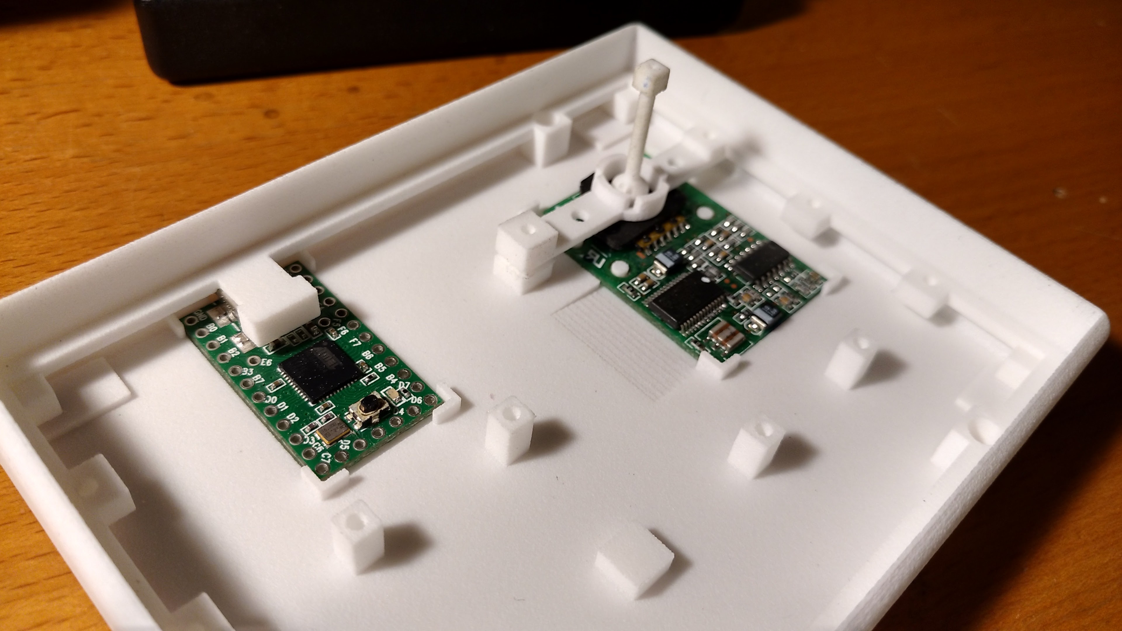

Inside of prototype and comparison to RedTilt

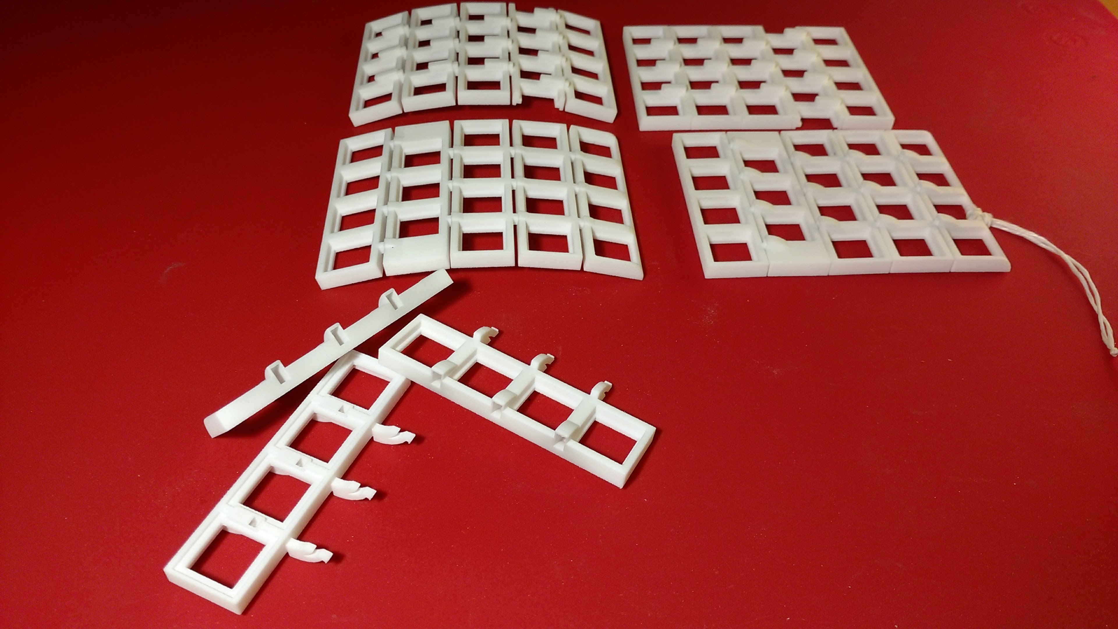

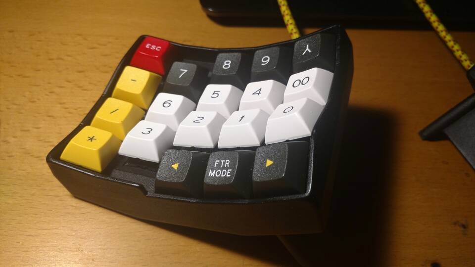

Upcoming bowl shaped variant
One more thing:
Are hinged boards my new 2017 project? Or is there something cooking already? Let's see...
Sneak peek 1 SCNR
Sneak peek 1 SCNR
Sneak peek 2
Sneak peek 2
Apart from the trackpoint that still needs to be hooked up everything is working as expected, and the typing feel after only the few minutes this message took is not much different from the RedTilt I am used to. I guess with the column layouts I found a perfect match to my fingers, and the flexibility of a split board takes care of adjusting to different conditions in the workspace.

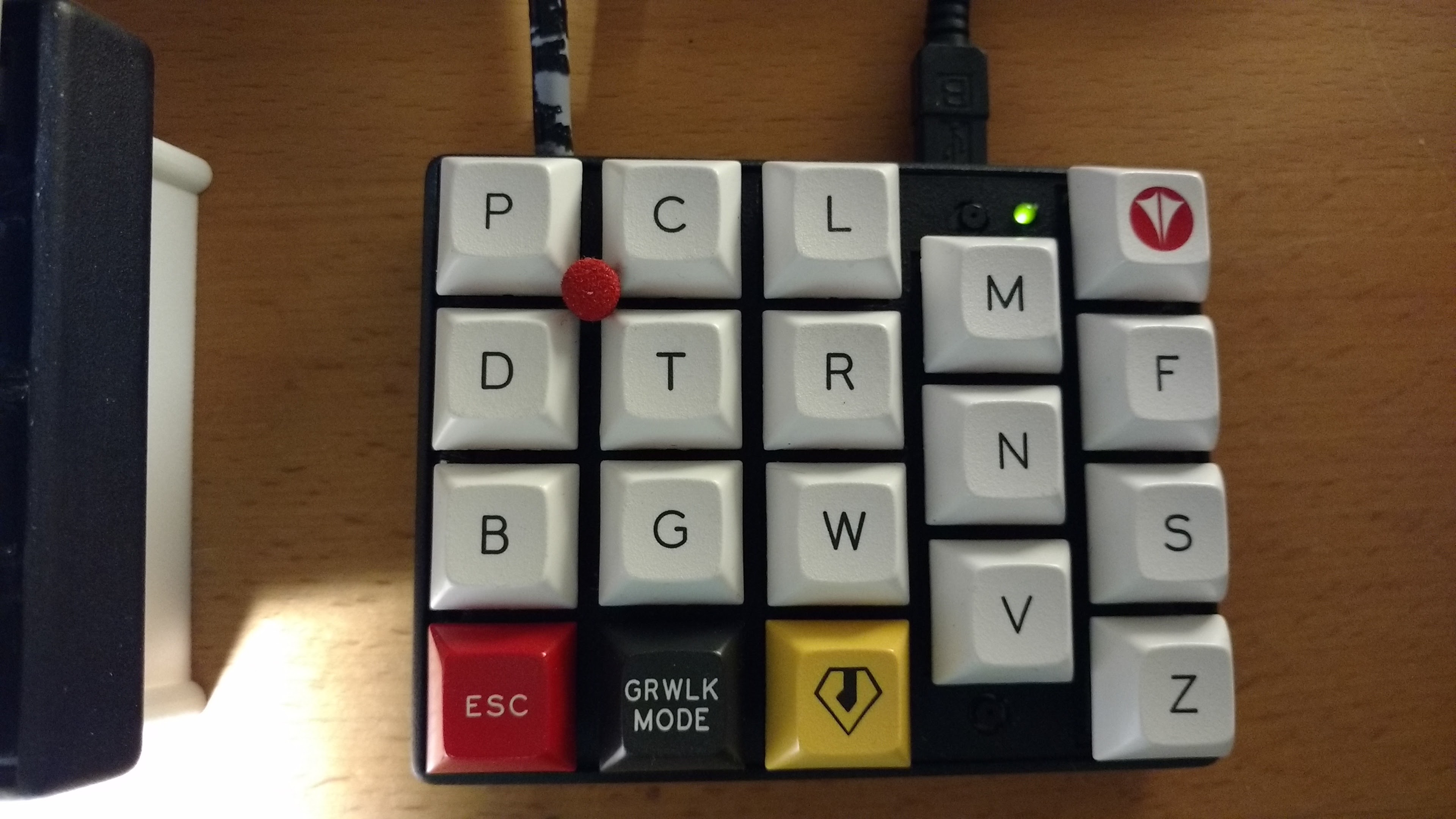

Testing trackpoint with external reset circuitry instead of GPIO as previously used. :mad:
Everything wired and correct multimeter readings, but no cursor... Time for the logic analyzer I guess
Posted: 22 Nov 2016, 22:44
by suka
The trackpoint finally works, or more correctly put I finally figured I should probably betterconnect it to a working GPIO of the teensy I scrapped from my old BlueCube board (RIP). I thought I had cut off all fried pins but must have missed exactly the one I tried to put the PS/2 data signal on :evilgeek:

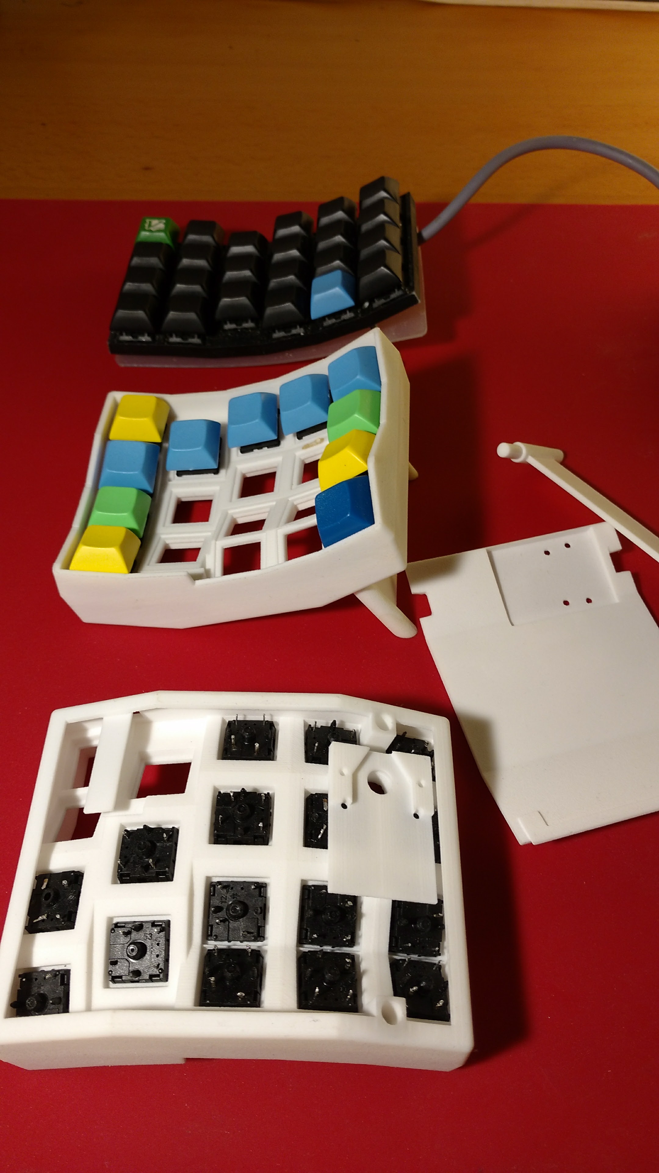

Being technically more or less feature complete I decided to put the new design to the test and use it exclusively for a few days. And what can I say: Not too much of a difference even though I did not tent it for a longer period yet. Or maybe the switch from MX reds to browns again is overshadowing the subtle difference for now? Only my outer wrists got a little more pressure because I lazily put them on the table without noticing - since that was not at all possible with the much higher tilted variant I will have to monitor that bad habit again I guess since the board is so temptingly flat now.

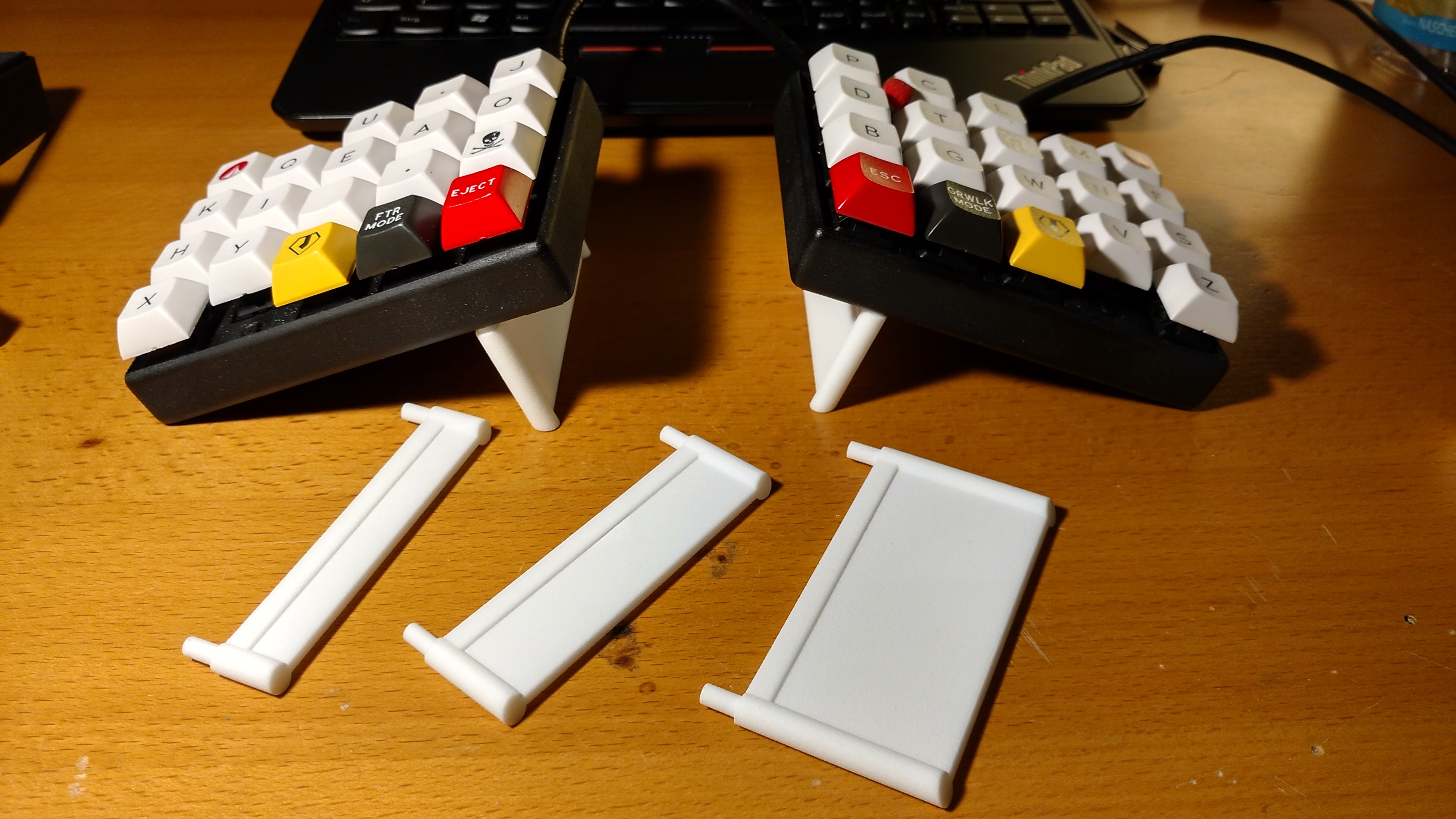

Tilt options in different angles
Whatever the major difference will turn out to be, one thing changed notably already: While before people at work would rather give me pityful looks for typing on such a pile of junk parts and not even being able to afford proper printed caps now everybody passing by my desk is immediately drawn to the look of this creation. I guess because you now realize that it is not only the shape itself that is looking slightly irritating but also the minimal layout itself.
It took only some tiny software adjustments and I was able to use the new board for the entire last two days. I also snug a notifier LED into the frame this time, should not only be helpful for debugging but also in signalling the many different modes I use by now and tend to forget how to exit from them :-) Macros and a passhash implementation are just such a great usability enhancement, but when you need to change them so seldomly it always was a minor nuisance to configure them without extra feedback from the firmware (yes, hid_listen and a good textual interface would be just fine, but everytime I work on a feature it feels I found a logical way to control it that I should not forget and then it all happens again ...
LED added
LED added
The transportation inter-frame works great, even though the new version came out a little too high - but this way the variable tenting modules could also be incorporated, and also a piece of cloth to prevent the caps from scratches, although that seems a little unlikely to happen.
So apart from giving it a few more days of typing time I'm waiting for the serial port expanders to arrive (yes, ordered them already as otherwise a new 3 1/2 year period of prototype status would have started for sure) so the interior can be greatly cleaned up and the cable made detachable. Hope to be able to fit them quickly as some other new component for a possible future project just arrived today :D

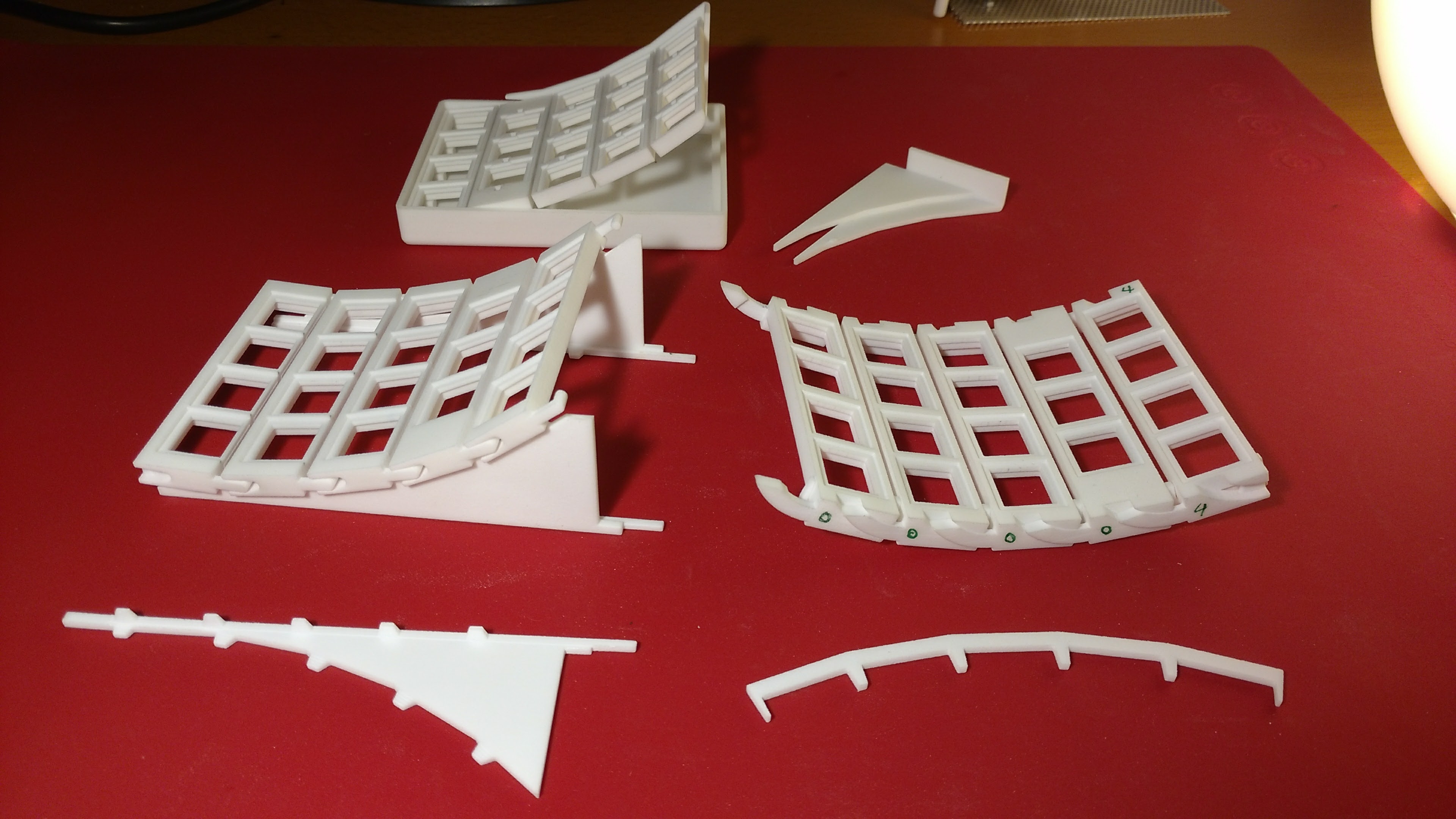

Although with the latest adjustments to the interior case elements it was not as hard anymore to get all cables and components aligned beneath the keyboard frame. The trackpoint stick need just a tiny bit more of clearance to the "C" cap, but I'd rather increase its initial reaction threshold before dremeling down these wonderful keycaps should a smaller extension not work!
Inside elements exactly fitting: But one too tight and one too brittle, duh!
Fun fact #73: 2*(1 MX blue + 3 Whites + 15 browns) take 965g in addition to the 130g of the upper half to fully compress when put upon each other :-)

I just could not resist: after a very interesting exchange with a fellow keyboard enthusiast last week I decided to finalize the bowl-shaped keyboard too, despite my satisfaction with the recent model.
But now all of the sudden it feels as if I have finally completed what I had in mind so many years, and this time without any compromises or prototype hacks: complete case, matching tenting supports, detachable connection cable and I2C on both sides for a minimal pin count.
OK, the Trackpoint and status LED are still missing, but that is the icing on the cake still to be done.
Inside still WIP since I was not sure the MCP23018 would fit and thus used long enough wires for alternatives,, but despite the many wires it is actually quite clean, especially at the teensy side 8-)

Two complete days of typing on the latest "BlackBowl" creation and I must say I'm overly excited with it. I know you should never say never, but I feel I have nailed the ergonomic sweet-spot for me with it, and cannot see any more room for serious improvement. While I first found it a little strange to type on I now attribute that feeling to me being really tired at the time, and sitting at my working desk with a way to high table - it is an absolute blast!
The slight bowl or well shape is extremly satisfying to type on, decreases distance slightly and just seems to guide the fingers and hands back to centered positions with every little touch. So even when not tilted the board feels a lot more natural than anything else I've tried so far. I especially like the forward-tilted thumbkeys: makes them more natural to hit on the top rather than the edge, and makes up a little for the only little ergonomic nitpick I find - that I did not move the thumbs inwards further 1/2 key but rather kept the simpler rectangular layout.
Otherwise sizing and layout are true and tried, case and cable are finally presentable and since about 5 minutes the trackpoint is also mounted and functioning.

What's left to do? A RGB status LED for sure, a little carrying case or bag and plenty of nice-things-to-be-done-sometime are in my head, but unless something really urgent should surface I might just leave it as it is. If it wasn't for the new Kailh options I would probably see no reason to continue creating another board next year - but then there are always novelty ideas to be tested, so stay tuned :-)
It did get crowded at the end: Never aim for too low a height or you will pay dearly during assembly :-)

Can you provide some input on how the TrackPoint stalk performs when it's between that set of keys? I am working on a custom board right now and I just can't get the courage to put a stalk there. I've moved it to the far left of the keys on the right hand board (so, one key to the left of where yours is). Does it interfere with regular typing or is it difficult to move because it's embedded in those caps? I really would like it closer like yours, though...

Tye wrote:Can you provide some input on how the TrackPoint stalk performs when it's between that set of keys? ... Does it interfere with regular typing or is it difficult to move because it's embedded in those caps?
In this particular configuration it does work marvelously if the extension is thin enough or you use a little larger spacing then the regular 19mm - I think I used 21mm minus the rotation. If you're willing to take away the corners of the surrounding caps - which I am absolutely not, at least with these keysets - you have no issues at all. I designed the extension to be 1.5mm diameter and cut it smaller around the bottom edge. Or tried an even thinner cross cross-section similar to MX stems, also fine.
Regarding the length, any increase in sensitivity through the longer leverage can easily be compensated through the trackpoint firmware. What I also did when I only had too long extensions at hand was to decrease sensitivity drastically when the trackpoint had not been used for a certain time and only ramp it up after the first intended stronger touch to prevent mouse mode from activating when unintentionally touching the nub. This can also easily and practically be combined with the Press-to-Select function as a selector, BTW.
So you see, plenty of options, and no reason not to mount it in a prime position if you have the room below the PCB. I guess the models where the stick is attached to its PCB by ribbon cable (not IBM?) would be even easier to place.
