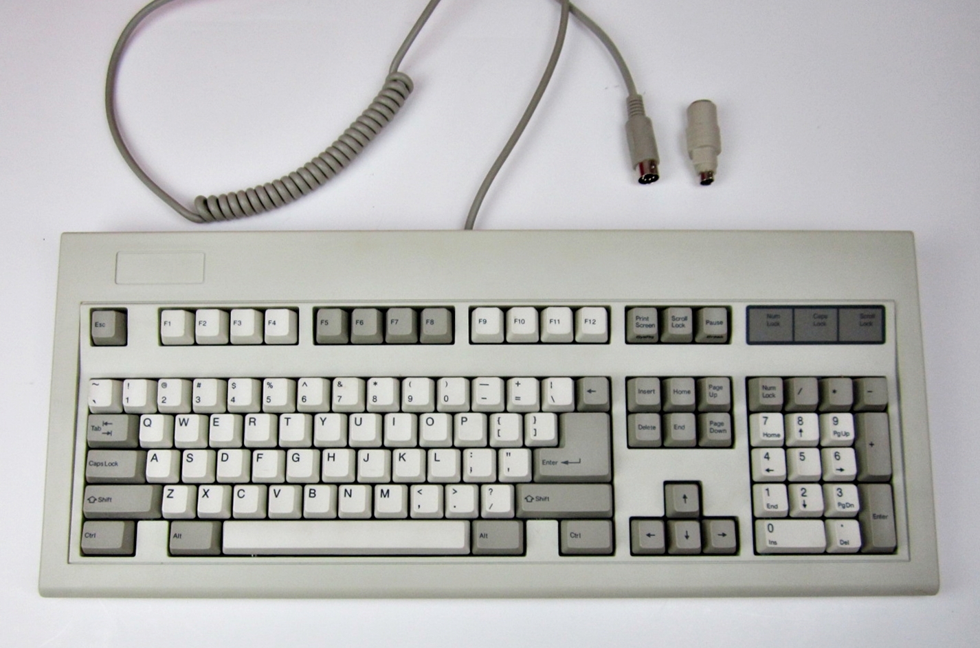

Whatever it is it's too expensive. Looks a bit like a Monterey clone except for that hinge above the function row.

Can someone help identify this keyboard?
Posted: 02 Jun 2017, 21:58
by Harshmallow
88Teo88 wrote: Can someone help identify this keyboard?
Looks exactly like a Chicony KB-5181, just missing its rear label.
Posted: 02 Jun 2017, 22:19
by 88Teo88
thank you :)

The logo recess isn't always present — a case with no logo recess seems to be an uncommon variant. One way to get a positive ID is to check under the feet, as Chicony's name is moulded into the inside of the larger foot (both sides I guess). Not that I see any reason to doubt that it's Chicony.

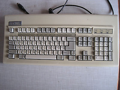

Harshmallow wrote: Can anyone identify this keyboard? The FCC ID says it's from PC House and it was granted in 1987. The board looks like it's in good condition and has already had two declined offers on it. It's intriguing me. Board label shows 80 Data - 5339
http://www.ebay.ca/itm/Rare-80-Data-533 ... SwZKBZMPe8
Ha a very Tai-Hao vibe about it I'd ay.
The keycaps aren't either TH or TI series, which I'd expect them to be if Tai-Hao was the OEM. There's a lot of similarity between Tai-Hao, Focus and various other brands.
I recognise the keyboard though …
Yes, here it is:
https://geekhack.org/index.php?topic=80464.0
Clicky foam and foil, if it's the same as the others.

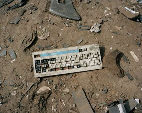

Anyone seen this board before. I spotted it in an article on e-waste and the picture appears to have been taken in Ghana or Pakistan based on the text from the article (linked in the spoiler).
Yes, here it is:
Thanks Daniel, that appears to be the one!
