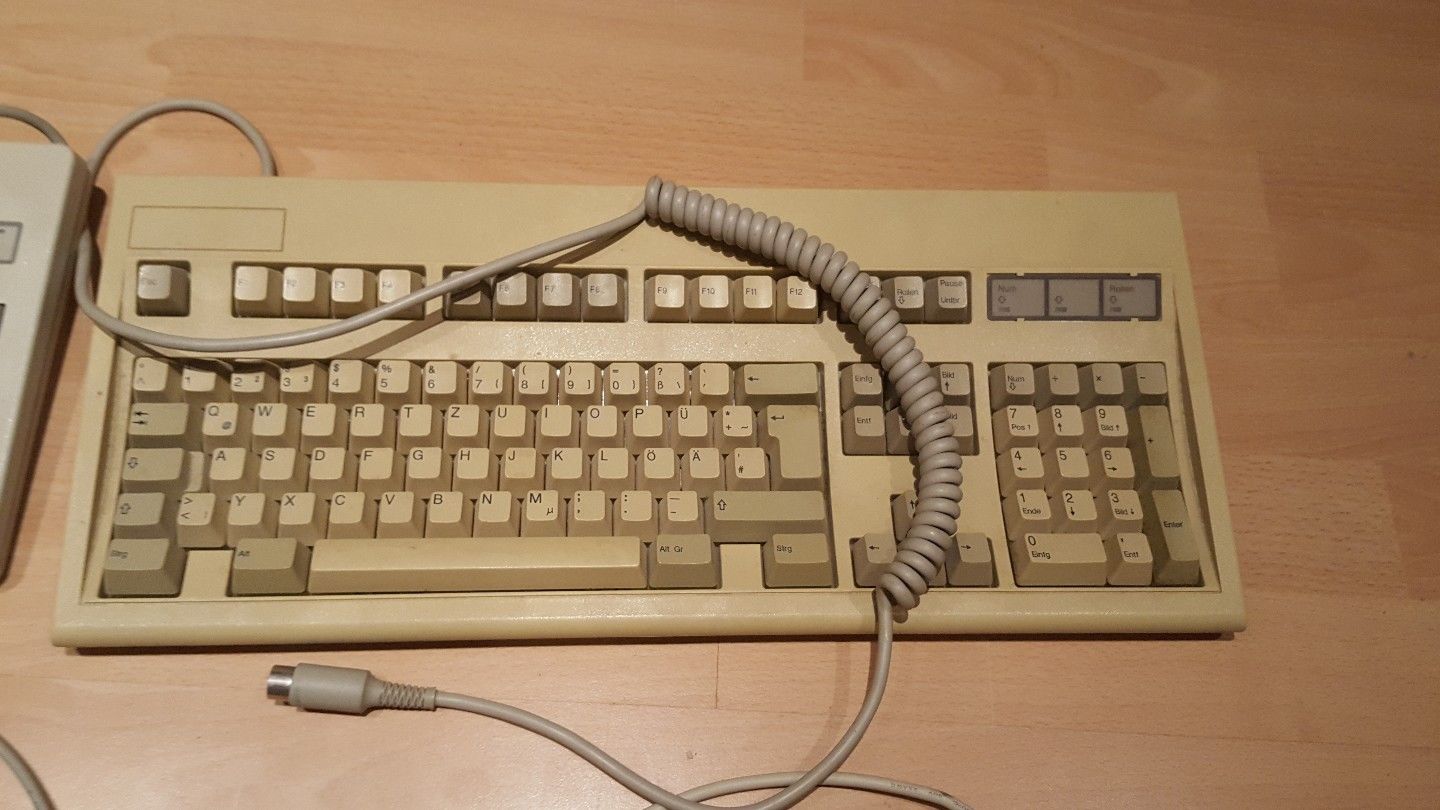

Can anyone tell off the bat what keyboard this is? Stepped capslock, indentation for logo at top left and the four little nibs around the LED screen should be pretty distinctive, but I can't recall having seen anything like it. Horrid banana colour, though...
Posted: 28 Aug 2017, 20:55
by Keybug
Okay, forget it, just realized it's an old Keytronic. :?
