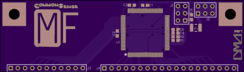

Integrated green wires to
87x15mm - had to make the PCB a bit taller to accomodate the triomate connector.
Speaking of which - insertion force seems to be significantly more than 1 kg, and this worries me.
Can't find exact specs for triomates mating force anywhere in the internet - it may be 5 kg easily. On a 16-pin socket. And there will be 30 pins in total.
May be something like http://suddendocs.samtec.com/catalog_english/bcs.pdf + http://suddendocs.samtec.com/catalog_english/tsw_th.pdf - yeah, standard pin headers - would be better. samtec promises about 120g/pin. Which is 3kg.
Or go 1.27mm pitch? http://suddendocs.samtec.com/catalog_english/slm_th.pdf + http://suddendocs.samtec.com/catalog_english/dwm.pdf for example?
Won't make things worse - traces are running even closer than that for extended periods of time. Mating/unmating force will be significantly lower. Pins will be a bit more fragile though.
Will try to trace beamspring adapter tomorrow - to see how it should look.

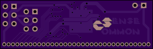

Routed 3 versions, to compare. Core is the same, connector to outside world is different. "GND" is a standard 2-pin header, 6-pin headers are also standard 0.1" pitch 2x3pin.
IBM 30 pin, 4.78x0.82":
mini-xwhatsit-compatible 0.1" pitch, 3.43x0.57":
Proposed 0.05" pitch, 1.75x0.57":
Had to develop a compact logo variant for the 0.05" version. Prefer to go ahead with 0.05" version because it can be put anywhere, and if ribbon is needed it will be just 1.7" wide. But for MF phase 1 special PCB version can be designed, which will be a drop-in mini-xwhatsit replacement. Easy to do, just LOTS of empty space on the board.

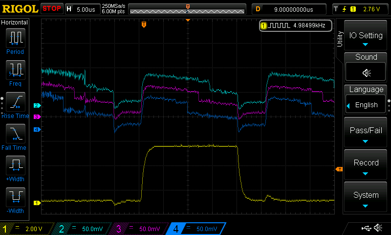

Turns out shielding is useful, after all.
This is 3 adjacent columns with shielding removed.
This is 3 adjacent columns, same board, shielding intact.
Shielding prevents charge sapping by an adjacent line. Supposed to be a Good Thing, makes for more consistent readouts. But the price is great - half of the charge carriers sapped by the ground (another interpretation would be "but the resulting capacitor is twice as large and voltage achieved is much lower".
One thing to note is that in second picture there's still 2 foot of unshielded ribbon cable between PCB and controller, and the effect is not nearly as drastic. Can't really explain that. I think it favors "charge carriers escape" theory - shielding removed is really close to the flipper. But the logic behind this explanation is pretty poor.

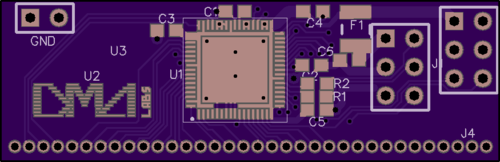

Looked at PCB assembly prices. Looks like it will cost more than parts and PCB combined.
Changed chip to TQFP - those are easier to solder. But twice as much pins so assembly is even more expensive. But since it looks like I'll be assembling those anyway- number of pins doesn't matter.
Also figured out why MF logo threw an error with oshpark's gerber parser. 63-point polygons - oshpark cannot into those.

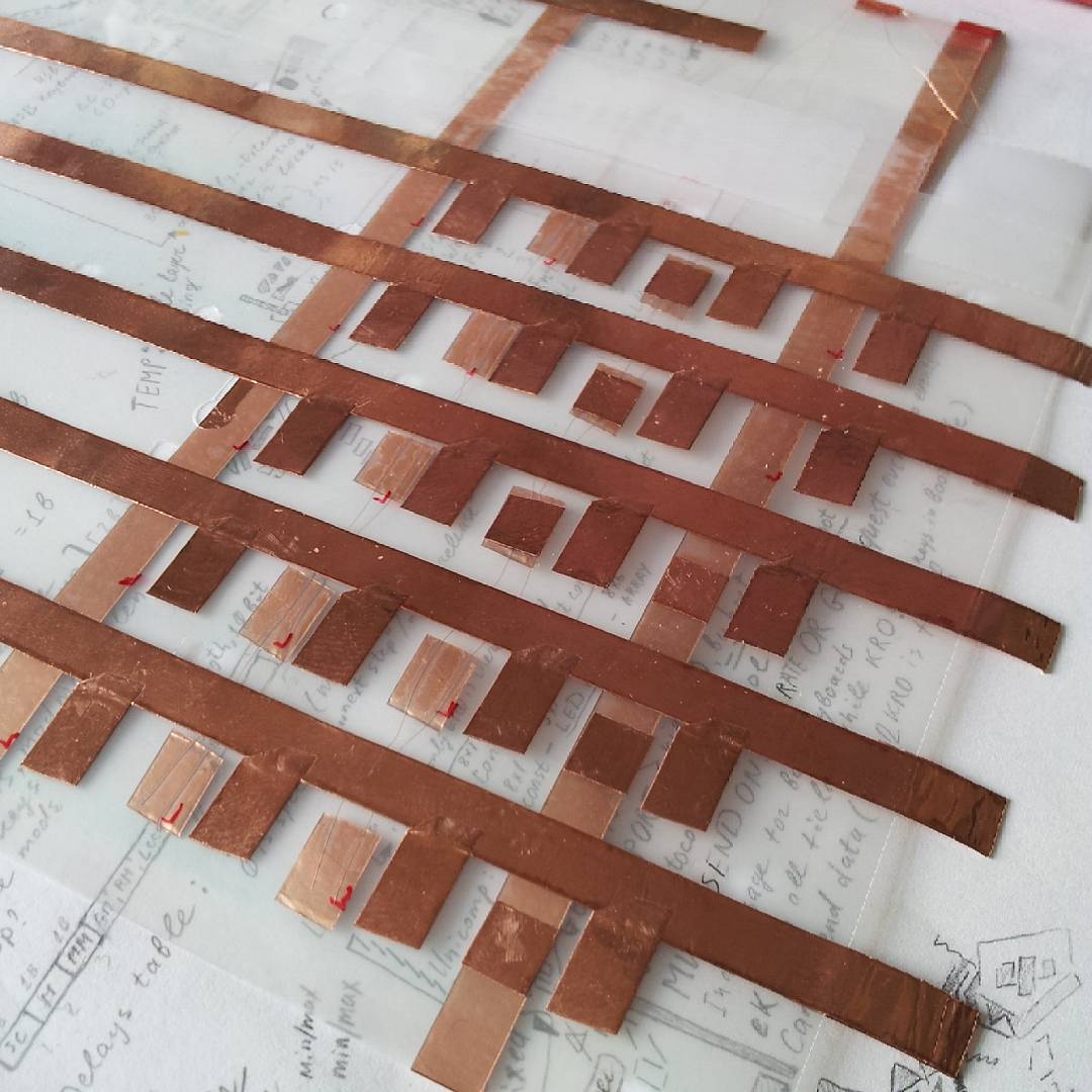

Experimented a bit with PCB design.
This is F122 under-PCB mylar sheet with craft store 1/4"-wide copper tape pasted to it.
Row lines are run all the way across it, flipper legs standing right on them (I aimed for "about 2/3rds of the strip is under the flipper").
Leftmost and righmost columns just run across the rows, forming 1/16 sq. in. overlay between row and column.
Middle columns tape is cut to 1cm pieces and connected with thin wires, forming sort of a dashed line, to minimize overlay. Right column has a standard gap between pads (0.015"?), left has zero gap (red on the photo marks the pad border).
Right half has additional 1/4" square pieces of copper pasted as far away from the row line as possible, but in a way that flippers still completely cover them.
It is sandwiched into bolt-modded unicomp (layers are "barrels - "sense card" - unicomp's original rubber membrane - metal plate"), and controller connected to the end of the strip, like this:
It's not much worse than PCB proper.
Readouts at rest are 5-8(looks like the gap is the main factor affecting the levels) on dashed columns, 28-30 on solid ones.
Keypress gives +10 (+15 if there's additional copper piece under the flipper).
Readouts are stable and variation is SURPRISINGLY LOW.
So it looks like PCB can be replaced with a mylar sheet with conductive pads printed on it, akin to the one used in model M. Can't find how much those cost though. I think they must be cheaper than PCB.

Wow, that's very interesting. A bonus with using a capacitive mylar sheet is you wouldn't have to heat bend it the way you might with a PCB. How does that sound in comparison? I'd think it would be a little more muted when the flipper whacks the mylar.
Posted: 19 May 2017, 06:41
by DMA
Techno Trousers wrote: Wow, that's very interesting. A bonus with using a capacitive mylar sheet is you wouldn't have to heat bend it the way you might with a PCB. How does that sound in comparison? I'd think it would be a little more muted when the flipper whacks the mylar.
Another bonus is that it will fit FFC connectors because it's a Flat Flexible Cable, not a PCB :)
It seems tad quieter than F122. May be because I haven't tightened the bolts, or because of the rubber underneath.
https://www.instagram.com/p/BUQAkq4BgQ7/- those are 12mm M2s, because I don't have 8mm ones.
It still has that F snappiness though.
I think there must be 3 mylar layers, actually. Protective top layer, then rows and then columns (assuming traces are printed on top. If they're on the bottom - protective layer needs to be below. I've heard those conductive inks are not durable and need to be protected from scratches.) Will probably still be cheaper than FR4.

DMA wrote: So it looks like PCB can be replaced with a mylar sheet with conductive pads printed on it, akin to the one used in model M. Can't find how much those cost though. I think they must be cheaper than PCB.
I suspected that and expected it to work better because the distance between capacitance plates is much smaller providing a wider swing. I actually ran the theoretical math on another thread somewhere here (or on GH).
I kept working on using my vinyl-cutter to test but had issues with getting full layouts off in one piece. Had I realized it would work so 'rough and ready' I wouldn't have tried so hard.
