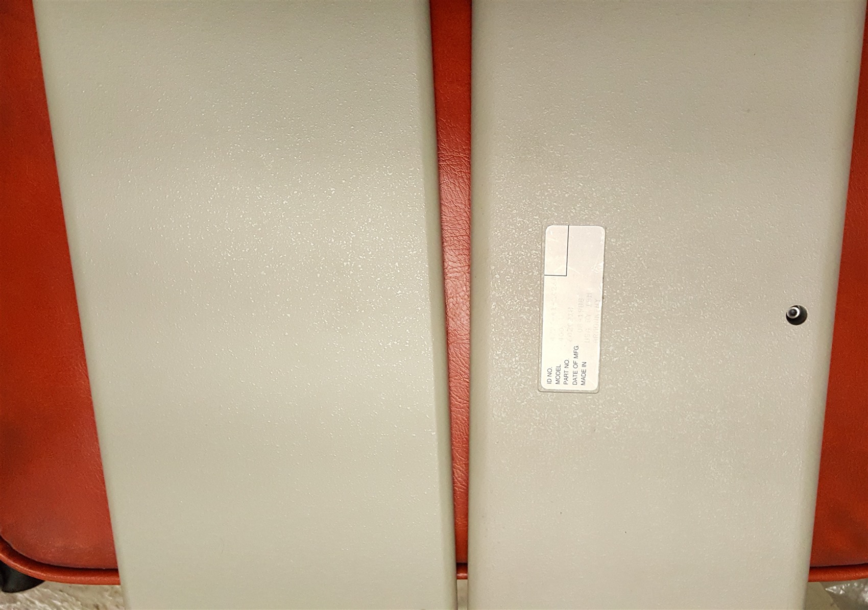

All the first run parts (except keys) are being sent tomorrow by DHL Express! They should arrive by mid-week and then I can start the final QC testing for all parts. I have extra batteries for my micrometer! Keys are expected to be mailed by the end of next week. They are working on the final adjustments of the key molds.
Here are the photos of the cases and outside foam being mailed. The other inner parts are also being mailed so in effect I will be doing the assembly and testing from all newly received parts.
Again please disregard any and all colors and lighting in these photos as they are not accurate or representative of what you will get.

I am typing on a fully assembled new prototype F62!
Everything is working very well so far. The powdercoated die cast zinc cases are excellent quality. It was well worth the couple extra months to get the paint job right. The off-white/beige color is almost an exact match to the 1988 F107 case I mailed them as the reference. The texture is the same bumpy, mostly matte but slightly reflective powdercoating as the original. The True Red and Black cases look good. In the next week or two they will mail the Industrial cases.
The capacitive PCBs, controller PCBs, inner foam, and outside foam are all good. Every PCB is being grounded in two spots to the bottom inner assembly with 6-32 screws to eliminate the risk of stray capacitive signals.
There were a number of issues that I have told the factory to work on and prioritize for completion as soon as possible. Some notes:
The top inner assembly parts are very good but slightly off spec. The TIA curve is about 1mm off from the ideal. My XT sample has a perfect curve that matches my CAD files exactly so I have asked the factory to remake the samples to this standard. The perfect curve helps ensure a more even pressure on the barrels between the top and bottom inner assembly. The wrong curve can result in wiggly barrels and clicks that are not as sharp so it is important that they get it right. To correct this issue they are going to adjust their tooling and mail corrected parts ASAP.
The compact cases had some issues with the color of the hard anodizing being slightly off. They are adding another couple screws on the bottom to further secure the case.
The product boxes were 2.5mm thickness instead of the 5.0mm I had specified so those were rejected, though the box artwork is well-printed.
Finally the springs are very close to the originals but I want to see a few more spring samples with different materials before the springs go into production.
