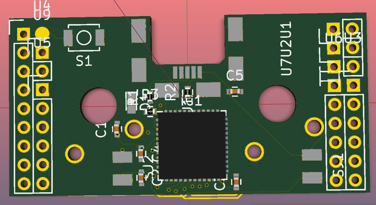

by mohitgarg
It was considerably easier to route this because of the larger area. I'll upload this to the Git soon. If you want we can fit the logo on the front as well. Dimensions are 38.1 x 17.78 (+2.9718) mm
Posted: 11 May 2016, 15:30
by matt3o
wouldn't printing on 2 sides be more expensive? I would also add "
https://elf.io" and the board revision. "Elf 1.0 -
https://elf.io" (all people involved will be credited on the website of course)
Apart from that the only thing that worries me a little is 38.1mm width
