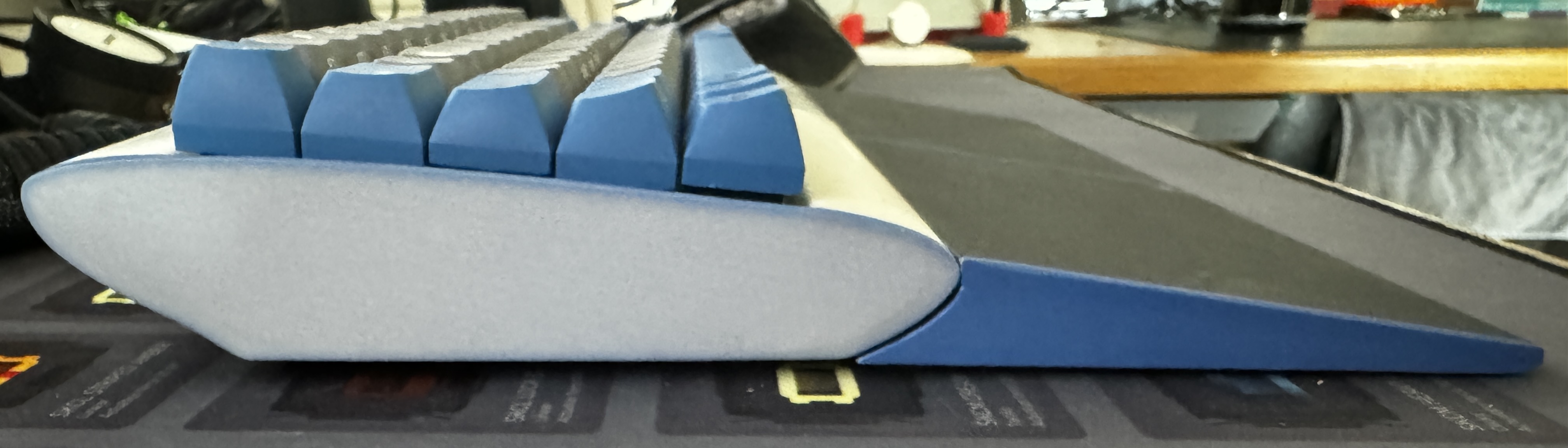

I am working on a snug fit wrist rest as well in the same design. Still testing the variants before I get it done in the proper color. Here's what I have so far:
