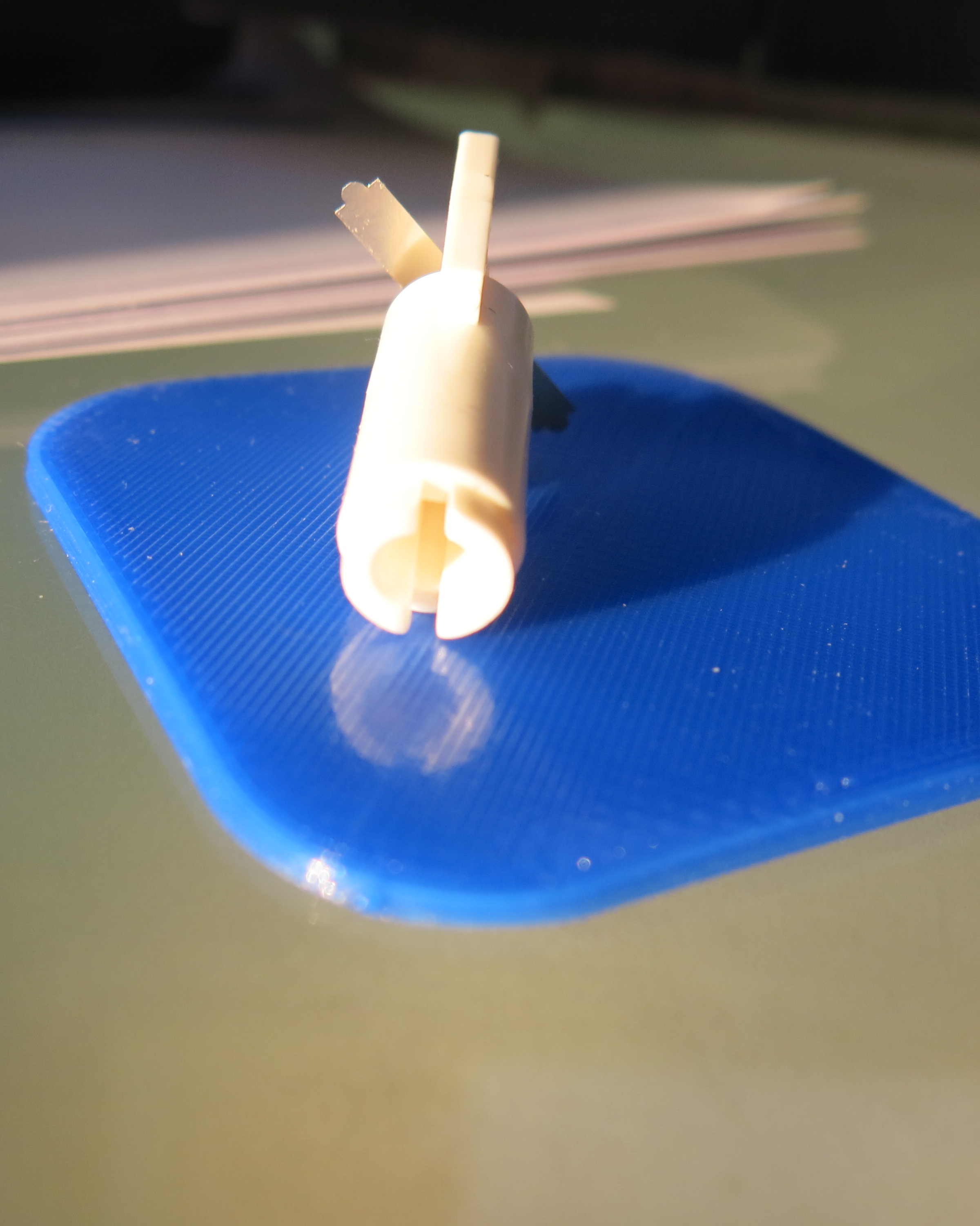

Mostly I need the inside diameter of white part, the rest I can work around.
w/images/2/22/Beamspring-top.jpeg
Can you take a picture of the white part with the metal insert not in there as well? If possible get the picture from a top view so I can get a better sense of the profile in there.
Thanks in advance, once I get this updated I can get things rolling for production on an SLS (Selective Laser Sintering) printer and it should be like 3-4 USD a piece I think. Not as cheap a printing it on an FDM machine but it would certainly be stronger and more reliable to produce them this way in any kind of quantity.

Layer_Shift wrote: Mostly I need the inside diameter of white part, the rest I can work around.
The diameter of the slider barrel is 4 mm. The groove adds another mm - so the diameter is exactly 5mm when measured from groove to groove.
I did my best to get a focus inside the white slider. The last one on the pictures below is showing the "rail" where the mount insert is sliding in. The first one is showing it directly from the top:

That is AWESOME!!! I have used a beamspring many moons ago and wish I could get my hands on one.
By the way the pictures of the barrel are perfect. I thought that was how they were setup, but wanted to make sure I wasnt missing something.

The full height of the slider barrel is 18mm. The printout was 3.65mm but can easily be 3.9. The diameter measured at the spot of the excrescence is 4.35 and can definitely be 5 mm in diameter.
