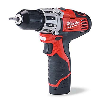

i plan to use this. I may or may not make a little jig to hold the barrel plate

Donnelly20 wrote: 08 Sep 2019, 16:09 i plan to use this. I may or may not make a little jig to hold the barrel plate
Yeah, as long as the barrel plate isn't flexing when you drill, you should be alright. At least with the Model F bolt mod, cracking wasn't a concern.

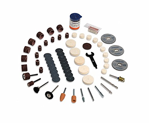

So it turns out my dad had a dremel and he is letting me use it for the bolt mod, although when i dug it out it had none of the pieces he said he may have put them away some where else, so i have ordered the multi purpose chuck, 100 piece muti purpose tool accessory kit.
Which attachment should i use to grind down the posts on the switch plate. i have only done a few with the hand file i have but the file is not completely flat so its making the posts domed. i was thinking the smallest sand paper piece would do.Also which attachment should i use to make little guide holes for the drill bit.
PS. i also bought the flexi shaft tool in hopes of making life easier

That is some nice gear! My Dremel is a standard basic cheapie from the 1980s.
That burr tip still looks large - I have one that is much smaller than the diameter of the primary shaft.
I do all the cutting with a chisel tip blade on an Xacto knife. I do the rough cuts with one blade, pull all the plates apart, and shave the flat tops of the "mesas" with at fresh new chisel tip. Try to do it in a single stroke.
As always, get in very close with your reading glasses and do it 2-handed.
