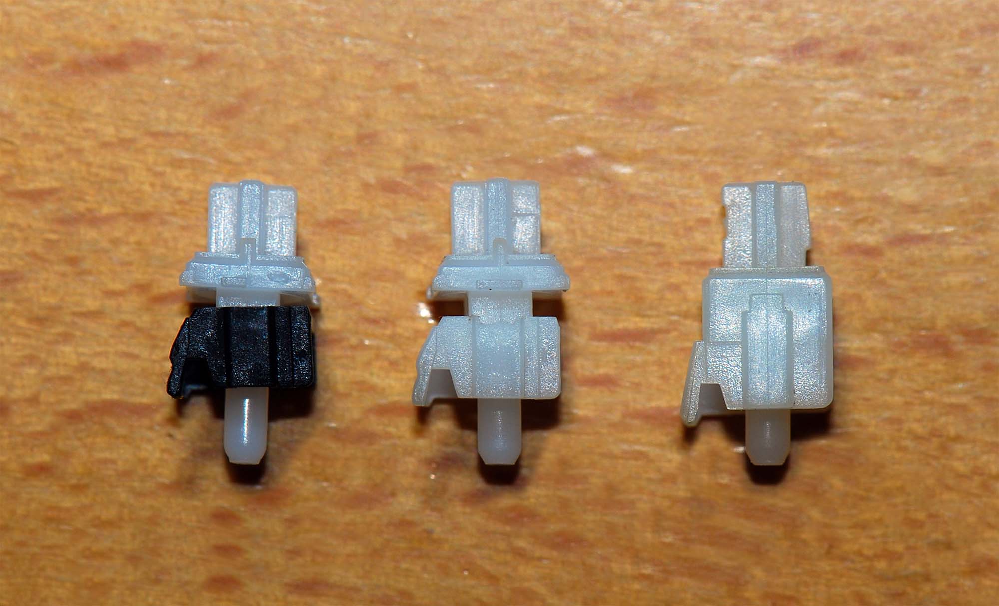

Posted: 31 May 2012, 16:42
by ripster
I think I can safely say you can skip the WHITE.
I have no idea what Cherry Corp was designing that switch for but it ain't no Clicky Green.
Pics stolen from somebody or other
Look for upcoming pics with Watermark saying Ripster. Quality MUCH better.

Posted: 31 May 2012, 17:04
by ripster
Nice WATERmark Limmy...
Anyhoo I'm posting this because if I'm gonna get banned here I want to know upfront this time.
Cherry WHITE 2.jpg (173.63 KiB) Viewed 6090 times

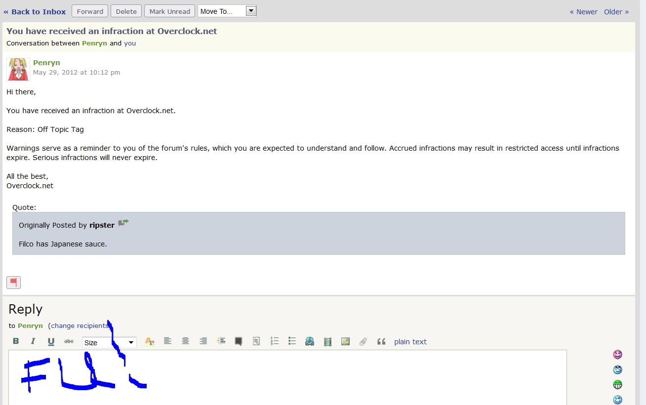

I hope not because OCN did not give a fuck and THOSE guys are tightasses!
http://www.overclock.net/t/881812/tell- ... t_16886472
My most recent infraction point (expires in 30 days and you need 10 to get BANNED so fuck you REALLY have to work at it)
