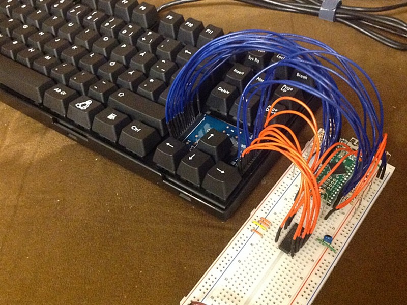

The picture I haven't posted here on DT yet.. My brand new test board is an ISO one =)
