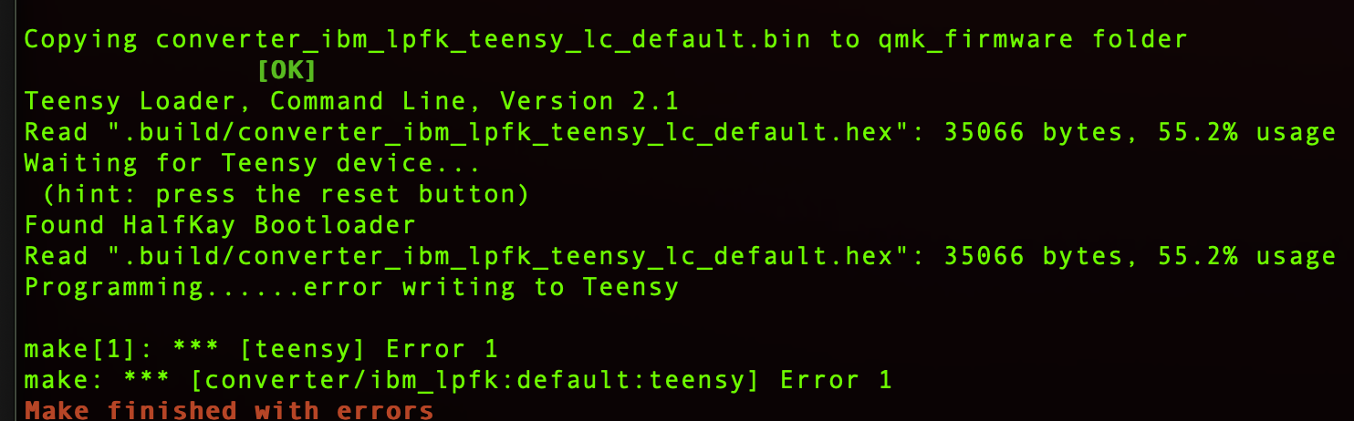

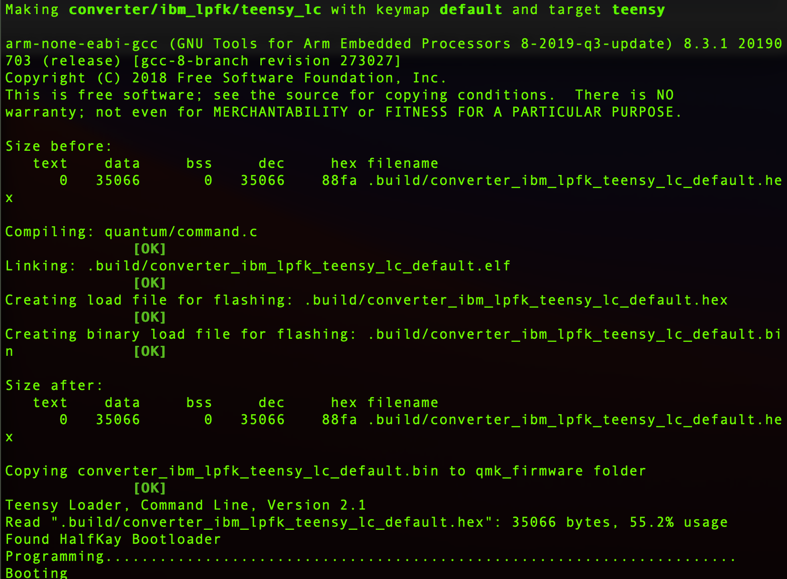

Tried copying over your latest version and replacing my local. When I compile locally with
make converter/ibm_lpfk:default
I get a converter_ibm_lpfk_teensy_lc_default.bin in my qmk_firmware dir. I do not know how to flash a bin to a Teensy LC using Teensyduino or QMK toolbox so instead I use
make converter/ibm_lpfk:default:teensy
It compiles, I press the button when instructed, I get this:
Screen Shot 2021-06-14 at 7.31.02 PM.png (167.54 KiB) Viewed 4324 times
so I run the make command again and the Teensy is still in boatload mode and it works.
Screen Shot 2021-06-14 at 7.40.39 PM.png (398.3 KiB) Viewed 4324 times
QMK toolbox recognizes the device as QMK IBM LPFK keypad converter(FEED:6094:0001). No blink of LEDs, no keystrokes recognized, etc.

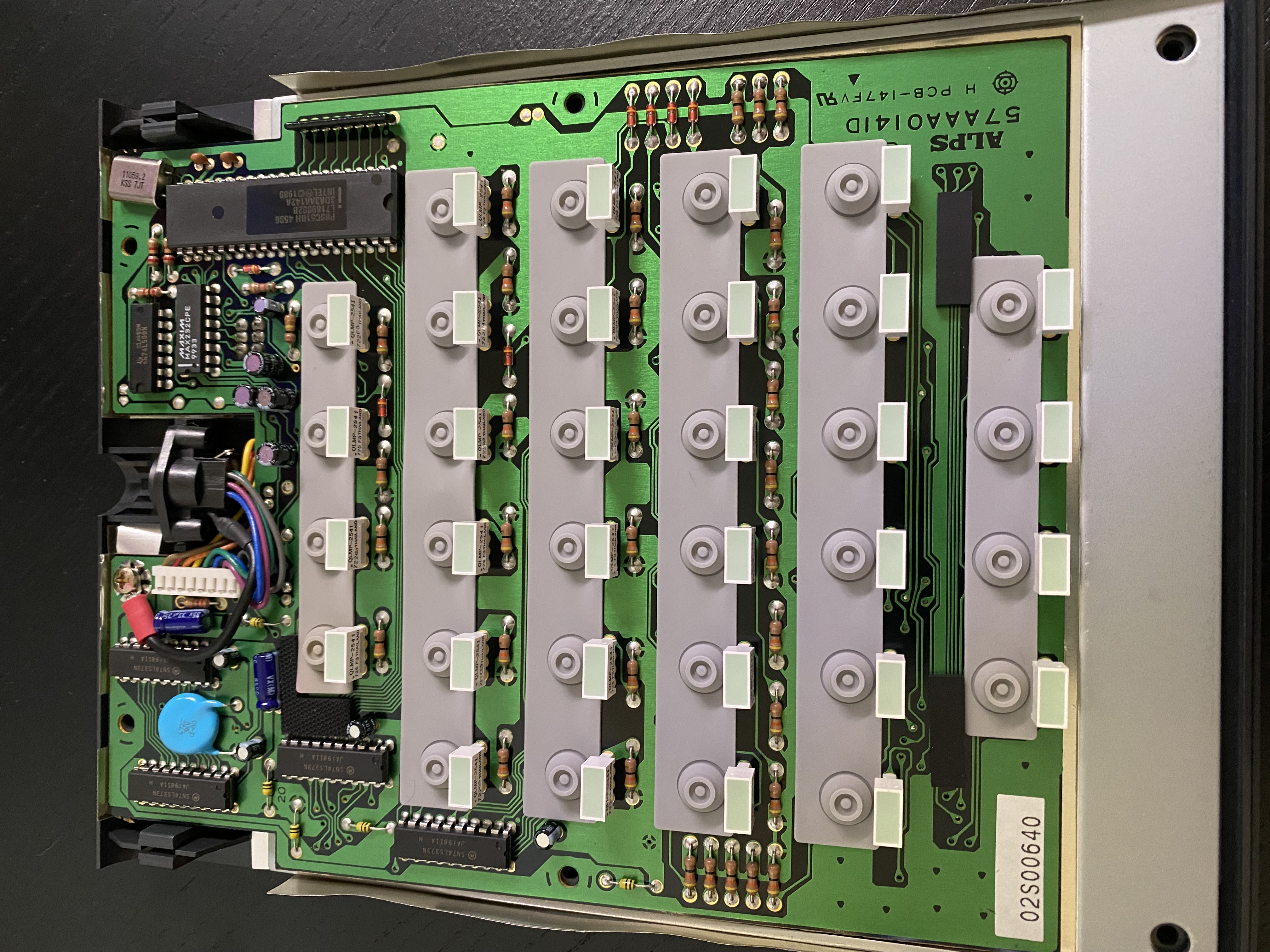

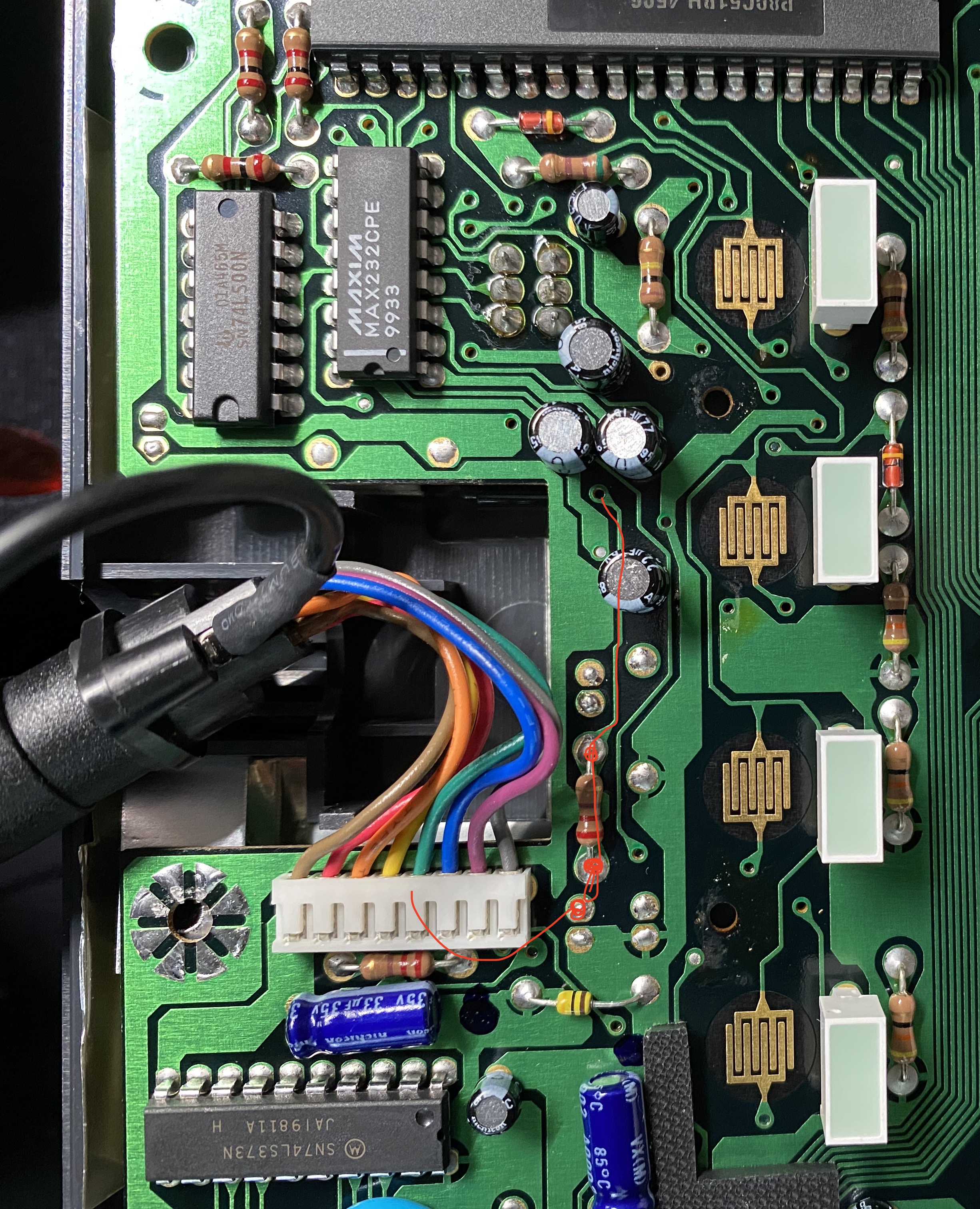

I'll add these to the body of evidence as well... Purchased NIB/sealed and nothing looks too crazy inside.
IMG_0657 copy.jpg (2.74 MiB) Viewed 4279 times
IMG_0658 copy.jpg (3.6 MiB) Viewed 4279 times
Re: IBM LPFK & Arduino Nano.
Posted: 16 Jun 2021, 03:59
by MMcM
Yes, everything looks newish. Did you try measuring power to all the chips? As I said earlier, for loopback mode all they need is 5V and the other signals don't matter. And if there were a short between 5V and ground, USB wouldn't work. Furthermore, I thought the power-on state was to light all the LEDs and the MCU had to run for them to turn off, though I could be misremembering that.

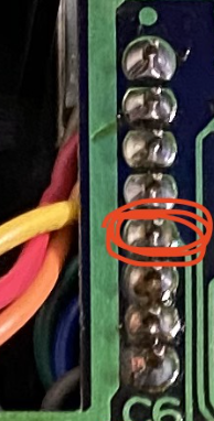

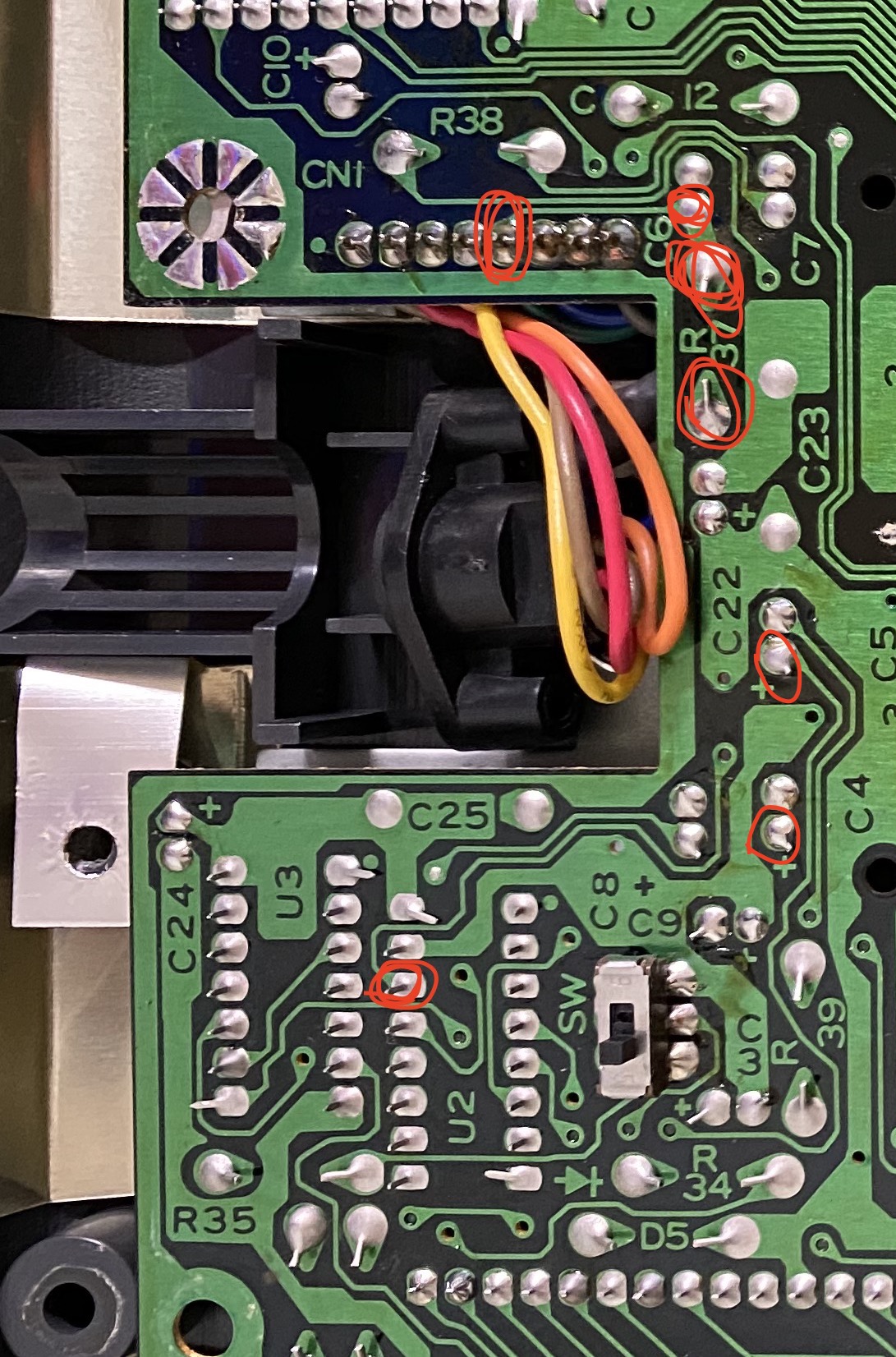

Curiouser and curiouser... It would appear the MAX232 onboard is the only chip getting power. Here I've circled the only spots on the board where I can detect 5v.
IMG_0658 copy.jpg (3.59 MiB) Viewed 4181 times
So either the whole rest of the board is busted? Or is there some signal it's supposed to receive to activate the rest of the board?
Appreciate the flashing tips- I'll give :flash a shot next time just for the convenience of being general purpose!
Posted: 19 Jun 2021, 05:45
by MMcM
Don't assume that the pin numbers on CN1 are related to the pin numbering of the DIN standard.
The pin you have circled on U2 is 14. (The dot on the lower-right is next to pin 1. Count left from there to 8, then cross over and count right.) This chip has 16 pins. Vcc is two to the right of there. You can see from the photo that this is definitely connected to pin 14 of U3. There is a big old trace with C25 written in the middle of it. That chip only has 14 pins, so that's power, too. I bet it's connected to the rest of them, too, but you could check.
Is pin 5 of CN1 really connected to pin 5 of the DIN socket here? I rather suspect it's connected to pin 3.
More importantly, is +5V from your converter really coming into that pin? We're aiming to confirm that this is managing to power these chips.

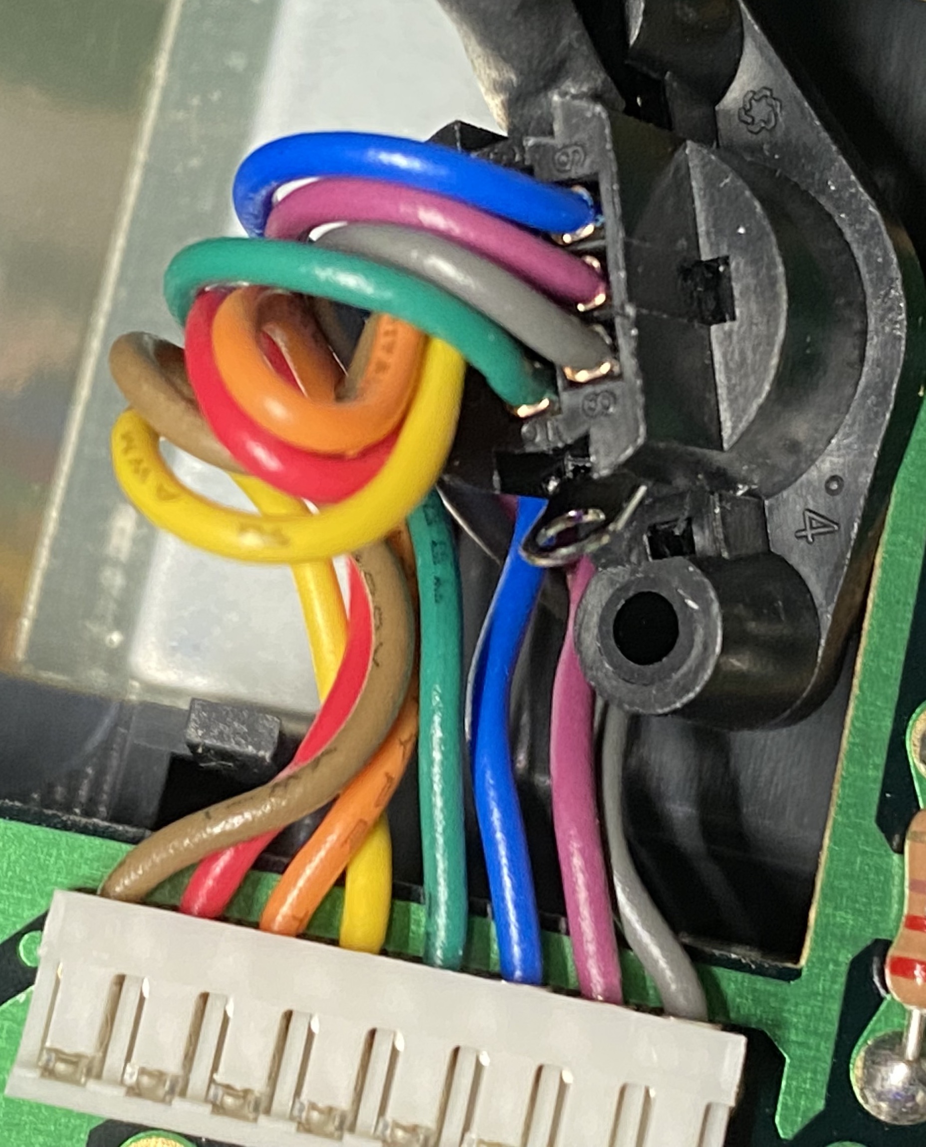

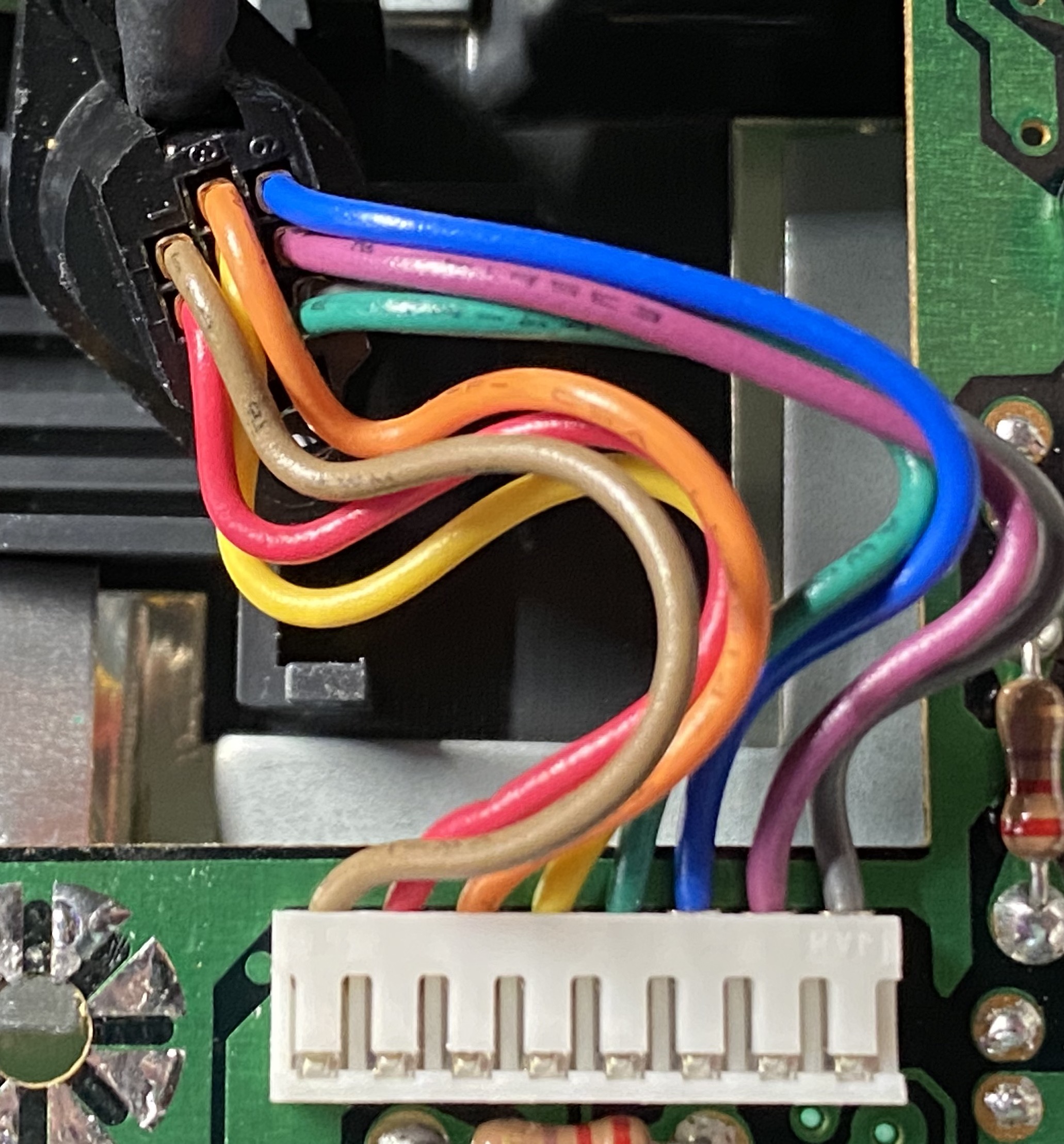

The socket includes helpful numbers that make identifying which colors correspond to which pins even easier.
IMG_0668 copy.jpg (643.64 KiB) Viewed 4136 times
The socket goes:
1 = Brown (ground)
2 = Red (ground)
3 = Orange (TX)
4 = Yellow
5 = Green (5V)
6 = Blue
7 = Purple
8 = Gray (RX)
This matches from top to bottom what one finds on CN1.
IMG_0667 copy.jpg (735.11 KiB) Viewed 4136 times
So on the back side, 5th pin down (green) is 5V. I get 5.1v there with multimeter.
IMG_0658 copy.jpg (565.02 KiB) Viewed 4136 times

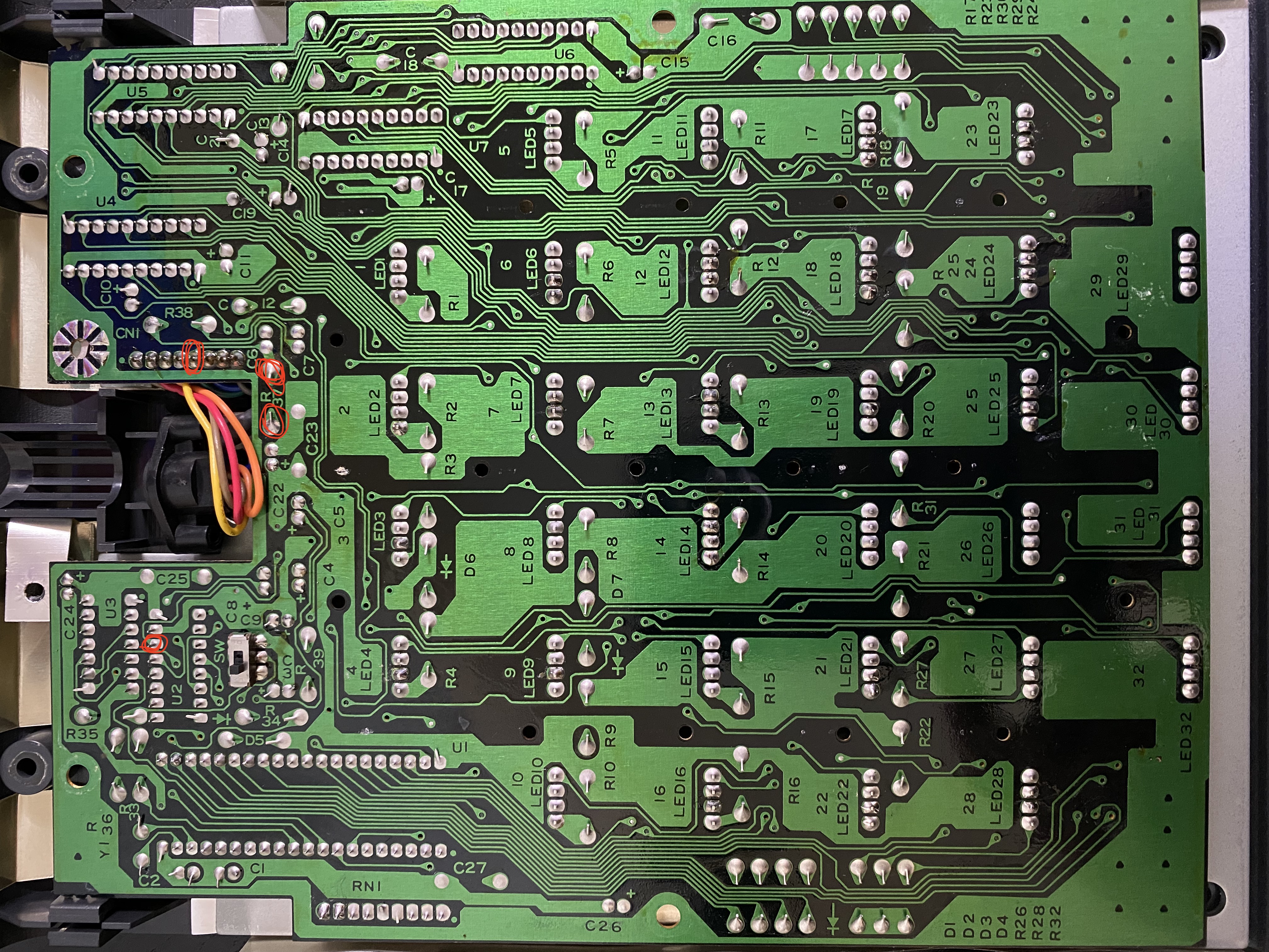

I probed every other point on the board.
Pin 8 on CN1 reads -5.66.
The two pins on R37 read 5.1.
Pin 14 on U2 reads 5.1.
Pin 16 on U2 reads 0.
Pin 14 on U3 reads 0.
C6 reads 5.1.
C4 and C5 show about 0.1 or 0.2
Everything else shows no voltage.
Posted: 19 Jun 2021, 18:09
by jmaynard
Hm. I'd want to know how +5 gets from the junction of C6 and R31 to the board's +5 bus. There's where your problem lies - or at least one of them.
Posted: 19 Jun 2021, 18:32
by raoulduke-esq

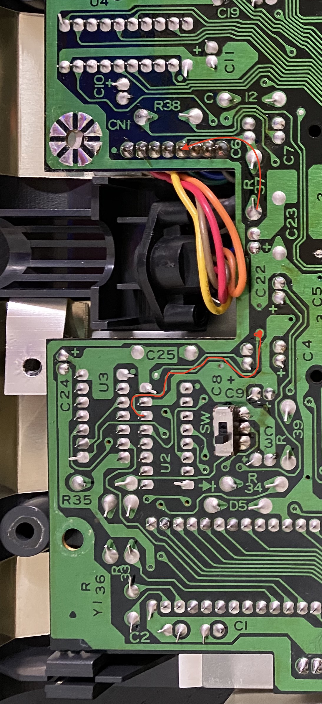

Indeed. Here we can see a tracing of what is currently happening... Maybe we can identify also the path of what should be happening?
Posted: 19 Jun 2021, 20:14
by MMcM
Okay. I see what is happening. I apologize for not noticing this earlier.
First off, the wires on both the DIN-8 socket and the PCB connector are the same as here and fine. Moreover, they are in EIA color code order: Brown, Red, Orange, Yellow, Green, Blue, Violet, Gray.
However, the cable that I have, which came with it, reverses the signals on each row. Did yours come with a cable? I know you've swapped it out a few times and apparently the latest one you have is straight through.
So, you need to reverse the signals on your converter to match what is, in fact, the order on the board. But not the one coming from the standard(?) cable.
