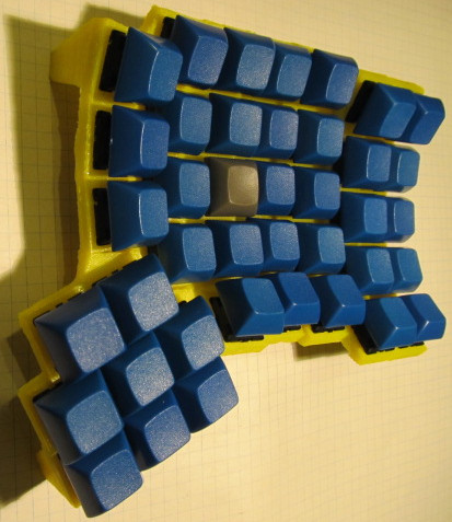

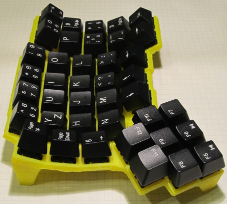

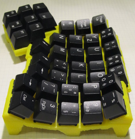

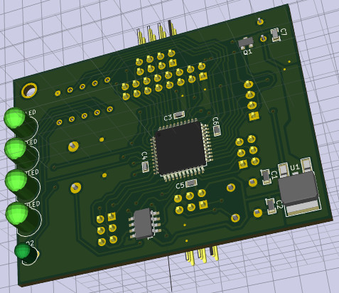

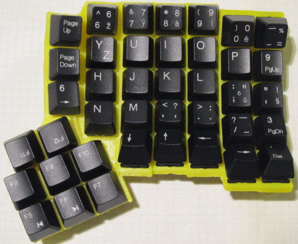

Just to let you know that work is still being done on this.
Current status:

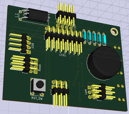

  • electronics is done (maybe I'll add one power filtering capacitor on the left side; it looks like it is not needed but at least a footprint can be added to the PCB)
  • v0.6 firmware ported to v0.7 electronics
  • keywell shape is fixed; there are these changes to keywell compared to v0.6:
    • smaller key spacing by 0.7 mm (it is 18.8 mm now)
    • steeper bottom and top rows
    • more stager on pinkie columns
    • the two top pinkie keys moved nearer
    • make it work better with DSA keycaps
As a result the case is about 2 mm taller, 5 mm narrower and the top two pinkie keys are about 5 mm nearer than they were in v0.6.
It still looks like it will be available by this midyear.

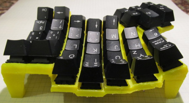

Some pictures of the test switch plate are below. Every time I change the plate shape I print mock-ups like these to check it out. And the renderings of the right hand side PCB. I do not have the real PCB at hand now.

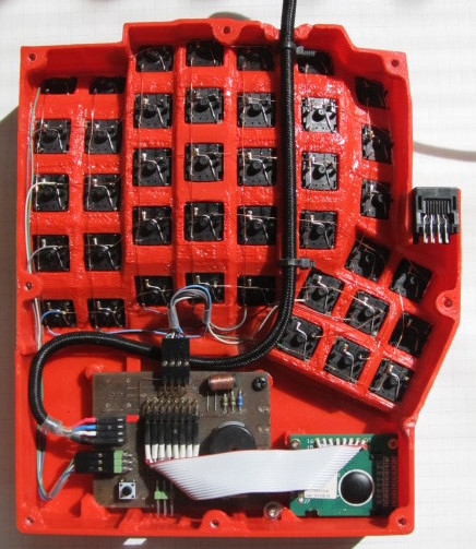

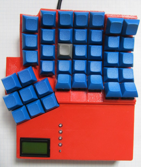

And kko made some progress with his very first Katy v0.7.
Here are the pictures of an unfinished right hand side of the keybaord.
