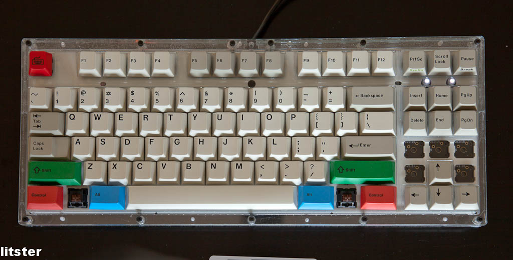

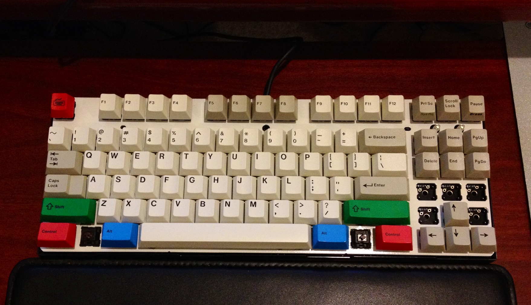

99% done. Picture below is the first Phantom prototype sitting in a Filco bottom case. White plate and no top case still looks pretty good, doesn't it? Due to the USB cable I have connect, I need to to cut out a piece of a vertical support bar to make it fit. Not a big deal.
Phantom Done.JPG (434.49 KiB) Viewed 13795 times
LEDs are not working, probably the firmware isn't done yet. They are white LEDs and I want to see them light up. Also ? is backspace now, and the right Alt is Win key. I had to bend my own wire for the spacebar stabilizer metal bar. Took me a few tries. And the wires are cheap. $5 for 6 feet.
There is a problem with the Teensy legs interfering with switches at F3, F4, 4, and 5. There is a brute force work around (shaving one edge off of the switch bottom casing). Looking into a solution with the Phantom team offline.
Anyone has any good suggestion on the best way to bend metal bars accurately? I can't do it well. And we can't find 7x and 6.25x stabilizers. We need to be able to source these stabilizer bars ourselves.
Oh, BTW, I am typing all this on the Phantom prototype! :-) It is good to see the 1.5x Control and Alt keycaps are being used!
Posted: 06 Jan 2012, 11:18
by trax
litster wrote:99% done. Picture below is the first Phantom prototype sitting in a Filco bottom case. White plate and no top case still looks pretty good, doesn't it? Due to the USB cable I have connect, I need to to cut out a piece of a vertical support bar to make it fit. Not a big deal.
Shit looks so cash.
Also, would be it possible to get ALPS in there?

Posted: 06 Jan 2012, 14:59
by bpiphany
I probably programmed the controller according to the regular Filco layout, that is why some of the keys have the wrong bindings. Are you sure you soldered the LEDs in in the right direction? Can you test with a volt meter if the voltage across the LED pins and ground changes when pressing "lock" keys. The pins on the Teensy should probably be trimmed flush with the top of the PCB before soldering them. I think that was part of my preliminary assembly instructions.. =)
Posted: 06 Jan 2012, 17:20
by litster
Square pad on the PCB is positive, and long leg on the LED is positive, right? I will test with a volt meter next, after work.
I must have missed your instruction on trimming legs flush. That should work.

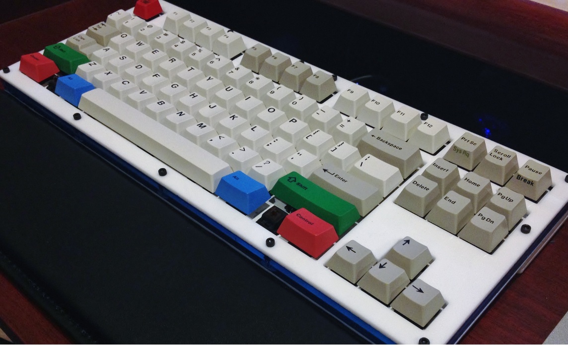

I also installed the Phantom into my white acrylic case. It fits! The Phantom plate is a little smaller than the original Filco plate because Filco's bends down a bit at the top and bottom. Because of that a little cushion on the bottom edge of the inside case, or a piece of really thin foam mat that the Koreans use in their custom cases should take care of that. Anyone knows where I can buy that?
Phantom in Acrylic-small.JPG (204.33 KiB) Viewed 13704 times

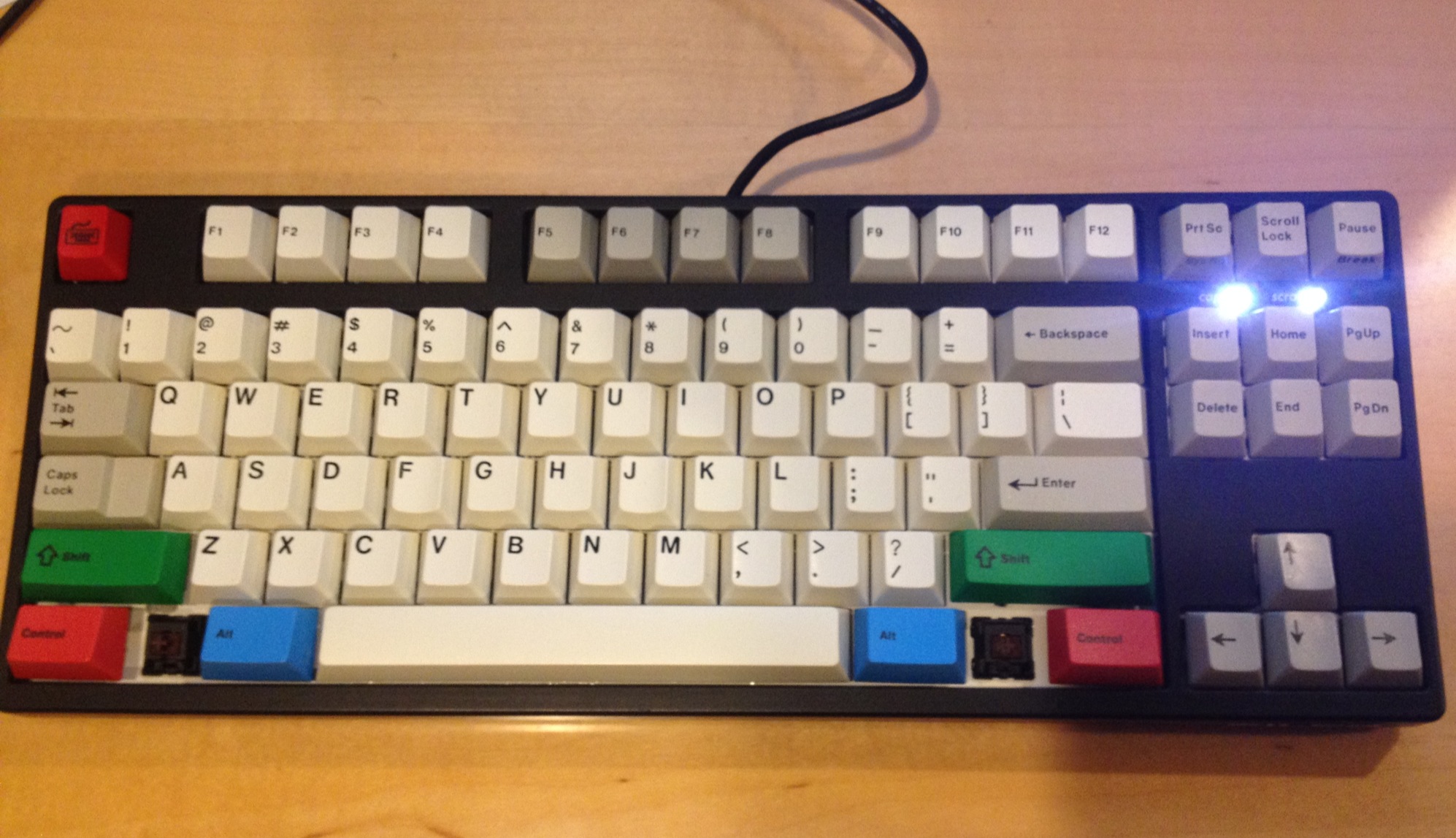

Everyone, please laugh at me now. First I screwed up the polarity of the LEDs. Now, the LEDs are so damn bright! they hurt my eyes while sitting in a genuine Filco Tenkeyless case.
Phantom Bright LEDs.JPG (491.84 KiB) Viewed 13694 times
Need to program the firmware to add strobe tactical mode.
Would a more resistive resistor make it dimer?

litster wrote:Would a more resistive resistor make it dimer?
Glad to see it working =D Yes a higher resistor could do that, I had gotten the ides (quite wrong apparently) that LEDs really wanted to stay close to their nominal current. Turns out it doesn't matter too much. On white LEDs the different color components might drift by a different amount when under feeding them though. It shouldn't take me too long to set up the PWM mode for those two LED channels. After that you have 255 steps of brightness to choose from! But not right now, I've got too much else to do =P

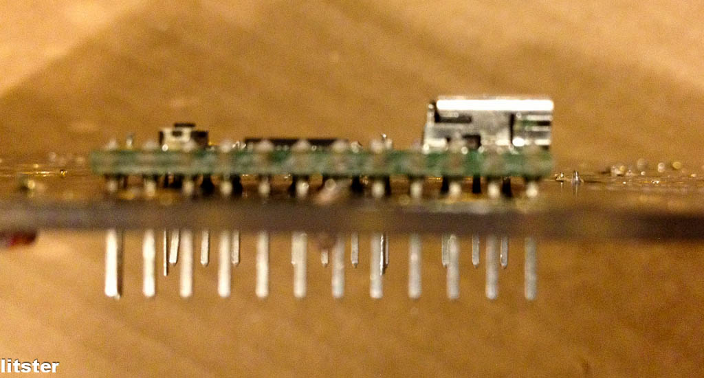

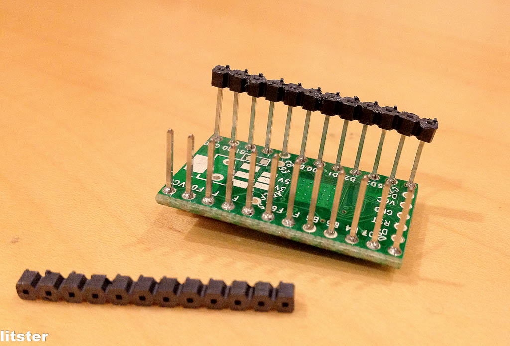

Removing spacers from Teensy legs so Teensy can get as close to the PCB as possible:
Teensy Spacer Removed.jpg (127.2 KiB) Viewed 13646 times
Teensy's legs through PCB, need to cut leg flush to PCB before soldering or the legs would interfere with switches F3, F4, 4, 5.
Teensy Legs through PCB.jpg (104.07 KiB) Viewed 13646 times

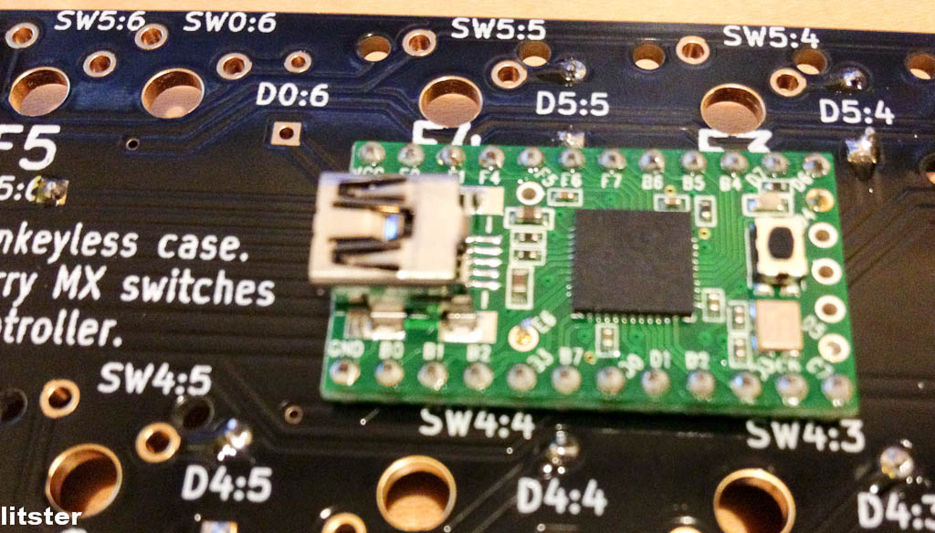

PCB with Teensy soldered:
Phantom PCB with Teensy soldered.jpg (179.4 KiB) Viewed 13646 times
The wrong way to solder Teensy, legs too long:
Phantom PCB Teensy Done Wrong.jpg (147.72 KiB) Viewed 13646 times
Closeup of Teensy on PCB:
Teensy soldered on PCB.jpg (169.84 KiB) Viewed 13646 times

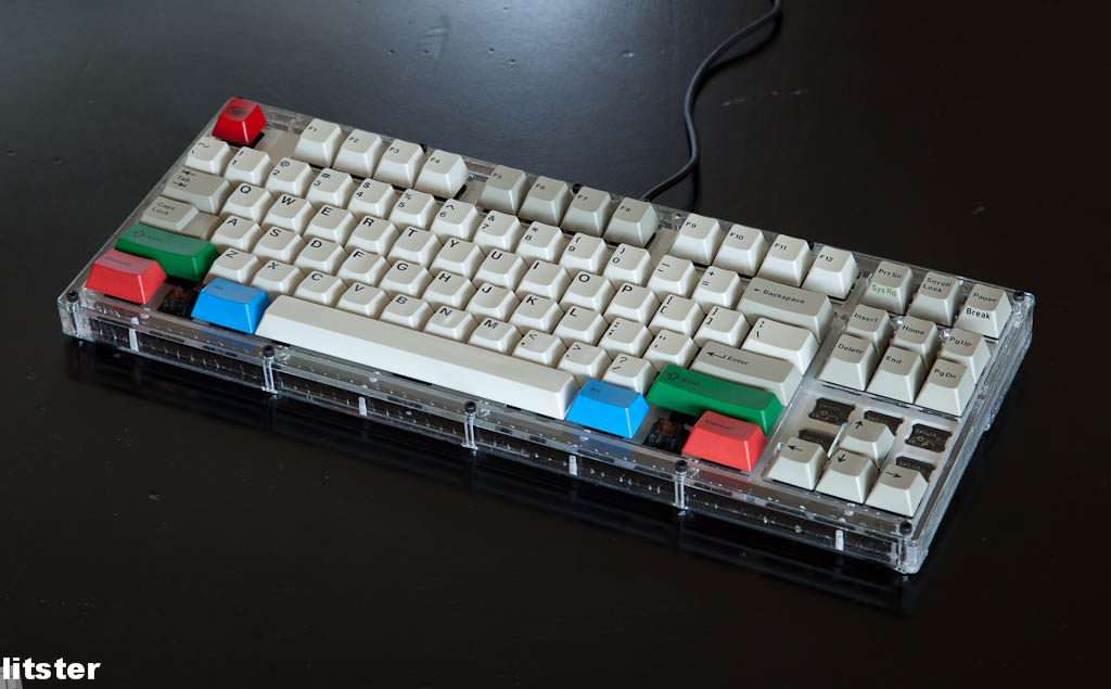

Phantom in Clear Acrylic Case with LEDs.jpg (110.12 KiB) Viewed 13646 times

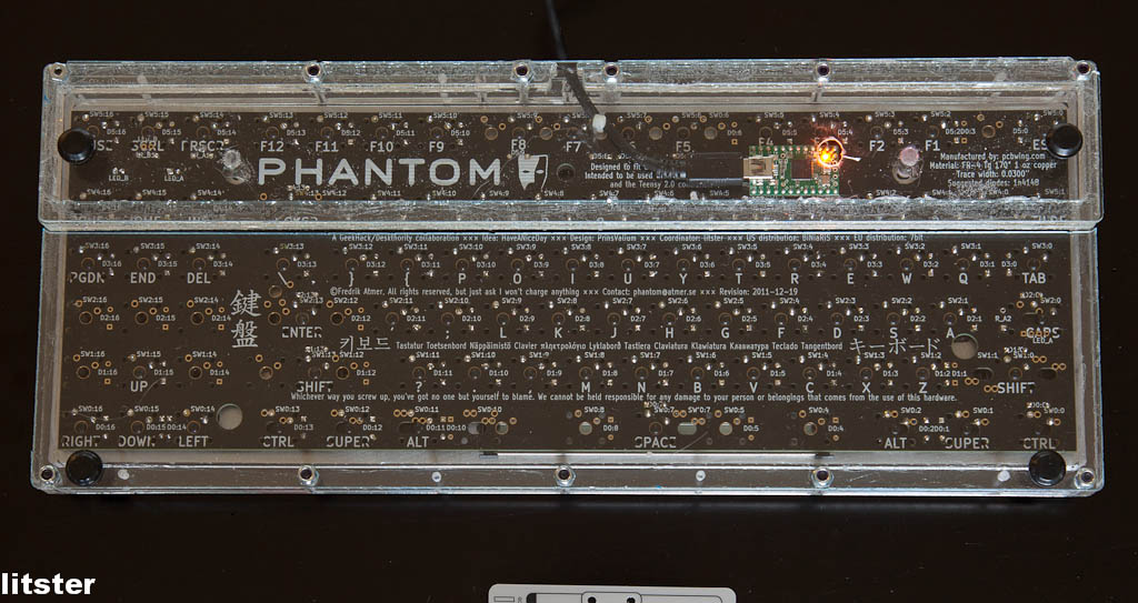

Phantom living inside my mutilated clear acrylic case, which should give everyone a good idea where everything is:
Phantom Bottom View.jpg (157.42 KiB) Viewed 13646 times

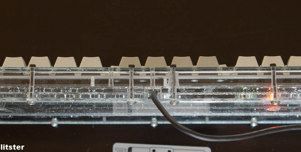

This is probably the first time you see how the USB cable comes out from the back. that opening works perfectly for Filco's cable, very secure. For Phantom, I zip-tied the USB cable to the Phantom PCB, and the hole appears to be too large, but the cable is very secure. I found out Goldtouch's USB cable is exactly the same as Filco's. I just have not tried using it on a Filco, and that it is missing Filco's Ferrite.
Phantom USB Cable Out.jpg (96.75 KiB) Viewed 13646 times

litster wrote:Phantom living inside my mutilated clear acrylic case, which should give everyone a good idea where everything is:
Is the metal plate jutting out from the PCB on every side by a few mm?
