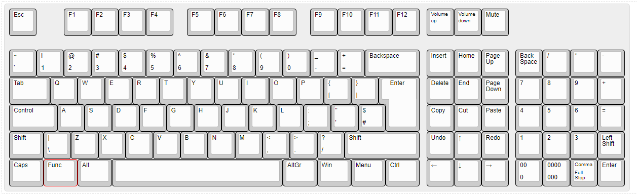

When folks note their interest in a 122 key keyboard, is their specific interest in the exact historical 122-key terminal models with the 24 bunched-together function keys, 5-key cursor design, etc.
Or is it primarily a request for the ability to have more keys than on a standard ~104 key keyboard? 12 extra keys on the top and 10 extra keys on the left side for function keys/custom keys, etc.
Personally I would like a 122 key beam spring keyboard that resembles the Model M 101-key layout but with the extra 12 keys above the 12 function keys, 10 keys on the left which I can use for custom keys (Explorer, media playback, start menu, etc.), the keys between Ctrl and Alt of course, and 3 keys above the Insert/Home/Page Up keys for Print Screen, Scroll Lock, and Pause/Break. I'm not sure if this updated layout would have too much interest.

Ellipse wrote: 27 May 2022, 05:03 Personally I would like a 122 key beam spring keyboard that resembles the Model M 101-key layout but with the extra 12 keys above the 12 function keys, 10 keys on the left which I can use for custom keys (Explorer, media playback, start menu, etc.), the keys between Ctrl and Alt of course, and 3 keys above the Insert/Home/Page Up keys for Print Screen, Scroll Lock, and Pause/Break. I'm not sure if this updated layout would have too much interest.
That is exactly what I want - modern 104 layout with extra keys. Plus nav cluster doesn't make much sense in 2022.

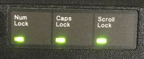

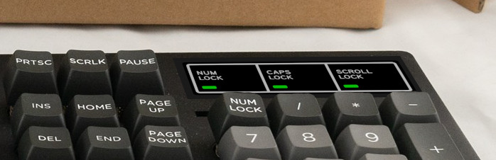

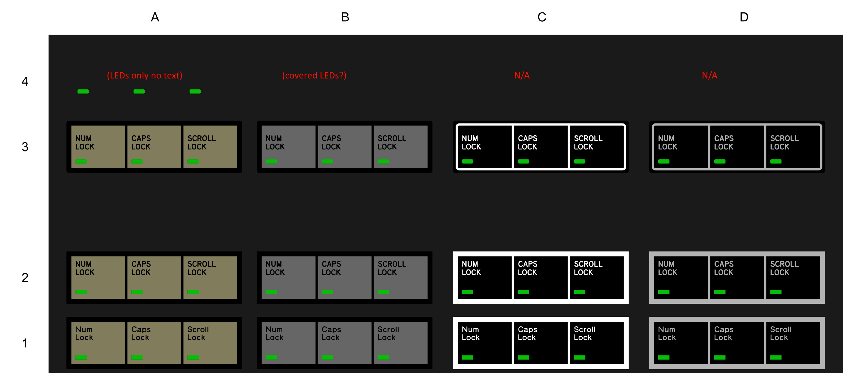

What do folks think about the new beam spring LED overlays? They will be Model M spec so that they can be used on the original Model M keyboards too (maybe if you use the new Model F project keys on a Model M or are custom adding overlays to the F77/F62?). A big thanks to Zed for creating these overlays.
In the coming weeks I expect the factory to start production on these. It may be possible to offer additional designs if there are any suggestions, but not sure yet. There may be a limit of designs so not all of the below designs may be produced.
LED overlays.jpg (312.8 KiB) Viewed 11386 times

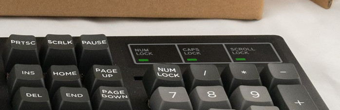

@Ellipse: NICE, I love the fact that now we have someone else (other than Unicomp) producing additional overlay designs!
Of all the presented options, I think the new beamsprings would best fit option D3. (because it's not too-in-your face, and all-caps matches the all-caps on other keys, such as PAUSE)
But maybe I would reduce the contrast even more a little bit, here I set opacity of the overlay to 40%, effectively reducing contrast:
When it comes to additional designs, I would also love to have available one that matches exactly the original IBM M13 led overlay design. These would be usable for the new beamspring keyboards too, but it would also be possible to use these to refurbish original IBM M13 keyboards. Unicomp doesn't sell this, so there's currently nowhere to source these:
Note that the black M13 overlays have black borders with very-dark grey insides. The very dark grey is so dark, that it's almost looks all-black when viewed from a distance.
Another design that I would like to see is top-aligned leds but with original IBM style. Let me explain, as you may know, current Unicomp full-size keyboards have top-aligned led lights:
Unicomp sells a couple overlay variants for these, but none try to look like original Model M overlays.

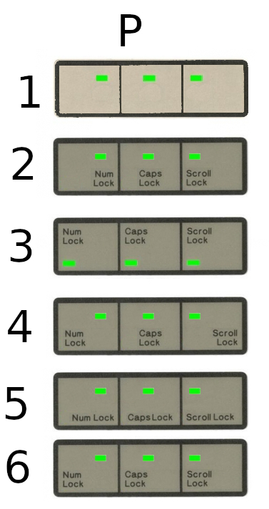

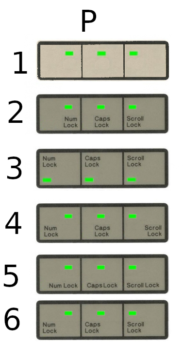

About a year and a half ago I drew up a couple ideas for the purpose of discussion:
Note: P3 is the original IBM overlay.
I personally liked P6, and P2 the most, and I think people overall gravitated towards P6 on chat.
Also would be great to have the P6 layout, but with black IBM M13 colors.

Ellipse wrote: 27 May 2022, 05:03 When folks note their interest in a 122 key keyboard, is their specific interest in the exact historical 122-key terminal models with the 24 bunched-together function keys, 5-key cursor design, etc.
I believe I mentioned it earlier in the thread, but yes ideally I'd prefer a standard 104 layout plus extras.
I'm not sure exactly how the plates work, would it be possible to split some of the 2U keys into separate 1U keys? For example I'd love the numpad to be all 1U keys, but that's not a deal breaker.
Basically, more or less standard 104 layout as a starting point, and then IMO the more keys you add on the better. 10 keys to the left, 12 extra function keys, more numpad / nav keys, etc. all are useful for me.

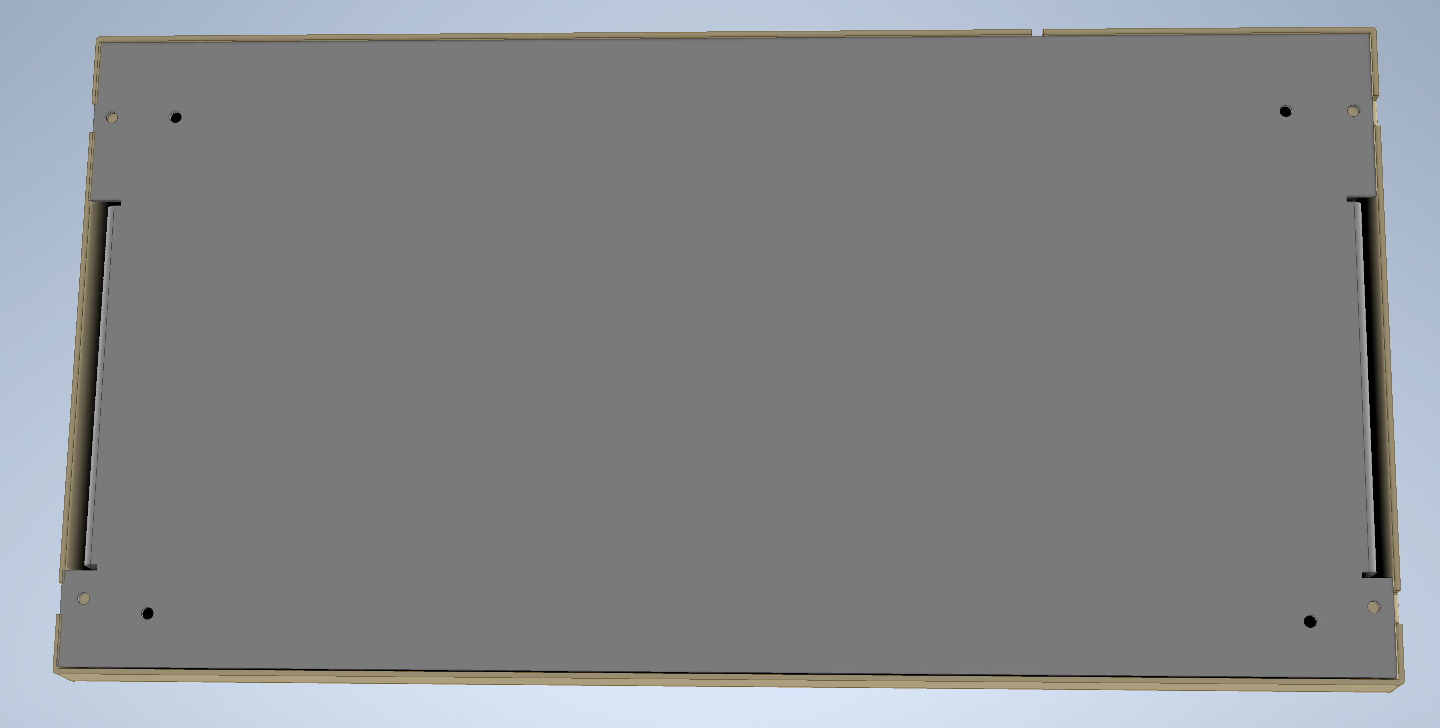

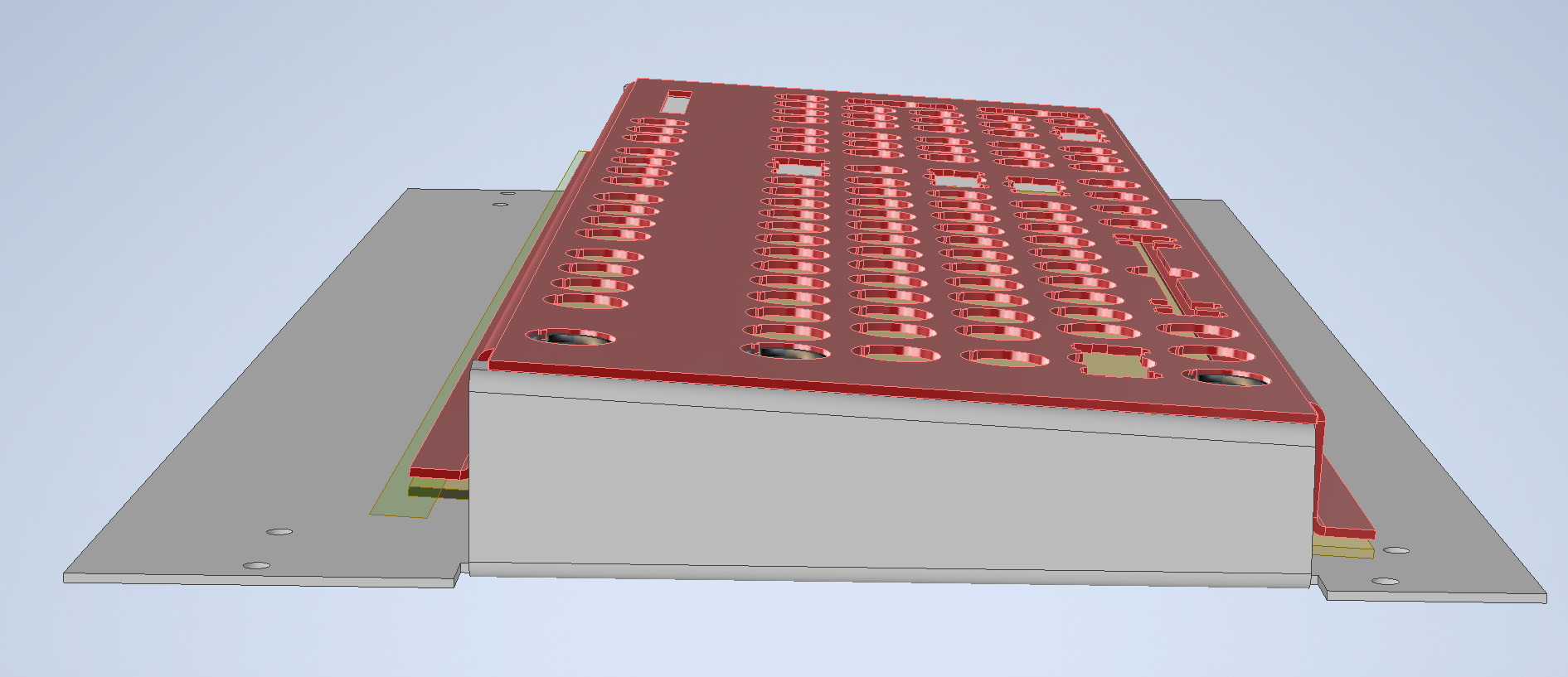

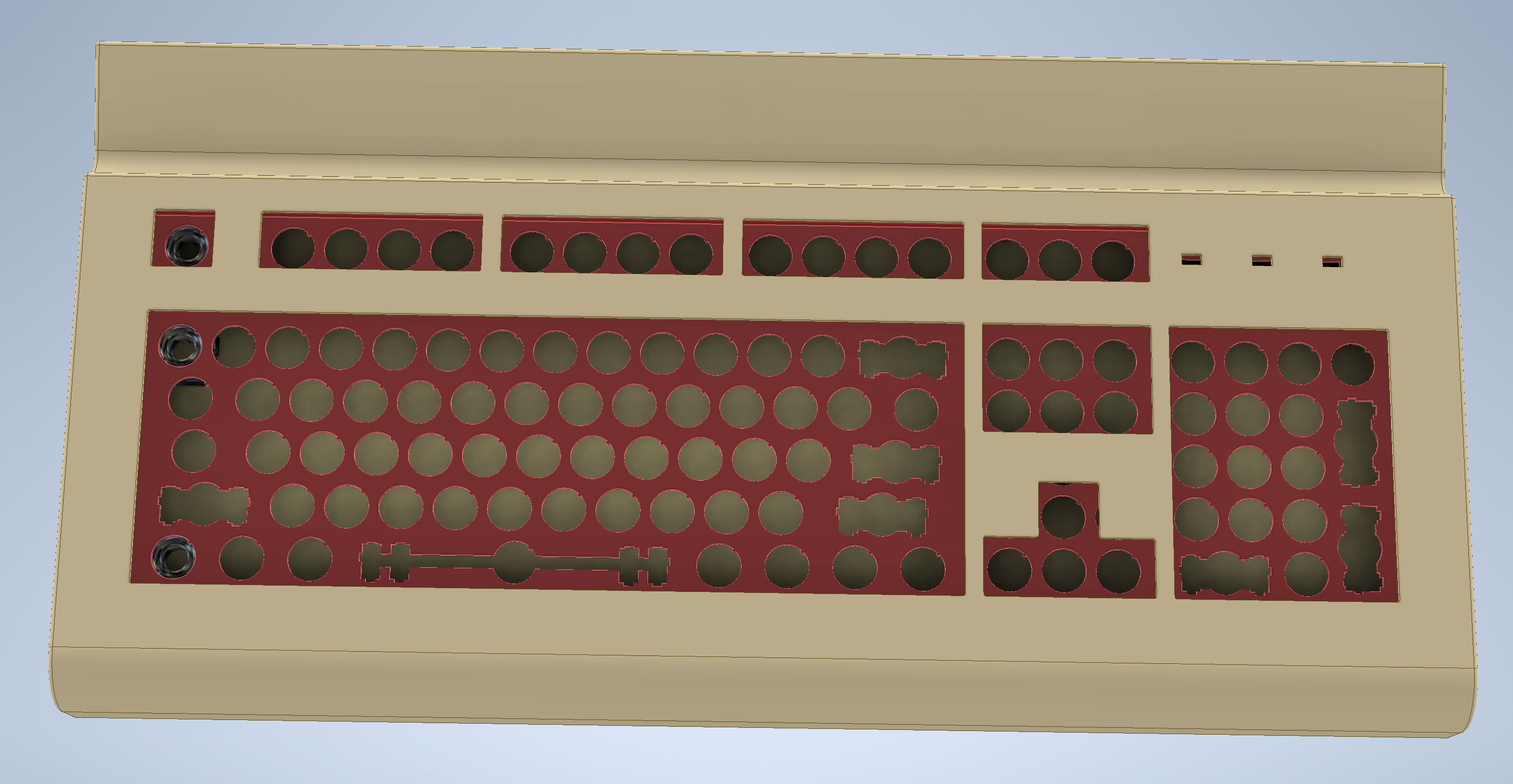

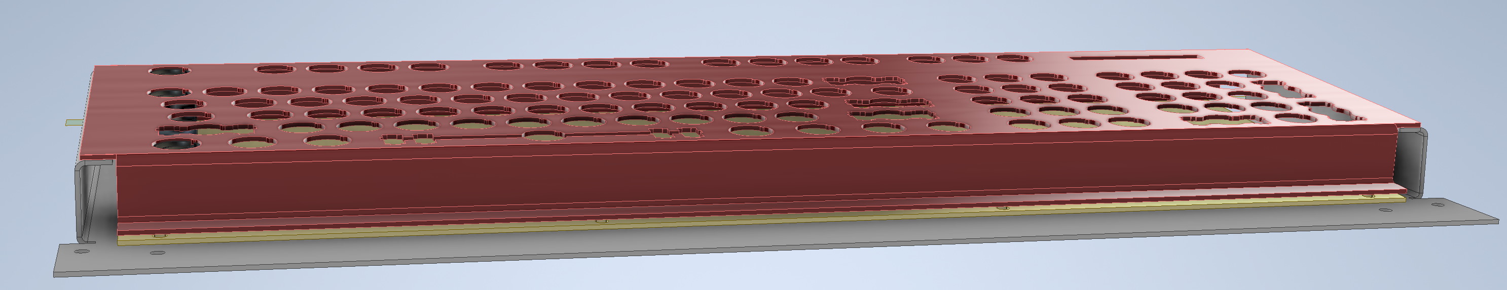

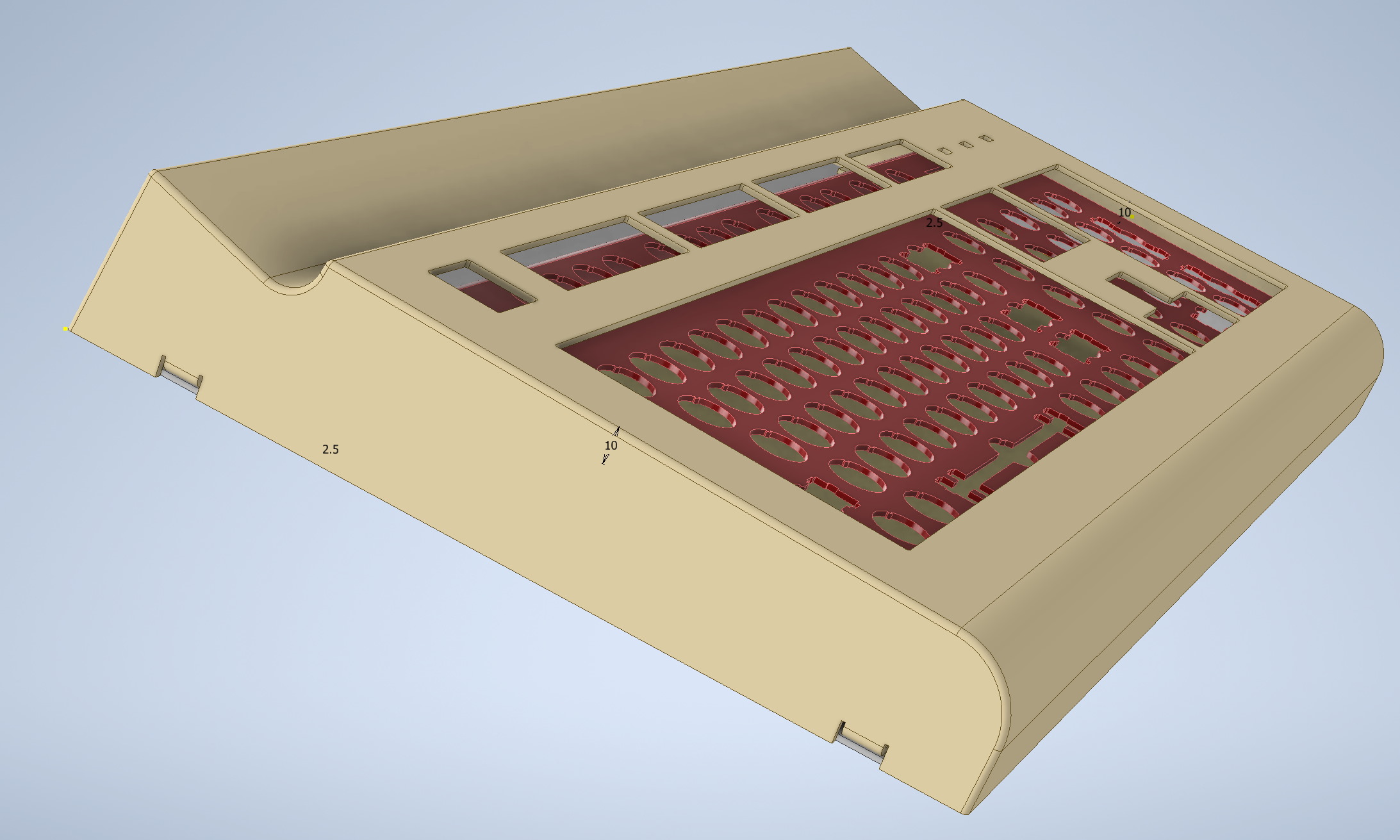

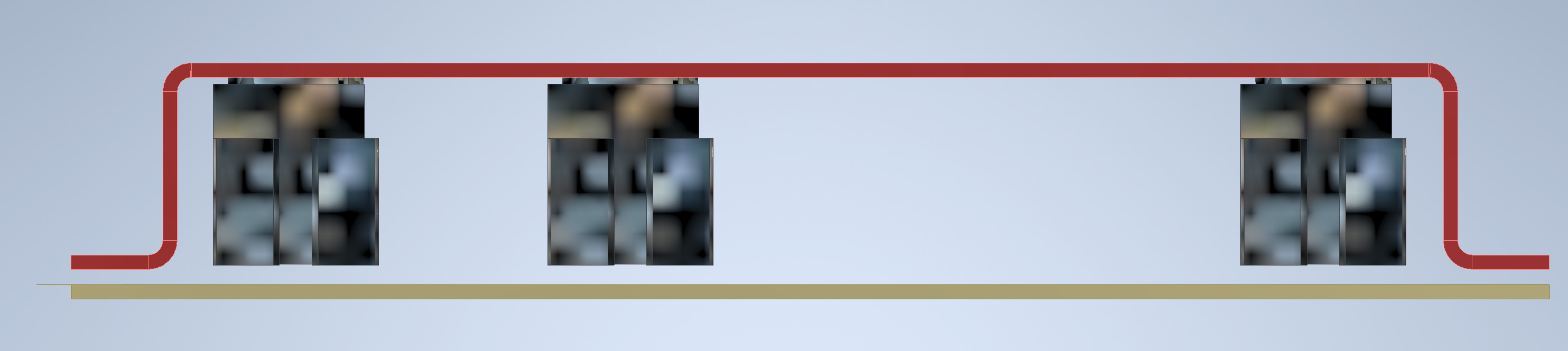

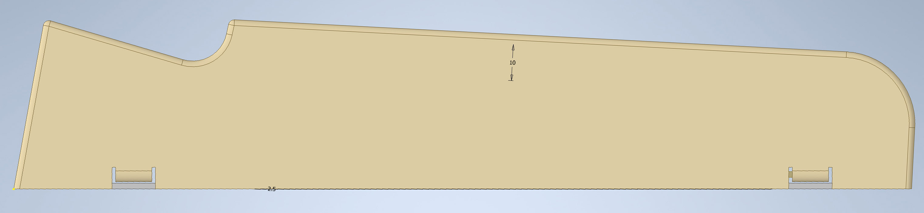

Here are some updated photos of the draft beam spring 104 style design. The overall case design is unchanged for the time being.
I would certainly appreciate any of the side profile measurements on the various beam spring cases other than the 3278 which I own. The goal is to have some cases inspired by the profiles and designs of various IBM cases, assuming the mold exterior parts can somehow be combined to keep costs reasonable (then it would just require different mold cores).
My first IBM style design posted a couple months ago was a combination of some IBM cases but I'm thinking maybe I should just do one case for each main variety (5251, 3278, 3101, maybe the 66 key beam spring?).
Of course of we go with a mold instead of CNC milled, the bent tabs for the top case would be removed and you would not see them. The top and bottom case would be assembled with posts on the inside of the top case.
Below are some details on the beam case design, to be more in line with the originals.
Top case (now at an angle as requested)
.....Top inner assembly ("TIA")
..........Inner foam
..........Beam Module
..........PCB
..........Foam or rubber sheet below the entire PCB
.....Bottom inner assembly ("BIA")
Bottom case
Notes on the PCB: the PCB is secured to the top+bottom inner assembly in a different way from round 1. The PCB touches the area where the top+bottom inner assembly are screwed together. To avoid issues, because the metal inner assembly cannot touch the PCB, on the top side, there is a small mylar strip glued or taped to the top inner assembly as you would see with the original IBM beam spring keyboards. On the bottom side of the PCB, the large foam mat has some holes in it for the screws so that the PCB does not contact the metal parts. The PCB and foam pieces are not shown in the photos (you can see a gap where the PCB would go, in between TIA and BIA.
The new TIA has slightly larger holes in the TIA, so that the modules will not fit into place. This will make assembly less secure - the beam modules will not be securely installed in place in the TIA; instead they will only be secure when the inner assembly is completed. Before then, the beam modules can be easily moved out of place. The reason for this is to reduce the contact between TIA and the beam module, in order to reduce the sound (that is why a foam is added). The foam allows a reduction in the noise of the mechanism. The goal is to eliminate the ringing sound when typing. This part was not in the previous beam design. The colors shown are all false colors designed to maximize visibility/contrast of the various parts. I expect the TIA to be black and BIA to be the same IBM gold type finish.
Screws: Case screws will be hex countersunk/flat top, 6-32, 1/2". Inner assembly screws will be standard + Phillips, the same used with the F62/F77. The TIA has holes and the BIA has threaded holes. The threaded holes are not shown in the photos.
