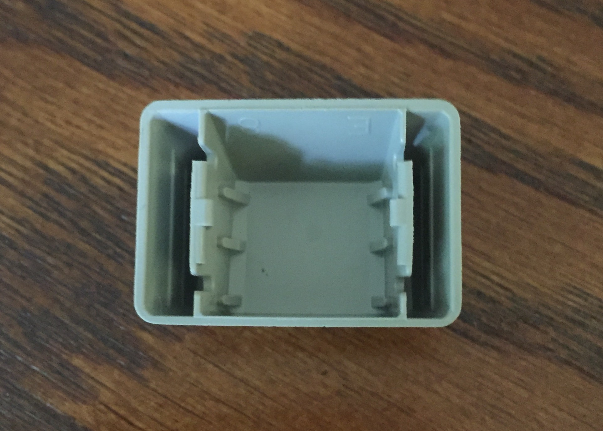

Agree with 7bit, with a twist. You just leverage the same keystem as the stabilizer on oversized keys. So the keystem is always the generic 2-piece keystem base (regardless if it is an active switch). Then the caps just snap on. A picture below of a 1.5u to add context. For the anything >1.5u, you just have multiple of these oversized clips (2 for anything ANSI with ISO enter needing three. Definitely doable. I would be up for helping to fund mold costs (assuming I get a cut until reimbursed).
Any extra stems we need, we source (plenty floating around without tops), or crawl to Unicomp when that supply dwindles. Moral, avoid designing stems.
Sorry for hijacking the thread with this, but we (BS fans) need help. I'll let it rest, but demand will be there... You build it, they will come.

DS caps for buckling spring stems would be in-freaking-credible. The best part is that although multiple molds would be needed because of the larger keys, there would only be a single "row" profile for them all, thanks to the IBM curved plate.

regarding buckling spring project. the cost of designing a new set is roughly $20k, it's quite a commitment. Cherry MX has the numbers to cover the expenses, everything else is quite risky, but if there's a real interest we can talk about it.

Advantage of BSpring keycaps is you don't need row profiles. Does that affect the estimated costs in any way?
Or is the goal here to create further profile to buckling spring boards?

yes, that definitely helps, but still you have multiple molds (1.5u, iso enter, shifts, ...)
