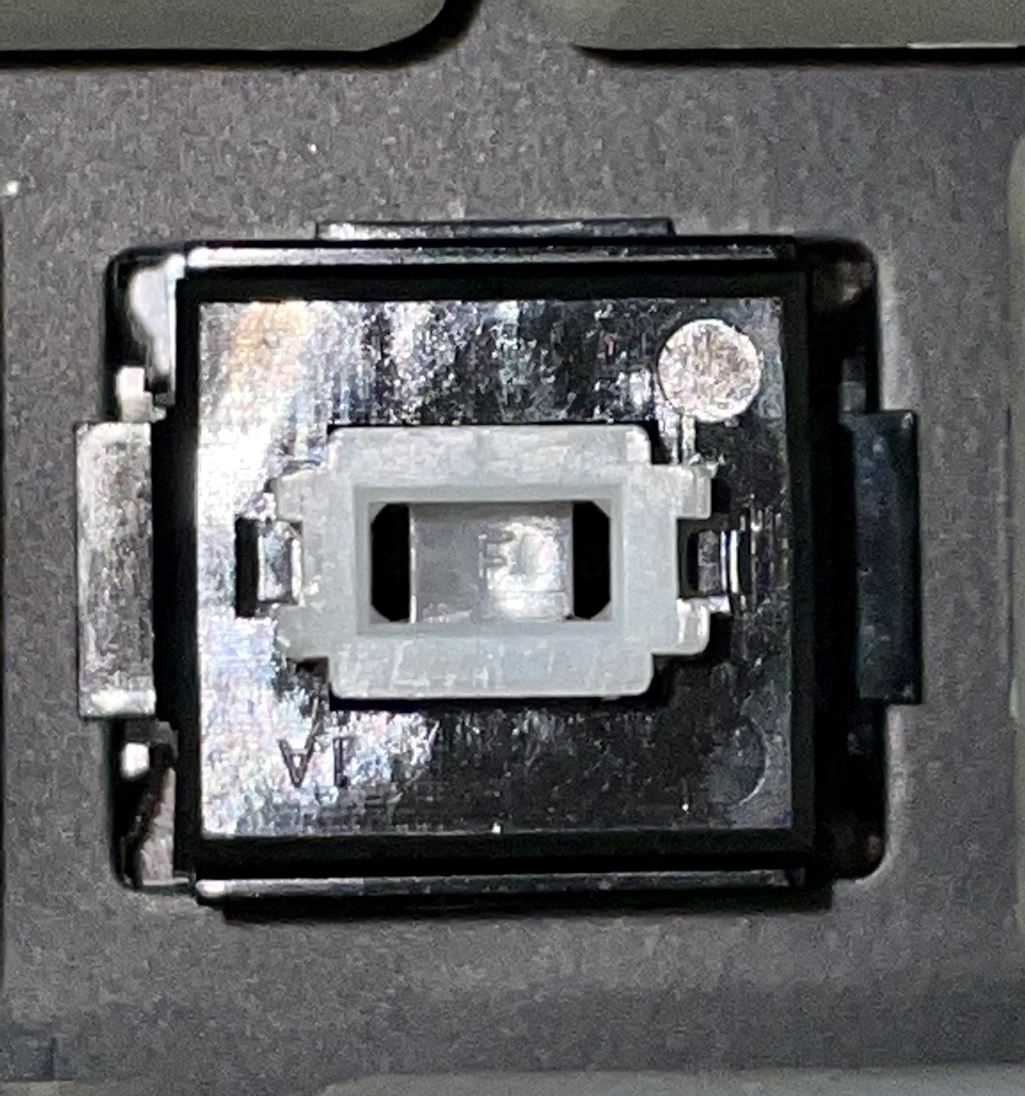

Yes it should work without issues. Alps clones should also work. Below is a picture of pine white alps with the original slider on the left and a Matias slider on the right. The Matias sliders it slightly smaller but works.
- 678E61F5-3FE1-4AF2-9337-0A3D8BE0EE16.jpeg (311.05 KiB) Viewed 11336 times

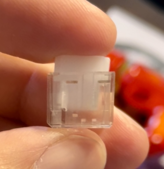

Re: Alps Appreciation
Posted: 16 Sep 2022, 07:35
by amigastar23
Polecat wrote: 16 Sep 2022, 04:11
amigastar23 wrote: 16 Sep 2022, 01:42
I don't mean soldering but only exchange the Black Alps sliders into the housing of my White Alps Keyboard.
My turn to not understand. They should swap, but what exactly are you hoping to accomplish by changing just the sliders from white to black?
I want to remove the clicker leaf and make a linear switch like in this video:
https://www.youtube.com/watch?v=vsJq434UYTA

So you're saying i can make linear Alps with the white Switches? They are bad quality, though. That's why i want to exchange them.

Polecat wrote: 16 Sep 2022, 06:03
thefarside wrote: 16 Sep 2022, 05:24
Yes it should work without issues. Alps clones should also work. Before is a picture of pine white alps with the original slider on the left and a Matias slider on the left. The Matias sliders it slightly smaller but works.
Wait, are those really Alps switches? Those are what I've been calling the "mystery switches", from 1992-93. Unbranded upper and lower housings, 1x mold numbering, and complicated Alps-style switchplates. They feel and sound like early SKCM switches, nothing like SKCM from 1992-93. I've found those in Datacomp keyboards, and they are hinted at in the wiki in a couple places. But who actually made and sold those, and why is the Alps branding missing?
edit: here's a wiki link with some photos of the mystery switches.
wiki/Datadesk_Switchboard
Note they're described as "incorrectly molded", but I find that hard to believe, considering how many must have been made. I would suggest that there were no Alps markings because 1) these were not made by Alps (someone else bought their tooling perhaps?) or 2) that someone specifically ordered them from Alps with no branding.

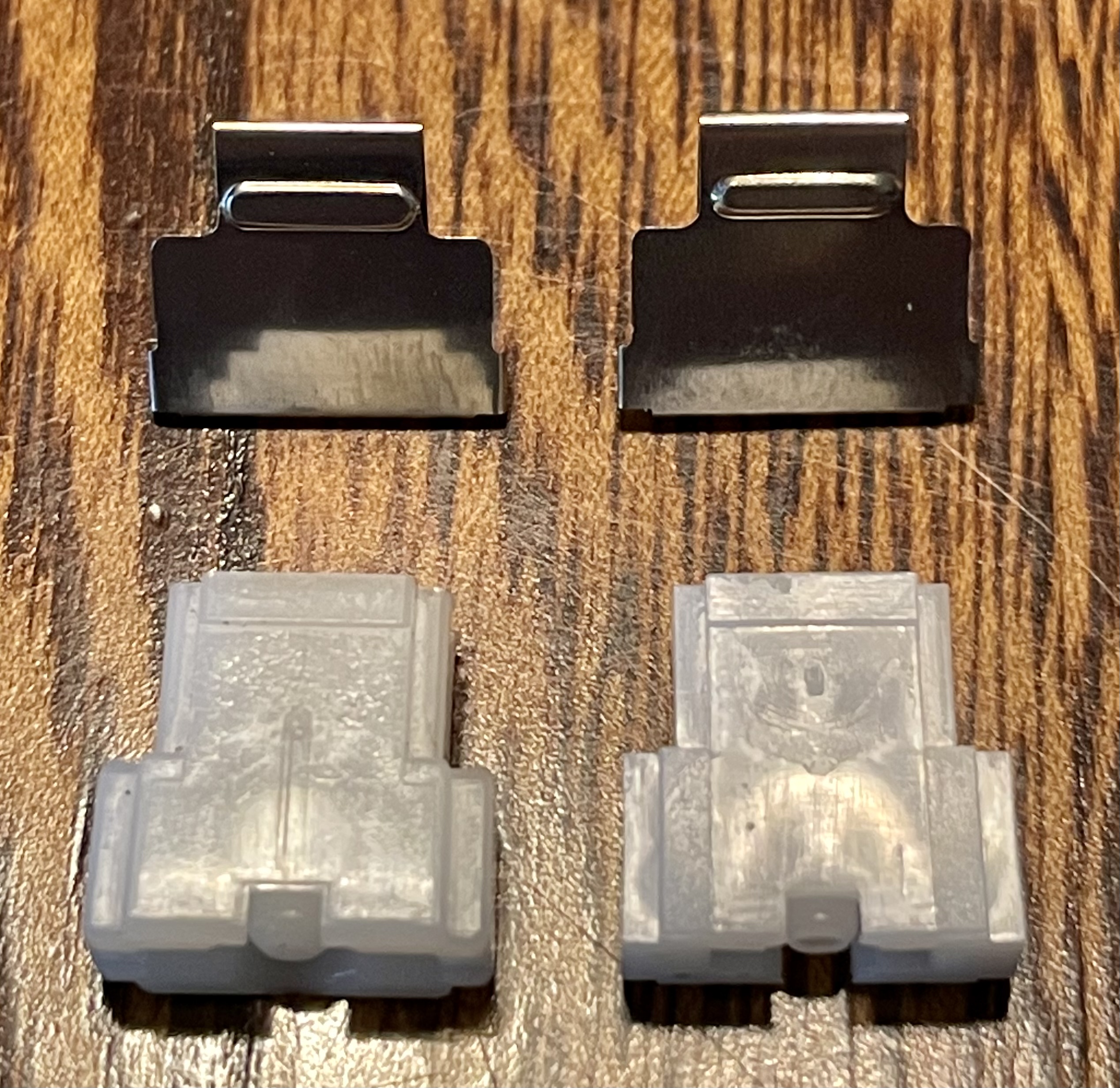

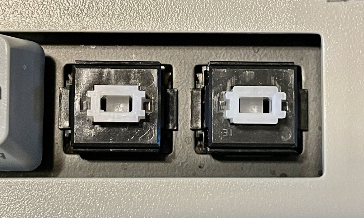

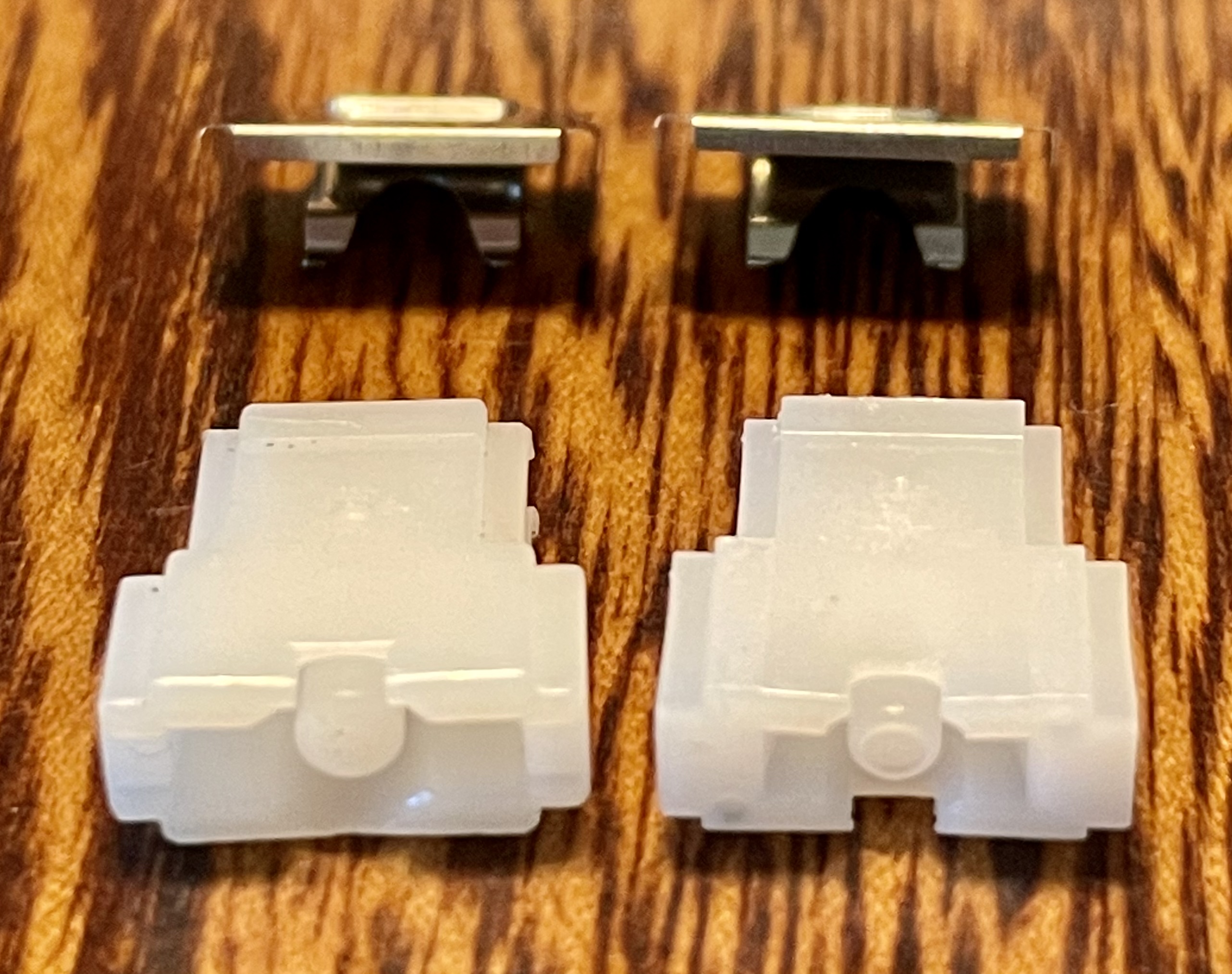

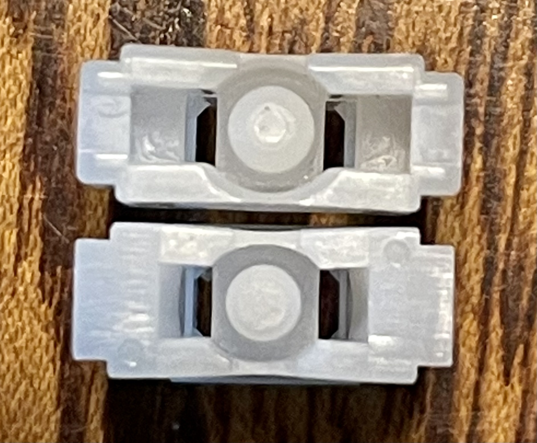

Sorry for the confusing post! The Matias slider was on the right side. I presumed the switches were alps because they looked, sounded and felt like genuine pine alps.
That keyboard is a Datadesk Mac 101-E. Below are some more pictures for reference. This was an eBay find with one picture that looked rough/dirty. Turns out it was perfectly preserved with two covers and the outside cover was dirty. Inside appeared NOS. The inner cover was a membrane plastic molded to the keyboard to cover the whole thing.
The stem on the left control key broke off and I wanted to see if Matias parts could be used as replacements for alps. I learned:
- Alps sliders are bigger than Matias and won’t fit in Matias top housing
- Matias sliders fit in alps top housings but are more wobbly but feel the same
- Matias housings can’t be used with pine alps due to the smaller simplified switch plate
Genuine alps does not fit in Matias housing:
- Genuine alps does not fit in Matias housing
- 9DABA226-B41B-42D7-9FF2-9044E84FBB08.jpeg (49.78 KiB) Viewed 11198 times

Switch closeup:
- Switch closeup
- 78DC09CD-BC46-4D35-8DA9-802AE2C92597.jpeg (918.13 KiB) Viewed 11198 times
Alps on the left, Matias on the right:
- Alps on the left, Matias on the right
- 878AFC89-6F5F-4CBC-81D8-B0C4BDF3ADCB.jpeg (1.53 MiB) Viewed 11198 times
- 694701E4-2CEA-4E9F-9858-C98B81182B24.jpeg (1.02 MiB) Viewed 11198 times
Alps on top, Matias on the bottom:
- Alps on top, Matias on the bottom
- 69FB85EC-B4EF-47AF-8CE9-A98B4FBBFA22.jpeg (562.72 KiB) Viewed 11198 times
Hope this helps! If there’s anything else I can provide just let me know.

Yes, it's the click/tactile leaves that determine the switch type, not the sliders. The slider color was only different so they could tell the switches apart visually once they were assembled. That's why I was confused by your questions. If you have a better set of sliders in a different color you can use them, but changing just the sliders won't change the sound or feel of the switches.

thefarside wrote: 17 Sep 2022, 12:16
Thank you, that's great information on the mystery switches. They do indeed sound and feel like early Alps SKCM. I'm really hoping we learn the truth about these. I have four or five Datacomp keyboards with them, and there are other examples posted here in various places.
We need to compare the dimensions to genuine branded Alps switches to see if the parts interchange. That would help to confirm whether these switches were built using older Alps tooling, rather than being clones. I think someone suggested that Forward might have made these. Datacomp is another possibility, especially considering they have been found in Datacomp keyboards.

Polecat wrote: 17 Sep 2022, 18:50
amigastar23 wrote: 17 Sep 2022, 06:55
Although you can lube them.
he he he he
BTW, before I saw this page, I did swap the sliders from a pine white to a bamboo black. They fit just fine.
