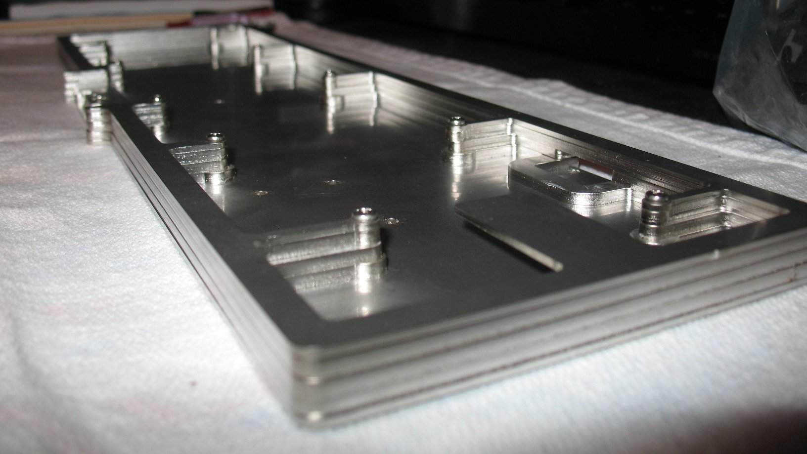

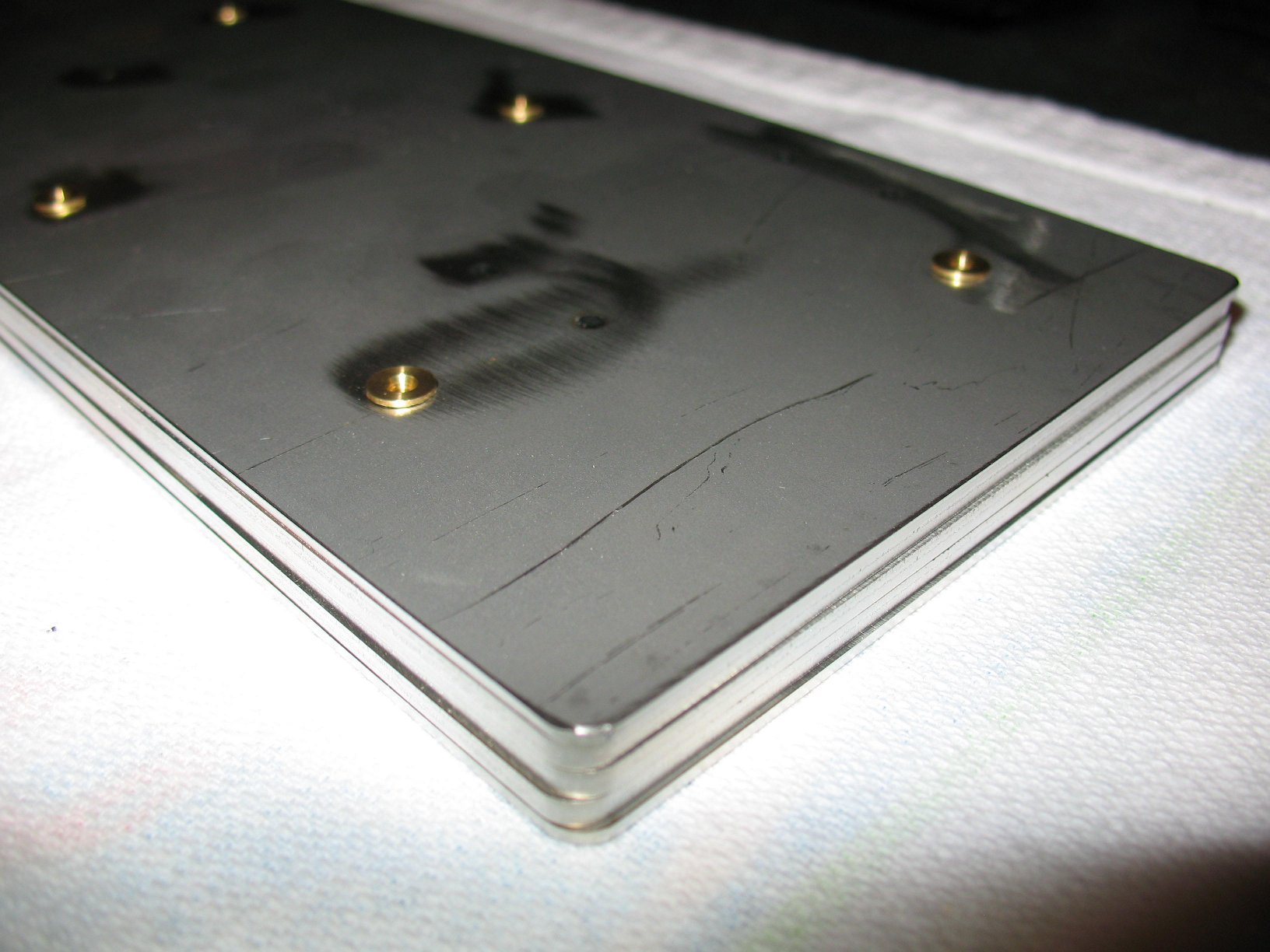

I have some pictures up here: http://imgur.com/a/8J3Ej
I got the base threaded, and everything fits together nicely! Now it's just a matter of putting it together ...

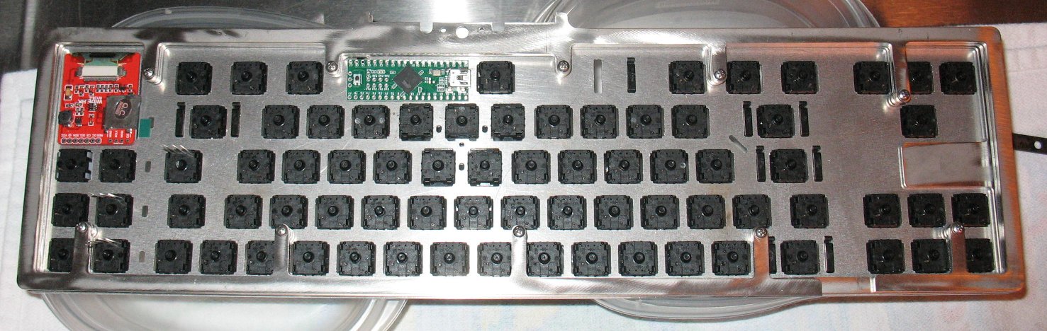

Some updates.. I cleaned the grey goop off the top aluminum plate. It all came off but I managed to add some scratches to the surface in the process. What the hell.. it gives the keyboard more character. :P

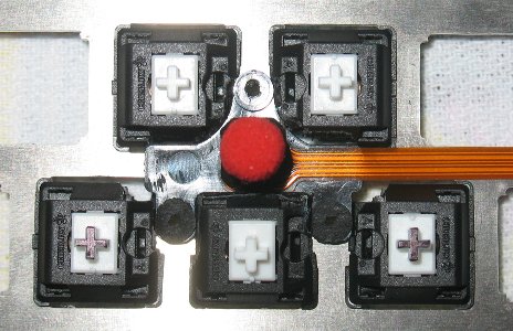

Cutting the switches around the trackpoint took some time and care but thankfully it all fit together in the end. The B key needs the trackpoint for support now. I think it will hold up.

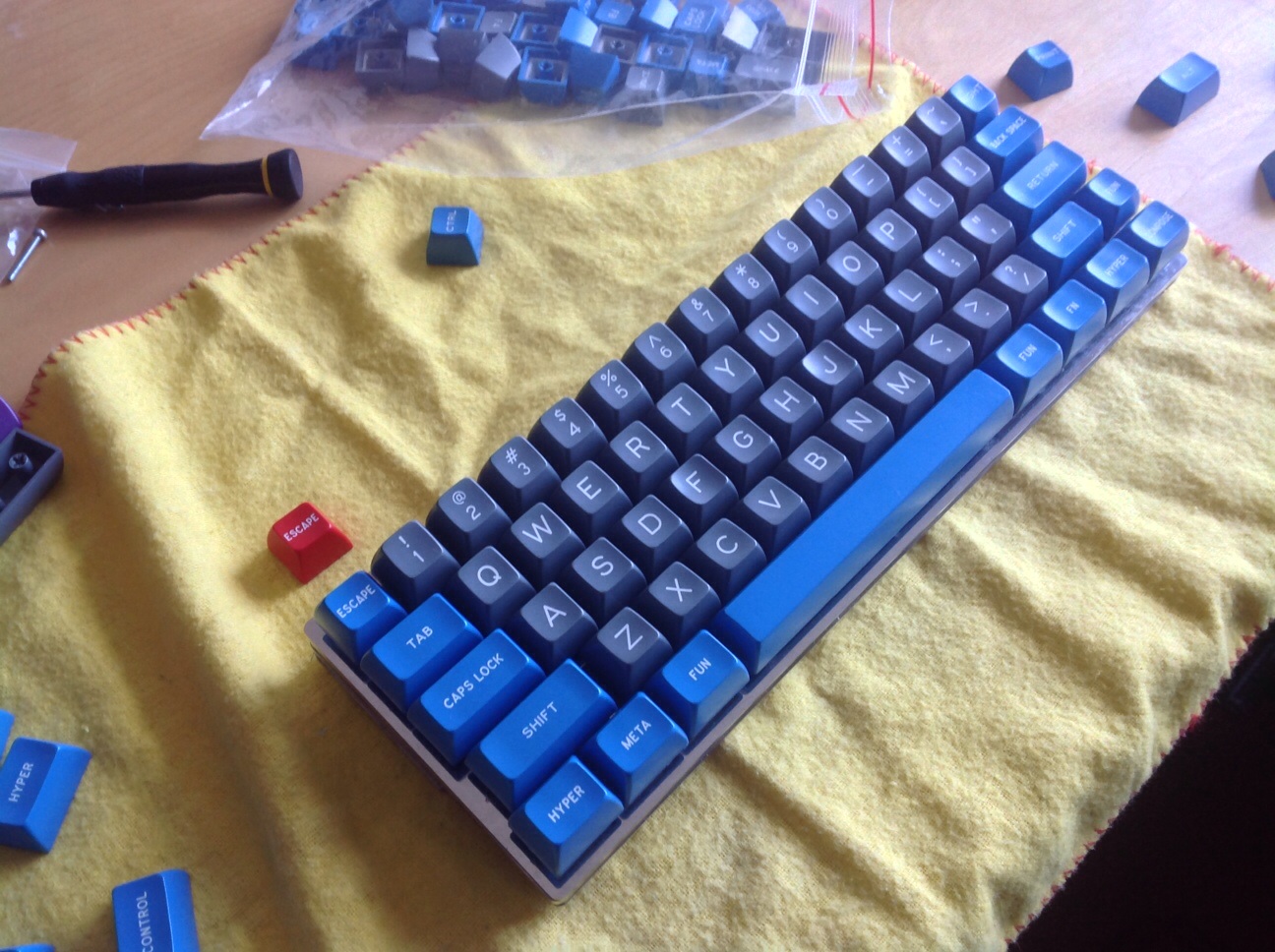

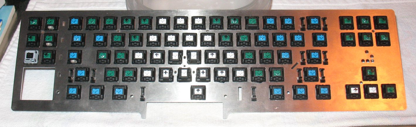

Here's a picture of the top with the switches in place. I should probably explain the color scheme in a separate post because there's some craziness going on there. All switches were stickered and lubed. This will be my first kbd with stickers, so I haven't a clue if they make any sort of difference.

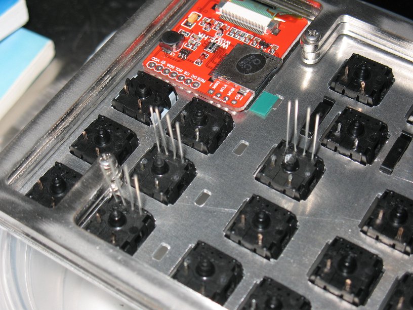

Here's the view from below. After I get some more screws in the mail I will begin wiring up the matrix. :-D
Here are the 3 lock keys. There will be 3 in-key LEDs and 3 not-in-key LEDs which will show through the holes in the top plate. I hope to make it configurable as to which LEDs light up, depending on if I have key caps with windows on (e.g., the commando set when that arrives :) )

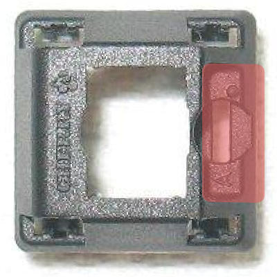

The LEDs are 2x5x5 mm RGB. They fit in the switches with a little dremeling and a little bending of the legs:

great progress, mtl!
I'm particularly interested in the RGB LED part, do you have enough pins on the teensy to handle the matrix + all the RGB LEDs? or do you use another controller?

That's a Teensy++ under the space bar, if I'm not mistaken!
A lot more actual hacking and elbow grease going into this one than I dare to try for myself. Those RGB LEDs are indeed a fine addition. What Dremmellng was necessary to fit them in, MTL, along with the pin coercion?

Ah, good question! I'm going to try to use one of these. A couple LEDs can be driven by the Teensy but I think 4 of them must be driven via the extra controller (since yes, even the Teensy ++ hasn't enough I/O pins), which is addressable over the i2c bus.
I will take some better pics of the modified MX switches to show the dremeling. BTW, if anyone is interested in trying some of these LEDs, I had to order 100 so there are plenty of extras.

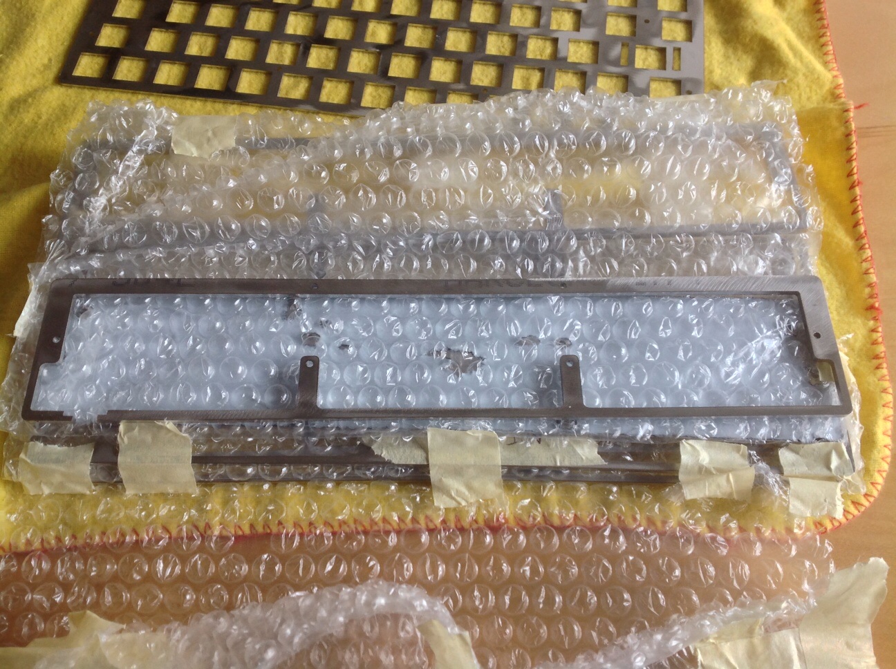

Finally got back to my desk again. Let's look inside this custom keyboard construction kit Matt3o sent me…
Carefully packaged. The components are labelled too:
Um, okay.
The first thing I did was pop two of the included bolts through the whole stack to give it a feel. And add my mx greens, and some caps…
I've a few replacements ordered from 7bit (more row 1 caps, including Escape, and more 1.25 mods) and neither shift nor return is perfect in the currently available SA anyway. But it's close enough…
Shiny!
I'd really better get this thing together for real. It's an awesome, heavy, tight little keyboard. Just how I like them!

I've added a couple of pictures to my album, I've finished soldering up the board itself (and it works!), and just need to get the usb plug soldered on the end, and it's complete!
http://imgur.com/a/8J3Ej#8jRfmWc

Muirium wrote:What Dremmellng was necessary to fit them in, MTL, along with the pin coercion?
I filed away the red area, which makes for more than enough room. I'll try to get some closer pics of the switch with LED in it.

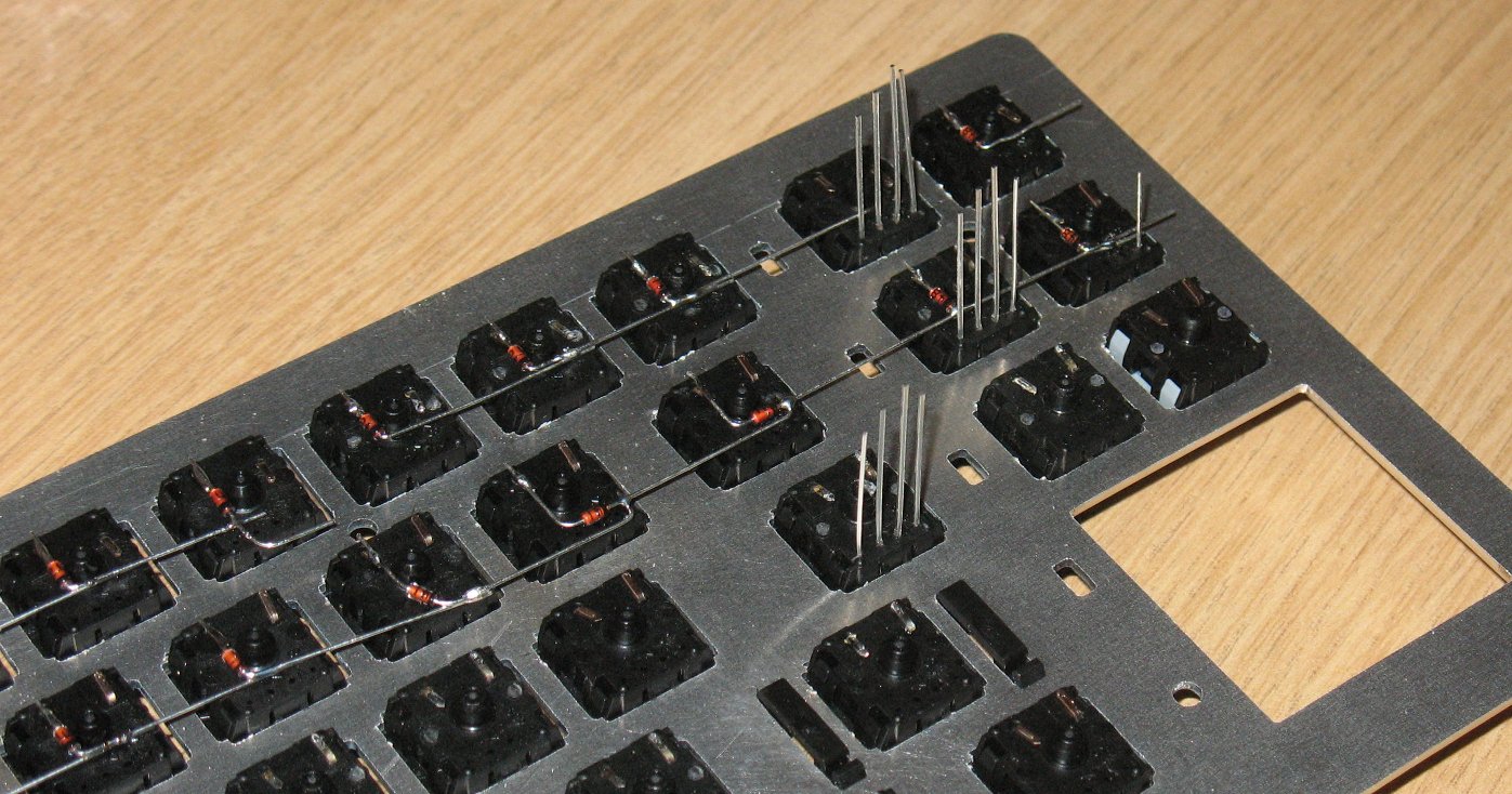

Also I've begun wiring the matrix. It is painstaking work and I've been going really slow (one row of diodes per night):

mtl wrote:Excellent progress, Zifle! How did you thread the bottom layer? That looks like the way to go. :-)
Thanks, the threading was done manually, by my dad (while I was watching :twisted: ), like so: Image
It definitely wasn't the easiest task, as Matt3o also warned me about prior to getting the plate cut. It did end up working, however, and I'm very happy with the result.
For the record, my keyboard ended up at 1360g! With a little skill, I should be able to murder someone with it...

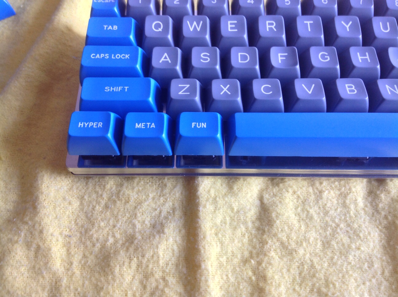

Some awling later and I have my case all bolted up nice and tight, without its earlier flexing. The alignment is actually pretty super and Matt's ambitious stepped + hidden screw design seems to be flawless! The whole thing's shiny from every angle. Quite distracting while working on it! Sweet.
My Teensies haven't arrived yet, so the hard stuff is all to come. I'll leave the case all bolted up in the meantime to train it to its true shape.

I've updated the imgur photo stream with some new pics. Some of the components were mounted to the bottom layer, including the USB port, and there are close ups of the modified LED switches.
I am procrastinating on the matrix wiring. :roll: Matt3o, did you melt the column wires to expose the solder points? Or is there a better way to strip those areas?

mtl wrote:I am procrastinating on the matrix wiring. :roll: Matt3o, did you melt the column wires to expose the solder points? Or is there a better way to strip those areas?
the best way I could find is with a sharp cutter (a scalpel actually). But I use pretty thick wires. If the plastic is thin I guess you can simply melt it. The alternative is to use 4-5 short wires per column, but it's a longer process imho.
