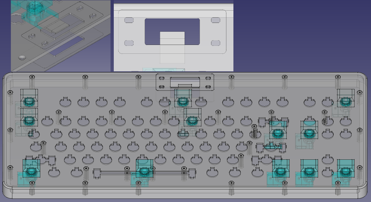

DMA wrote: 01 Jul 2023, 10:08 I _might_ have been overdoing the fasteners a bit.
Looks good to me. I've stripped down more Topre boards (to install silencing rings) than Model Fs so I’m very familiar with an obsessive looking amount of screws. Sure you don't want some in the middle? It's super satisfying when you do them all back up again. :D
Re: Modeling an F key mechanism
Posted: 01 Jul 2023, 13:30
by DMA
Muirium wrote: 01 Jul 2023, 11:44 Looks good to me. I've stripped down more Topre boards (to install silencing rings) than Model Fs so I’m very familiar with an obsessive looking amount of screws. Sure you don't want some in the middle? It's super satisfying when you do them all back up again. :D
ah, yes, topre. But I kinda outdid even them - topre has 30 self-tapping screws, and this one has 39 _pairs_ (granted, top screws will never be unscrewed, but someone will need to assemble it, and 78 screws, each needing 18 full turns is a bit cruel, even with powered screwdriver).
Can't have anything in the middle - keys are too close together. It has to be at most M2, with a self-clinching nut on the bottom - and even then it will provide a mechanical linkage from barrel to the plate, causing a lot of sound leakage.
OTOH, top plate will be 1.5mm of 304/316/904 steel, I don't think it will noticeably bend, even considering all those cutouts. And if it will - it's probably easier to press some ribs into it for extra rigidity.

DMA wrote: 01 Jul 2023, 13:30 ah, yes, topre. But I kinda outdid even them
Just remember to mark the PCB with those cool arrows or at least the circles, as they really help when you're down to your last few screws. I know!
Well, I suppose in Model F's and your case they go from plate to plate, which is harder to mark, but also much more self-explanatory. PCBs are visually much busier.
Posted: 01 Jul 2023, 16:07
by DMA
Muirium wrote: 01 Jul 2023, 14:40 Well, I suppose in Model F's and your case they go from plate to plate, which is harder to mark, but also much more self-explanatory. PCBs are visually much busier.
yeah, the back of the keyboard is pristine, nothing but bolts. Circles and arrows make sense when some bolts are there to fasten the lid to the case, and some are to fasten something else to the lid - but it isn't the case, plus there are countersinks which are CONSPICIOUS :)

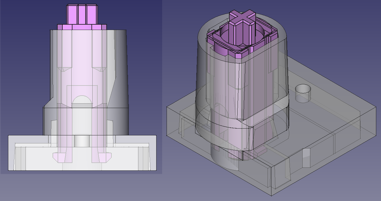

DMA wrote: 18 May 2023, 06:23 Wasn't easy, but here it is - 19x19mm, MX-mount, LED-enabled, original stem- and flipper-compatible buckling spring assembly, free of that pesky "spring doesn't buckle and requires reseating" bug.
Something I've noticed about your design here: By thinning the edge of the barrel so much, you seem to be leaving about 0.1-0.2mm thick of plastic in between the outsides and the notch of the keycap. With a bit of wiggle, it might be able to tear through that thin sheet of plastic. It also seems incredibly difficult to 3D Print without some kind of 0.2mm nozzle or a resin printer. I don't think you can "square" it up so much with how thin you left it. Seems like its a circle shape for a reason.
Posted: 05 Jul 2023, 06:57
by DMA
Liamkrum wrote: 05 Jul 2023, 06:31 Something I've noticed about your design here: By thinning the edge of the barrel so much, you seem to be leaving about 0.1-0.2mm thick of plastic in between the outsides and the notch of the keycap. With a bit of wiggle, it might be able to tear through that thin sheet of plastic.
yeah, because nothing is touching the barrel there, wiggle or no wiggle. I'm pretty sure every part that touches anything (temporarily or not) is at least 0.5mm thick - but I'll check.
Liamkrum wrote: 05 Jul 2023, 06:31 It also seems incredibly difficult to 3D Print without some kind of 0.2mm nozzle or a resin printer.
It will indeed be stupid to use 3d printer for that - but it won't be used, those parts are designed to be injection-molded.
Liamkrum wrote: 05 Jul 2023, 06:31 Seems like its a circle shape for a reason.
Not really.

DMA wrote: 05 Jul 2023, 06:57
Hmm, looking at the file you sent, the edge seems really thin (definitely less than half). I measured the edge of a barrel I have lying around at 1mm, so considering that the wall hardly seems like a few pixels in your screenshot, I wouldn't have much faith in the durability of this if you wiggle the cap a bit too hard to the side. Those "holes" seem like a non issue, but a cap that is sideways could easily get stuck in these created "holes". Not a manufacturing or plastics expert though, if someone is here, feel free to weigh in.
Makes sense. Although is it possible to mould a wall that thin? With a quick google search, it doesn't seem like you want any part thinner than 1mm.
Not really.
Makes me wonder why the designers made it a circle... I guess it just adds on to the point that those mould makers really were showing off lol.

Liamkrum wrote: 05 Jul 2023, 08:25 Hmm, looking at the file you sent, the edge seems really thin (definitely less than half). I measured the edge of a barrel I have lying around at 1mm, so considering that the wall hardly seems like a few pixels in your screenshot, I wouldn't have much faith in the durability of this if you wiggle the cap a bit too hard to the side. Those "holes" seem like a non issue, but a cap that is sideways could easily get stuck in these created "holes". Not a manufacturing or plastics expert though, if someone is here, feel free to weigh in.
again, you literally can't wiggle anything to contact that part.
Yes, it's 0.15mm thick in lowest 1.7mm - but I fail to see how it matters. That part can be easily made thicker - it's below the LEDs anyway - I just don't really see why.
Liamkrum wrote: 05 Jul 2023, 08:25 Makes sense. Although is it possible to mould a wall that thin? With a quick google search, it doesn't seem like you want any part thinner than 1mm.
I've seen a lot of plastic parts thinner than that (in their thinnest part). You also can do that, if you just look around instead of google searches. :)
Posted: 06 Jul 2023, 00:31
by DMA
..easy change tho:
I needed to round the sharp corners anyway to encheapen the CNC-machining both the mold and the top plate.
Posted: 06 Jul 2023, 08:52
by Liamkrum
Seems like a good fix. Wouldn't that leave less space for the LED though? How do you plan on mounting that anyways?
