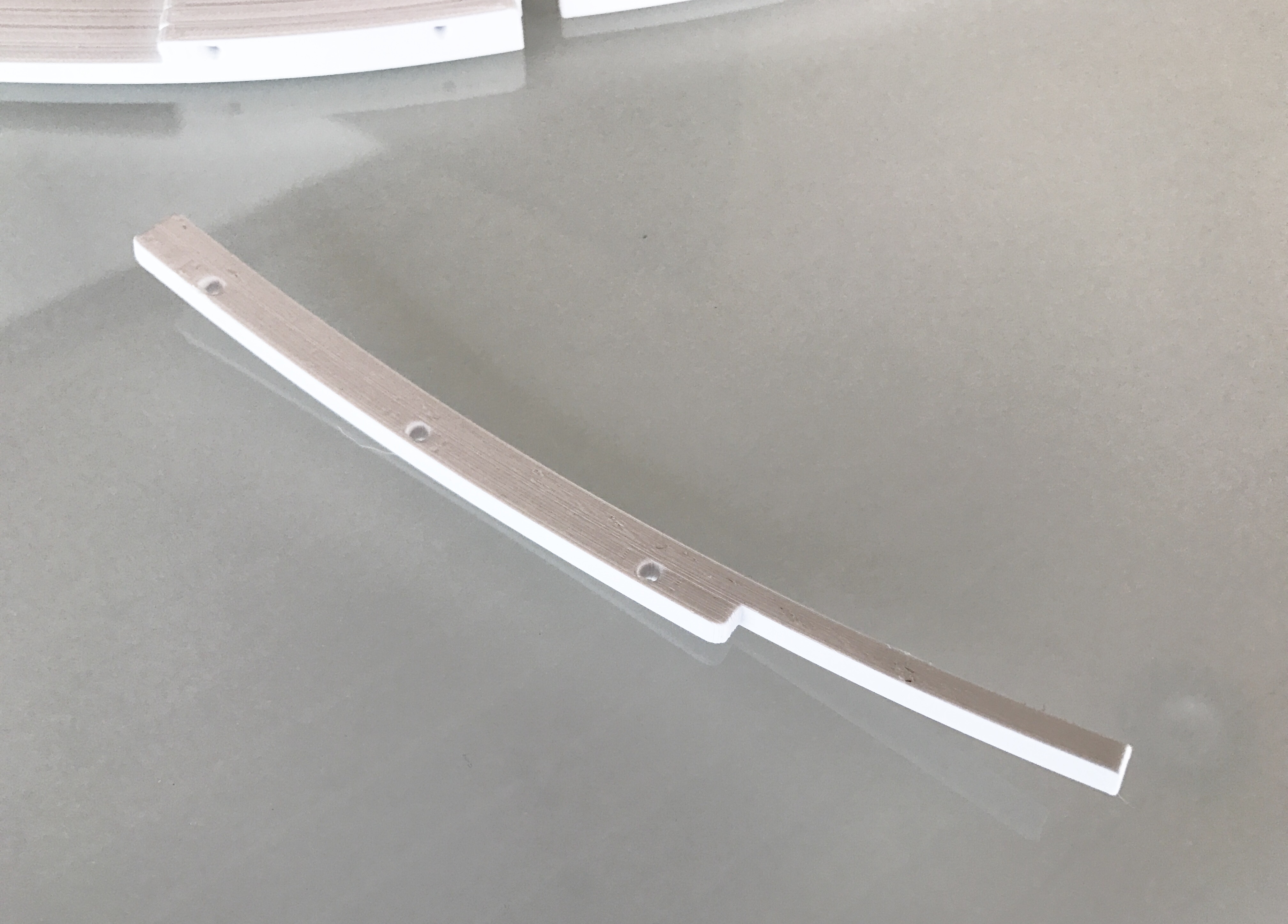

lot_lizard wrote: Printed samples of the side spacers, but really think we need a pattern on the side to break up the "3d printed" look. I threw this together, and will give them a go on the printer later today. Keep in mind the blue cutaways will be much less pronounced in real life. I realize this is silly stuff, but want to do what we can to make this has polished a product as possible.
I would probably use a regular honeycomb pattern. can you share 3D models, I've got a 3d printer myself I'd love to play with it :)
Posted: 19 Jan 2017, 12:17
by lot_lizard
andrewjoy wrote: Reduce the infill , you will be amazed how little you need for strength.
I tried a 50% honeycomb, and the I could visibly see it on the walls. I could tell it wasn't as rigid when bending around, but certainly didn't warp, crease, or crack in any way with some serious stress (this co-poly really is a special material). I should probably try going back to 50% on the honeycomb infill, and try bumping the walls up to 1-1.2mm to see if it eliminates the appearance issue (it was a nit, but annoyed me).
andrewjoy wrote: Bump up the print speed on the infill , it does not matter how accurate that is.
I'm currently at 40mm/s on the wall, and 60 (default was 50) on the infill. Let me know if you think I should try even a little more. I just can't have mess-ups, or I really do start running out of time, but really like the idea of trimming down the timing where I can
andrewjoy wrote: They look far enough apart to print one at a time not all at once , this will allow you to bump up the parameter speed and acceleration without stringing, it will also reduce the need for retraction.
They are currently set to print one at a time (might not have been clear before). I like that better as well, plus if we do have a screw-up on one cycle, hopefully we can salvage some of the parts
matt3o wrote: I would probably use a regular honeycomb pattern. can you share 3D models, I've got a 3d printer myself I'd love to play with it :)
Happy to :)... The right spacer is identical for both form factors. https://github.com/lot-lizard/Model-MF/ ... ris-Shield
Appreciate the thoughts... I am not TOO concerned about timing unless we start experiencing some issues along the way. All of the retainer clips are printed, along with the nylon stabilizer inserts (both turned out nice). Each will need to be tested against the finished product though to confirm. I did raise the C/micro/mini USB ports with a smaller lifter insert that you will slip on the retainer pegs to raise the USB controller itself... they were just too close to the bottom edge

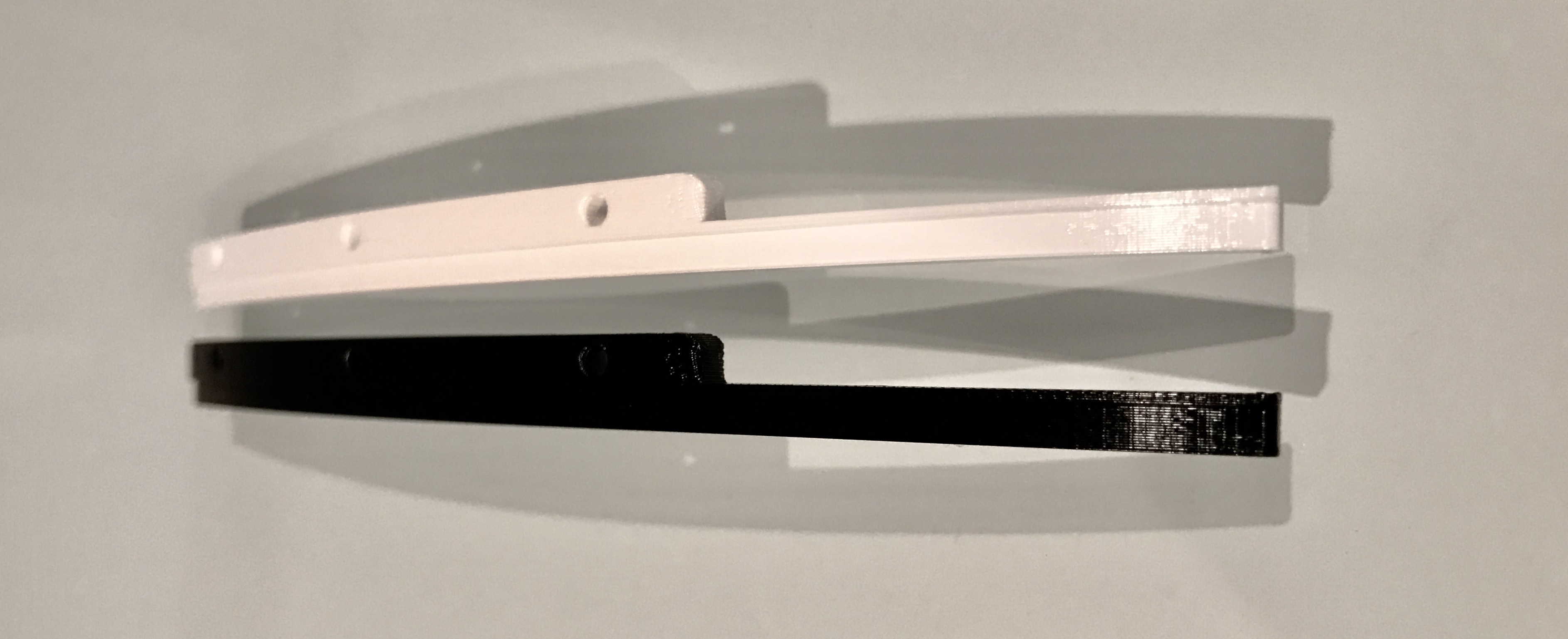

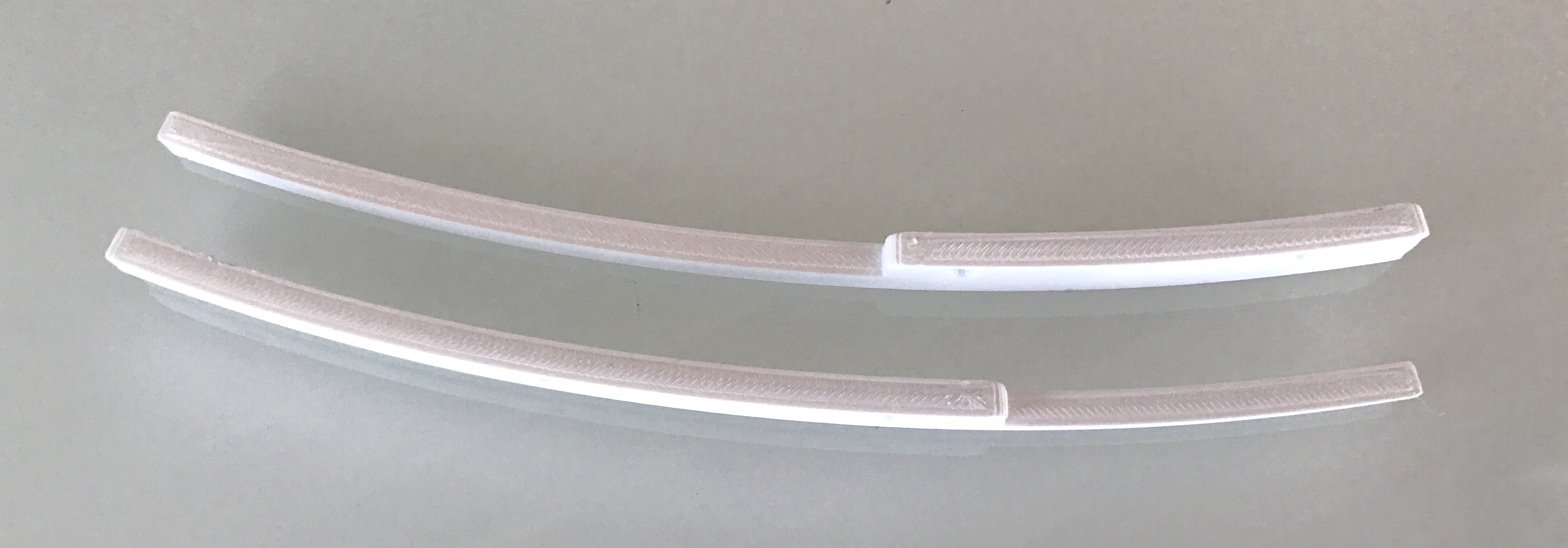

Okay... So I did the following:
  • Reversed the direction of the spacers so the heat from the fan is trapped better (half-a55ed draft shield)
  • Set the line height to .2mm vs. .1
  • Set the infill to 50%
  • Bed temp from 60 back up to 70
  • Reduced the fan speed by 30%
  • Removed the brim (all or nothing on this test)
Now I can't pry the damn things off the plate :lol:
They look good. I might kick the fan back up a bit so the screw holes turn out just a touch more rounded (look close to perfect), but I think we are very close to dialed in. Unfortunately these things are so long and small (height and width) that the infill patterns don't have much impact on the overall timing with a 1.2mm shell. What it did noticeably do though is reduce the amount of time the infill takes. The issue all along really has been that the infill (even at 100%) would occasionally leave a slight ridge when retracting (this Cura software elects to use some very random patterns, and I haven't seen a way to alter the algorithm). The ridge would harden enough that it would impact the shell pass, causing a "speed bump" as it passed by. Enough slight bumps in the process, and the silly thing would come off the plate.
The combination of the .2mm and reduced fill time have eliminated the hardening of any "glob", and now we cruise right along with smooth beads throughout. The other MASSIVE upside of the .2mm is we have cut the print time by half. The definition of the print is obviously less, but really only noticeable on the portion that would be covered up anyway. I'll try to get some pics later.
Appreciate your thoughts andrewjoy and matt3o. Also, if anyone decides to take the STLs and apply your own patterns with success, upload that for everyone if you would.
EDIT: photos from the above mentioned prints
Posted: 19 Jan 2017, 16:34
by andrewjoy
Looks good.

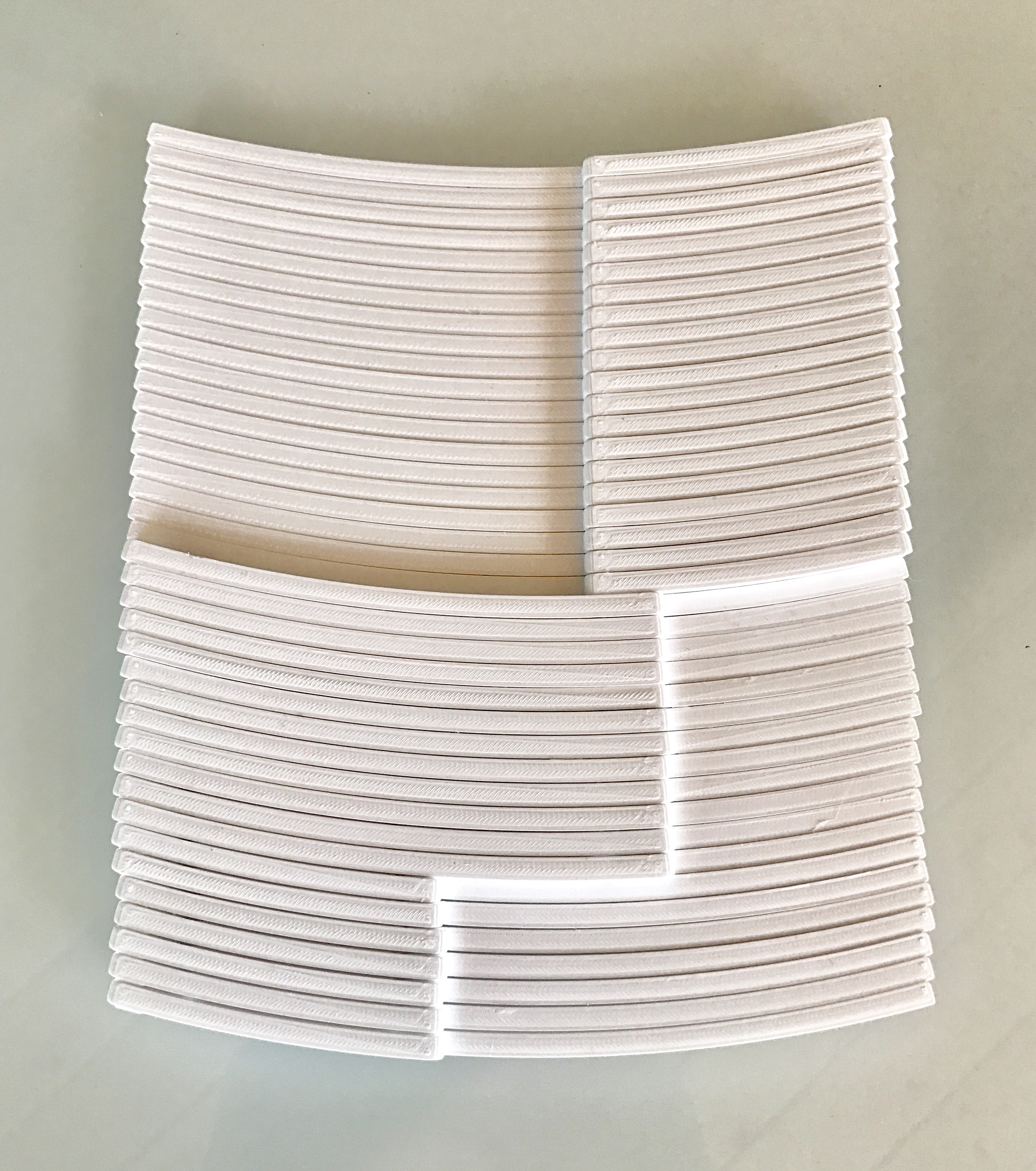

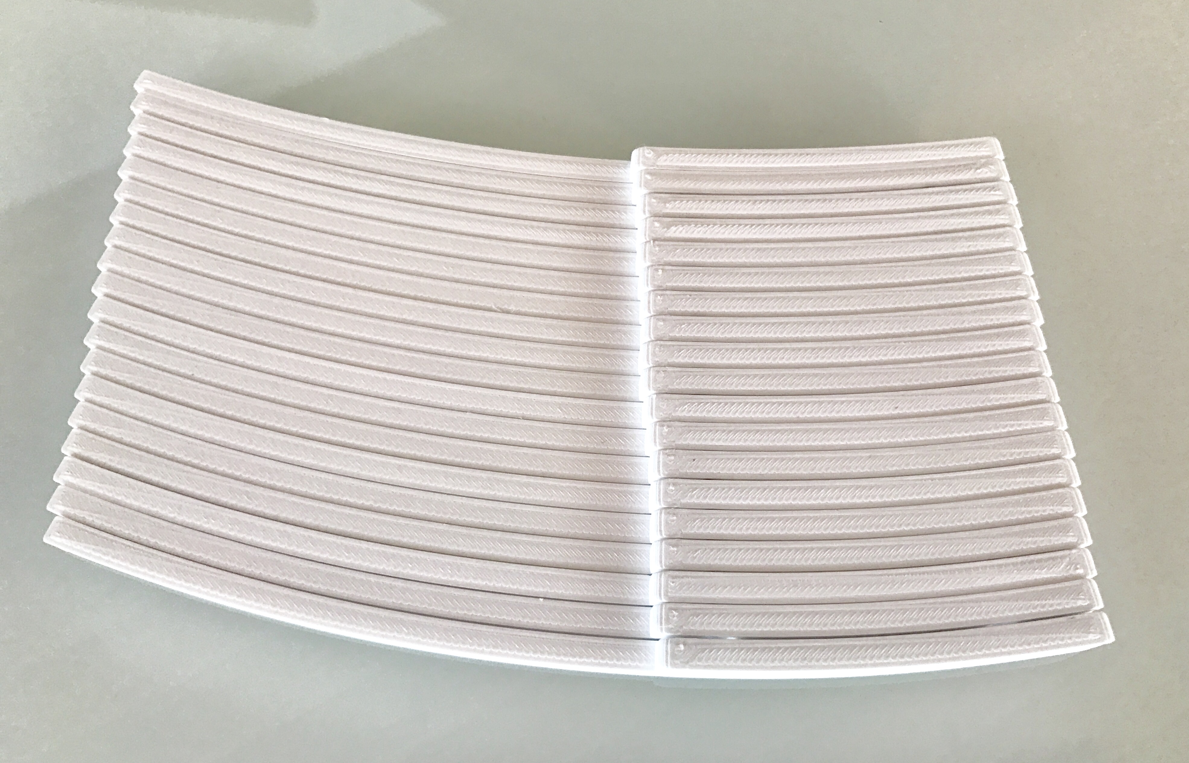

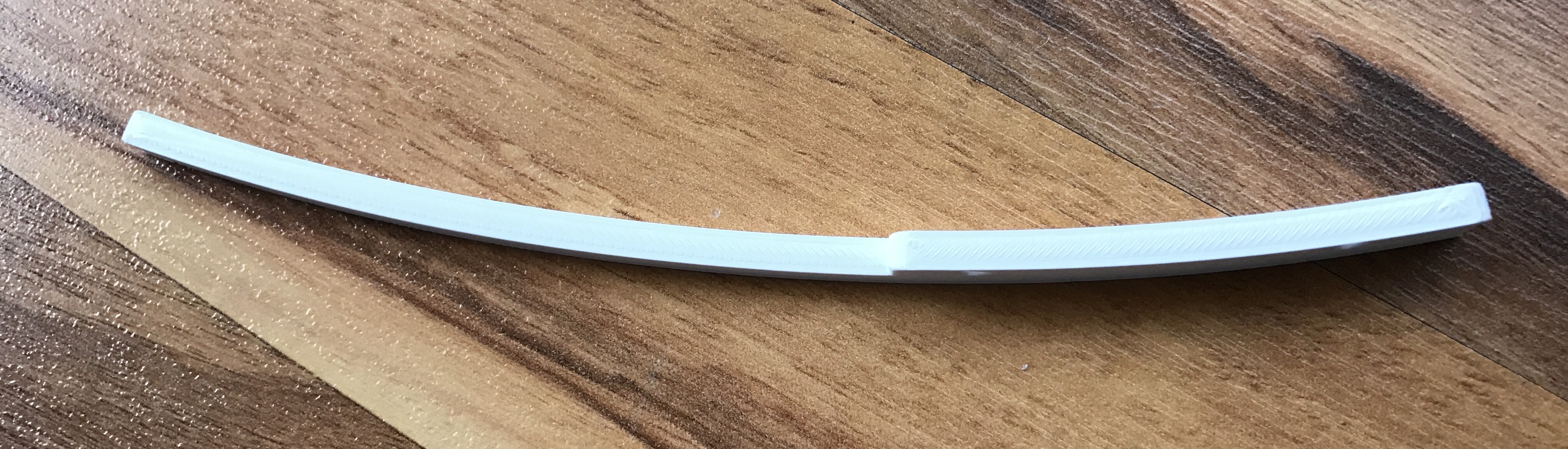

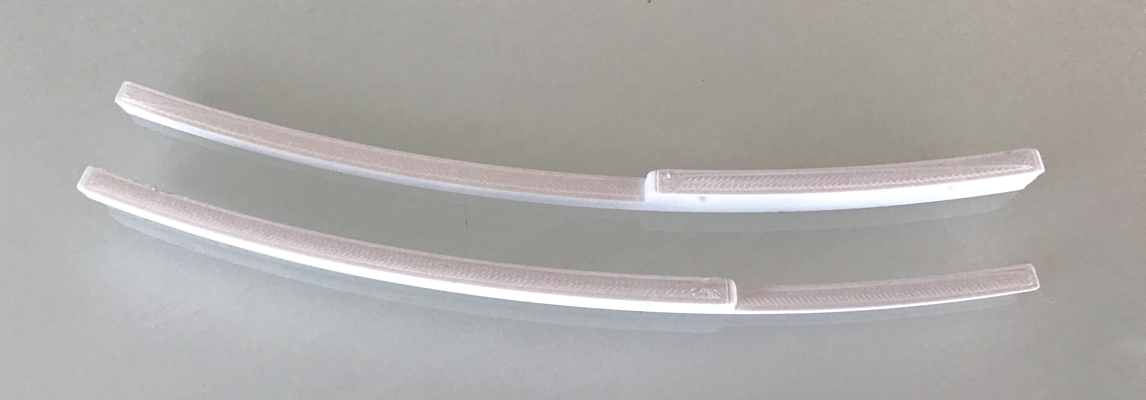

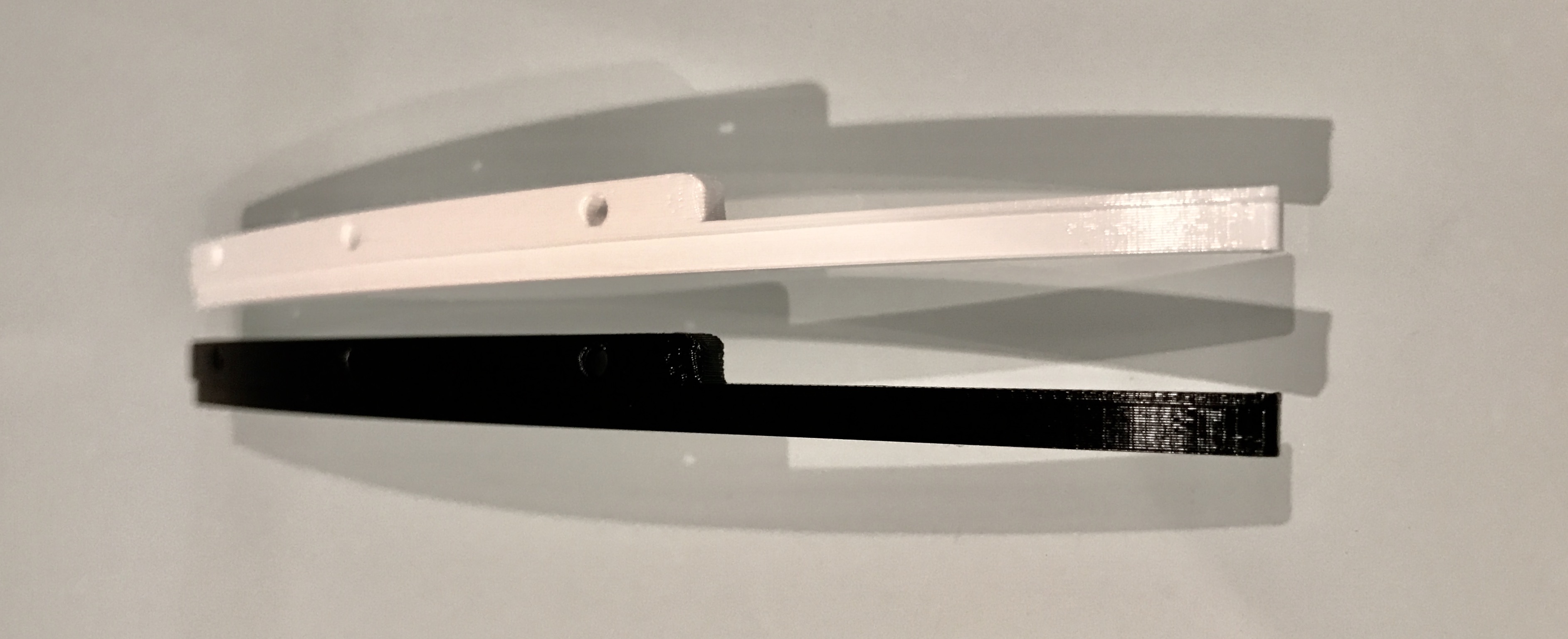

All of the white right-side spacers (applies to the full-size and SSK) have been produced, and onto the left-side for the SSK. Should be done with the whites altogether by the weekend. I mistakenly thought I have co-poly in black already, but the black is in nylon only (using for the stabilizer clips which are next). I have ordered a couple of black Colorfabb XT reels and a clear so I can play a little with indirect LEDs in the future. The following images show the progress to date on the spacers.
Also, I spoke with our box friends, and we are going to start production on those soon. They are going to make one more change for me in prototype form. I need the width and height of the box reduced by 1/4 inch each way to make the palletizing of the Euro shipment work. Otherwise I will be hit with a non-standard freight dimension fee
All right side white spacers for both the SSK and Full-size
Right side on top, left side SSK on bottom (inverted)
Left side SSK
Left side SSK
