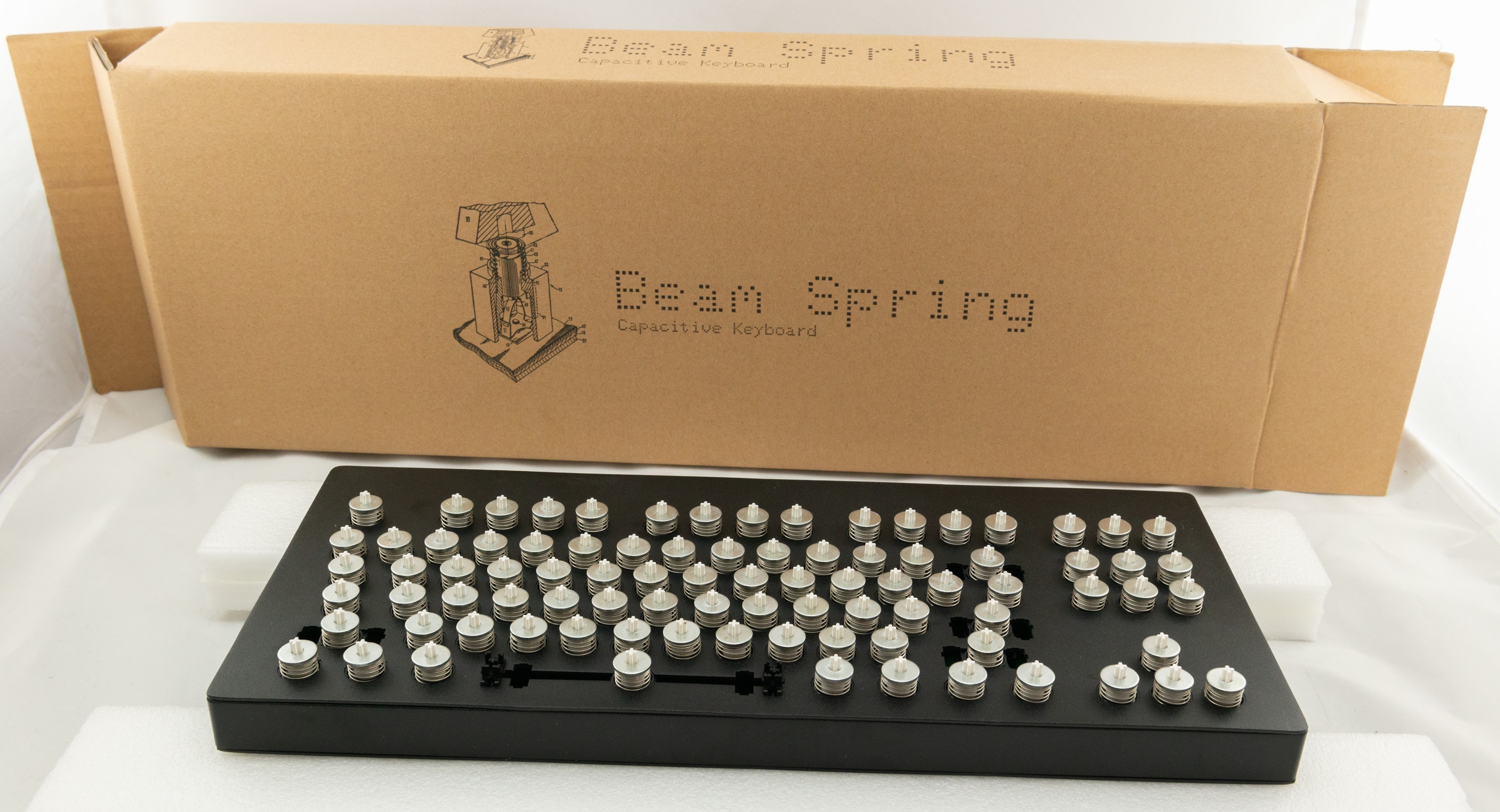

Today is the public launch of the Brand New Beam Spring Keyboards Project!
This was designed to be announced after the new Model F project ended but there was another project in the works to reproduce the beam spring module exactly (good for the purposes of spare parts for the original keyboards), so I thought it would be a good time to post. My modules are not backwards compatible with the original IBM beam spring keyboards. They have been redesigned to be used with Cherry MX type keys natively and to remove all of the wasted space in the modules and in the beam spring cases, while maintaining 100% original key travel and the same exact specifications for the fly plates, beam module footprint, etc.
For now you should check out the photos on the thread linked to below and sign up on the interest form if interested.
https://docs.google.com/forms/d/e/1FAIp ... p=sf_link
Please keep all beam spring discussion on this separate thread only so as not to add confusion to this current thread.
Details on the features and pricing are in this separate thread:
viewtopic.php?f=50&t=26174&p=491823
Important note: To repeat what I posted on that thread, the new beam springs don't ship and are not a focus until I've sent out the new Model F Keyboards. The Model F project was not delayed to finish these beam spring keyboards. More details are in the above thread.
