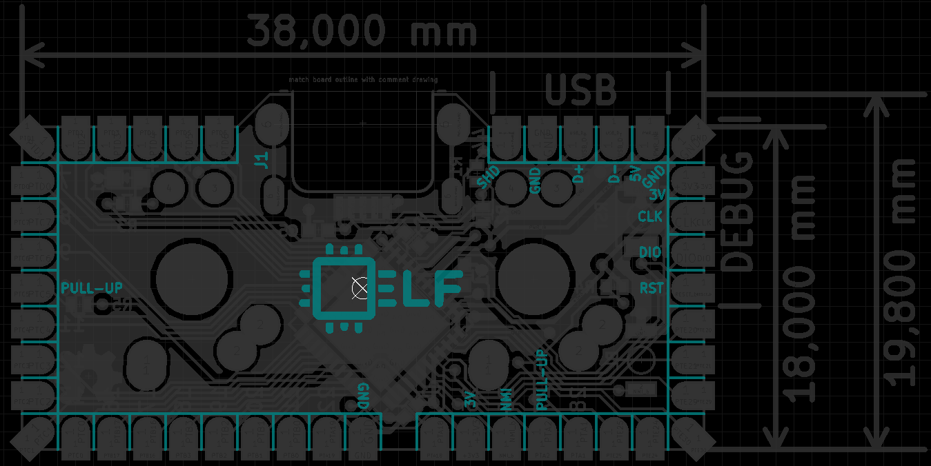

Cleaned this up and changed the font to something more explicit in regard to 1 vs I. Also corrected two typos.
- PINOUT.jpg (344.43 KiB) Viewed 7817 times
edit:
and new button footprint for bootloader plus a bit more rigid USB 'peninsula'. I decided to keep the old footprint for the reset button, as the larger pads are easier to work with if one wants to do stuff with them.
- prod_maybe.jpg (341.71 KiB) Viewed 7796 times
Posted: 27 Jan 2017, 13:34
by Sythe
On the USB connector feet through holes, I think you will want to increase the pad size on the top side of the board to pick up enough solder during SMT.
I have an Atmel board at work I was going to show as an example, but forgot to take a photo of it. Will try and remember Monday.

Posted: 27 Jan 2017, 14:44
by pomk
Sythe wrote: On the USB connector feet through holes, I think you will want to increase the pad size on the top side of the board to pick up enough solder during SMT.
I can enlarge the front holes, the inner ones are a bit cramped for space
(edit: they are exactly according to molex spec though)
Posted: 27 Jan 2017, 15:16
by Sythe
Yeh saw that. That might work well enough. I'll try get the photo of the board on Monday to show you what they did.
I work with SMT assembly in my job and showed your board layout to the design engineer at work who does our PCB design and he also didn't think there would be enough surface area for solder paste application during SMT. For hand solder, this obviously isn't an issue.
Posted: 27 Jan 2017, 18:17
by pomk
Well it's good to have professional opinions on these things from time to time
I'll try to adjust the design accordingly where possible.

Posted: 03 Feb 2017, 13:23
by pomk
So last communal check before I generate the gerbers again for matt3o.
I modified the USB pads as suggested:
- traces.png (73.02 KiB) Viewed 7685 times
I added the pin descriptions on the top side for all pins that have some special considerations.
- top-silk.png (56.03 KiB) Viewed 7685 times
Lastly I rotated the corner pads by 45 degrees and adjusted the outline to match. With this change the board should no longer be as pointy in your fingers as it was before.
- outline.png (54.03 KiB) Viewed 7685 times

Posted: 03 Feb 2017, 15:17
by Sythe
Looks great.
I would suggest you look at doing the panelising yourself, so its done right.
Especially since you have pads all the way around the edge you want to be safe.
For panelising, look at doing it with breakaway tabs.
I think something like larger tabs around usb and clear section opposite side and small tabs near corners should work.
Posted: 03 Feb 2017, 15:40
by pomk
I have no experience in panelization, so I think it would be ill advised for me to begin practicing with this project. The first prototypes had no cosmetic problems from the panelization applied by the company who built them.
