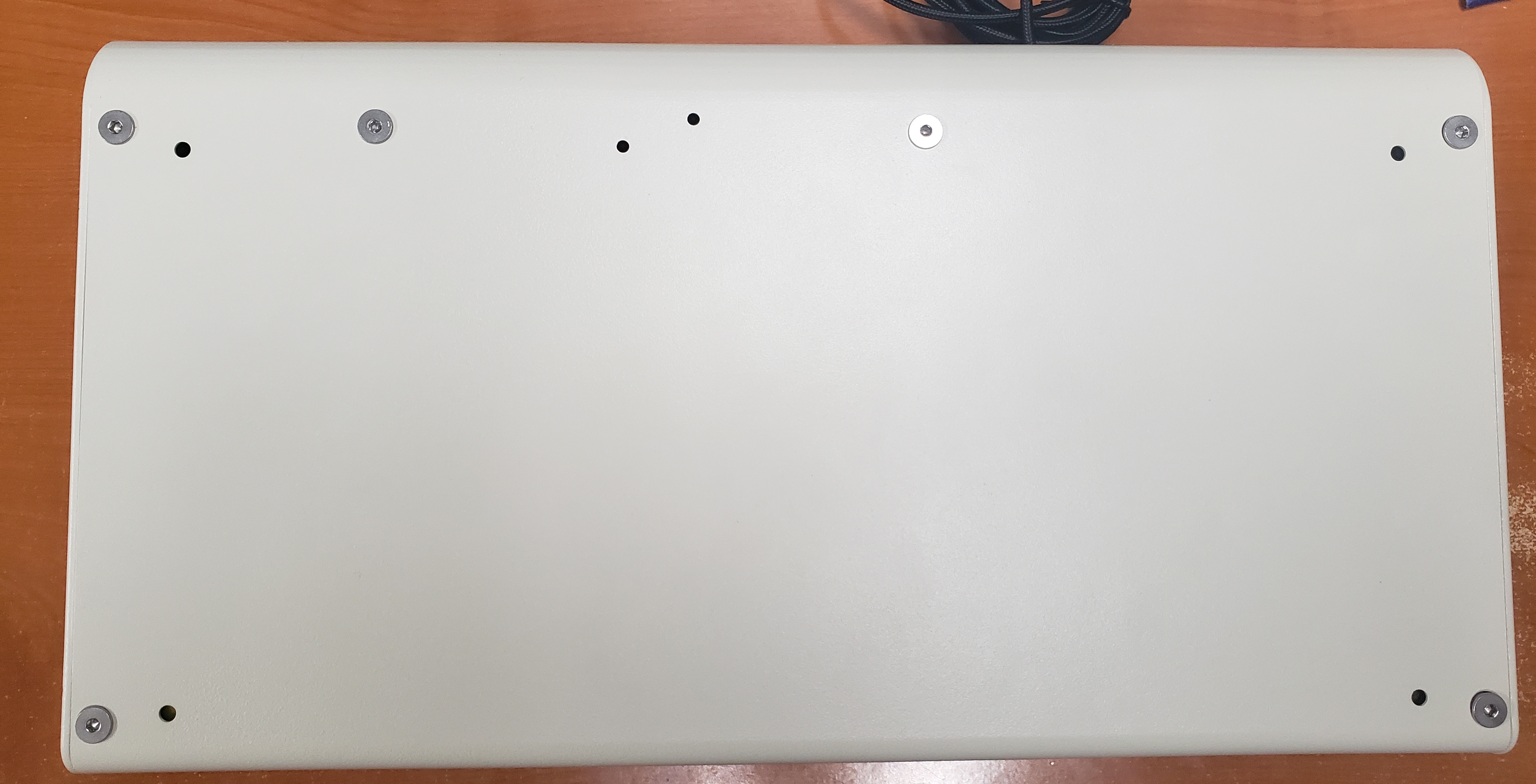

Here are the first photos of the completed and tested M Style FSSK sample; it is configured with the HHKB Style Split Right Shift and Split Backspace. Since the ~ ` key is left of the 1 ! key, I was not sure which key to place in the rightmost key of the block, so I selected a blank key. Any ideas on how folks plan on configuring their FSSK layout with such a configuration?
For the M Style case keyboards, wcass has ingeniously updated the PCB design to allow for the same PCB to support both HHKB style split right shift and regular right shift, to cut down on the number of PCB variations.
As noted earlier, these are the rejected sample cases that have defects (casting defects, they did not drill all of the mounts and screws correctly so the inner assembly has sunk inside the keyboard, etc.). Fortunately the keyboard is fully functional in my testing with QMK today.
The case bottoms have 4 holes for optional screw-on bumpers, plus 2 holes to mount a solenoid. The case tops have two internal posts, one to mount a solenoid and one for the P clip (USB cable strain relief).
You can also notice the changes to the interconnections between top and bottom inner assembly
1. They now have additional tabs between the first two rows, just like the IBM F122 and F104 originals. I believe this was done to keep the plates as tight as possible, to allow for the snappiest of clicks upon actuation of each key. The Round 1 compact style F104 and FSSKs do not have these extra tabs. I can tell that the Round 2 boards have some extra clickiness/snappiness to them compared to the Round 1 boards, though both have sufficient clickiness/snappiness.
2. The controller tabs have been modified slightly on the M Style boards to make them simpler and a bit less flexible. Sometimes when unscrewing the controller and adjusting an old bottom inner assembly, the old tabs would move out of position which would require some pliers to move them back into position. They are also slightly taller, to allow for more room between the controller and BIA.

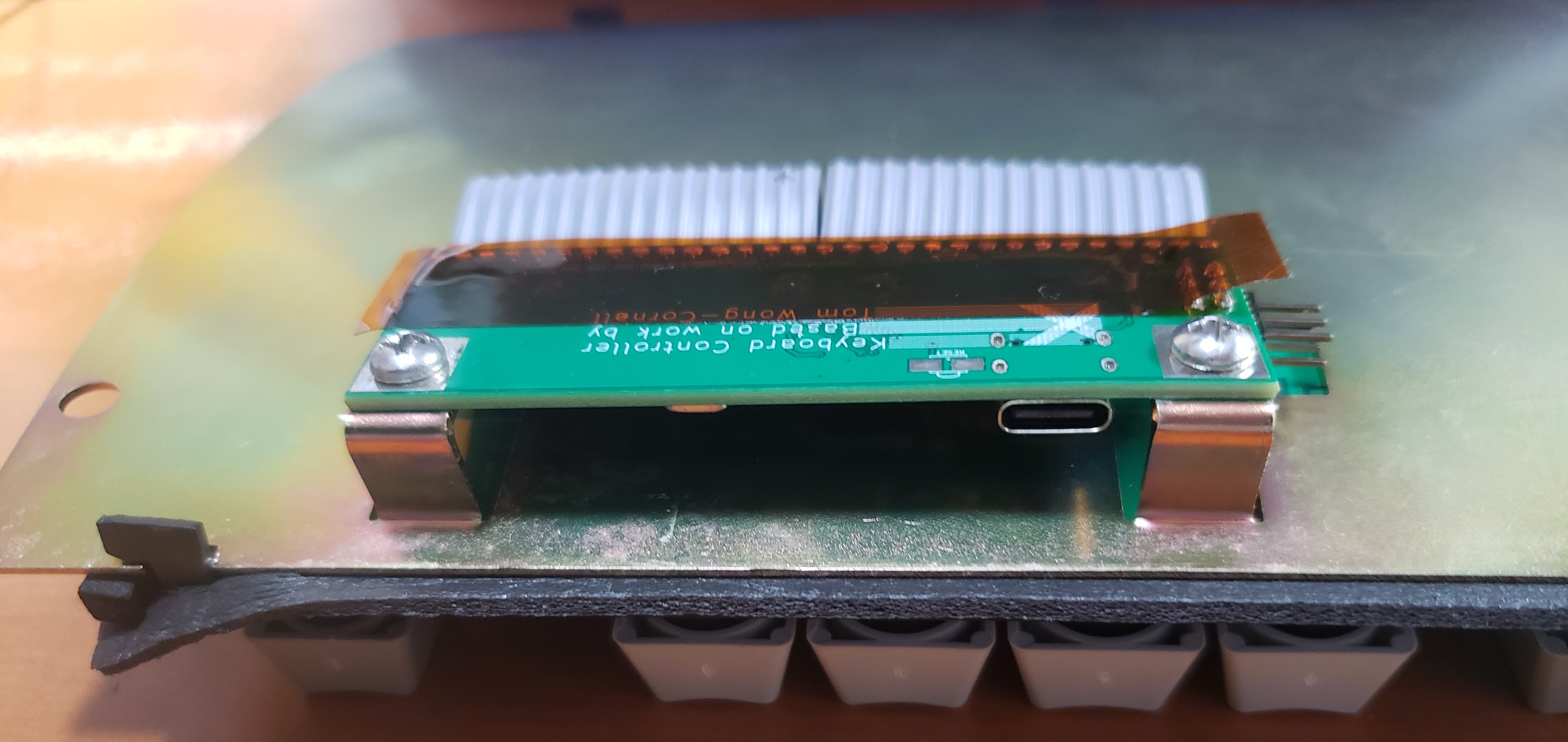

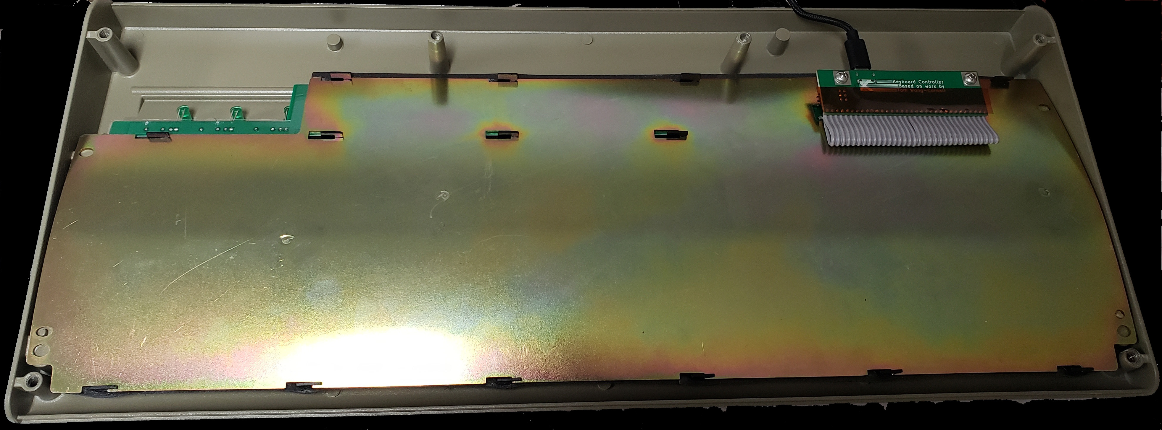

Here are the first photos of the completed and tested M Style F104 sample; it is configured with the US ANSI layout. As noted earlier, these are the rejected sample cases that have defects (casting defects, they did not drill all of the mounts and screws correctly so the inner assembly has sunk inside the keyboard, etc.). Fortunately the keyboard is fully functional in my testing with QMK. Also the texture is a little more visible in this photo than in the SSK photo though the textures are all the same. It is a nice texture reminiscent of the Model M style cases (originally plastic) as well as the IBM Model F cases (unpainted plastic, painted plastic, and painted metal).
Also shown below are some photos of the inside of the F104, indicating the locations of the P clip and where a solenoid driver and solenoid would go. The LEDs are designed to have the flexibility for movement so you can move them closer or further away from the LED overlay based on your LED lock lighting preferences.
