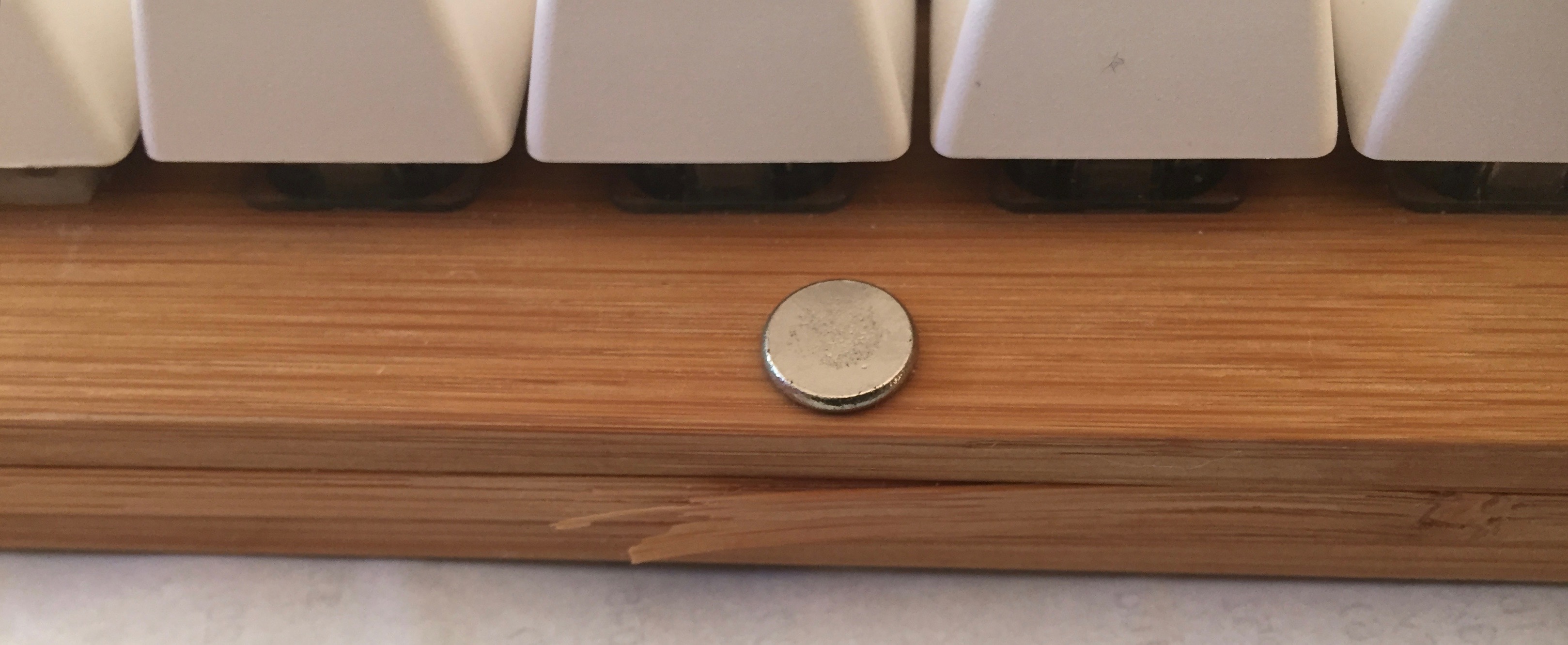

I received my Bamboo TKL on Tuesday, and have been giving it a couple of hours a day the last couple. I want to thank XMIT for letting me participate, and also for driving the initiative in the first place. I have Hall Effect sensors all over the house and shop, but I have never tried one in a stand-alone keyboard. A unique experience for sure. My thoughts...
  • Bamboo body - I am a huge fan of bamboo in general. The grain is always very clean, seldom warps, and prefer the carbonized look over natural. They did a nice job laser cutting/engraving the 3 layers, but fell pretty far short when it came to polishing the end result. I can tell the production was a bit rushed when I first opened the case to a strong varnish odor. The edges are quite rough, and there is a pretty uneven transition between the layers. You can tell that very little sanding was done once the plates were cut. Surfaces all the way around are fairly rough. Definitely has potential though with 5 minutes of extra attention to detail.
  • Fasteners - as others have mentioned, the sex bolts are a bit excessive and could be a higher grade. Something a little smaller that was countersunk on both the screw and nut sides would be ideal.
  • USB cable - as others have pointed out, something detachable would be ideal. Storing attached cables is messy, and the waterproofing need is an odd requirement (not sure what their target market is)
  • LED backlighting - I realize I am in minority here, but I appreciated the numerous light effects. Not for myself, but my 4 year old daughter is having a blast with it, and I like her taking interest in keyboards. If the cost built-in isn't too much, and it can be turned off, it is a nice feature... and behaves well (I am not having the quality issues that others addressed)
  • Caps - this one has already been beat to death, but I would second what everyone else has said. Cap quality itself is fine, but the legends are not ideal (my daughter couldn't find 'A' even though she is very aware what it looks like and where it is located on a keyboard).
  • Switch - The whole point of this exercise... I consider the Hall Effect sensor and the mechanical switch to be two completely different things (though they obviously work together). You slap the right magnetic field in almost any physical switch mechanism, and this PCB in theory could pick it up (hence the waterproof nature of the board). The Hall Effect sensing is working very well. On something that behaves like a linear switch with no-tactile bump, I tend to touch type even more... and it took me a bit to get the actuation point down. It seems lower than an Alps, but I didn't verify that. It could be the 70g switch I am using as well (which makes touch typing that much easier). I would like to see the point of actuation raised a hair (at least for the 70g switch), or have a "bump" along the way.
    The physical switch is very smooth, and I am enjoying the 70g springs. I think it is actually a little loose though, and if you press laterally on the key at the base of the stroke, it grabs slightly. This occurs on every key for me, but in some cases, can get stuck altogether.
Overall impressions are really high though. It is a very enjoyable typing experience. Upgradable firmware is not a big deal to me on a TKL, but would be for pretty much every other layout. Well done finding this, and putting together the initiative. I would happily pay 50 additional dollars for this same board if we could raise the quality level in several key areas. Those need to be improved though before it would be board that I would really embrace.
