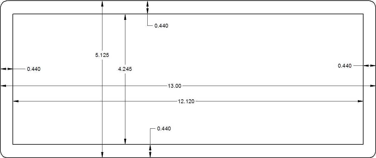

The new case will be laser cut acrylic sheet. Hopefully, the contest will pay for it.
The bottom layer will be .125" thick clear acrylic. You will be able to see the PCB through it.
Acrylic layer 1.jpg (22.96 KiB) Viewed 27961 times

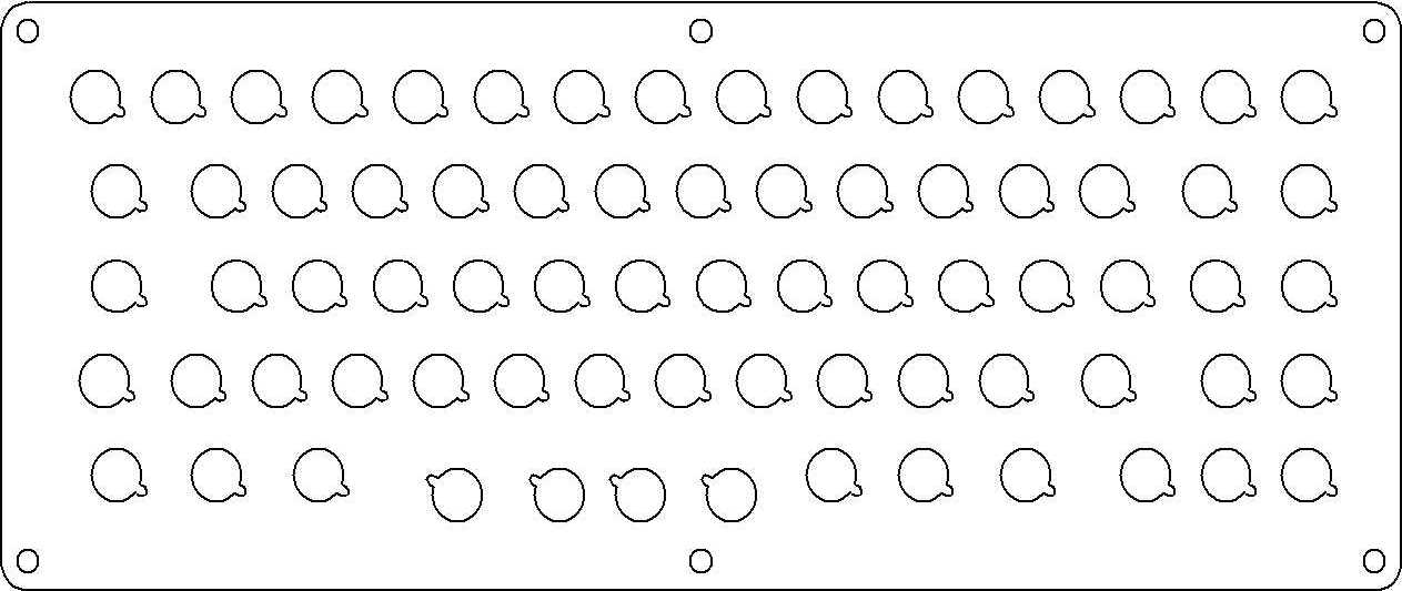

The middle layer will be .25" clear acrylic. This goes on top of the PCB and around the barrel bases. It will act as a light pipe for the LEDs (mounted on the PCB). The holes will be tapped for #6 machine screw. It will also need some engraving for the LEDs and micro USB connector.
Acrylic layer 2.jpg (32.1 KiB) Viewed 27961 times
