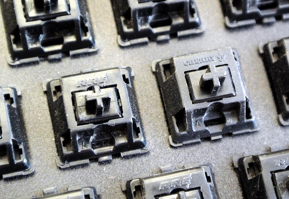

As you can see from my rather poorly-done photos, RRE switches use shinier plastic than their Cherry counterparts, and their top part is very slightly narrower. In terms of feeling they are somewhat more springy and scratchy. Cherry switches are smoother and easier to bottom-out.
The switch alongside its Cherry counterpart:

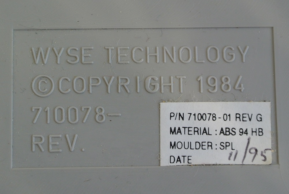

The inside of the lower case. You can clearly see the date:

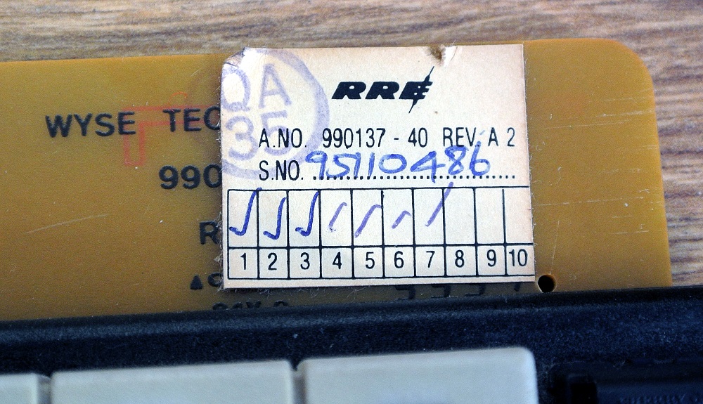

Sticker on the PCB. I think it's safe to assume that this keyboard was made on November 4, 1995. Or that it was the 486th keyboard manufactured in November 1995.

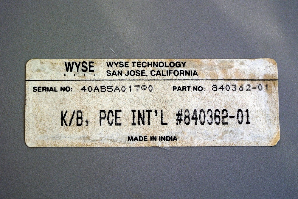

The Wyse sticker clearly states that the keyboard is "made in India".

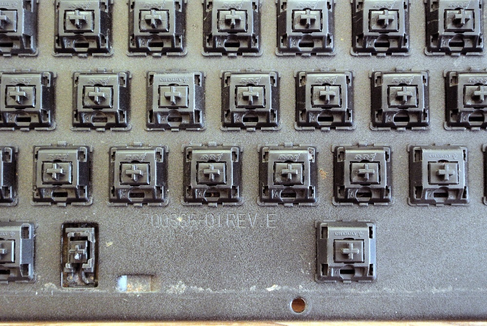

Another picture showing switches "in situ" mixed with genuine Cherry MX Black.

The mix of switches is a bit odd, especially since they seem to be fairly randomly placed in the alpha area.
I wonder if some of the switches quit working at one point and someone replaced them with the closest thing they could find - MX blacks.
Posted: 27 Mar 2015, 09:54
by stratokaster
Compgeke wrote: The mix of switches is a bit odd, especially since they seem to be fairly randomly placed in the alpha area.
Doesn't look like it, to be honest. There're no signs of soldering or repair on the circuit board.
