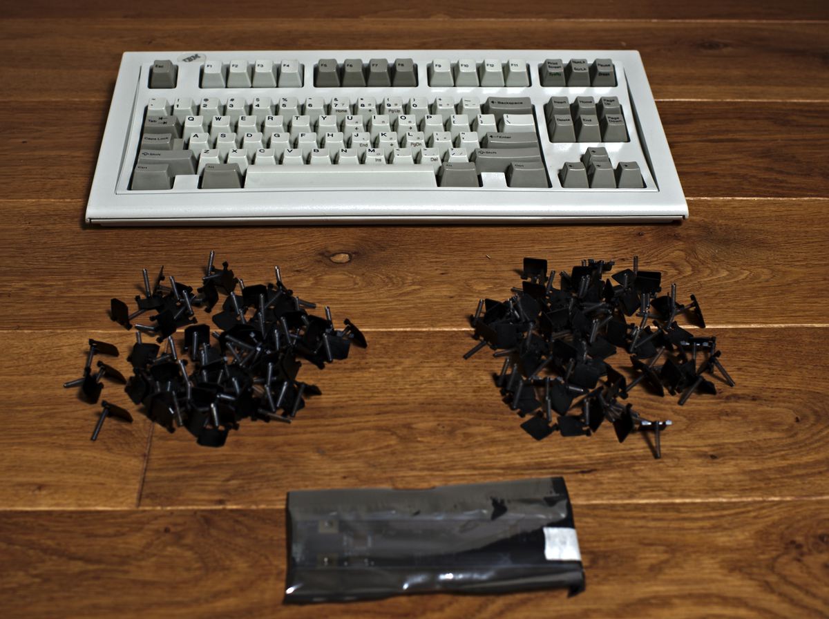

Here are the parts that I have mentioned:

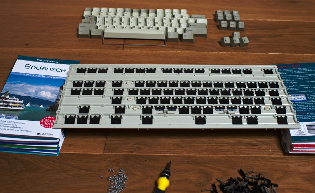

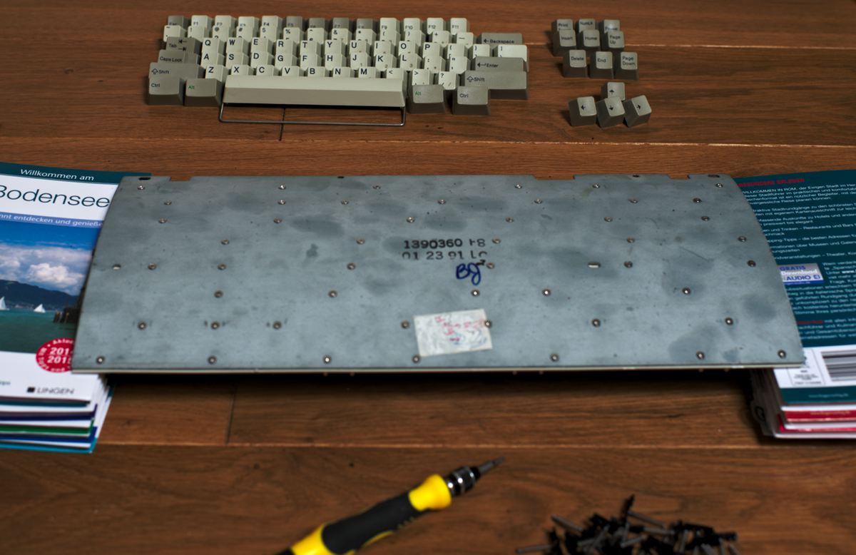

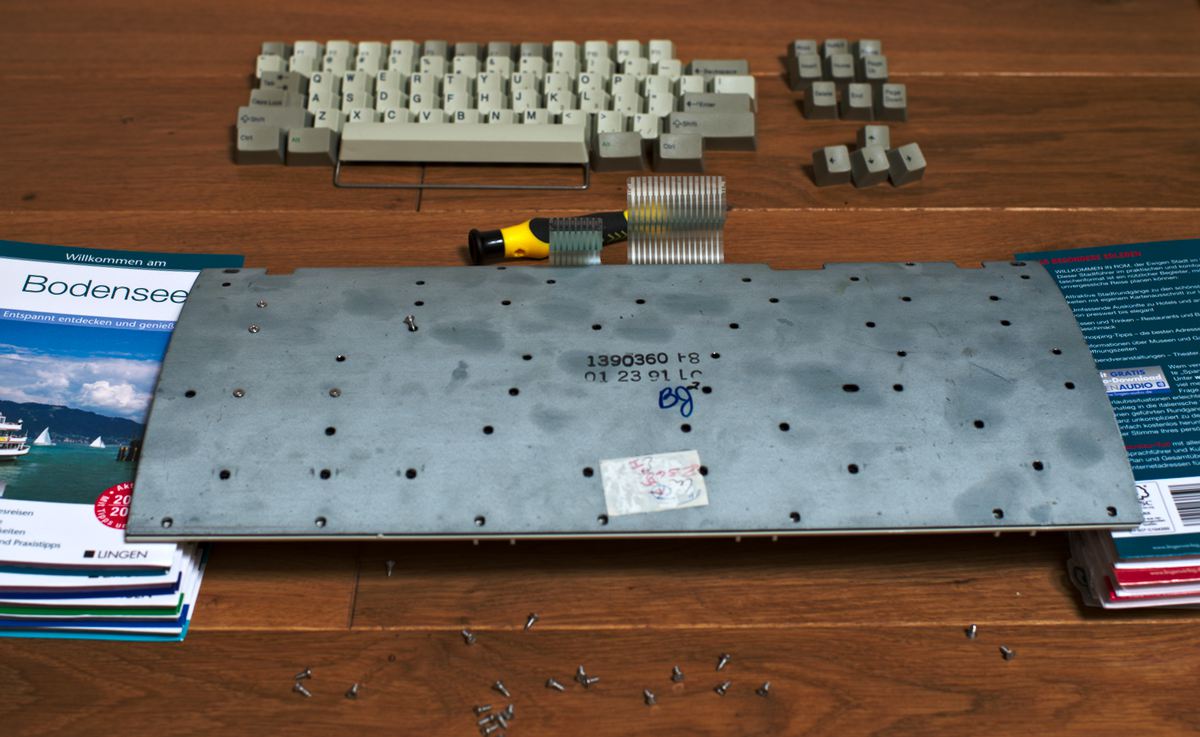

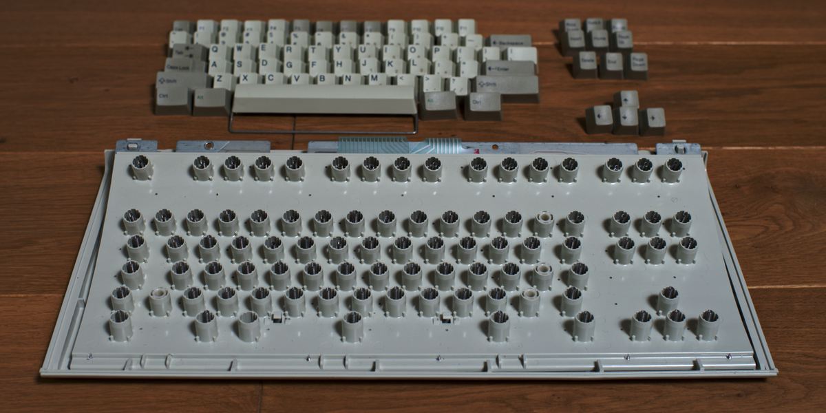

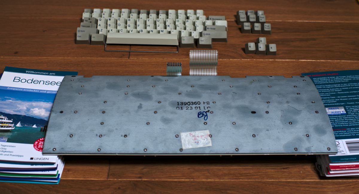

Apologies for the quality of the pictures. I do not have lot of time right now. I am posting while doing, real time:
Remove the keycaps:
Remove the screws:

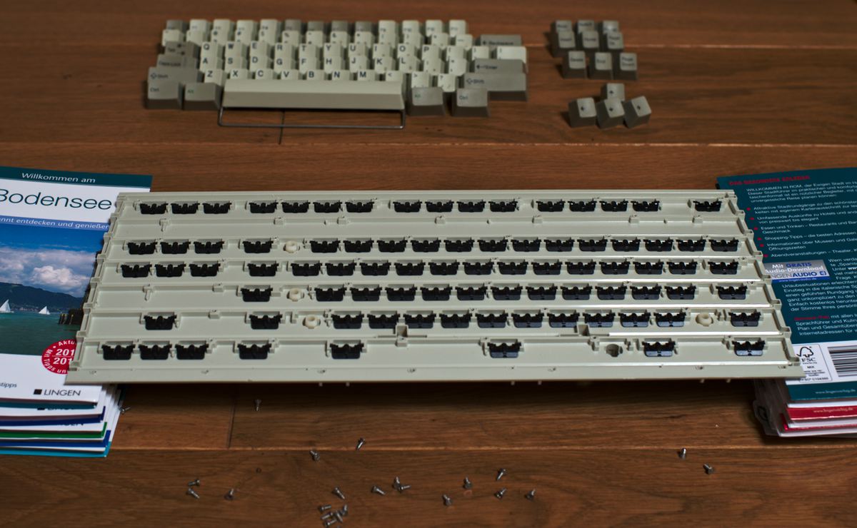

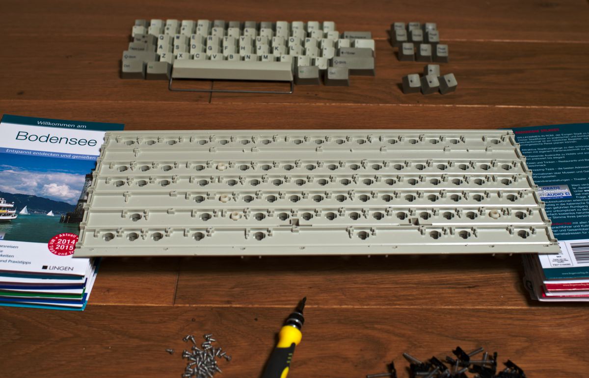

Replace the flippers:
You will notice that 4 of them do not fit. This can be resolved by modifying the plate or using an older one. I have to make my mind. I may use my other SSK for this project.

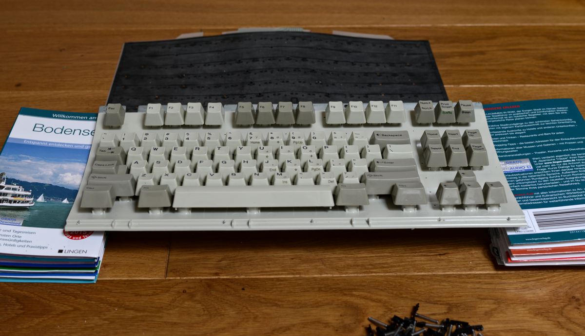

And mount it back.
Conclusion: leaving aside the four flippers that can be resolved, the flippers are compatible.

Posted: 25 May 2015, 18:45
by idollar
seebart wrote: I am sceptical it will feel 100 % exactly like Model F. Sure, more like Model F. It is a great idea though. Reminds me I got plenty F flippers around, just no spare ones. :D
For the time being you will have to trust my fingers.
It is not an M for sure. It is not an metal F (107 or similar). But it is VERY close if not identical to the F122 that I worked into an ISO layout.
I will try to get the project through. I have been collecting the parts for months. Now that I have them, I must do it.
It will take some time. I will be busy during the next 1,5 weeks.
