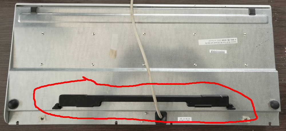

Stainless steel backplate and coiled cable

So that black thing on the back is a large stand?

seebart: Yes, that's a large stand.

Seebart: Yes it's a stand, though it's definitely not as good as the spherical rubber feet. The feet make a great angle and make the board utterly nonslippery on the table.
