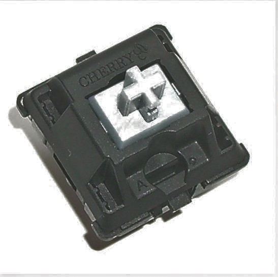

I don't mind collecting switches — I'm at over 300 types now and counting.
However, I photograph very few of them, and I process and upload very few of the ones I do take. I'm now at over 4000 largely unsorted photos and far too many undocumented switches.
Now, I just got some MX Speed Silver switches in. The photo below is adequate within the scope of my work, but the angle isn't quite right compared to my previous MX photos (which is why I prefer to collect a whole series before taking the photos).
So I turned my camera back on, and set it up the same way as as always: super macro, EV compensation to minimum.
This sucks.jpg (378.48 KiB) Viewed 7605 times

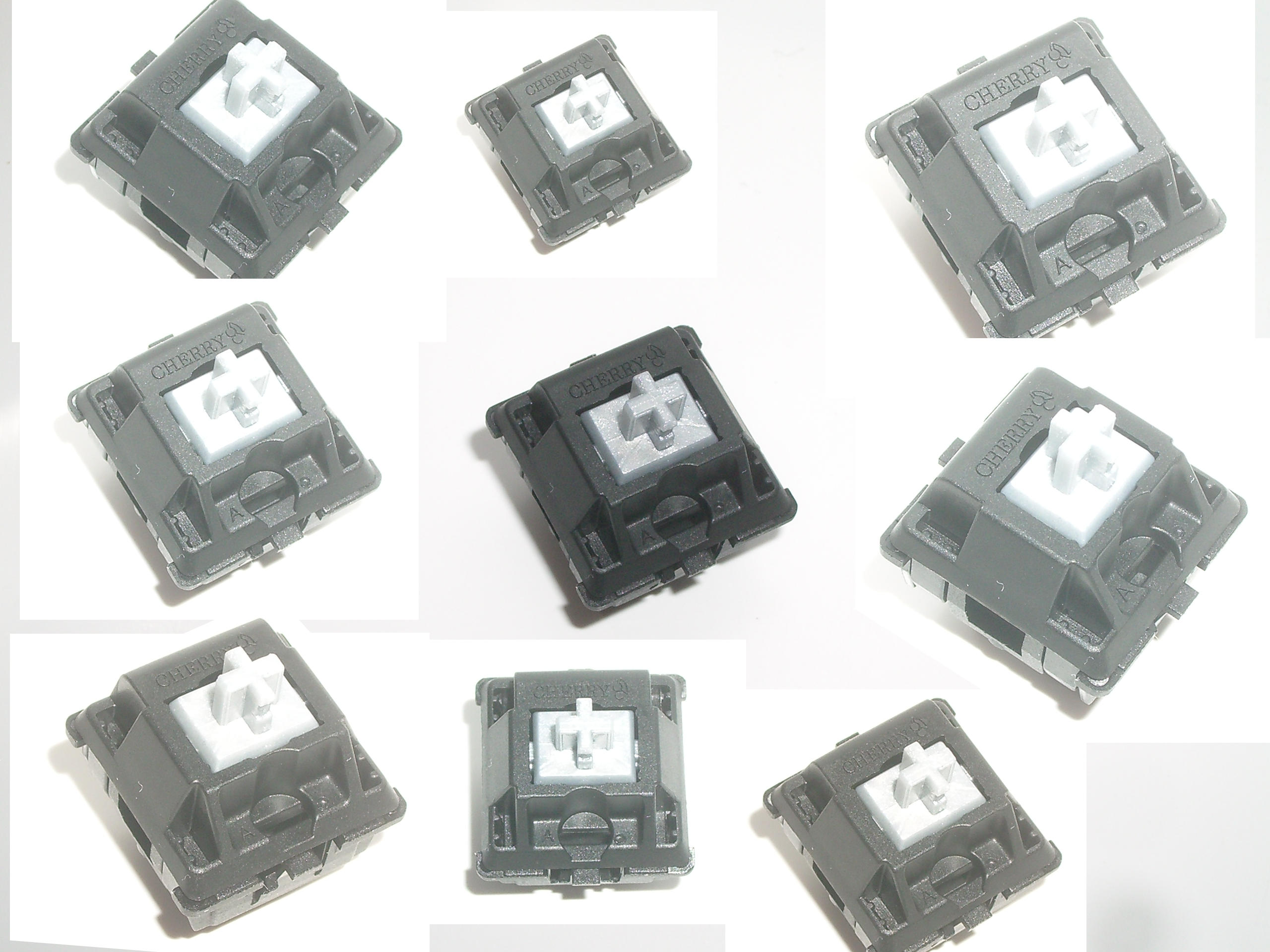

The inset photos are a variety of attempts to recreate the first photo, from any angle. That's both without my little lamp (just used to make autofocus work, but I had it turned off for the good photo) and with it on (facing both towards and away from the subject), using various angles and distances to the subject (all inset images are to the same scale) and with my ghetto reflector arranged in various ways.
This comes close to proving that my camera is not just sentient but capricious. I've known for a long time that the camera virtually randomises the settings, but this is the most extreme it's ever got. It's impossible to recreate the first photo and I have no idea why.
I desperately need someone to take the all switches and do a proper job with them — I don't mind collecting them so long as someone else shoots them. It takes enough time to get switches lined up nicely (that might take half an hour for one shot), balanced (I'll balance parts on-end or upside down to avoid unsightly props holding things up), without having the hassle of trying to gouge out some essence of value from piles of sub-mediocre photos.
Posted: 28 Apr 2017, 01:46
by snuci
Your white balance is way off and there's way too much light. I just edited the pic in the left side middle and simply lowered the light but the silver was still too washed out so that colour is lost in editing.
This sucks2.jpg (63.37 KiB) Viewed 7596 times

snuci wrote: Your white balance is way off and there's way too much light.
The amount of light is constant, year after year. The good photos and the bad photos here were taken minutes apart under identical settings and conditions, and the camera decided for no apparent reason to behave wholly differently. It relates to all the automated settings that I have no control over — largely black switches in the middle of a huge white background are likely so meaningless to the firmware that it can't correctly compute the settings. This results in imperceptible factors causing random variations in the algorithm that can drastically affect the outcome (there are days when I get exceptionally good results, too). Presented with a field of meaningful visual data (something like a PCB for example) the algorithm works well, but switches don't work.
You'd need a very small tripod for macro, since the camera is only a few inches away from the subject (and I don't have space for that anyway). A tripod standing on floor would just be an invitation to trip over it, especially when trying to find some spring that's pinged off — you've got to factor in another half hour to an hour looking for missing parts in disassembly shoots (that task requires a room with a light-coloured floor, no carpet, and entirely devoid of any object that anything can disappear into or behind — bear in mind that these parts can be as small as under 3 mm long).
I've left off doing the Datanetics switches for two reasons. DC-60 is a special reflect-the-flash-back-at-you design and I gave up with it. DC-50 is tall and has a white slider, creating two problems: the height goes outside the depth of field, and the exposed white slider disappears into the background and I can't remove it as it's too indistinct and too fuzzy. I've tried various grey card types and I never got good results. If the background is too dark, the details in the switch vanish as the background isn't reflecting enough light onto it.
Then you'd want to redo all the existing photos. Some were one-shot jobs. Damage to the switch during disassembly means that I can't recreate the photo sequence, and I don't have any spares. I'd have to look into buying replacements. Also, there are extensive disassembly sequences that all need recreating.
I don't especially want to take another photo ever again, but having the switches to hand means that I can take additional photos as and whenever, for example comparing Aristotle Yellow with real Cherry MX (those photos came out OK as it happens.)

This is the third attempt at the switch, original and adjusted:
IMGP5335 copy.jpg (163.94 KiB) Viewed 7425 times
The colour balance is still weird but I can't fathom what's wrong with it. The background has to be replaced with white as it's never evenly lit, and I've converted it to white without damaging the shadows. Compare this though to a Cherry RGB switch:
