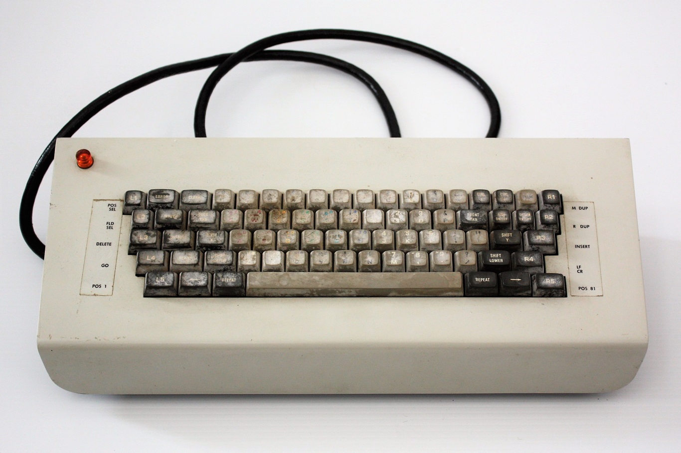

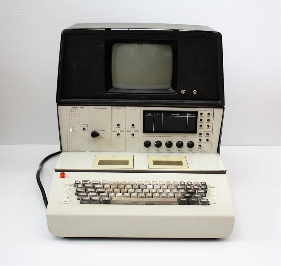

I recently acquired a Viatron System 21 computer. This computer was used for creating/storing and printing punched cards. Consider it as a word processor but with punched cards as output. While this computer didn't have a punch card built in, it had a device that would sit on top of the keyboard and punch the keys for you, among other forms of input and output.
Anyhow, I showed a picture of the keyboard but since it will need pretty extensive restoration, I figured I'd add a thread in case anyone was curious. Here's what it looked like when I got it.
Viatron System 21 - keyboard as received
Viatron System 21 - keyboard as received.JPG (300.82 KiB) Viewed 9568 times

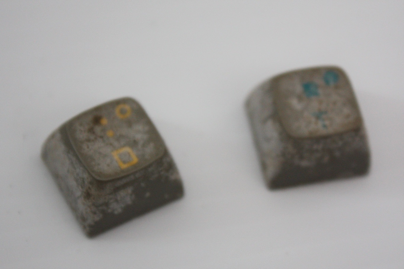

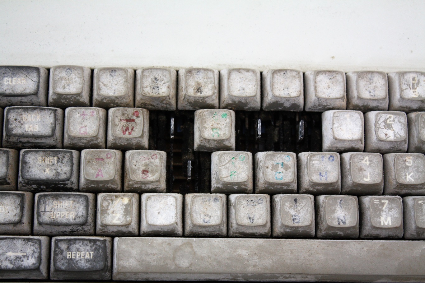

I was concerned these key caps may be engraved so I'd have issues restoring these depending on the condition and exactly what was on the surface. Polishing these key caps might damage them permanently if the damage was extensive. Thankfully, it's not too bad. There is a chalky surface on the key caps. I believe it's caused by extensive fading. You can use a fingernail to scrape off the chalk. Here's a close-up pic of the key caps.
Viatron System 21 - Dirty key caps

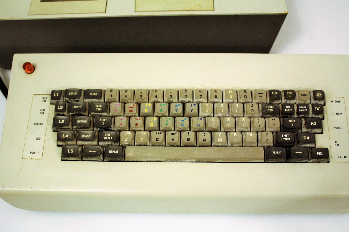

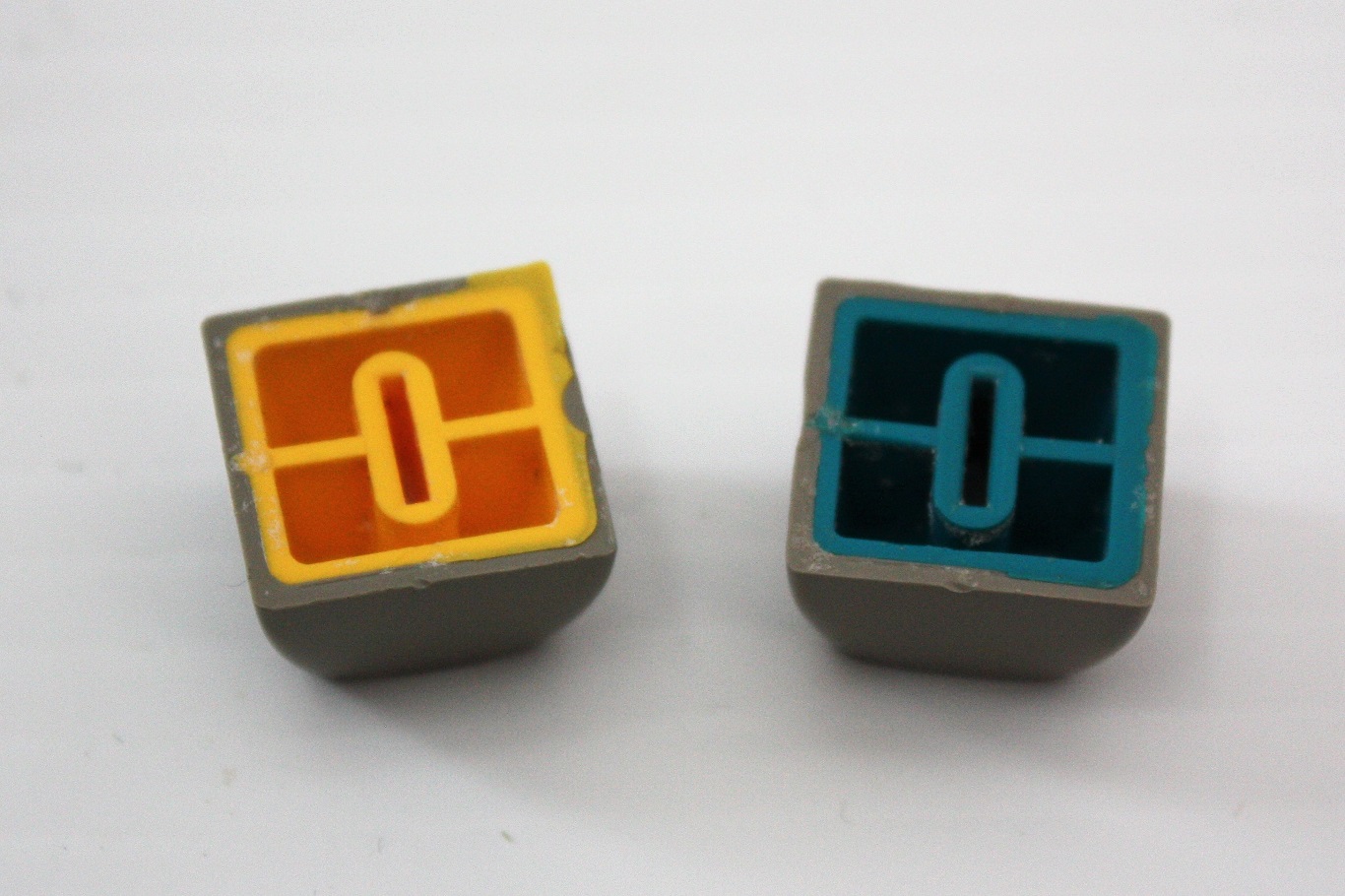

Here they are after soaking in water and polishing them with plastic polish. They still need more work but they are visible. On top of this, I am very fortunate that these key caps are double shots.
Front of key caps:
Viatron System 21 - cleaned key caps
Viatron System 21 - cleaned key caps.JPG (237.2 KiB) Viewed 9568 times
Back of key caps:
Viatron System 21 - key cap back
Viatron System 21 - key cap back.JPG (343.09 KiB) Viewed 9568 times

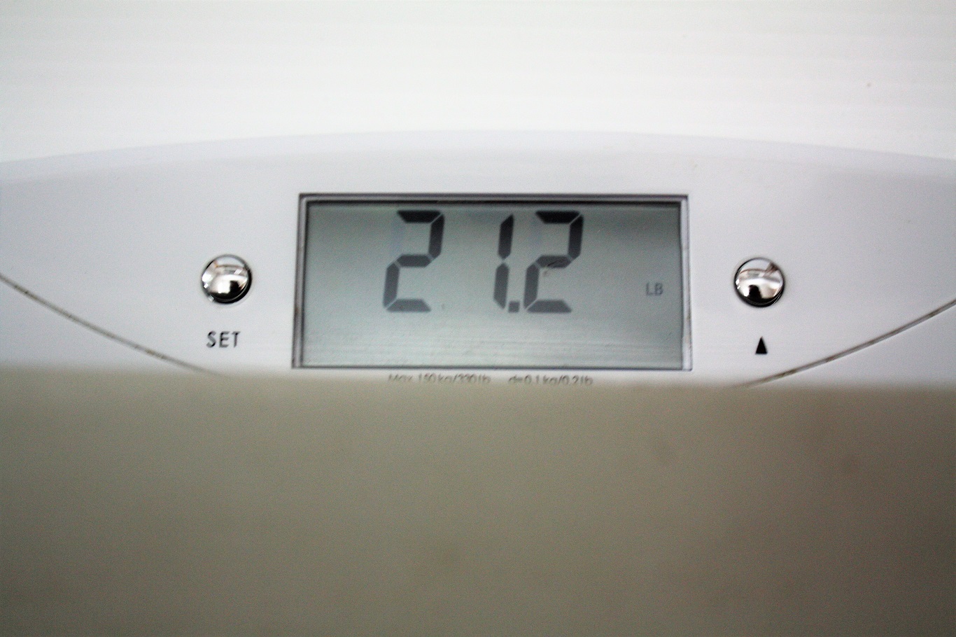

Lastly (for now), I think this might be the heaviest keyboard ever for the size and form factor. It must be forged out of a block of steel. It actually shocked me when I tried to lift it. Model M, look out, his will break a foot if you drop it; and not from very high.
Viatron System 21 - weight of keyboard (without cable)

Posted: 06 Sep 2017, 23:35
by Daniel Beardsmore
9 kg?! I guess now we have heavy light …
At least the keycaps are salvageable.

Posted: 07 Sep 2017, 15:42
by Chyros
Holy fuckballs, that thing is heavier than the Chyron Aircraft Carrier Oo .

Here's a quick pic of the terminal. All 130+ lbs of it. It's all made of steel as is the internals of the keyboard (not plastic like the Collimation Optical Encoder keyboard). The only plastic part on the device is the plastic surround around the monitor. Even the back cover is steel.

Posted: 07 Sep 2017, 16:39
by seebart
Impressive indeed. Nice to see those keycaps aren't damaged.

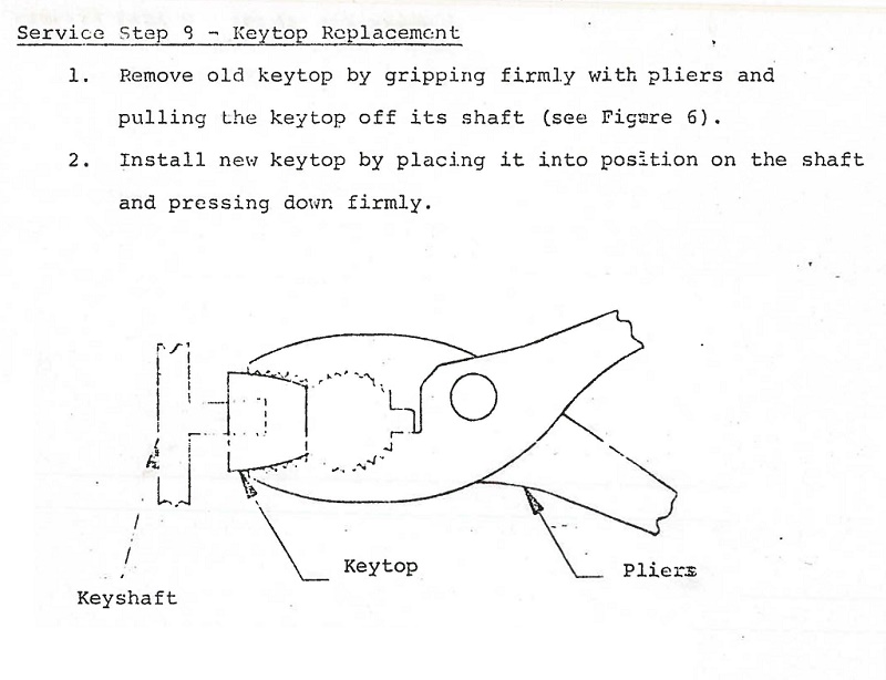

Here's an interesting tidbit that I found in the documentation. I cringe when I see this.

Posted: 08 Sep 2017, 15:00
by seebart
Well obviously they recomend the "brute" approach to keycap pulling. :o :roll:
Posted: 08 Sep 2017, 15:20
by pixelheresy
Yeah, that graphic is cringeworthy.

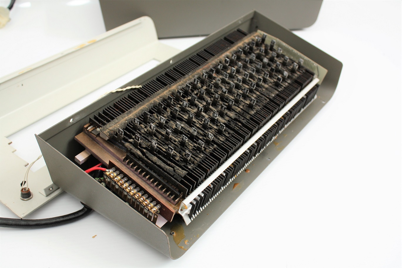

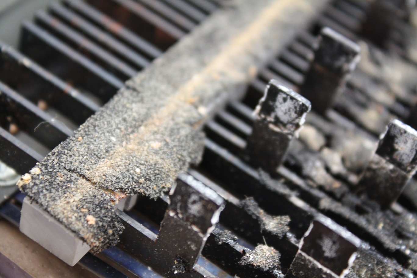

Here are some quick pics of the keyboard mechanism as I got it. What I thought was tar paper is actually thin foam that has deteriorated very badly. If I didn't see a small protected portion that was still intact, I wouldn't have a clue what it was. It was not a light shield (which is good) but it might have been a slight damper for the keys?
I wonder if the white stuff on the key caps is some form of outgassing byproduct? Chyros?
Here are the pics. I believe the light generation is on the left and the optical sensors are on the right. The top is a hinge for the key shafts. Because of the sticky foam, I don't know what this feels like yet.

Viatron System 21 - keyboard deteriorated foam
Viatron System 21 - keyboard deteriorated foam.JPG (329.83 KiB) Viewed 9371 times
Posted: 09 Sep 2017, 00:22
by Engicoder
Amazing number of parts! Taking that apart will require some careful notes. I hope you used the keycap puller recommended in Service Step 9 :)

Posted: 09 Sep 2017, 17:30
by HuBandiT
snuci wrote: It was not a light shield (which is good) but it might have been a slight damper for the keys?
Dust/dirt protection?
snuci wrote: I wonder if the white stuff on the key caps is some form of outgassing byproduct?
Looks like limescale or salt deposits; from vapour of hard water if stored in a damp/humid place, or salty air near a sea/ocean? I had such once on a terminal keyboard with shiny caps when a careless relative stored it outdoors for a few years. Or if it was used/stored in/near a printing house, could be chalk dust/particles (used for surface treating some kinds of paper).

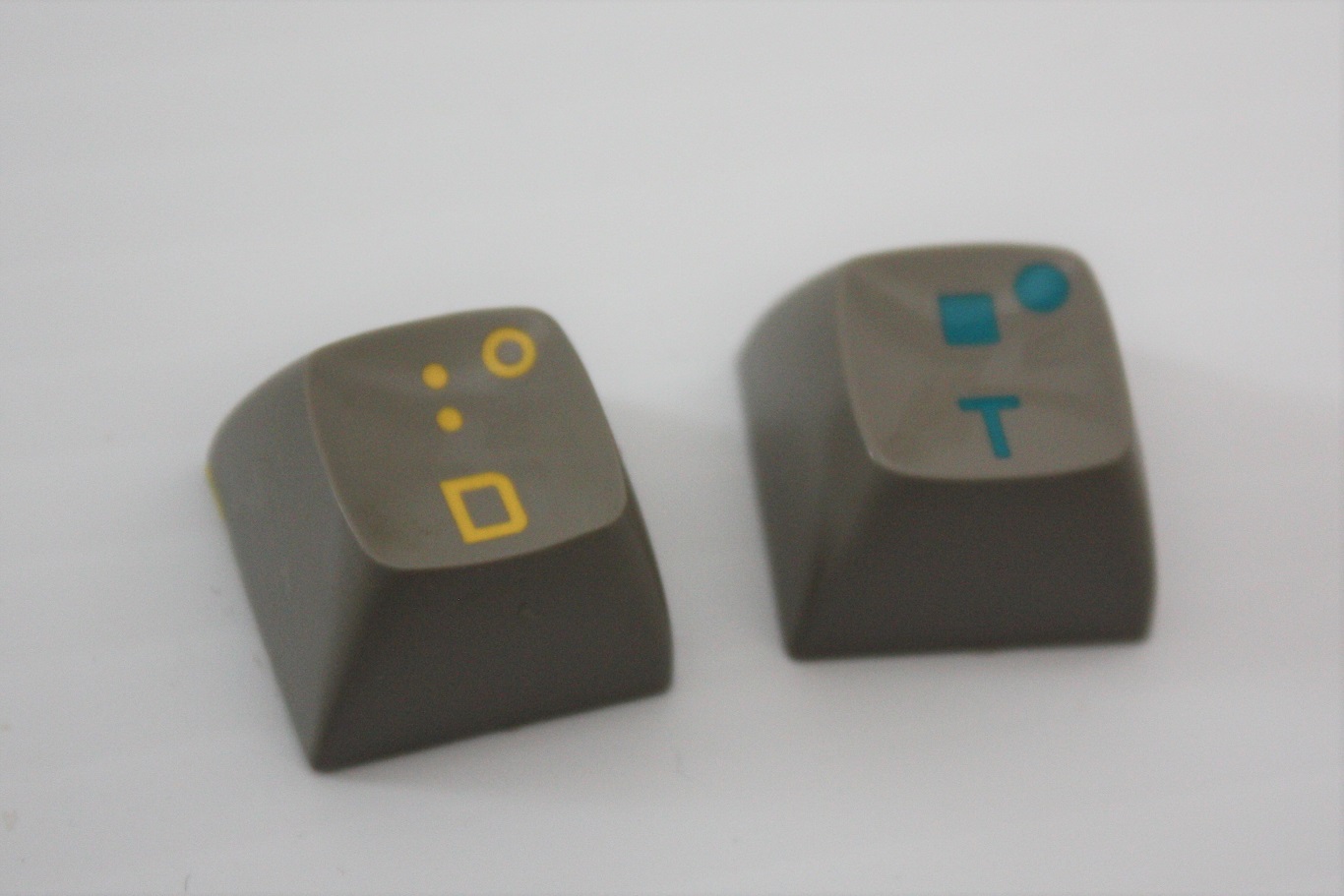

During this process, I didn't have a reference for the key caps like I usually do. The keyboard at the Computer History Museum is not detailed enough to read the key caps so I had to scrape off and clean up at the the key tops so I could make out the legends for replacement when cleaned.
Here is a couple of pics. More to come later on or tomorrow as I am now done. These are definitely unique legends.
Before cleaning:
Viatron System 21 - key legends for reference after cleaning
Viatron System 21 - key legends for reference after cleaning.JPG (398.21 KiB) Viewed 9172 times
After cleaning:

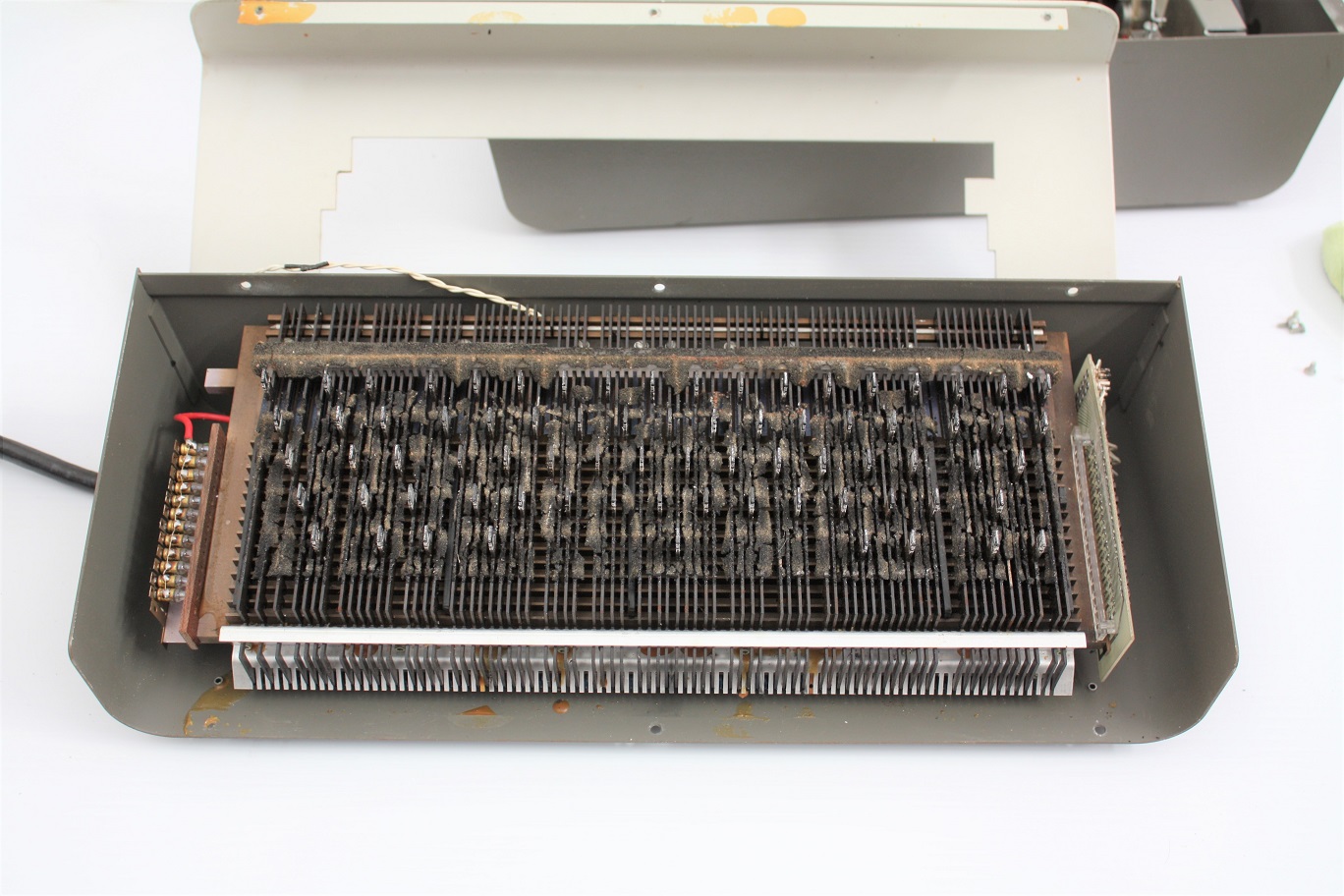

Here are some pictures of the internals while I was cleaning it up. The deteriorated foam had eaten into the paint so after I scraped and chipped the hardened foam off, I touched up the key shafts. There was also a toffee-like sticky substance that is visible in the pre-restoration pictures that was making the key shafts stick that also had to be removed. This was a real challenge but it did clean up for the most part.
You can see the light channels under the key shafts. Depending on the key pressed, the light coming from the left side would be blocked by the unique fingers per key shaft so that the optical sensors on the right would see the unblocked light and determine what key was pressed. The light channels are also forged metal so this definitely adds to the weight. I have not yet found an appropriate patent for this but the light and optical sensor boards are made by Viatron so I don't believe this is a third-party keyboard.

Viatron System 21 - pre-restoration sticky toffee-like substance
Viatron System 21 - pre-restoration sticky toffee-like substance.JPG (496.76 KiB) Viewed 9129 times

Viatron System 21 - post-restoration keyboard mechanism
Viatron System 21 - post-restoration keyboard mechanism .JPG (347.91 KiB) Viewed 9129 times

Posted: 10 Sep 2017, 05:11
by Sangdrax
I took apart a busted Selectric II recently and this really is built a lot like a typewriter. The levers and mounts looked almost exactly like that. Used a comb spring for the levers exactly like that. Had that sheet of foam under the keys, which I think was a kind of contamination shield more than anything. There is so much grease in these mechanisms, you can see why they wanted to keep as much dirt and crap out as possible. Probably the gunk you were dealing with was old hardened grease. Either that or rotted foam. It tends to liquify after thirty or forty years.
Gorgeous board though, and very interesting. Looking forward to more of what you find on how it works.

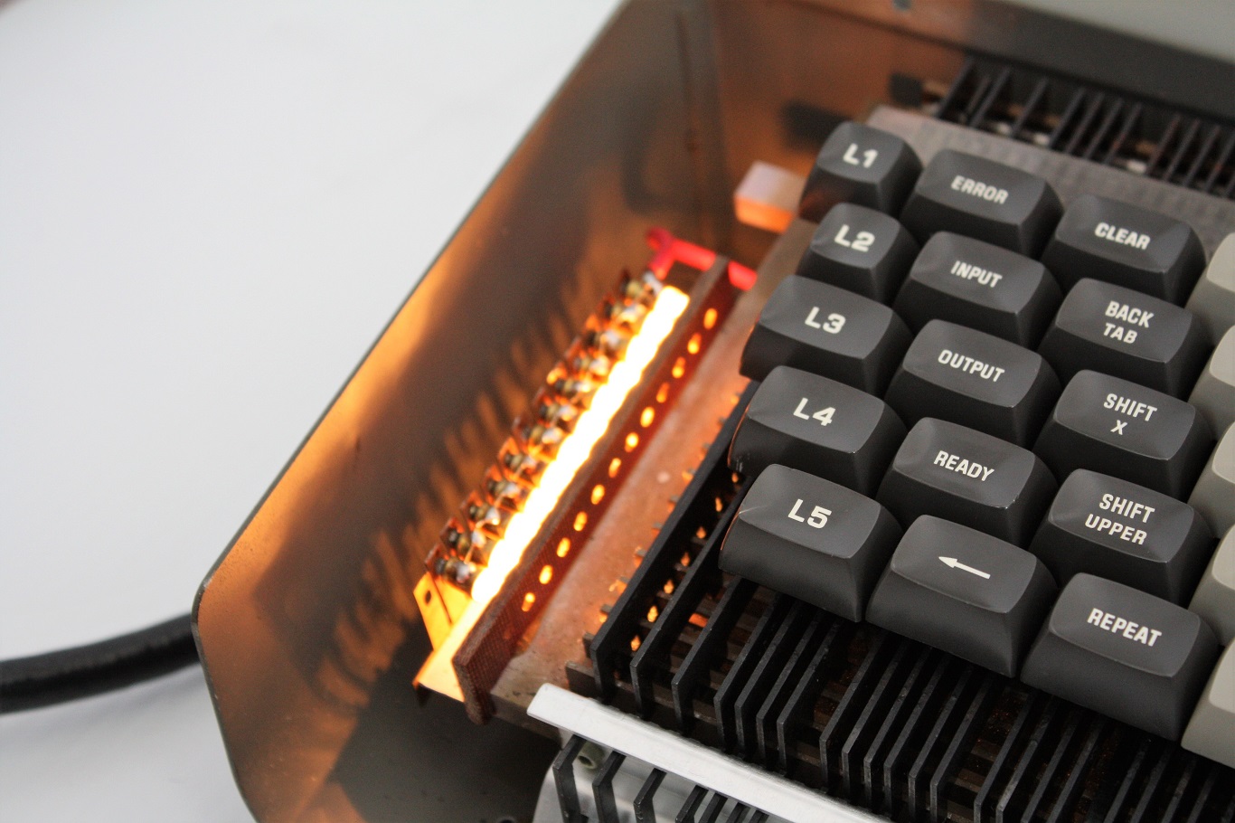

Added a picture to illustrate lights on one end of the keyboard actually lit up.
Viatron System 21 - Keyboard lights
Viatron System 21 - Keyboard lights.jpg (317.2 KiB) Viewed 8953 times
Posted: 23 Nov 2017, 15:21
by Engicoder
That looks amazing. Seems like a shame that its hidden inside the case. This really cleaned up so well!!

Wow, it is super cool actually seeing the lights working correctly. I didn't expect that to happen. That plastic polished worked wonders on those keycaps. I may have missed it, but is there a name for the mount on this particular set of keys? Am I correct in thinking these could be replaced with other keycaps from keyboards with similar arms? Not that you intend to, of course. Awesome restoration.
Posted: 28 Nov 2017, 18:43
by snuci
gkubed wrote: I may have missed it, but is there a name for the mount on this particular set of keys? Am I correct in thinking these could be replaced with other keycaps from keyboards with similar arms?
I don't know the name of this specific mount but I am fairly certain these would be interchangeable with IBM beamspring key caps or Selectric typewriters.
Not sure the mount type was ever named, I guess it would be something like "Flat Metal Typewriter Mount" or "Flat Metal IBM Mount". FVTM (Flat Vertical Typewriter Mount) IDK just spit-balling now.
