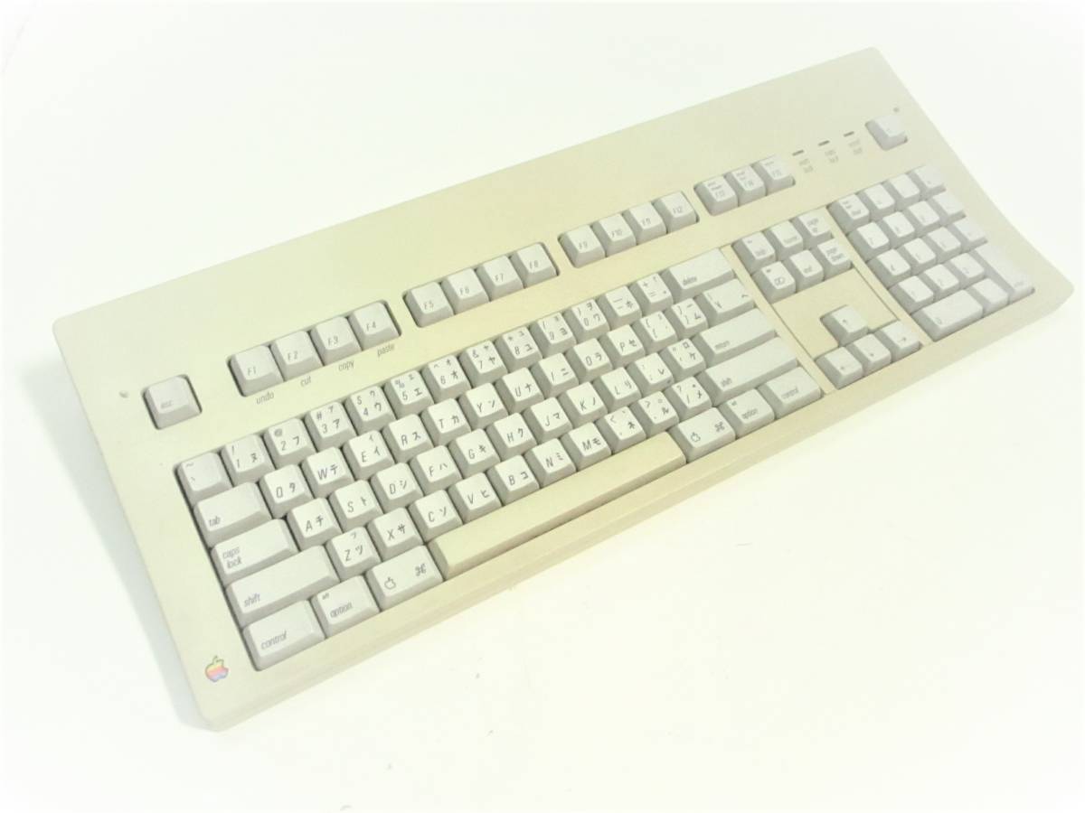

So I recently bought this good looking japanese AEK :

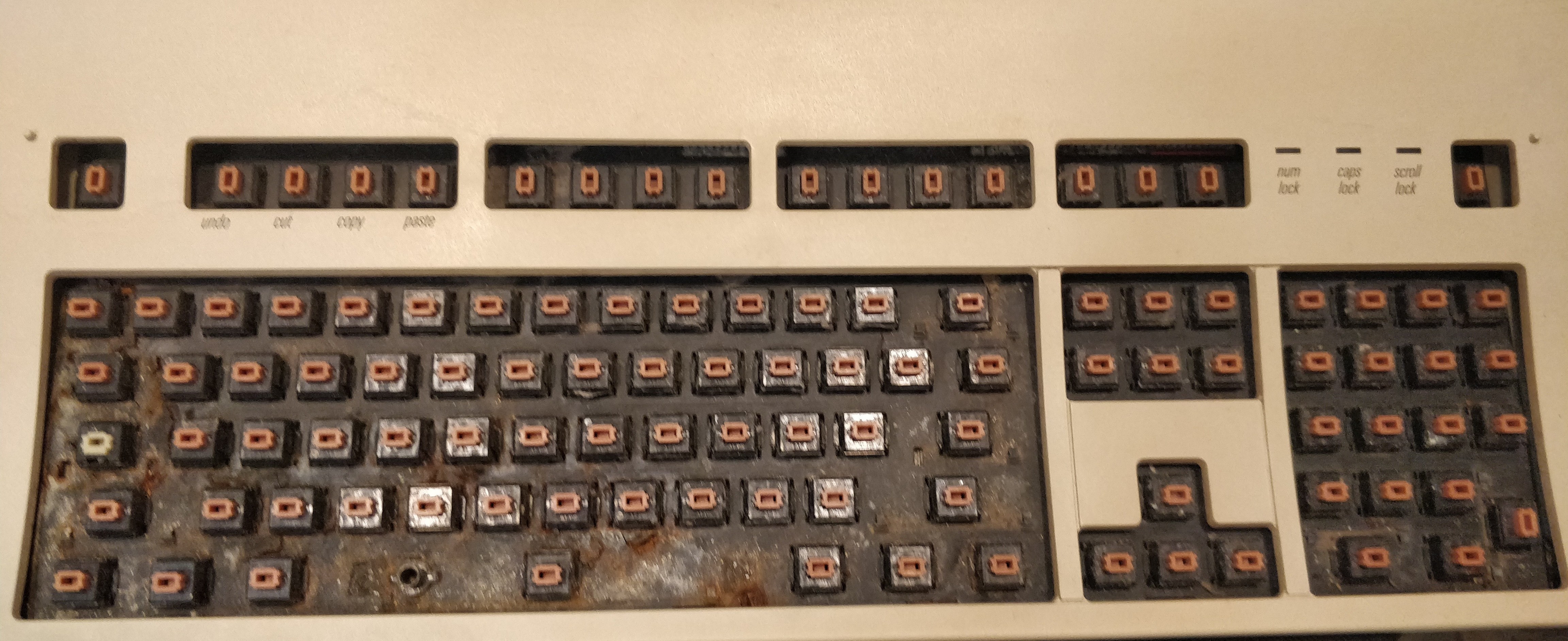

However, upon closer inspection, the board is absolutely rusted to rot:
So, is this salvageable? Should I consider designing and manufacturing a new plate? I'm guessing the pcb/electronics are probably in quite the bad condition too, but haven't checked yet.
Would you recommend just salvaging the switches and keycaps and doing an alps tkl build instead?

Plates can usually be sanded back and painted unless they're really rusty. Biggest issue I've had on corroded boards is definitely the switches. Worth popping a few open to see how bad they are.

Thanks for the replies! Shipping from USA is unfortunately impossible for me for the next 6 months due to my life situation, so I'll try to salvage it first.
The switches feel pretty good so I'm hopeful, but in worst case I have some donor switchplates from salmons and isopropanol.
