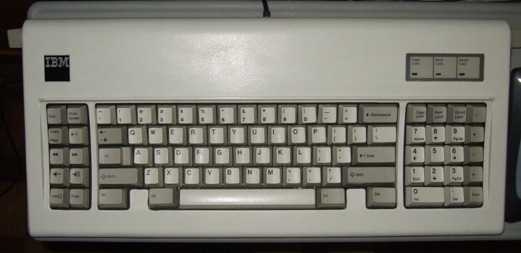

The IBM XT keyboard has a fantastic feel but the key layout is ... not great. For years it has been the ugly stepchild next to the AT, Model M, and SSK. It uses the XT protocol, so is not natively compatible with any computer made in the last 30 years and no one actually likes where the keys are on this thing, they just love the feel.
For the last few months I have been investigating the feasibility of modifying a Model F XT keyboard. I’ve hinted about this in a few threads here and at GH and at the urging of a few members, I’d like to crowdsource this idea. A design goal for the project is to re-use as much of the original keyboard as possible while adding popular elements of modern keyboards such as improved key layout, USB connectivity, programmable keys, and maybe backlighting.
My research suggests that this can be accomplished by adding Soarer’s adapter and changing only two significant parts; the matrix PCB and the metal top plate (barrel frame). As an incentive for your participation in this project, I offer you recognition here and also the fruits of your collective labors – a group buy of the new parts along with easy to follow instructions. The PCB, barrel frame, and pad “conversion kit” should run between $30 and $60 each depending on quantity ordered. Teensy, custom keys, and IBM XT would not be included at this price, but many of you may already have these.
If this project is a success, I expect that it will stir interest and spin off similar projects like a capacitive buckling spring mini or ergonomic. But these ideas will likely require a different controller and case than the original IBM PC XT keyboard.

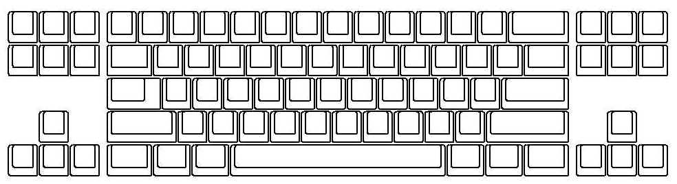

Posted: 01 Jul 2012, 18:44
by AKIMbO
I love the name Model F NG.
Here's my take on a proposed layout. It has all the keys a normal TKL does...plus media keys (vol up, vol down, play, pause, next track, prev track). The only key that I completely did away with was capslock, but who will miss it! It also doesn't have a right windows key.

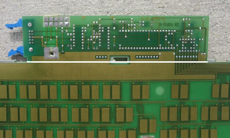

Posted: 01 Jul 2012, 21:53
by wcass

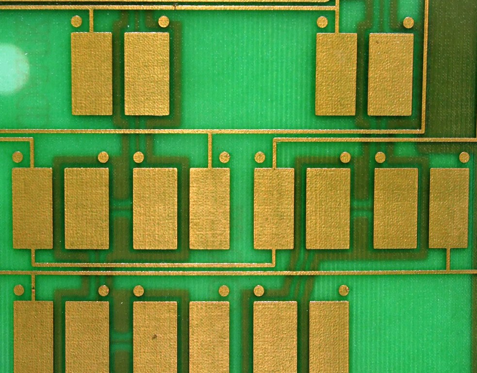

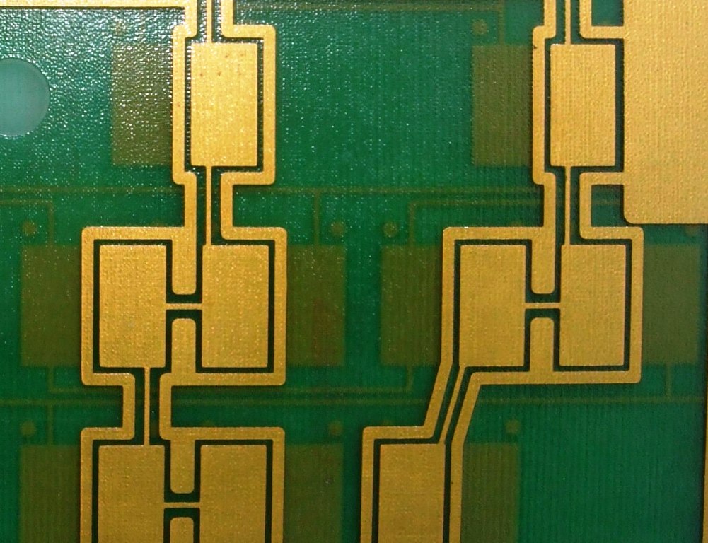

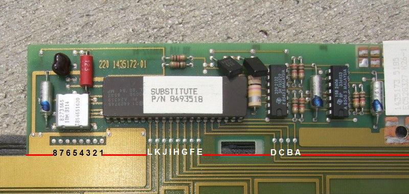

here is where we will cut the controller:
from the other side with rows numbered and columns lettered:
here is a close up of the front top right of the matrix:
matrix top.JPG (217.98 KiB) Viewed 32861 times
and the same spot from the back (mirrored):
matrix back.JPG (170.07 KiB) Viewed 32861 times

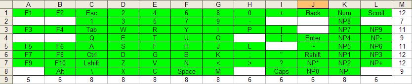

Good idea. But we are limited to 83 keypads. We are using 63 under the alphanumeric keys (2 for left shift and 2 for enter – required for ISO convertibility). The right shift has only one live switch, but uses two barrels (one for the stabilizer). The backspace key is still using two keypads – could take one there, but for every “extra” key added it means that you will need to find a source for barrels. The downside of the layout I suggest is that it does require one more barrel than what comes with the XT.
Try your hand at rearranging the keys in a way that incorporates that spot but still only uses 19 keys in 6 columns outside of the alphanumeric. Remember, you can use 1.25, 1.5, and double-wide keys.

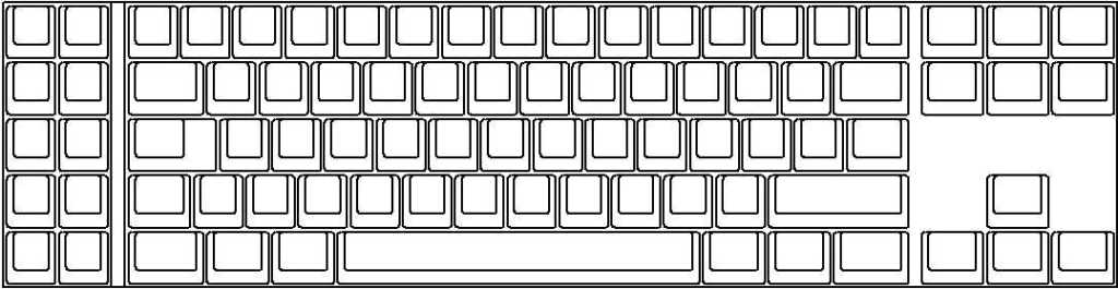

What about a layout like below? It would alleviate the need to cut out the bar that runs parallel to the function keys.
Please excuse my poor paint skills^
Posted: 01 Jul 2012, 23:10
by Findecanor
I don't think that the layout with three columns on the left would fit. Note that the Model F XT has only a 1-unit wide Enter key and a 1 3/4 wide Backspace key, and the partition to the function keys is 1/2 keys wide. The area available for keys is therefore 21 1/4 wide with the partition removed. The main keyboard area needs 15 units. Then you are left with 6 1/4 for six keys + new partition. This means that each new partition must be 1/8 unit wide, and 1/8 units wide is 1.78 mm including space on each side. We don't have these tolerances.

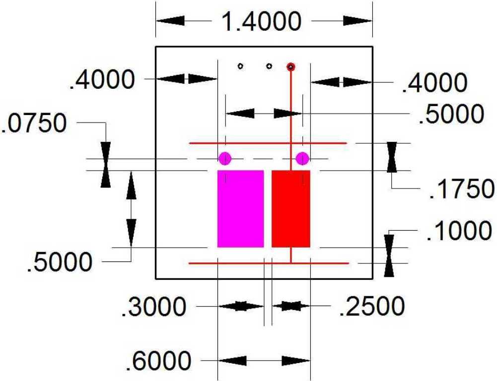

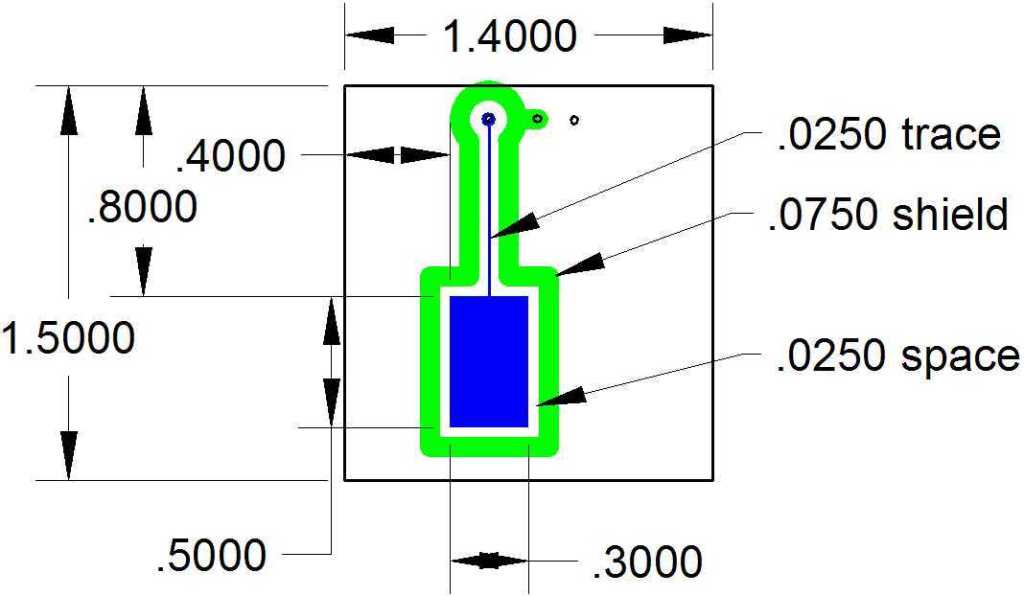

PCB Info:
The board is .031” thick with two copper layers. Copper weight is unknown (does anyone know how to test for this?). The matrix part of the PCB is 16.6”x 4.8”
Each capacitive switch is composed of three rectangular pads:
• a row pad is .500” tall, .250” wide, and is on the top copper layer
• a column pad is .500” tall, .300” wide, and is on the bottom copper layer
• the third pad is exactly the same size as a column pad, but is on the top layer directly above the column pad; this pad is not connected to anything; if there is not a proper name for this pad, I dub it the “magic pad”
• distance between a row pad and the magic pad is .050”
• two .085 diameter dots are at the top corners of each switch; like the magic pad, these are not connected to anything; I will be referred to these as “magic dots”
• standard switch width is .750”; standard height is .825”
• row and column traces look to be .025” wide
• minimum distance between traces looks to be .025” also
• row lines normally run .175” above the top edge or .100” below the bottom edge of a row pad
• the bottom of a bottom row pad is .200” from the bottom edge of the PCB
• the top of a top row pad is .800” from the top edge of the PCB
• the left side of a left most column pad is .400” from the edge of the PCB
• the right side of the right most column pad is .400” from the edge of the PCB

AKIMbO wrote:What about a layout like below? It would alleviate the need to cut out the bar that runs parallel to the function keys.
Good idea. It is one key narrower so the space between the alphanumeric and navigation keys will be a tad wider than what you are used to on a tenkeyless. I could do a mock-up if you like.

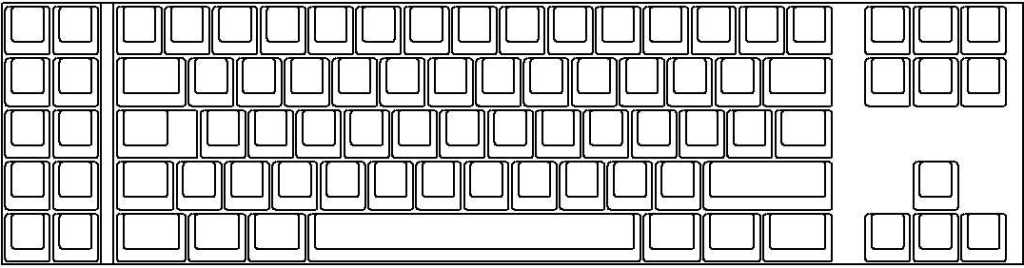

Posted: 02 Jul 2012, 02:35
by wcass
This has got the border on it. Also, all 83 keys are shown. Left shift is split (ISO), backspace is split (Happy Hacker), enter is split (ISO would be double high, ANSI would be double wide). I just dropped the navigation keys in, but there is .80" of space to split up for left and right of the navigation keys.
I just thought of something. If we make all of the navigation keys 1.25 wide then it fills in the extra space. I'll do a mock up of that.

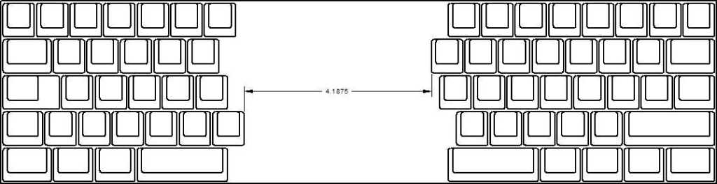

by wcass
Here's a starting point for the guys that like a split keyboard. What you see displayed uses 68 barrels leaving you with 15 barrels to use elsewhere. The split in the middle is just over 4".

There seems to be one pad on either side with one having this "shield" around it. I assume it is grounded? Do you know why it's necessary?

Icarium wrote:Great idea! Wanted to do something similar for a while.
Do you know how exactly the switches work, yet?
What exactly does the PCB have to look like?
I have a copy of the IBM patent and several other derivatives around here somewhere, but -not being an EE, i don't pretend to understand it. as near as i can tell, the switch is composed of 3 pads and the hammer. one of the pads is charged and - due to the position of the other pads, some of the potential energy is stored electromagnetically across all the pads. when the hammer strikes, it adds another "pad" and potential energy is shifted around. the controller is connected to one of the pads and detects this change and registers this as a key press. the type of capacitor formed by the pads is polar - serving the same purpose as the diodes in conductive switches.
this might also be useful reading
http://en.wikipedia.org/wiki/Capacitive_sensing

Here is a the XT matrix:

Posted: 03 Jul 2012, 14:30
by Soarer
wcass wrote:... the type of capacitor formed by the pads is polar - serving the same purpose as the diodes in conductive switches.
I don't think it's polar - it doesn't need to be. When the switch is closed, the capacitance is lowered which when strobed increases the rate of change of voltage at the sensing side, hence increasing the voltage sensed at a given time after the strobe above some threshold in the sensing circuit. Any other path to the sensing would have to go through multiple switches, but the switches in other columns have their strobe lines grounded which I guess quells the signal.
