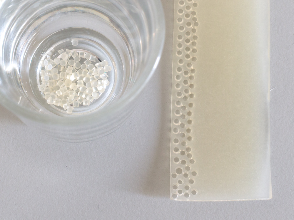

by Jmneuv
I will not be distracted by some crazy dentists:
2.0mm dia, 1.5mm thick, hard
i settled on 2.0mm diameter, 1.5mm thick, hard silicone;
2.5mm diameter / 1mm thick pads will fit tightly and not be removable; they also will compress little so a 1mm thickness is enough (else you lose too much travel) - this option feels more "professional" though;
Update: 1.5mm thickness is probably slightly too much: now on an assembled keyboard when normally typing i'm squeezing the pad only minimally (when bottoming out), thus not really 'reclaiming' any of the lost travel.
I'll try 2.0mm dia & 1.0mm thickness next. Probably something uneven like 1.2 would be perfect.
Did you know?: the 'X' in 'MX' stands for 'eXperiment' ~.~

Posted: 07 Feb 2014, 16:25
by tricheboars
what is the tool used to make the little dampeners? this could be a silencing solution for SA caps!
Posted: 07 Feb 2014, 16:27
by Muirium
And what were the results of different depths of silicone? I've got some busted MX blacks lying around (from an ugly desoldering fight with a Tipro) to experiment with.
Posted: 07 Feb 2014, 17:51
by welsinki
tricheboars wrote:what is the tool used to make the little dampeners? this could be a silencing solution for SA caps!
It looks like a leather hole punch normally used to punch holes in belts.
Posted: 07 Feb 2014, 18:37
by Jmneuv
Umm i can give some more in-depth answers later when i have more time. As a quick overview i can say: i love it, the silencing totally works - any switch i open up gets the little silicone pellet treatment. I finally got my hands on 1mm (exactly) silicone which is juuust barely thicker than the gap below the stem-'stick' thus just dampening while reducing travel not at all:
http://www.ebay.de/itm/221351433388
(thanks to the guy who used the thin sheet for topre)
The tool is indeed a belt hole tool - luckily the smallest of the wheel was just right (i sharpened it a little).
Please be aware however, that you will lose the typical authoritarian knock when bottoming out with plate mount switches. If you're going to miss that - watch out.. also due to the silence you'll start noticing other things like spring ringing, scratching, etc.
Key upstroke now is loudest of course, no way to dampen that.. a thick custom pcb might help in that regard.
If you guys have some patience and don't want to commit with sheets and tools yet, i could make a few packs and send them out.

Posted: 23 Feb 2014, 11:25
by Muirium
Jmneuv was kind enough to send me some of these 1 mm thick tiny silicone discs so I can try them myself. They are indeed pretty neat. I lined up some MX blacks in a spare plate, and tried direct comparisons between this damping method and o-rings on various caps.
O-rings lose a noticeable bit of key travel, of course. These internal dampers (I-rings?) are a notable improvement in that regard. And the damping itself is very similar. I recommend anyone interested in o-rings gives these guys a shot.
The downside is installation, of course, You have to open up your switches, and it's a tiny plug you've got to slide down a tight hole. I lucked out by finding a good sharp pin, however, and I just stab them in the middle when they're lying on my desk, and insert with that.
Typically, I'm not a switch modder. These MX blacks are sacrificial for keyboard science (they all lost a leg in The Battle of Tipro that I fought against a Slovenian army of veteran solders) so I'll try some lube while I'm at it. A bit of practice and I might even be up to the task of damping my greens.
Thanks Jmneuv!
