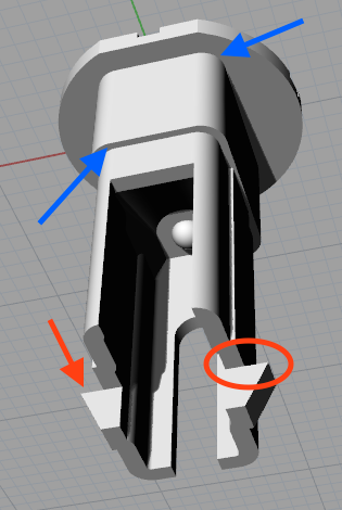

Really looking forward to this. I wonder, now this is probably just crazy, if damping would make any sense whatsoever with buckling spring? You know what I'm thinking: something like and o ring on the way down and a Type-S Topre collar for the upstroke. Does this make any sense? I am probably just overthinking this, believe it or not…

noise from BS comes from so many places that I wouldn't even know where to start from silencing it :) Definitely a buffer under the top platform would be a nice start

Annotated image: Blue is downstroke, red is upstroke.
I think damping the upstroke would be interesting, as I like the effect it has on Alps and Topre. Perhaps buckling spring would sound more snappy with damped clacks? I need to think about that.

Damping the upstroke is more complicated I believe, there must be some "slap" from the flipper contributing to the noise

the barrel hits the top platform only. The small step you pointed with the second arrow is just for reinforcement.
The upstroke needs to be dampened from the inside of the keyboard I think (and not from the slider itself). But noise also comes from the spring and the BS "pivot plate".
