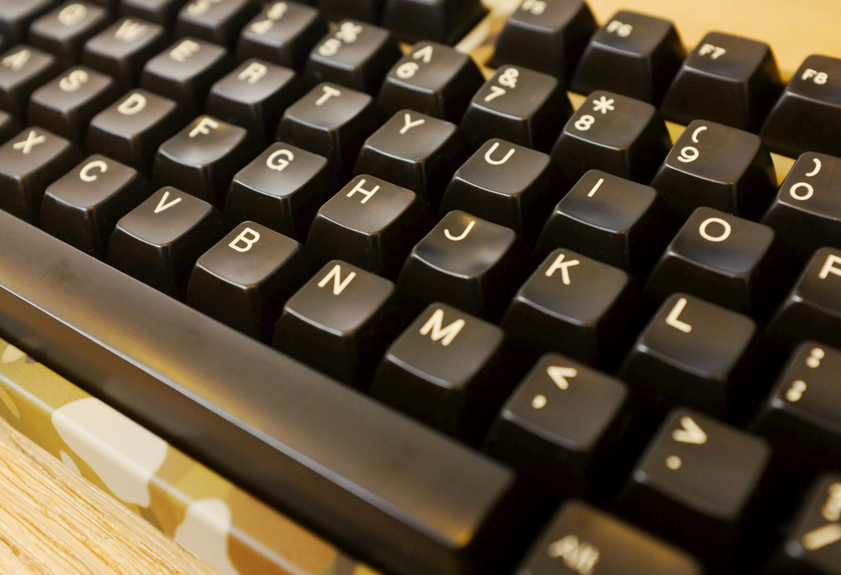

I loved the retro styled SP caps sold as FILCO branded caps, the colour was just wonderful, but the quality was dreadful. As Mu said, its a little hit and miss. A great shame.
- Screen Shot 2015-02-13 at 13.41.38.png (831.8 KiB) Viewed 6302 times

Shiva had a pretty rough time with that particular SP set. No thanks to "Filco", whose name appears on the packaging but who don't seem to give a toss about "their" product!
http://deskthority.net/keyboards-f2/fil ... t9401.html
