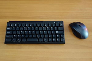

Uniform stagger
A Filco Minila Air with 0.25u equal stagger
A uniform stagger or equal stagger has all letter-rows shifted an equal offset to one-another. A 1/4-key uniform stagger is more often found among compact keyboards. A 1/2-key uniform stagger is more common among vintage/low-cost and point-of-sale keyboards.

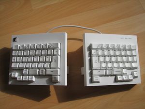

Columnar layout
A NEC PC-8801-KI keyboard. It has the alphanumeric keys in a column-oriented layout
Many ergonomic keyboards have instead keys organised in a columnar layout, with the columns shifted at different offsets to better suit the different fingers.
Columnar layouts are sometimes called column-staggered

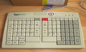

Matrix layout
A TypeMatrix 2020 with ortholinear layout
A keyboard layout with no staggering is called matrix layout or ortho-linear (or ortholinear) layout. The term "ortho-linear" was coined by TypeMatrix.[Citation needed]
Matrix layouts are believed by some to help with RSI symptoms but no research can be found on this subject.[1]
